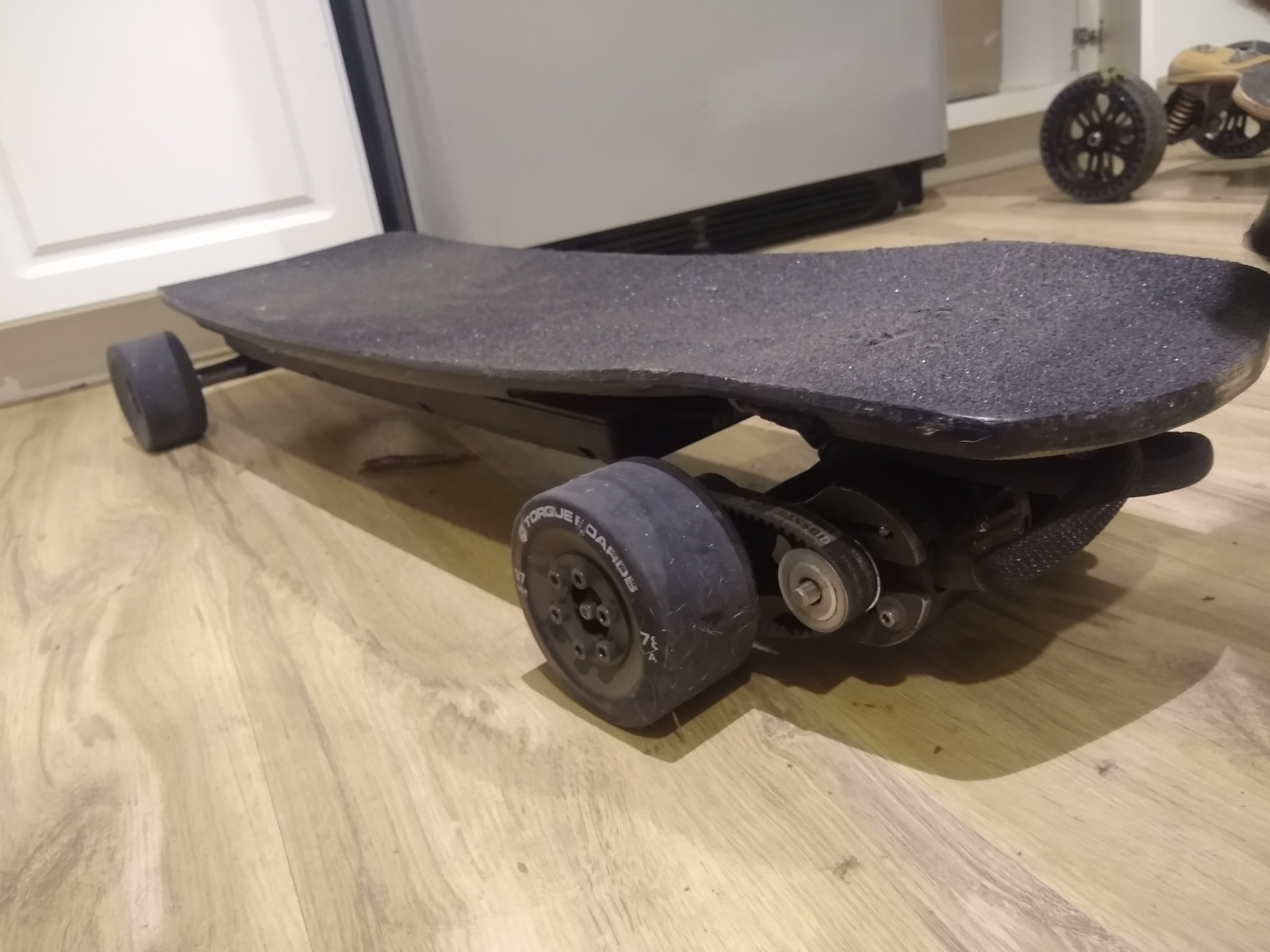

I have this omen barfight that has idk what you call it, but it drops in the back and works like a kick would. Motors are getting moved to the other side for obvious reasons.

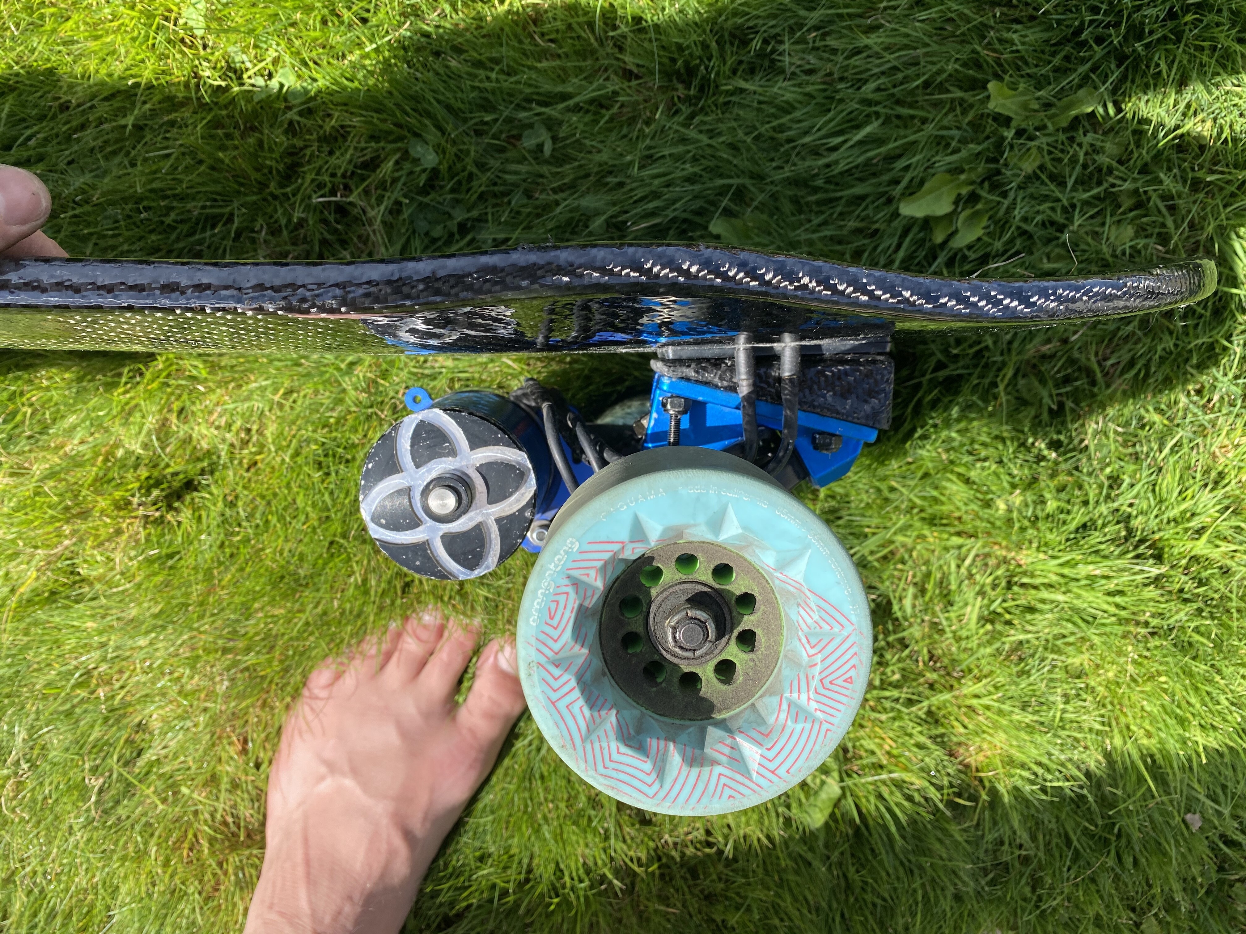

Proper vibration dampening needs to be accounted for though. As well as the understanding that you may bend your axles a bit quicker.
The most important thing is the 8 mm shaft and 26 mm (by memory, please confirm) axle length for compatibility.

Basiclly a Short Kicktailed dual Hubdrive is your best bet for having a good easy Pop.

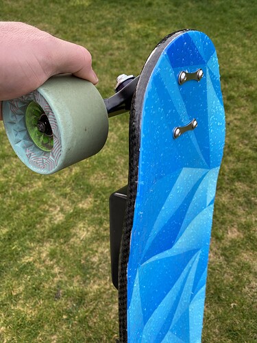

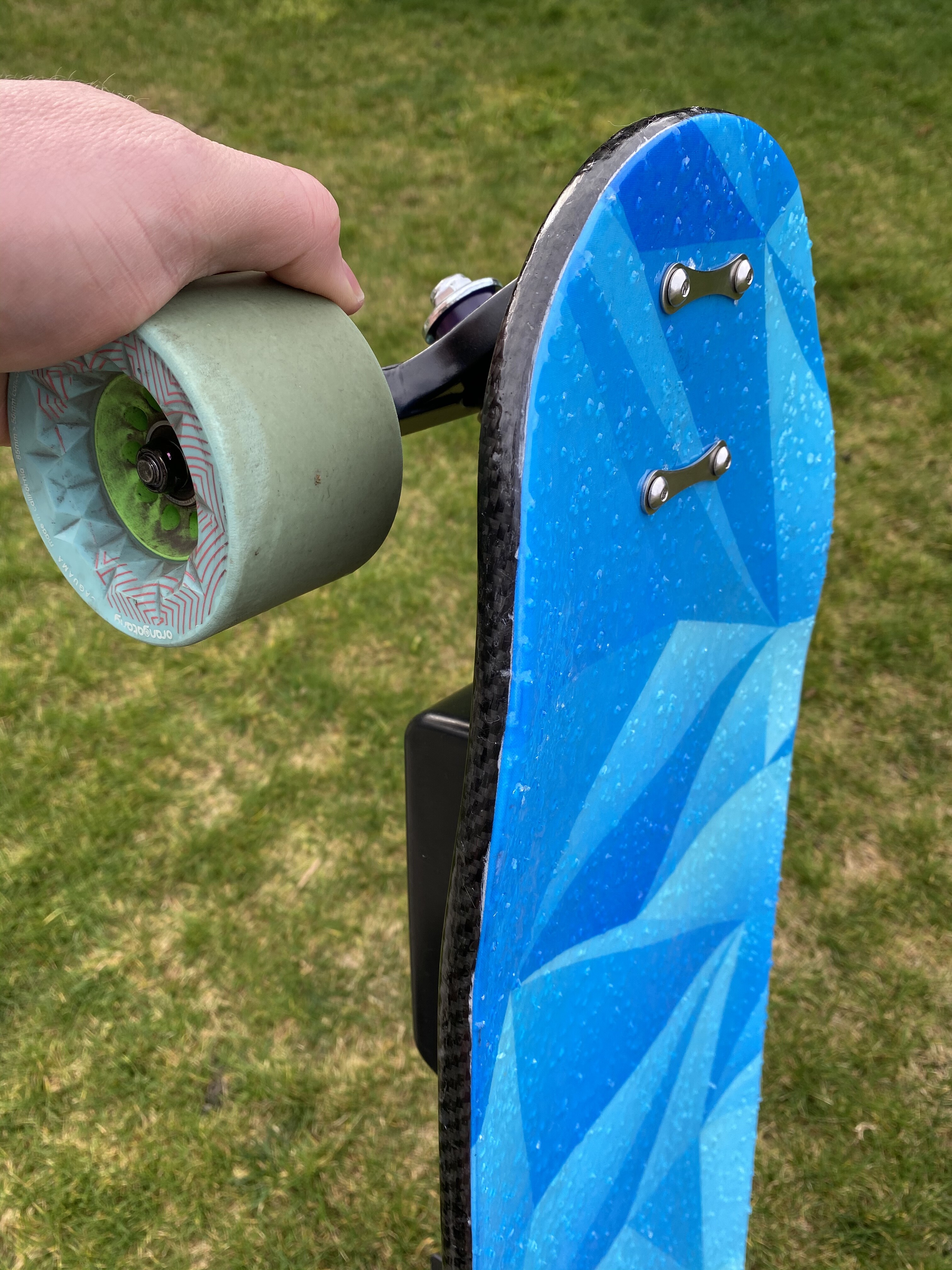

Edit - gonna need some long axles to avoid wheel bite on a kick tail deck.
