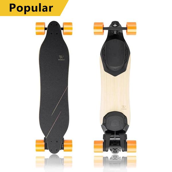

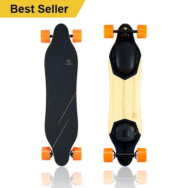

Last but not least the Wowogo 3/3x (8Ah)
The wowgo is arguably the most basic board here.
It is a booted clone like all other boards above and it has no special features. But it has very nice Paris trucks though! Acceleration, top speed, range and price are again comparable to the others, while the belt version is a little bit more expensive but on par with Backfire. The deck is again very flexy and you’ll get all the basic features.
