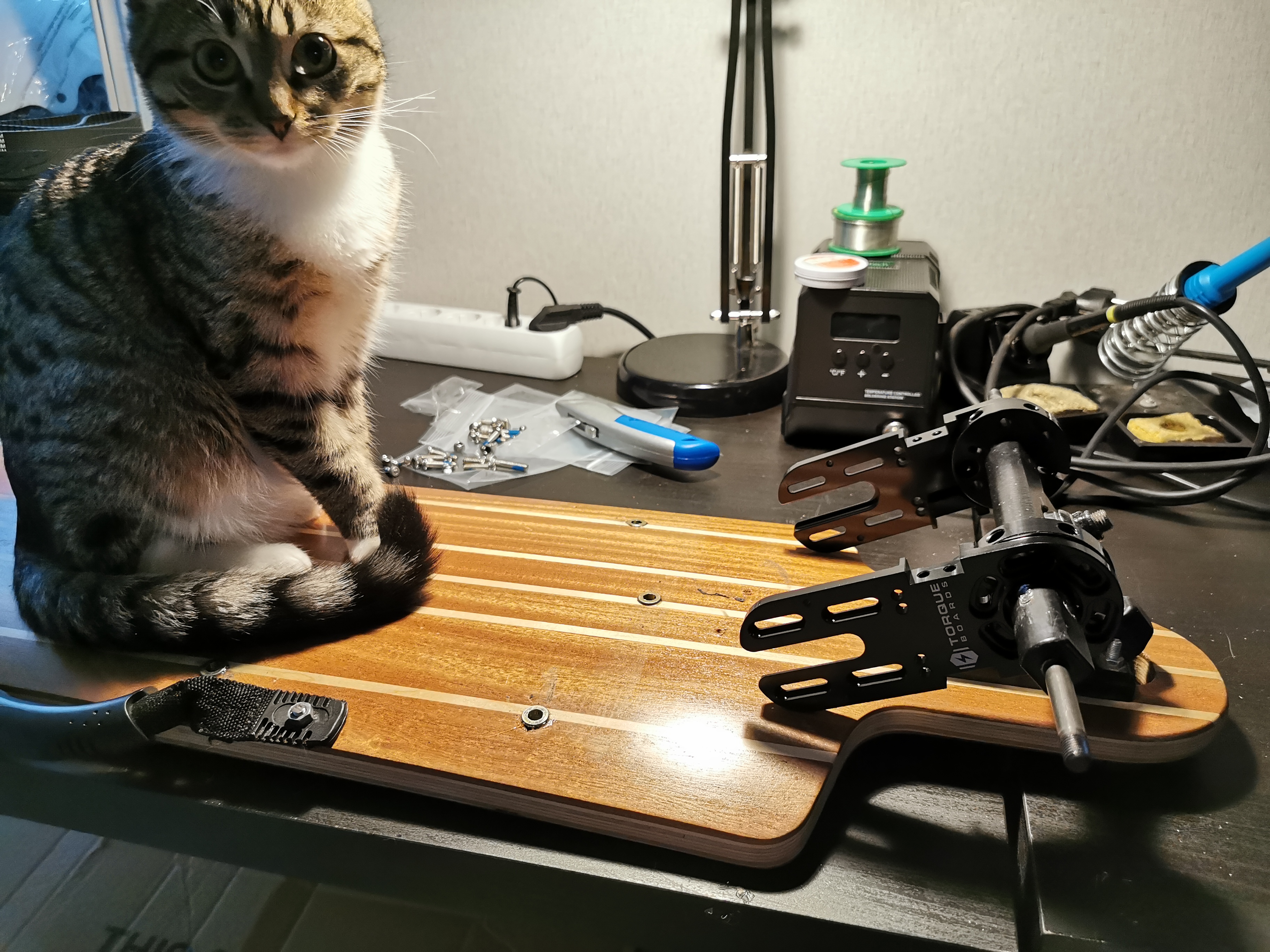

Rebuilding the board to TB all terrain
Looking goooood. One of your drive wheels is on backwards though.
Was this guy running on thane before the upgrade?
Wich wheel is mounted wrong?
Motors and motor mounts are brand new but yeah it was running thane before :slight_smile:
the point of the v on a tire tread should be the first part that touches the ground – that way it pushes water etc to the outside.
so from your photo the left one when the board is belly up is backwards
Fixed it :slight_smile:
