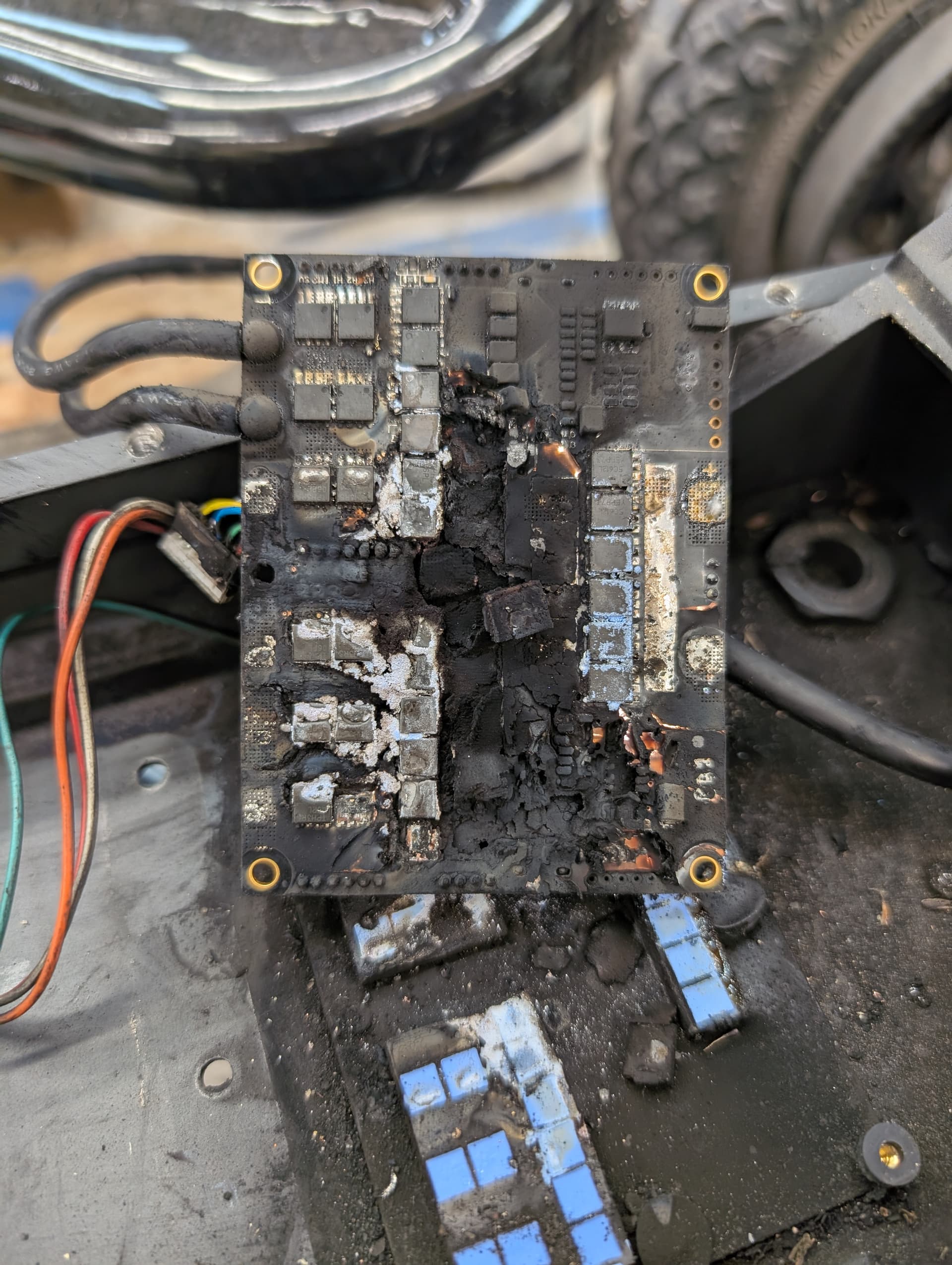

The ride started out fine, the trails are suffering from mid summer rocks and roots but nothing unusual. About 2/3rds through the loop I went over a piece of wood and started down a hill when the board stopped responding to the throttle and started making a humming noise. I stepped off of it and it started to back up, then copious amounts of magic smoke.

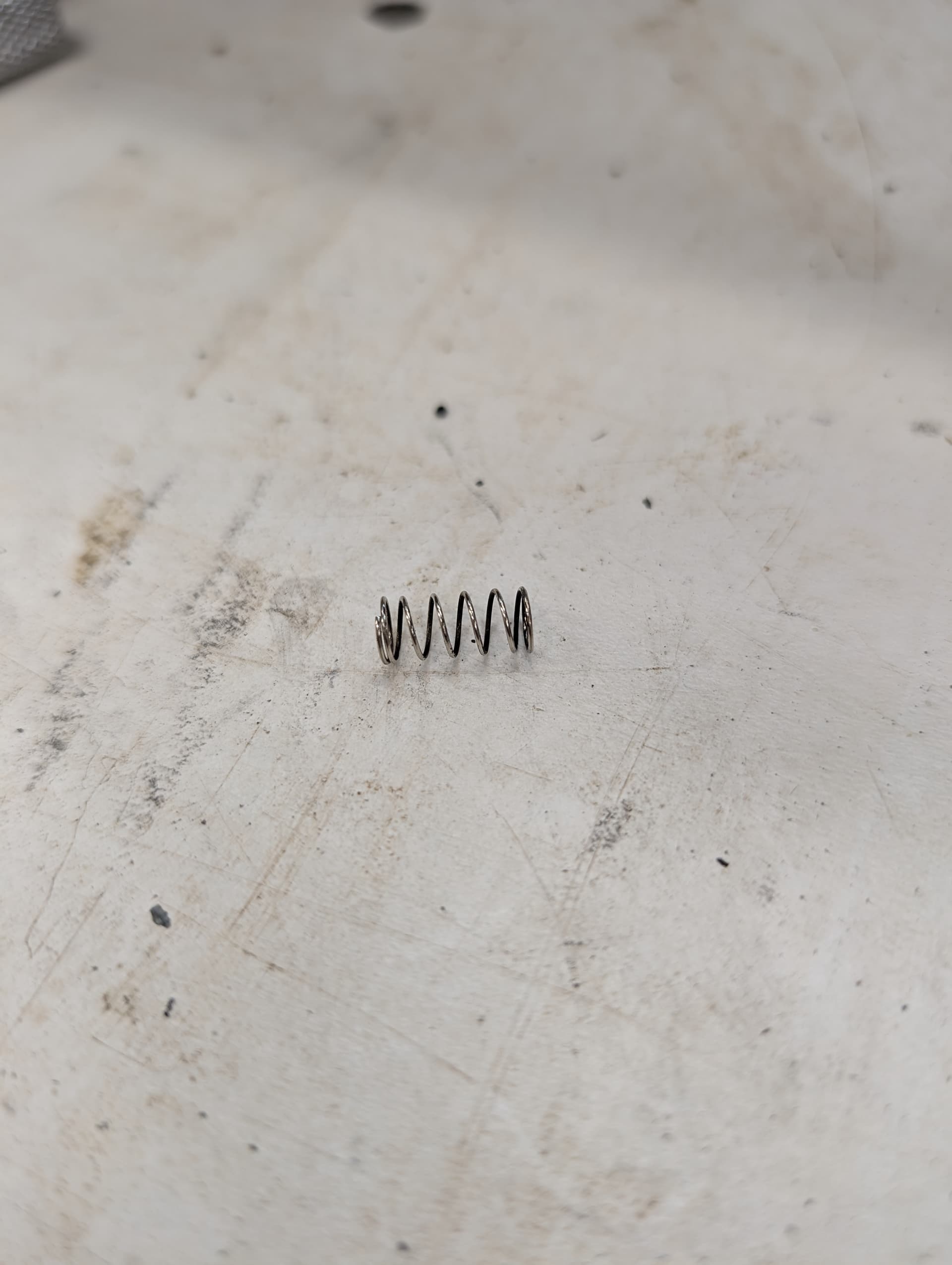

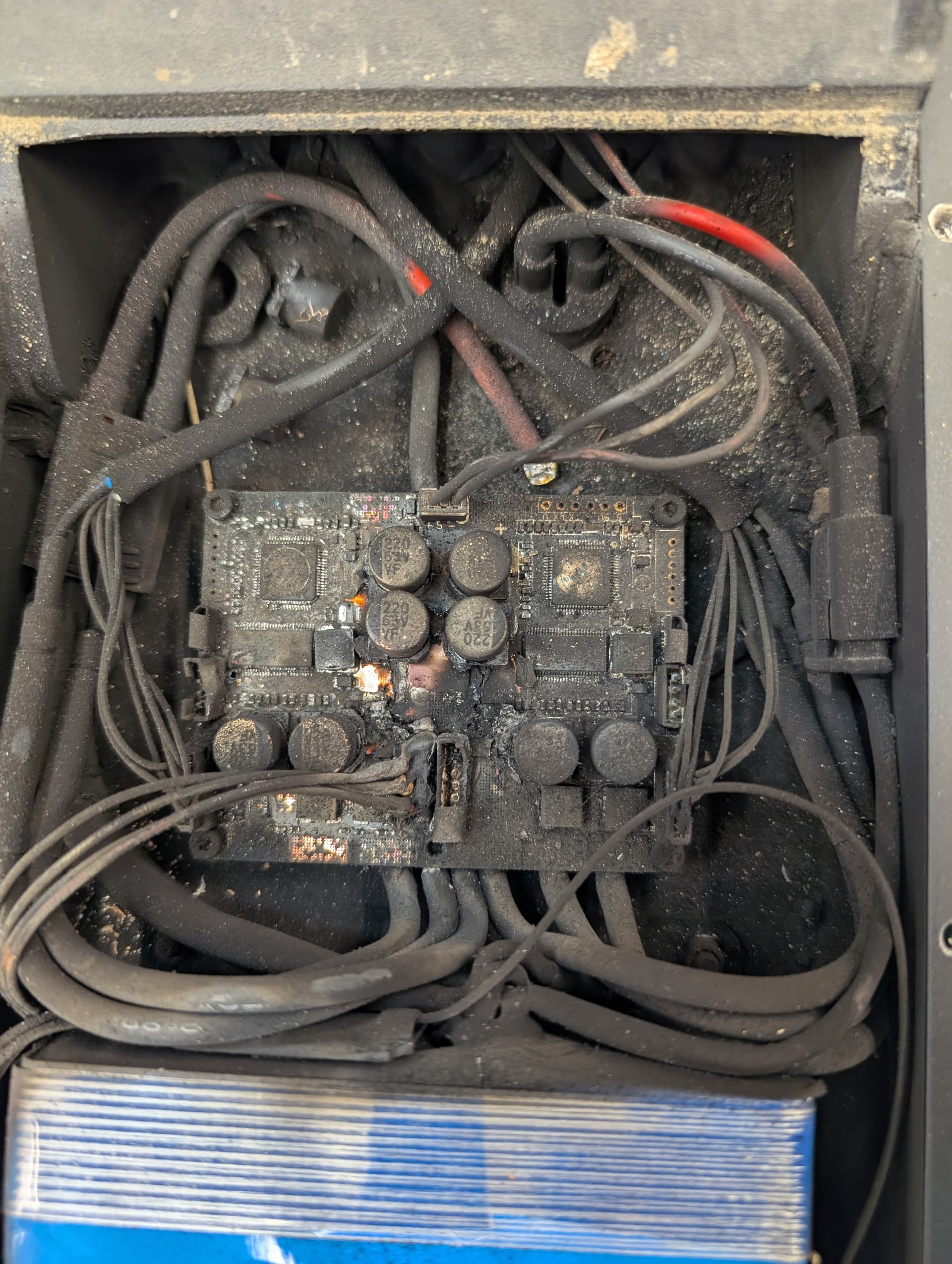

So you know what the first thing I noticed on this is? There’s no cover plate over the ESC board. All the aftermarket boards (save for the Flipsky maybe) have a cover over the top and a heat sink on the bottom. So no bits of metal could possibly short out a component of the board.
You know what the second thing I noticed was?
This:
Which was just floating around in the battery box. So far as I know this spring has no place on this board - the only (small) springs I’m aware of are on the outside of the box near the bushings.
So theory 1 is that this spring shorted the wrong thing at the wrong time. Presumably it’s been bouncing around in there since I got the board (possibly since the board was manufactured) so I guess I’m lucky that it lasted as long as it did.
Propel! If you’re listening, put a cover over your PCB’s!!! Also, Propel, if you’re listening, send me a new Endeavor. Without the spring this time.
The last thing I noticed is that on that board absolutely no component went undestroyed. Like everything that could have burned burned.

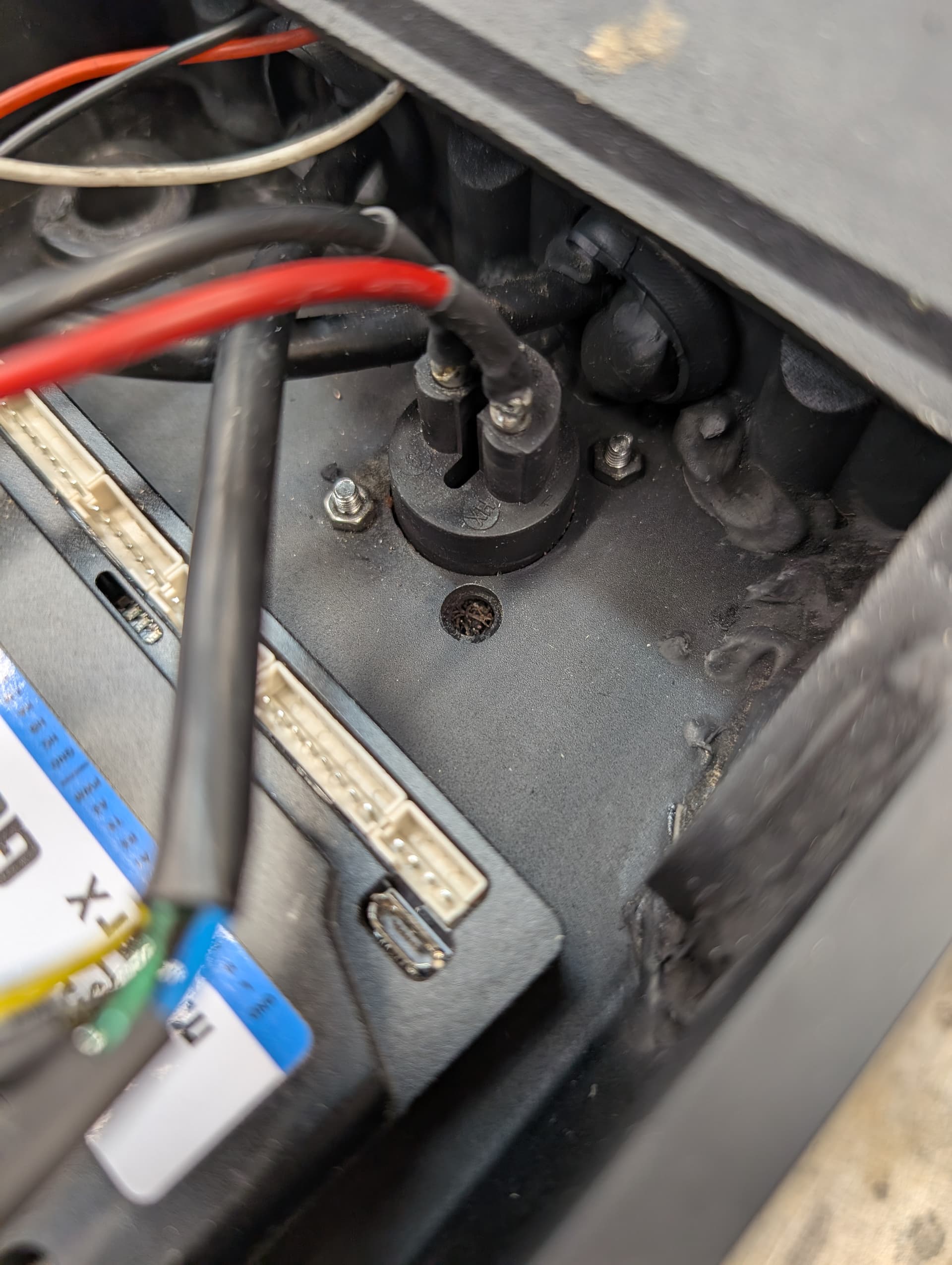

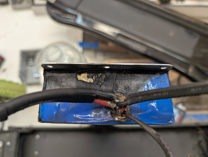

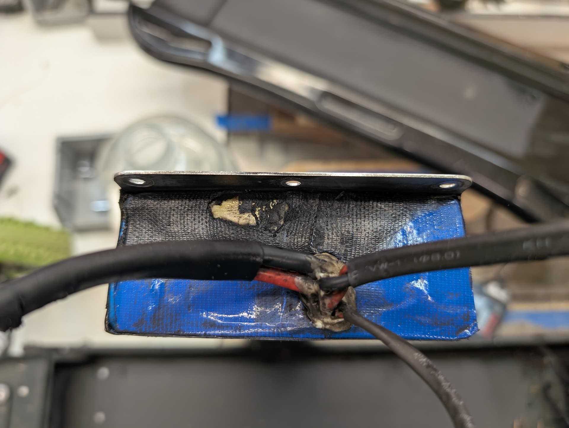

On the upside the battery pack took minimal damage, and both battery wires de-soldered themselves from the PCB (which makes them a “fuse” based on the melting temperature of solder) so probably the pack is still good. I’m going to leave it in quarantine for 3 weeks then test it.

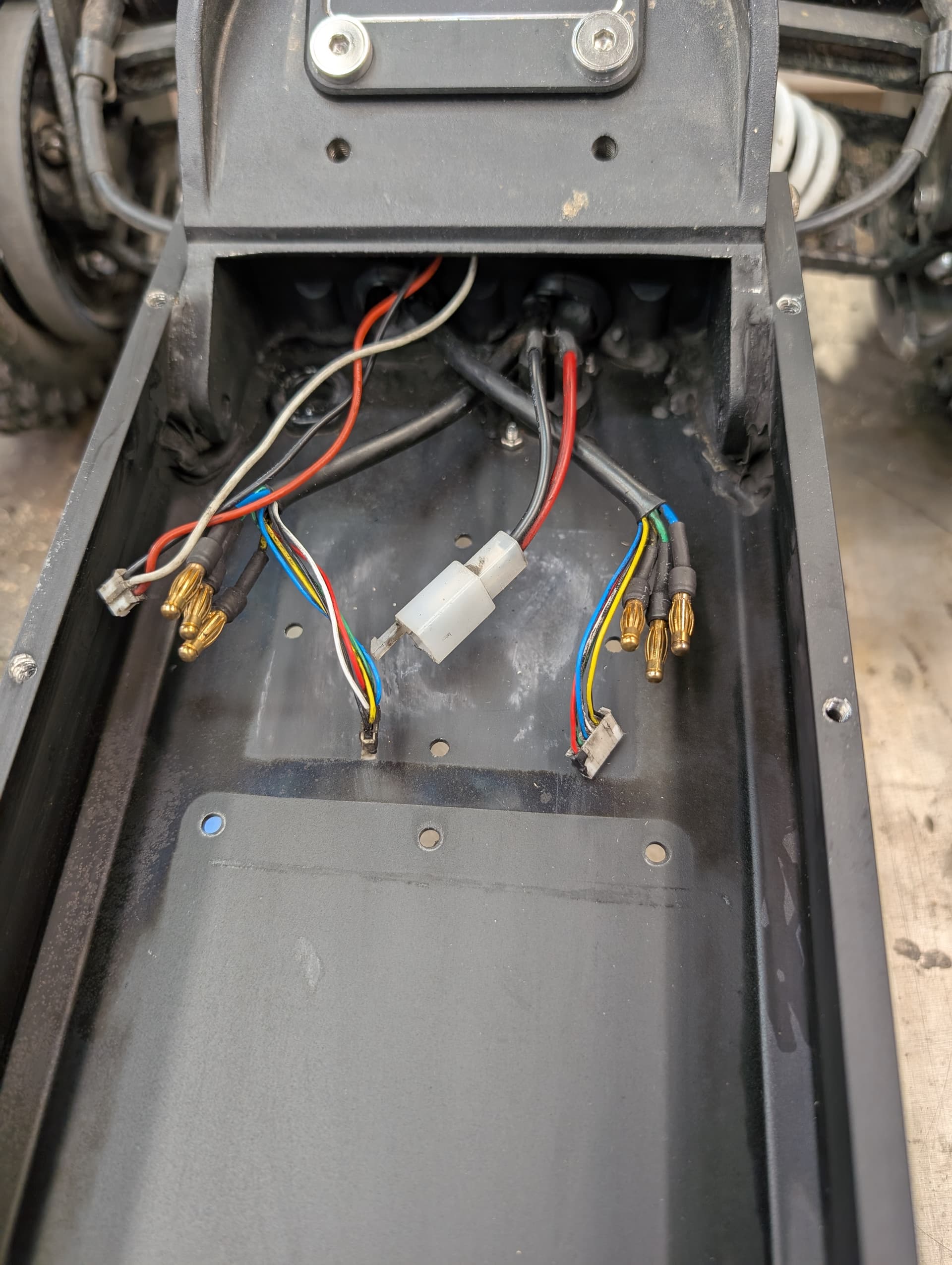

After that the housing cleaned up reasonably well and I haven’t really test fit yet but I think I can fit the makerX in there.
The motor wires look intact and the sensor loom cleanly disconnected from the board but I’ll have to bench test them.

Also, I know where the spring came from. These boards have little twist covers over the charge port which is on the bottom of the board. The cover has a spring in it that causes it to lock in place when you close it after a charge.
So when the cover gets snapped off by a root or whatever I happen to hit the spring is left on the inside of the board unfettered from its tether and free to wreak all manner of havoc.
Here’s the hole where the spring used to be part of the assembly
I guess that’s the law of unintended consequences in action.

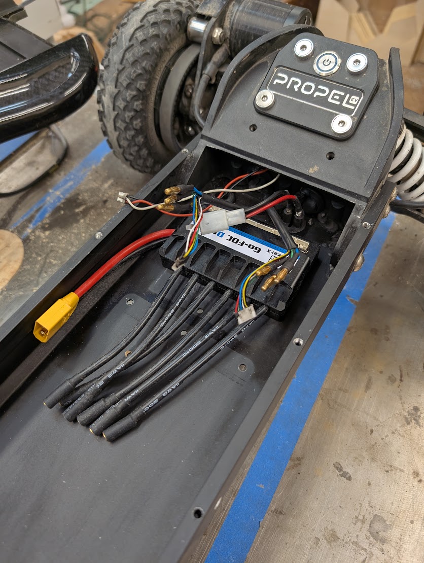

Ok, so despite my rather packed schedule I’ve begun working on rebuilding this board.

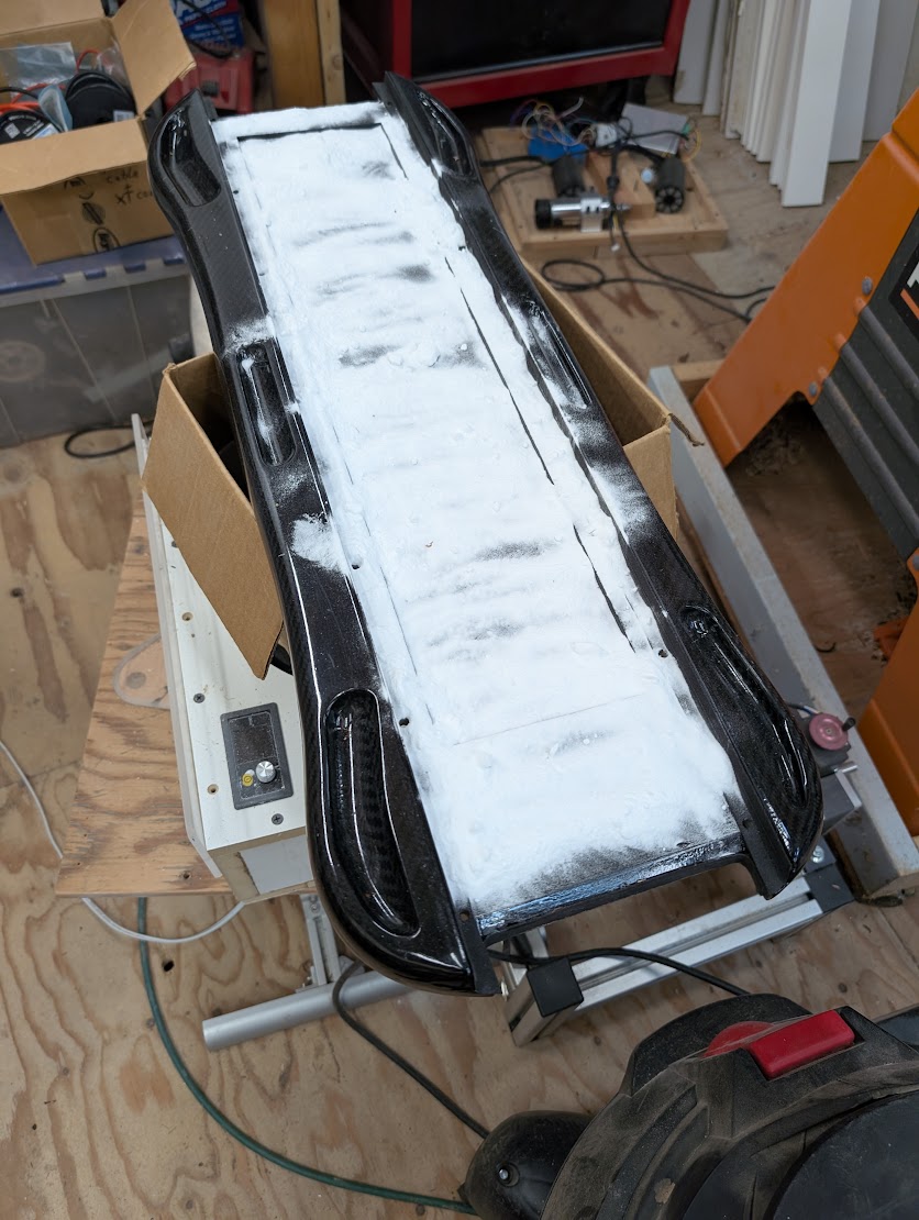

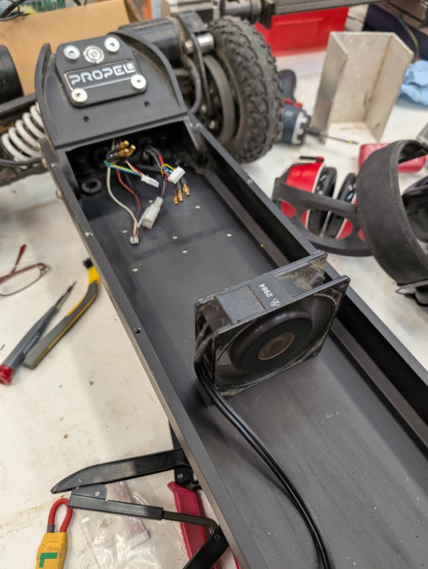

First, to get the smell out I cleaned all the surfaces with soapy water, then rubbing alcohol. After a little Googling I decided on 2 more steps. First, baking soda and second a small fan pointed at the smelliest areas. My theory being that if odor is particulate I can speed up the degradation process by moving more air over it.

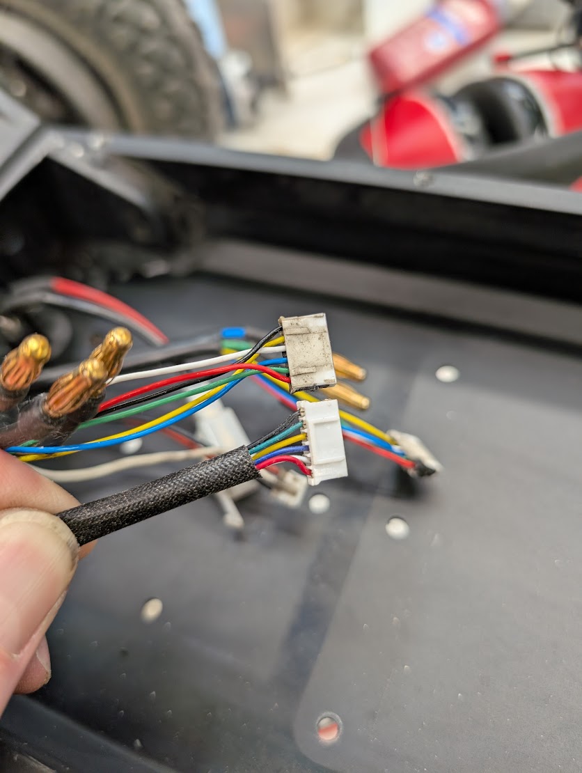

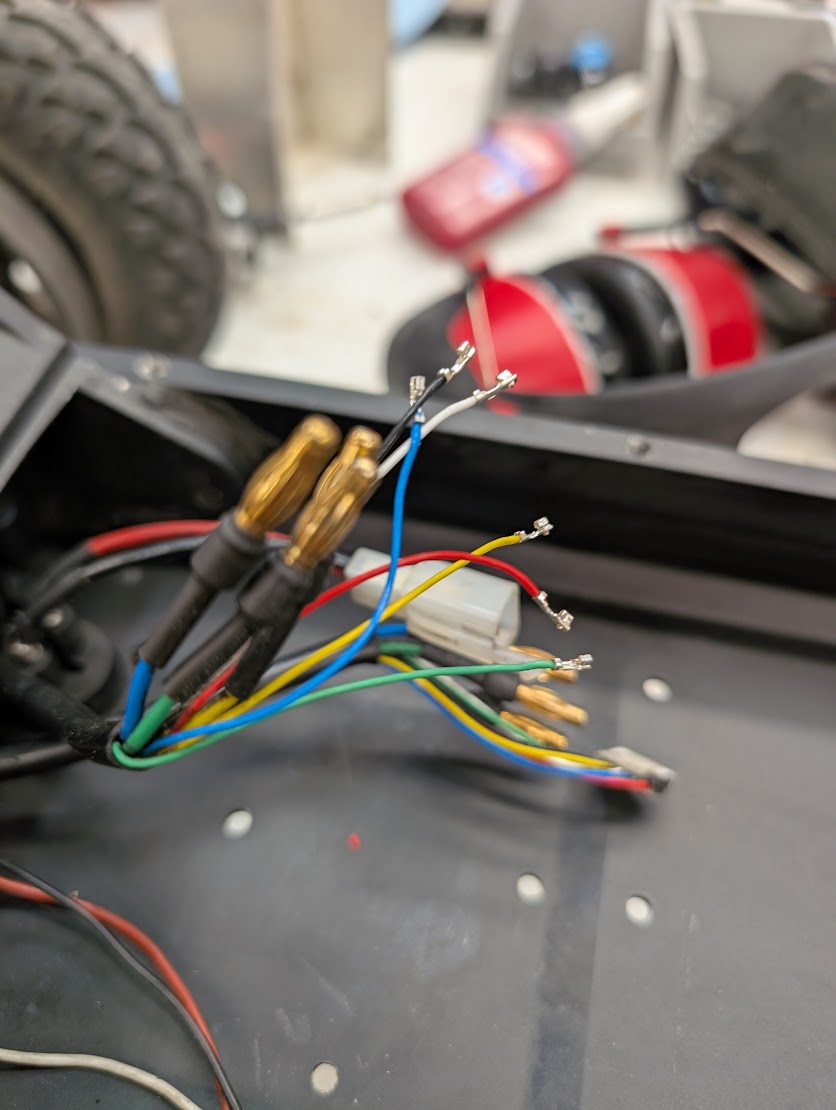

Next, I inspected all the wires and they seemed intact, so to get to the MakerX I had to swap motor sensor connectors. They didn’t color match, but I made the possibly wrong assumption that they position matched between the original board which was a Flipsky Dual FSESC 4.2. and the MakerX.
Then I found out that I have zero motor connectors in stock, so I ordered some of those, an anti-spark and a Bluetooth module which should arrive today.
I don’t know if the motor sensors are still electrically operational after the big flameout but I’m hoping they are. I guess I’ll know when I power the thing up.
Someone (probably me) should make a little handheld motor sensor tester. I actually made a very similar device for work a long time ago that I could pretty easily modify… It was called “The Tick” and it told me the number of ticks away from index the rotor was in. So it already understands halls. Might just be a matter of swapping the connector and rewriting the logic.
But of course that won’t happen if the motors work :slight_smile:
I still haven’t solved the RF problem, but I’m wondering if the “P” in the middle of the board is plastic and if there’s CF underneath it. If so (and not) then I could position the Hoyt and BT receivers there.
The other problem is that with the Hoyt remote I have no data on battery level. I’m still noodling on that one.

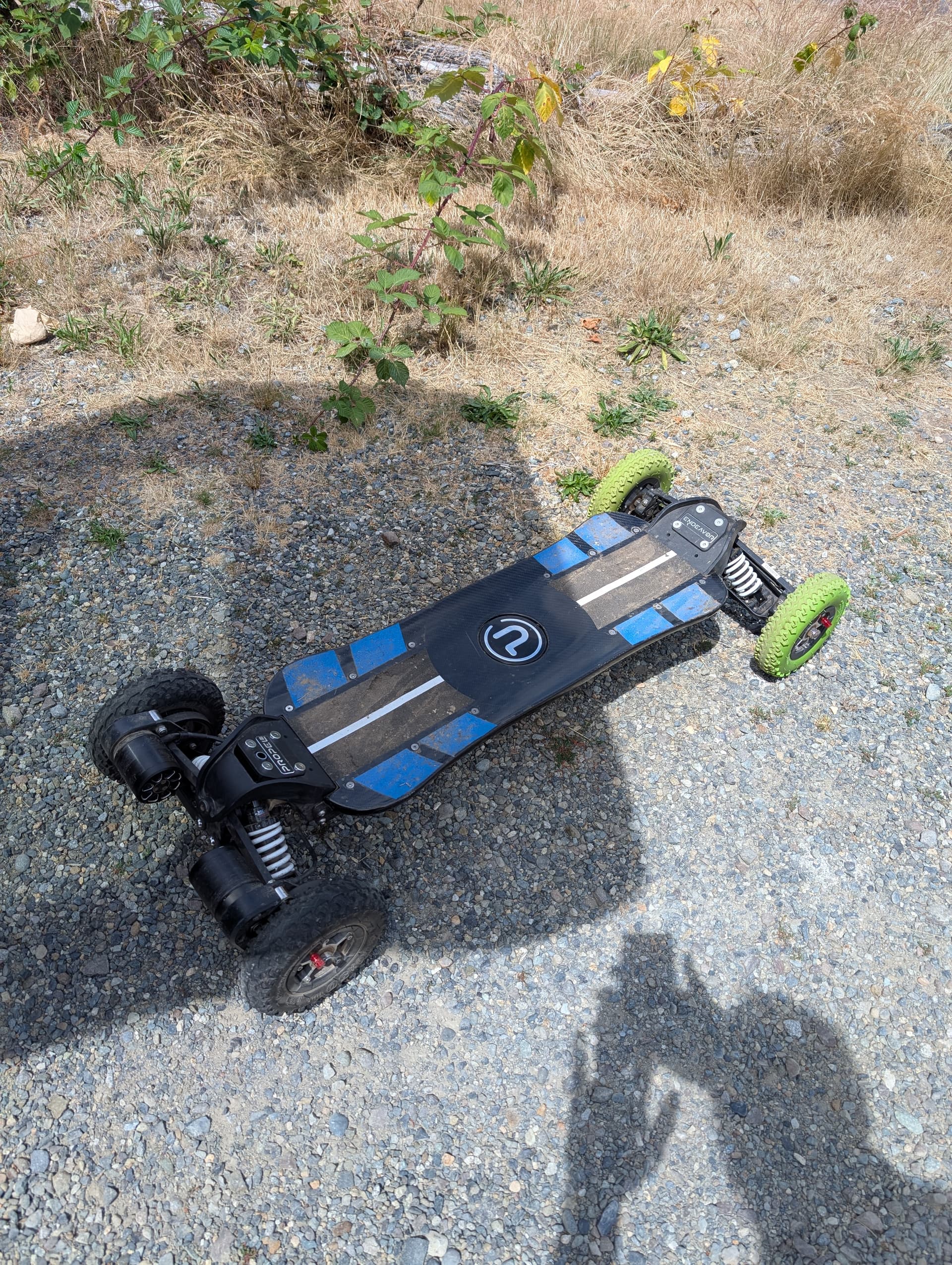

Success! Took it out on a nice hilly gravelly route and it ran perfectly. I started at 60 battery amps and 36.5 motor amps, then upped the motor amps to 46.5 and the battery amps to 70. I think there’s still some headroom available because it seems like it isn’t as powerful as the original driver, but I need to check the numbers for how Propel configures their ESC’s.
(does anyone actually know what the Propel factory ESC settings are? My Google fu failed me on this one)
anyway here are the stats:
test miles: 6.5
fires: 0
magic smoke: None
bloody knees: 0
sudden inexplicable disconnects: 0
times flung off the front of the board: 0
times flung off the back of the board: 0
