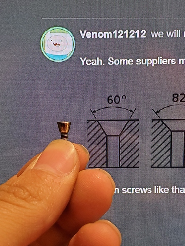

When @Penny_Pincher sent the hub motors to me, I knew that they ran fine, but I wasn’t aware that they would be coming without sleeves, etc. Anyway, no hard feelings. I am in the process of trying to source the screws that hold the sleeves onto the hub motors, and Landwheel did it an interesting way. They used these conical screws that create a press-fit-friction-lock sort of mechanical connection between the hub and the sleeve.
By using this process it secures the sleeve in both the radial and axial directions - pretty smart, and probably why I have never had an issue with flapping noise or slipping.
I need to find these screws below: I tried searching around for them on Google but I wasn’t able to find anything that resembled them, nor do I know the technical term for these screws - weird considering my major but it does happen.

They are torx T10 head screws, their diameter appears to be 0.21" and then 0.47" in length. Hard to exactly tell pitch but it was approx 7 or 8 threads / 0.1", so that would make it about 80 threads/in

Here’s some more data:
Below, the calipers are open to exactly 1mm.
They’re called trim head bolts but they come in lots of pitches so finding the exact one will be tricky.

Yeah. Some suppliers make 60° flat head bolts (standard countersunk bolts are 82° or 90° usually)
600px-Countersunk_holes.svg
I’ve seen screws like that exactly once before and it was in our schools lathes.
Yah but even 60 degrees doesn’t quite match up either, this looks more like 75
I was thinking the other direction, like 40-45° personally
Look at this scientifically accurate proof though
… proving you correct lol
