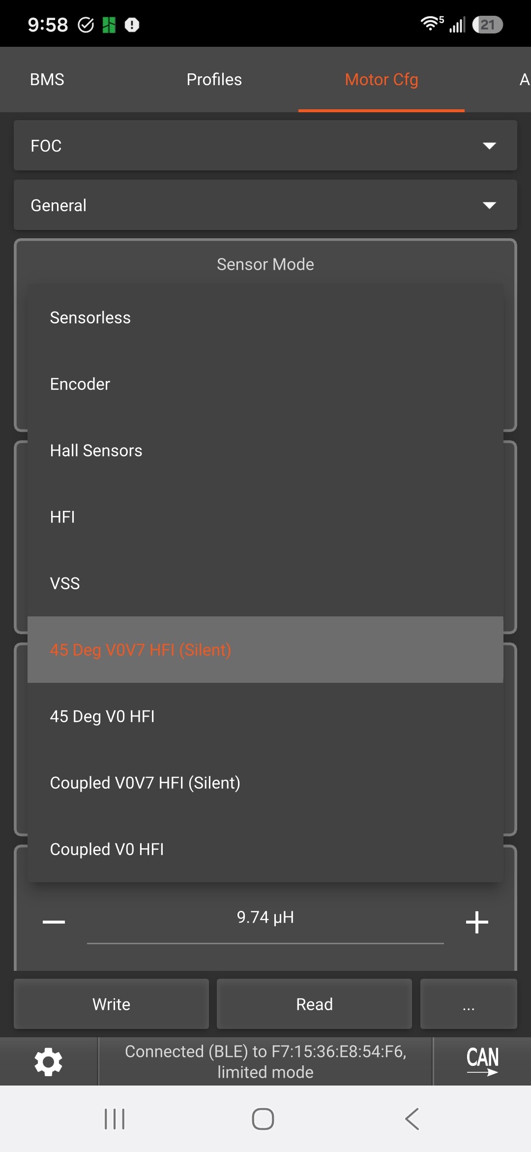

@Juniorsilva2 i just tried this silent hfi and it may be pretty decent.
If you try again at least twenty times, it might randomly work. This is literally the story of my life with VESC tool.
I busted a sensor in one of the motors on my mach and switched it over to one of the sensorless modes.. there was enough sensorless options in vesc tool to find one that just worked well with my motor without tweaking anything.
the motor makes a very slight noise now when starting from a stop, but apart from that it’s good as gold
You guys encouraged me, I had even already swapped the motors for two flip skis I had here, but the difference in quality between the reacher and the flip ski is quite large. I’ll try using the HFi and see how it works.
