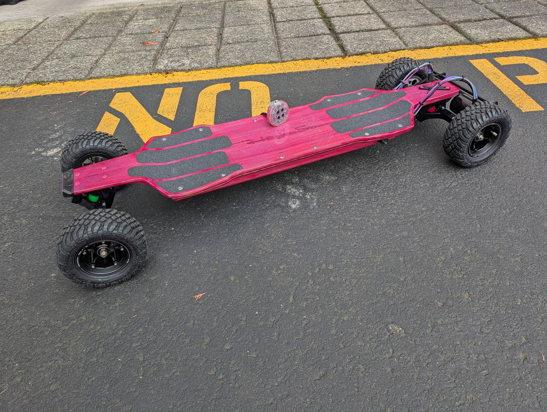

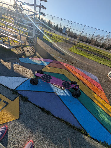

Alright folks, it’s time to officially introduce my latest build: Raspberry Riot.
This one came together equal parts necessity, inspiration, and questionable self-control around doughnuts.
:strawberry: The Namesake
Raspberry Riot gets her name for two very important reasons:
  • She’s unapologetically pink
  • She was built while absolutely housing Mighty-O’s Raspberry Riot doughnuts during the PNW Esk8 Build Day – 2025 Holiday Build
    Sugar-fueled creativity is real.

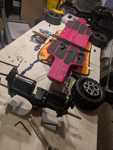

:brain: Conception & Design Philosophy
This build was born out of destruction.
I had just snapped the deck on Chocolate Dad Bod (now reborn as Purple Unicorn :unicorn:). While ordering a replacement Dadbod Duo deck, I discovered that Hoyt had already shut the doors, and sitting there on the site was a Cascade Duo just begging to be adopted.
So naturally… I snagged it.
That’s when the idea hit:
If Purple Unicorn exists, she needs a sister board.
Color logic:
Purple Unicorn already owns purple :purple_heart:
I love pink, purple, and black
Therefore… pink :pink_heart: + sparkles :sparkles: + black :black_heart:
No compromise.

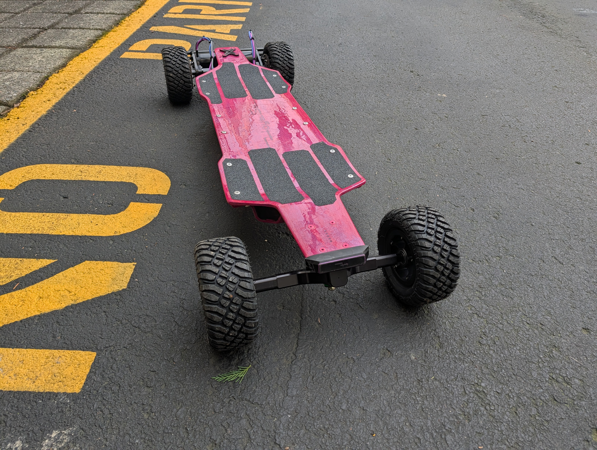

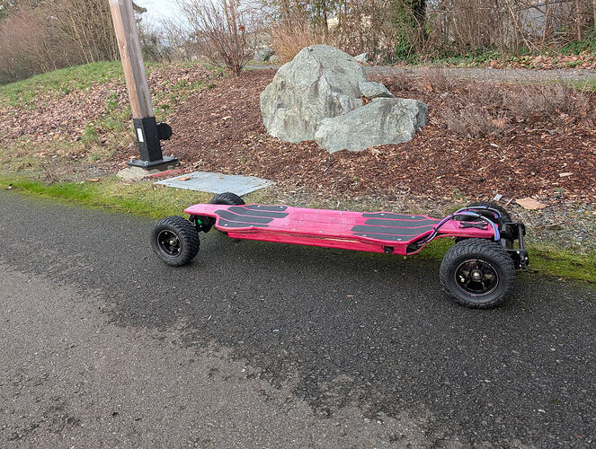

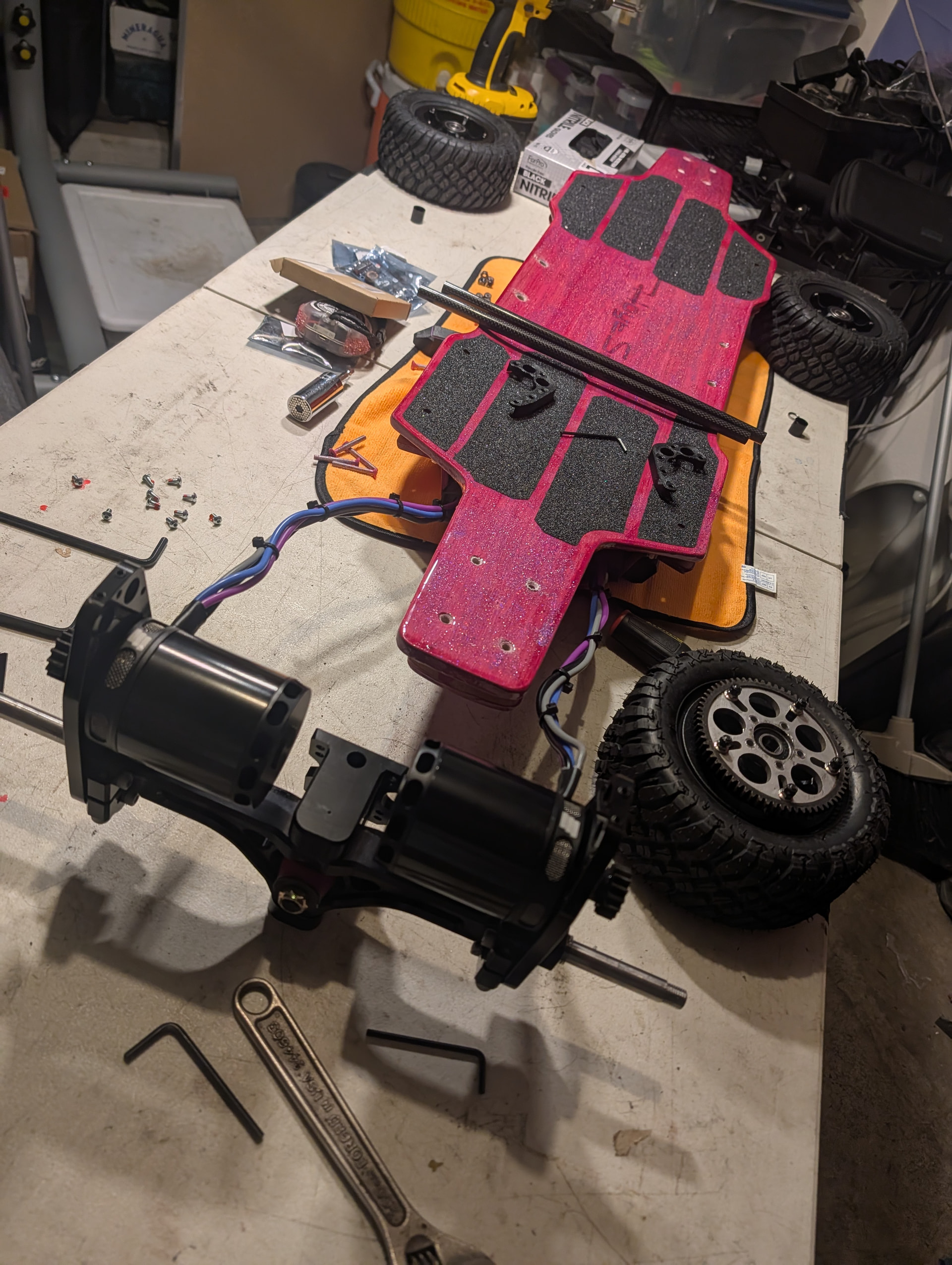

:skateboard: Deck
Hoyt Cascade Duo
Custom finished from raw to riot.
Process:
  • Removed factory grip tape
  • Alcohol scrub to eliminate all adhesive residue
  • Sanded with 220 grit
  • Stained using Pink Unicorn Spit
  • Sealed with Glaze Coat Ultra Clear + glitter for maximum sparkle :sparkles:
    Heat gun used to:
  • Pop bubbles
  • Improve flow and leveling
    Final sealing coat:
  • Ultra clear
    No glitter (lock it in clean)
  • Finish:
    High-gloss, pink, sparkly, and obnoxiously beautiful.

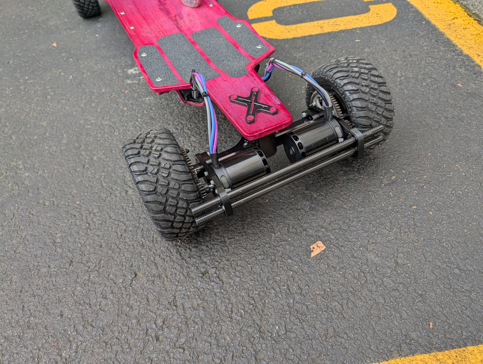

:wheel: Trucks
Duality Trucks
Honestly… just the logical choice.
If you know, you know.

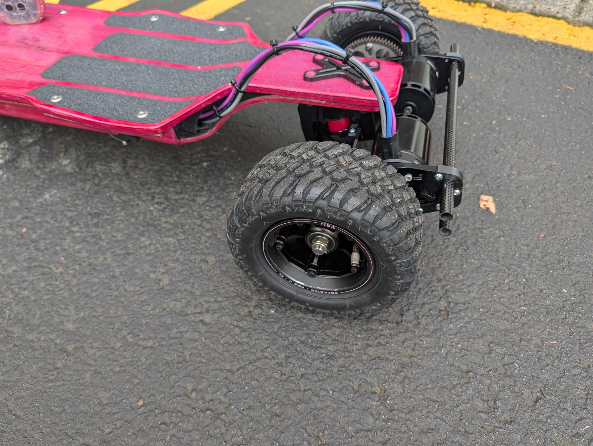

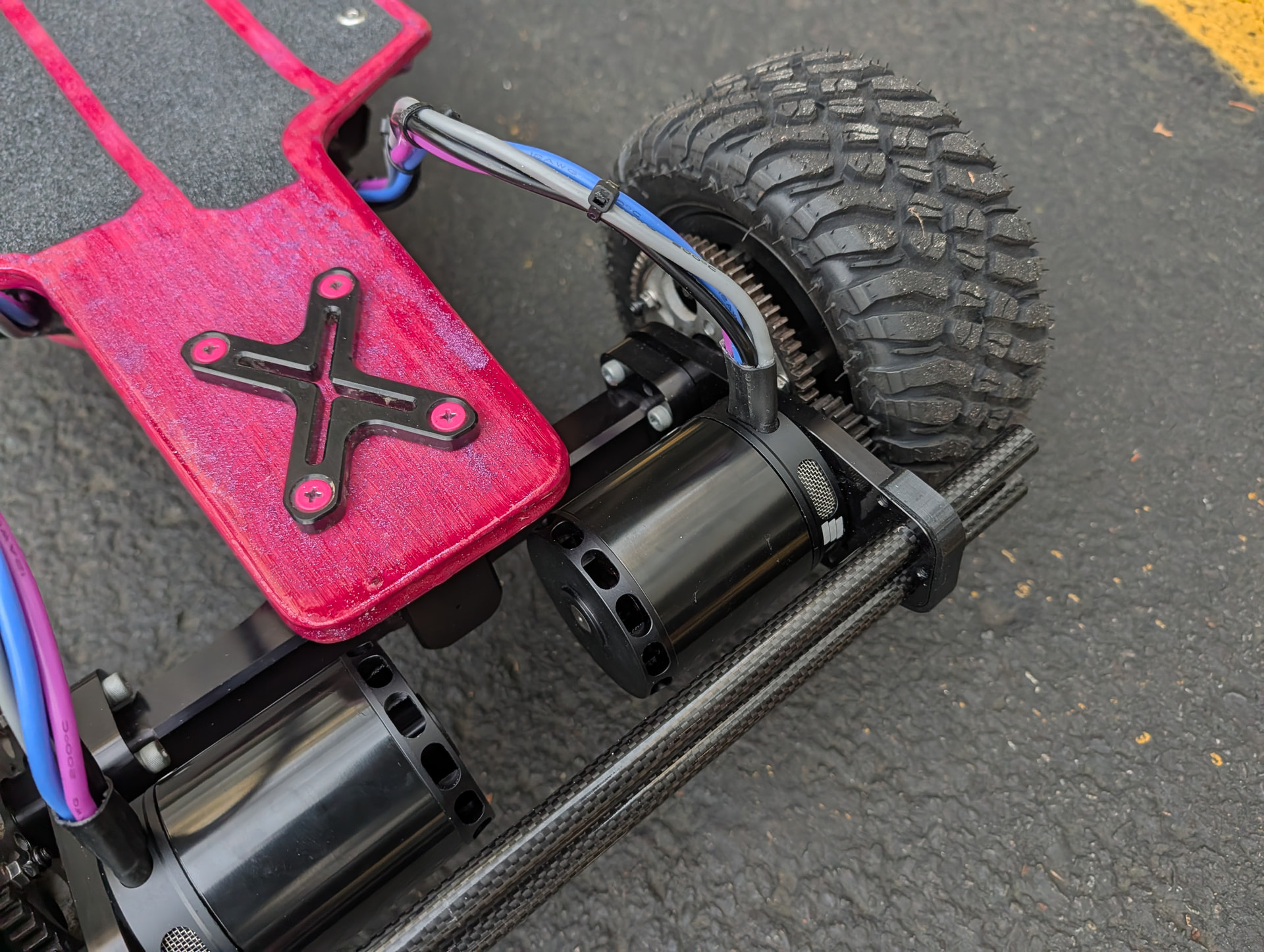

:gear: Wheels & Rolling Hardware
Tires:
  • MBS Explorer 8” (200x70)
    Rims:
  • MBS Rockstar Pro II XL
    Bearings:
  • Fast Eddy’s
    Drivetrain Hardware:
  • 20mm hex standoffs
  • 67T Stooge gears
  • Flanged M4 nuts
  • Vibratite VC-3
  • Additional M4 hardware throughout
    – Built to survive violence.

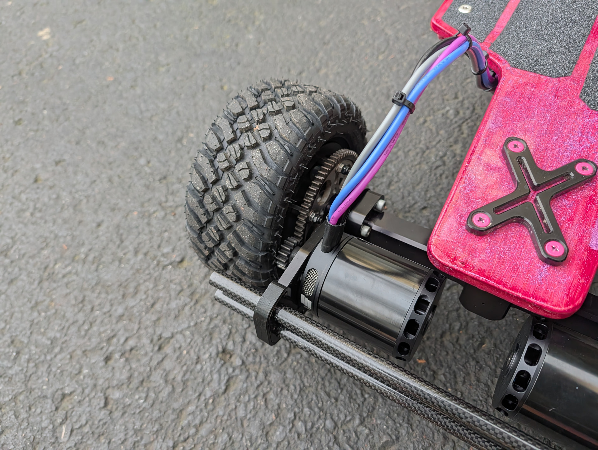

:speaker_high_volume: Drivetrain (aka The Noise Department)
  • Stooge 67/15T Open Gear Drive
    Because:
  • Open gears go REEEEEEEEEEEEEE
  • And that is objectively correct
:fire: Hot Take:
  • The world needs more open gears.
    I will not be taking questions.
:high_voltage: Motors
  • SKP 173kv
  • Plenty of torque, plenty of scream, zero regrets.

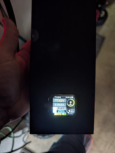

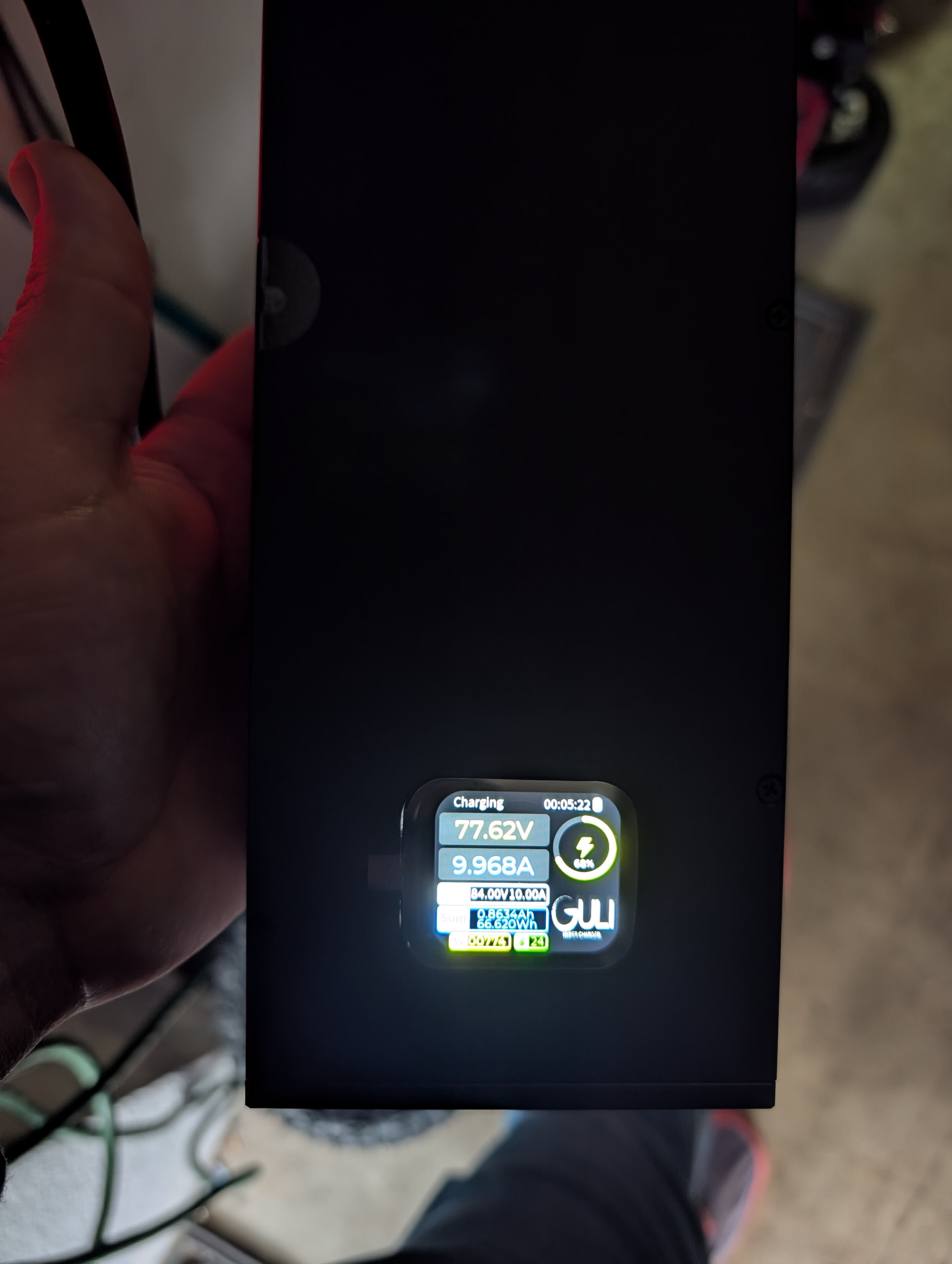

:battery: Battery & Charging
Battery Pack:
  • 20s5p Jackson Pack
  • ZBattery Solutions BMS
    Charger:
  • Guli Hyper Charger
  • Clean, reliable, and built for high voltage happiness.

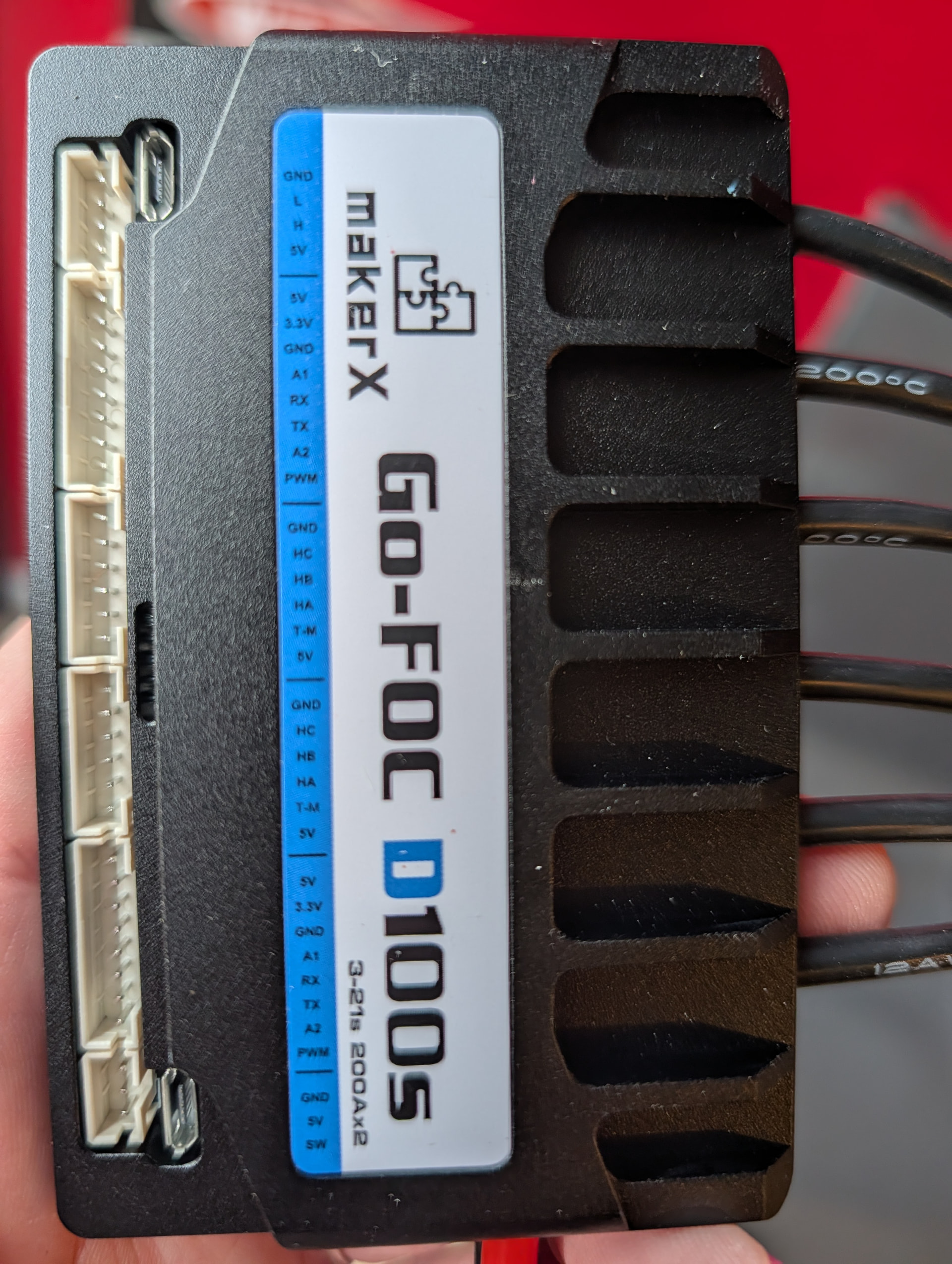

:brain: ESC & Control
ESC:
  • Maker D100s
  • Fully capable of handling 20s without breaking a sweat

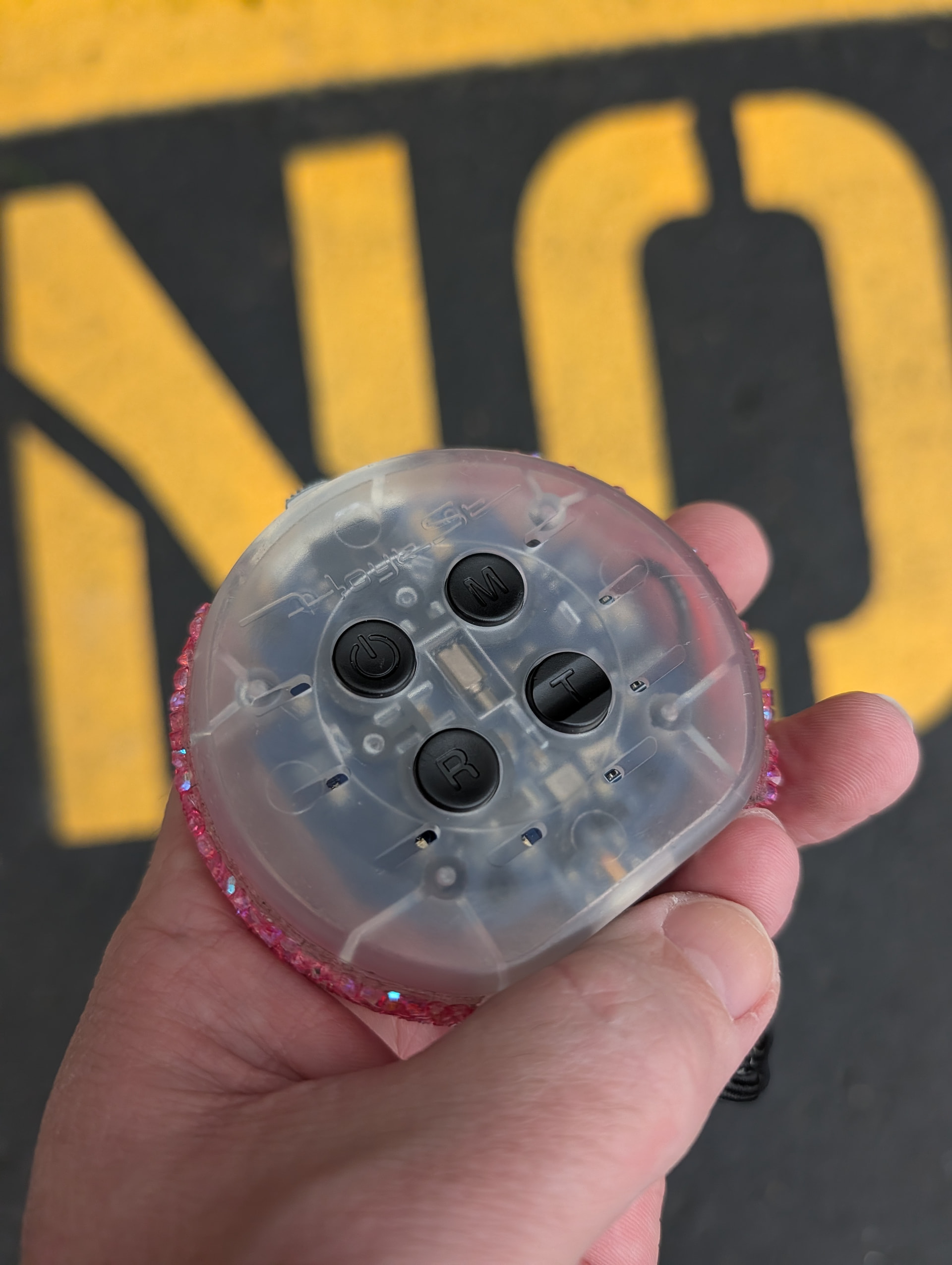

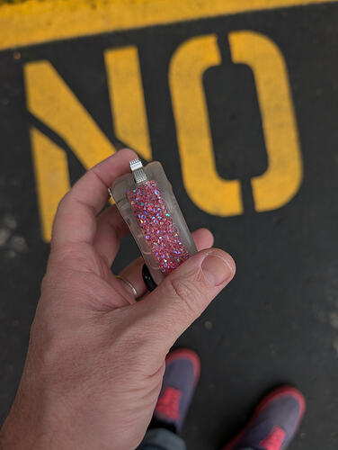

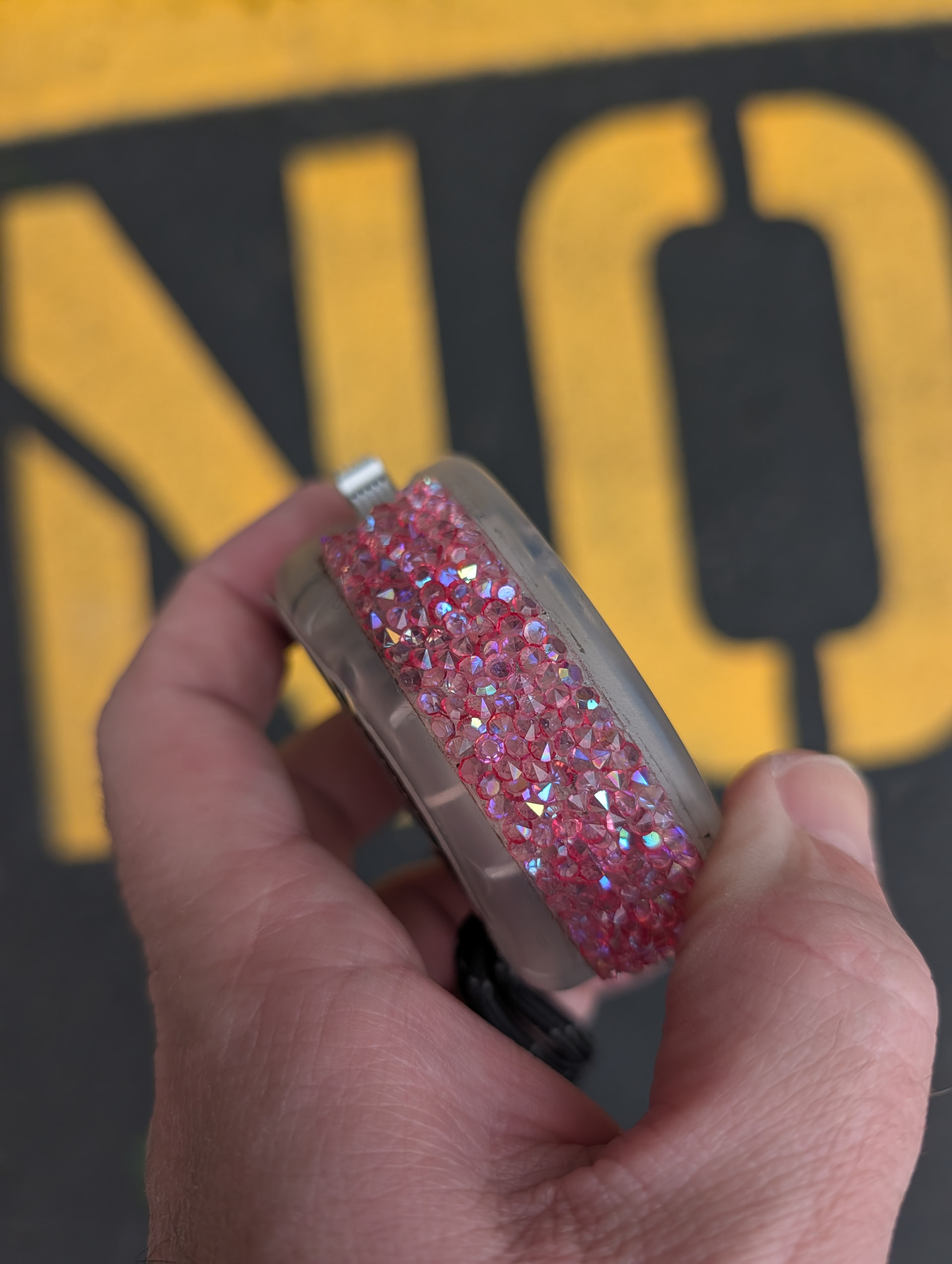

Controller:
  • Hoyt Puck
  • Ice puck shell
  • Pink sparkly grip (because aesthetics matter)

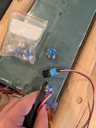

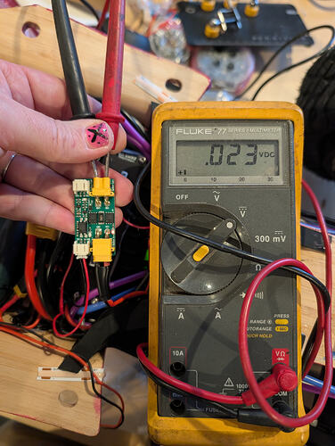

:electric_plug: Power Management
High Voltage Rail
  • Duck ASS
  • Full + switched HV rail
  • Integrated 5V buck output
    Low Voltage Rail
  • 75–100V to 5V converter
  • USB-C charge port
  • Pink underglow
  • RaceBox Micro power

:chequered_flag: Final Thoughts
Raspberry Riot is loud, flashy, pink, sparkly, high-voltage, and completely unapologetic.
She exists because:
  • A deck broke
  • Hoyt closed
  • Doughnuts were eaten
  • And restraint was nowhere to be found
This is a sister board built with intention, excess, and a whole lot of personality.
Thanks to everyone at PNW Esk8 Build Day 2025 for the vibes, inspiration, and enabling behavior.
Ride loud. Ride pink.
:strawberry::high_voltage::skateboard:

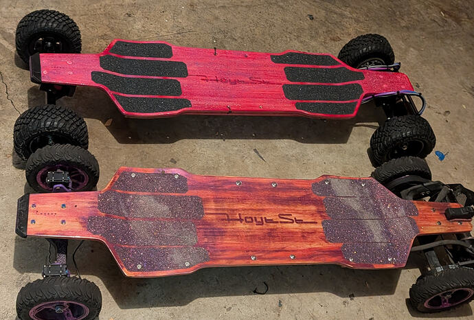

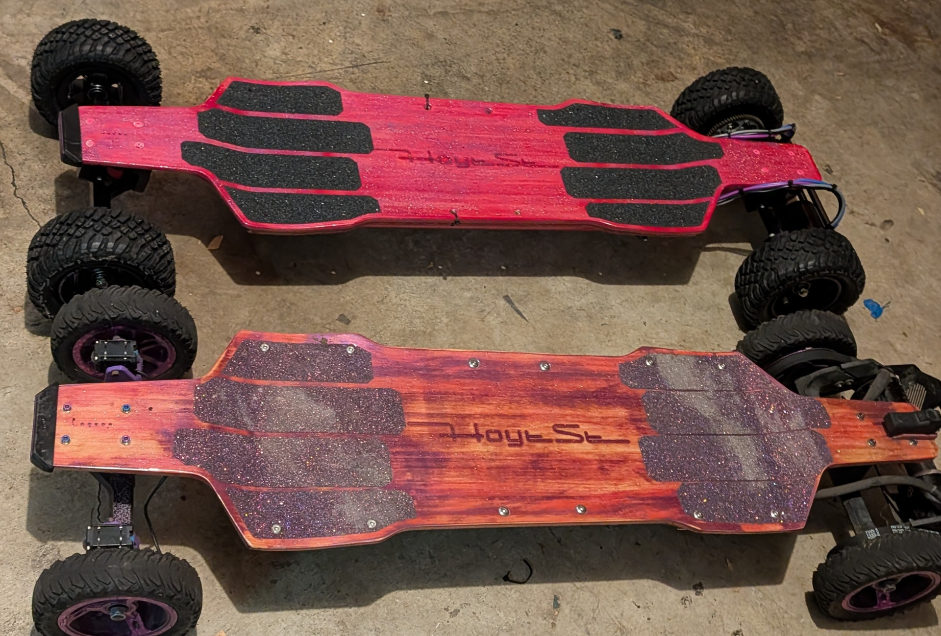

For comparison:
Top: Raspberry Riot :pink_heart::sparkles:
20s5p
Bottom: Purple Unicorn :purple_heart: :unicorn:
16s9p

https://a.aliexpress.com/_mK0PjN3
I think those are the ones. I bought a bunch earlier in the year and have been using them on the dad bod because they run off of the direct battery voltage

Do you worry about tripping on the phase wires at all? I feel like I would end up catching my foot on them somehow.
