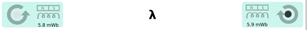

What’s up with your hall sensors? I would load the latest unity fw and redo all settings + motor detection.
Done. I uploaded the new motor test
Ahh I don’t think your hall sensors are working. I think that detection went sensor less.
I would check mechanical connections first.
No idea where to find the cables for that in the board.
I think this only noticable with a slow start up. Sometimes the right wheel doesn’t want to spin when I dont kick.
What I don’t understand is this setting. What does it mean when there is a black cycle or white cycle? By default motor 1 has white and motor 2 has black.
Just reverses the motor. Nothing to bother with, swap any 2 phase wires and it reverses.
Okay, thanks! Back to my main issue. I don’t think the defect hall sensor are the issue for that? Any other ideas what I could do?
I would open it up and unplug the sensors, I wonder if they may be causing issues plugged in but not functional. Then check the fuse connections and connectors just in case.
