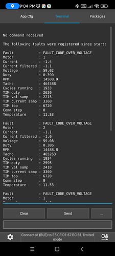

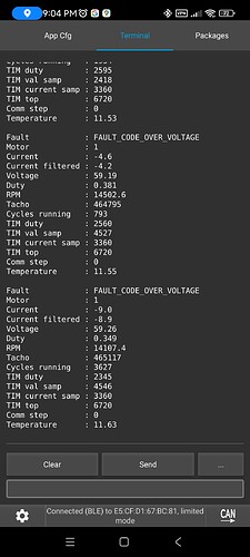

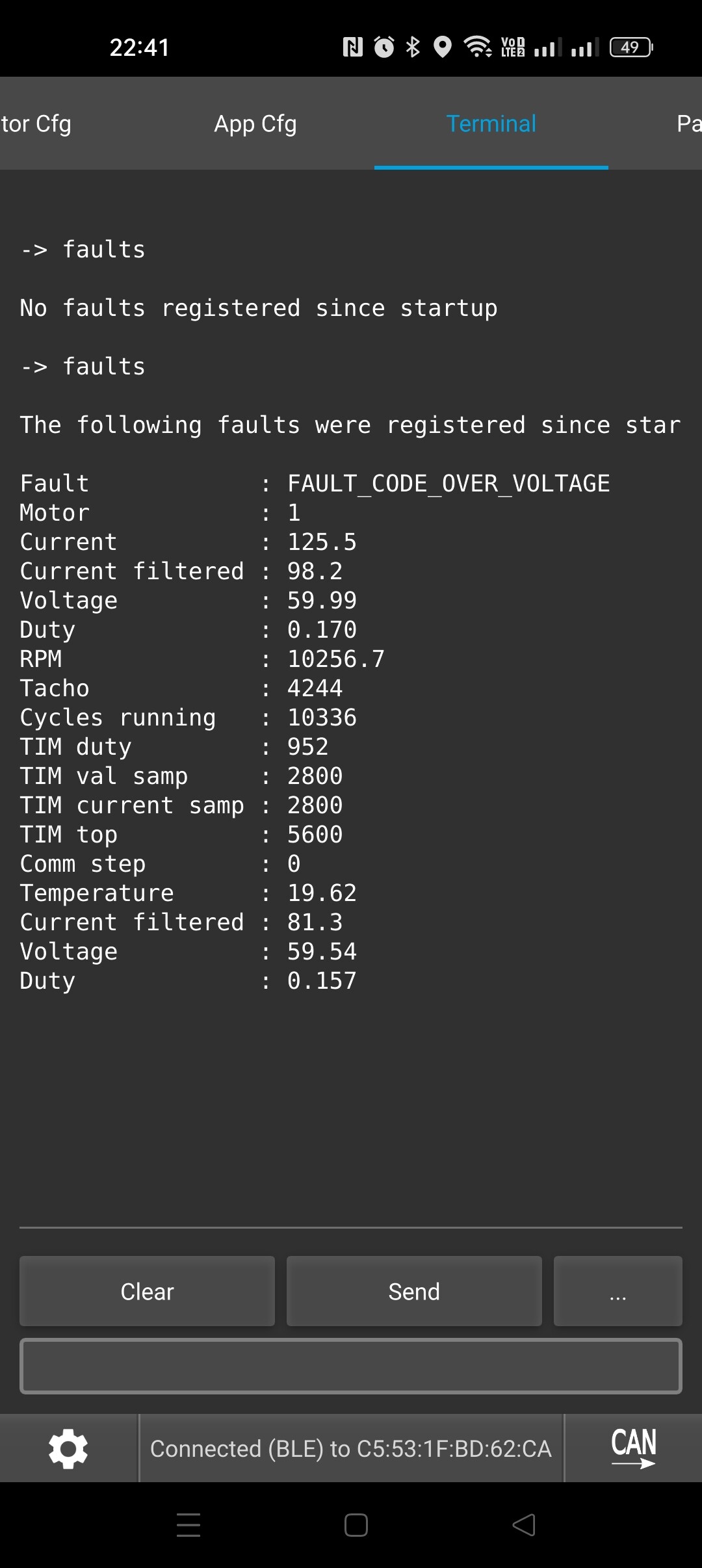

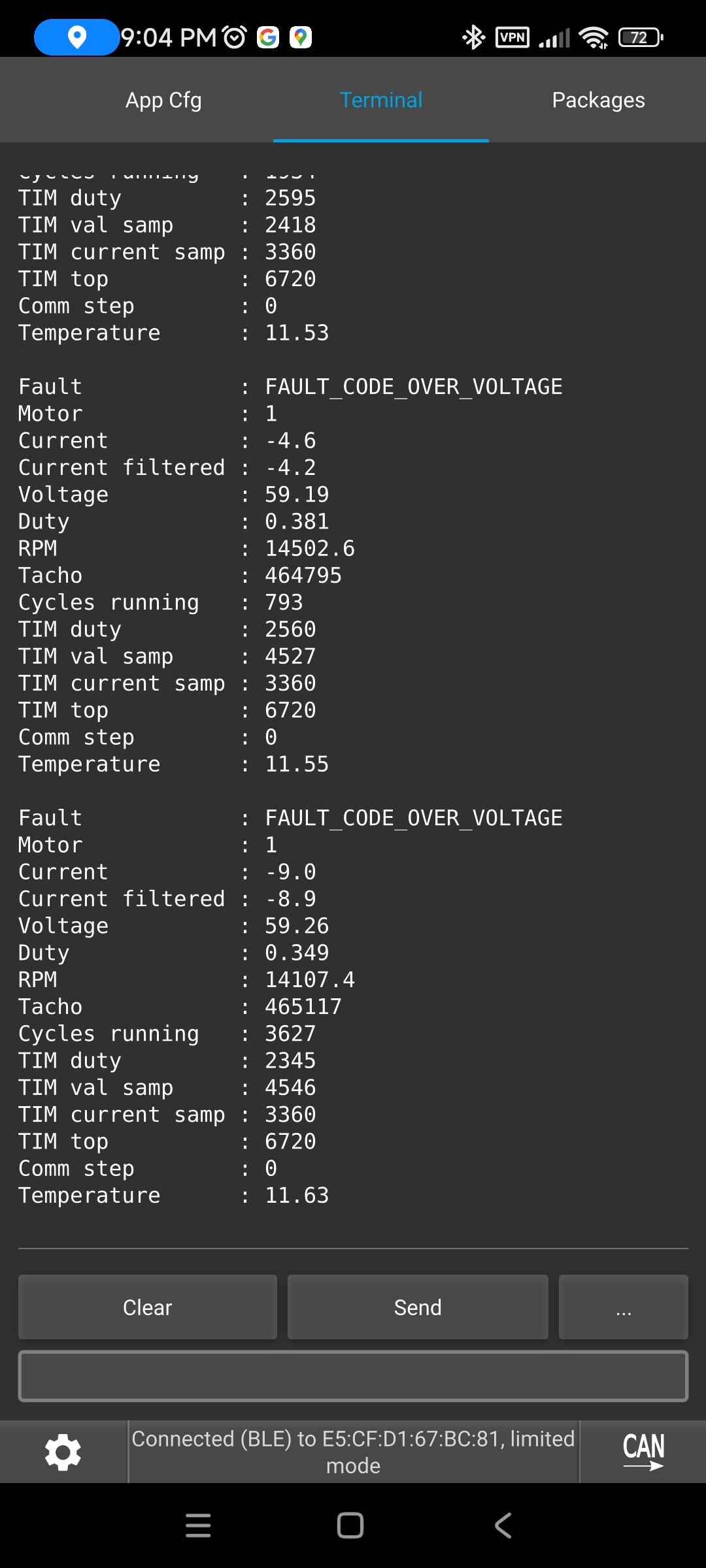

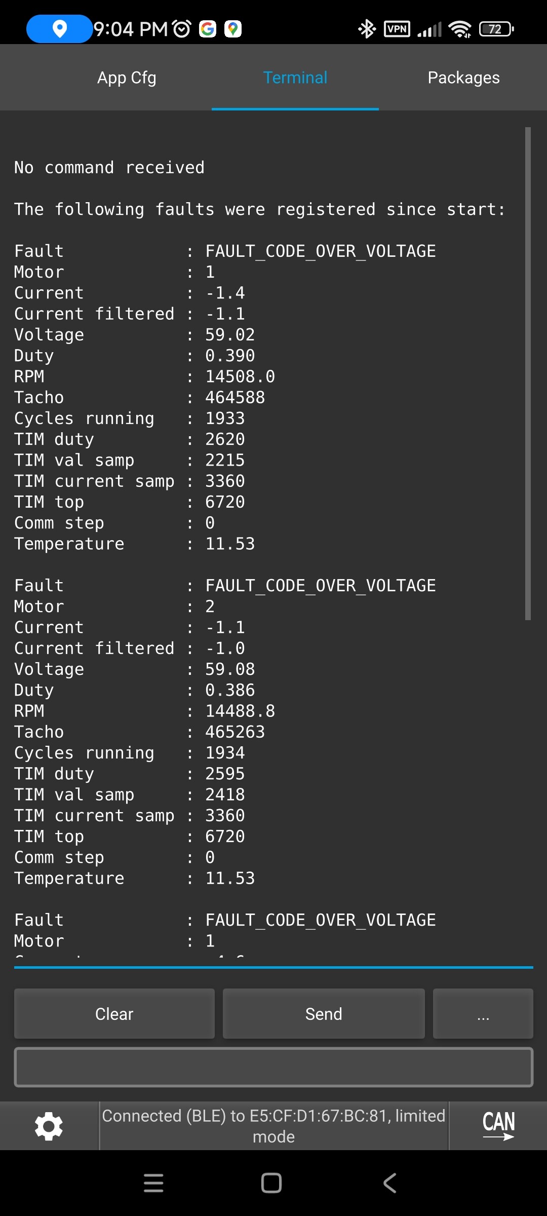

I’m trying to get to the bottom of an over voltage fault too. There’s some chance it may just be a flipsky feature designed to remind me to be careful whenever I get on the board, and to not buy more of them.
Colder temperatures might increase likelihood.
Only happens for the first twenty seconds of riding after the boards been sitting.
Only happens off the line. Motors set to 80A.
Never happens during regen braking, when the voltage should be higher in theory.
Both channels often report the same fault.
Flipsky V6.6 dual mini, with the tiny little capacitors. Changing to FW6.02 made no difference but helped with voltage readings.
I’ve just soldered 1000uF to the power input to see if that makes any difference. My gut feeling is it’s more likely to do the the ESC. You ever have over voltage under load when it’s the battery wires, or has it only even been during regen?
