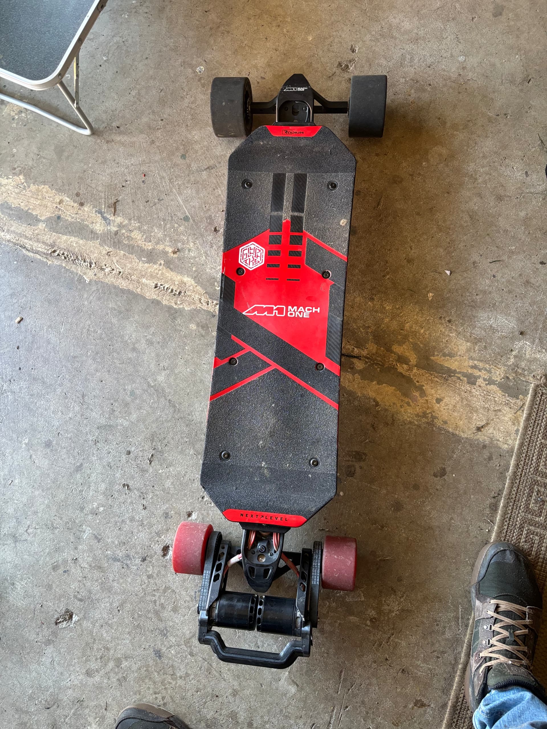

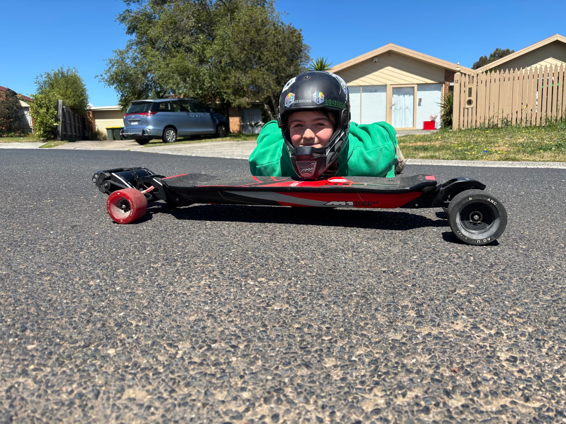

If you can get past the aesthetics, try the 125’s on front truck only.
The deck at an upward angle is not the major annoyance that thought it would be, and mine is rather extreme with 2.80/2.50-4 up front and 105’s or 90 mm urethane pushing from the rear.

I did the illegal thing…
it wasn’t as bad as i thought it would be! An interesting ride, definitely more rideable than i thought it might be…. But…
skatan punished me for it. Blew a hall sensor :man_facepalming:
this is what I get for being an antagonist :man_facepalming:

did you try rolling the gravel with the illegal setup?
I did. It was marginally better but still a bust
