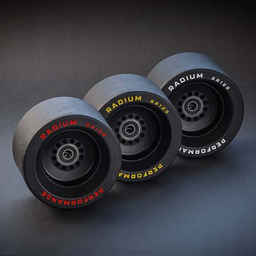

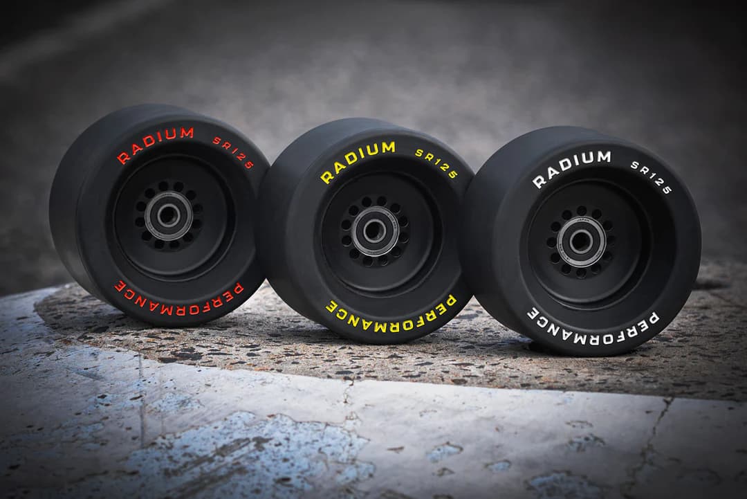

New SR125’s with updated core design in stock!
55A medium compound (yellow) now available, and updated core now supports down to 40mm length axles. Soft 45A compound currently in testing.
Have the bearing seats been adjusted or are they the same fitment?
They’re not as tight. No arbour press required.
Seat design is also new with double depth on both sides, and we provide an outer ring spacer and two different axle spacers so you can run 22.2mm spacing or 15.2mm for shorter axles (now minimum 40mm length needed).
