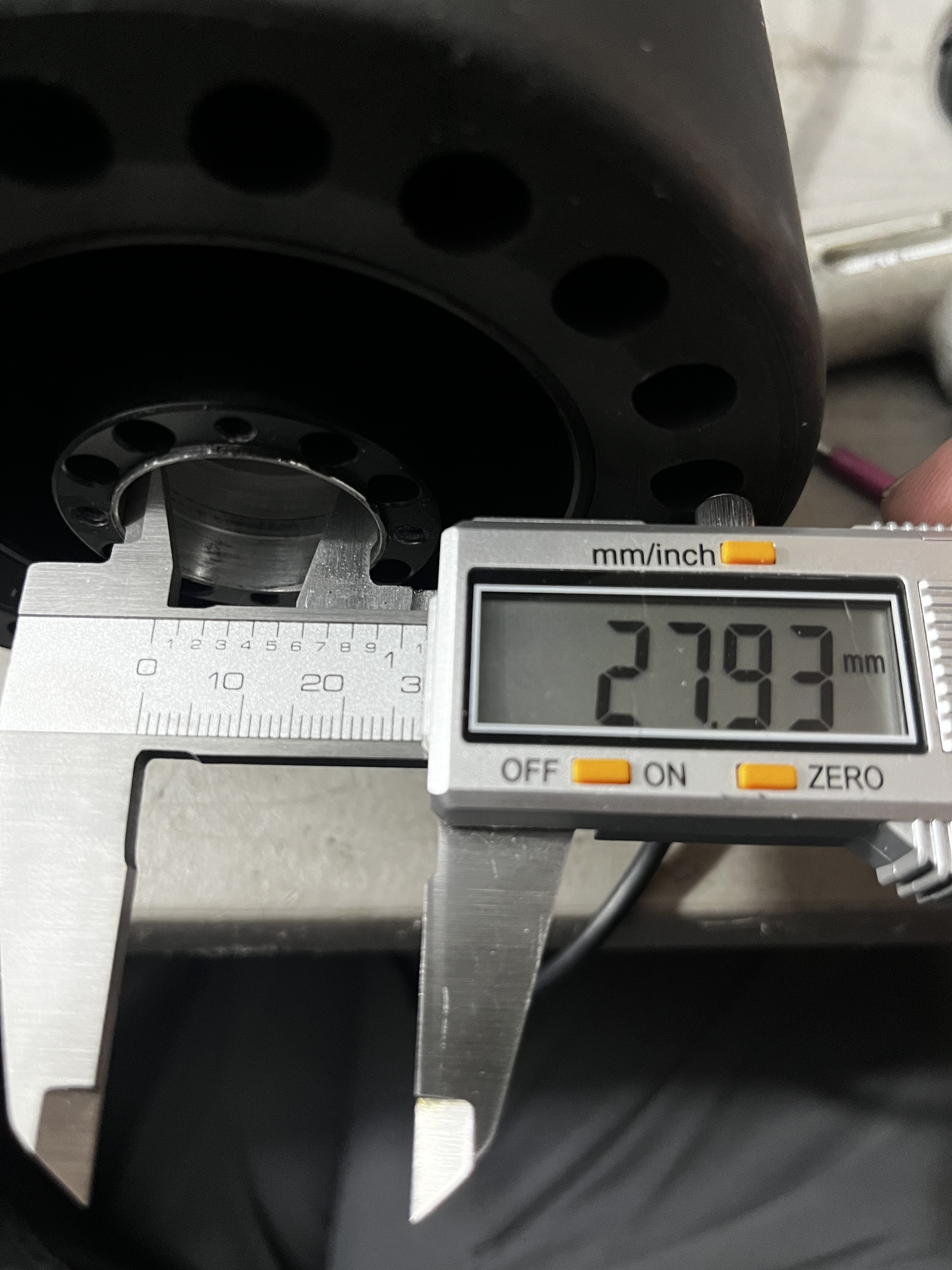

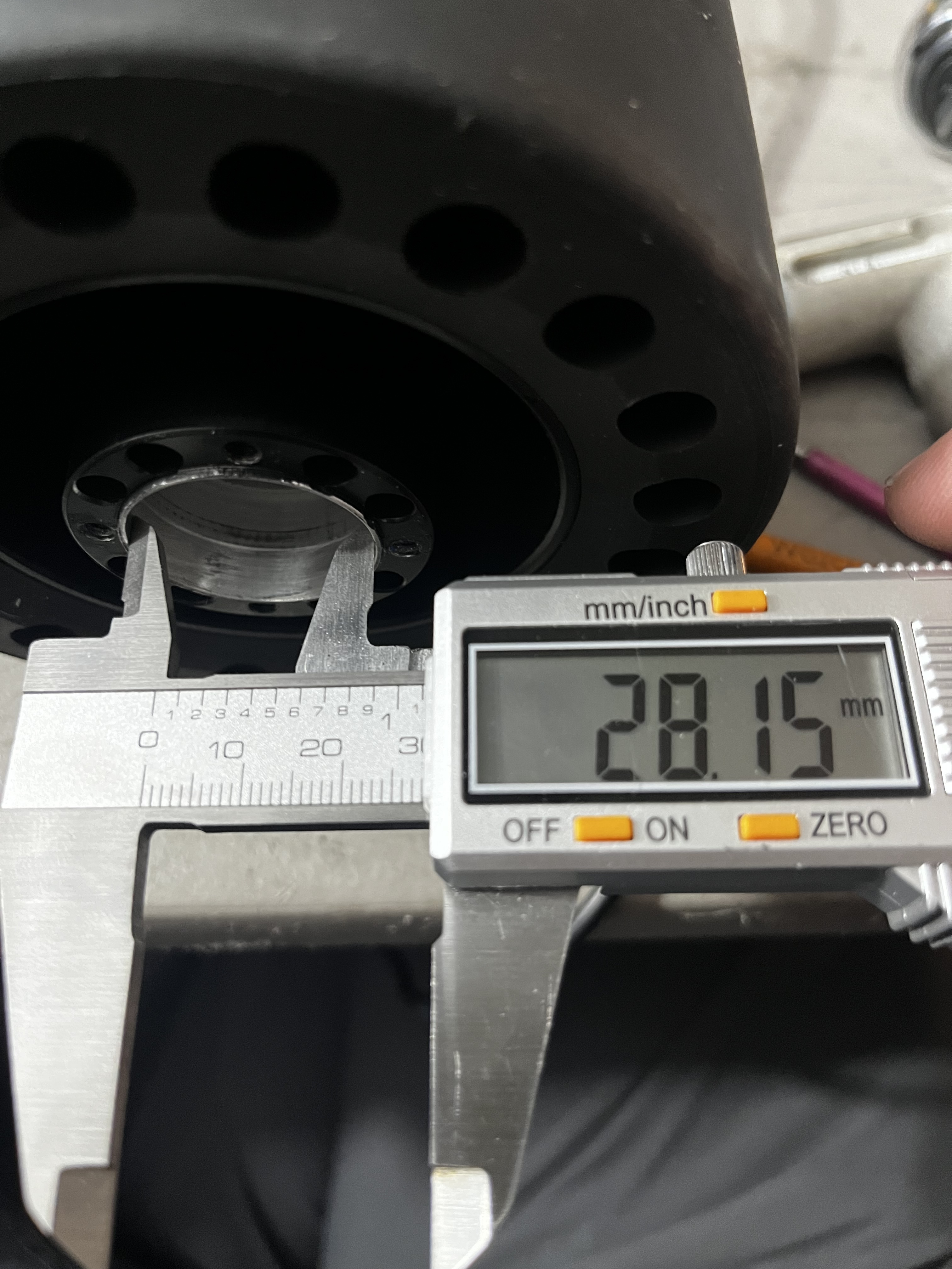

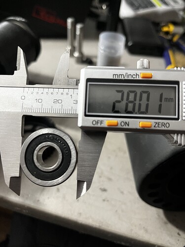

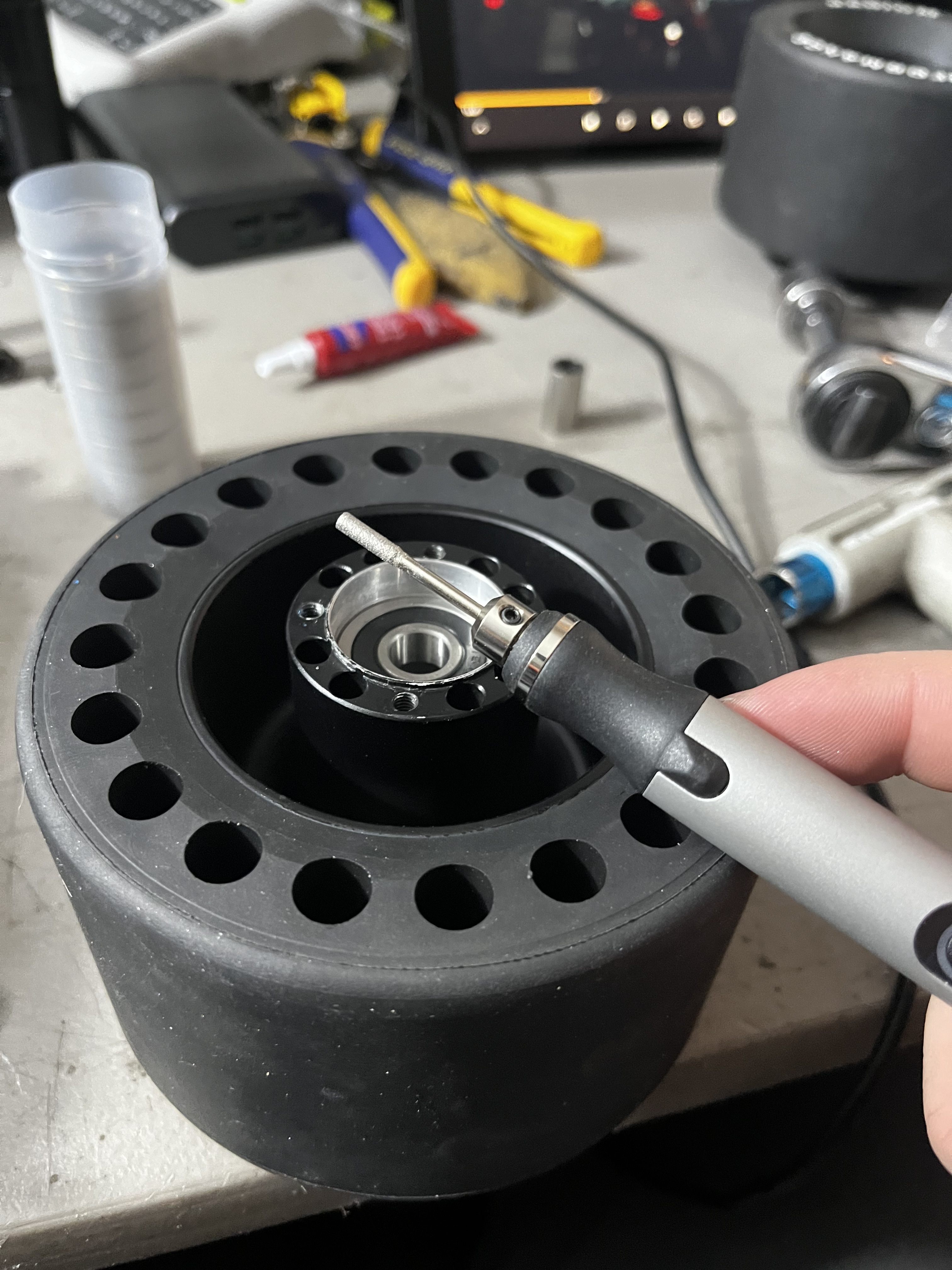

If its any consolation, the first prototypes of the BRP hubs i had made have a single tolerance bore all the way down, and i havent had any such issues with aluminum buildup - i just asked them for a JS7 tolerance on the bearing seat.
Huh, yeah. wow.
.2mm isn’t insignificant.
Ditto it’d be nice if it was a single diameter all the way down. (And slightly larger)
Little hit with a pen trimmer did the trick tho, great suggestion

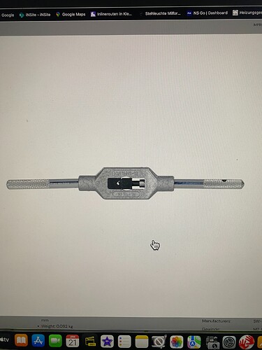

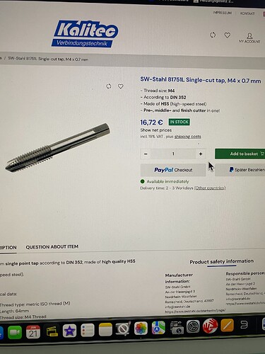

So I ordered a tap tool in the above mentioned dimensions… Because its aluminium/soft material i decided on the hand-tool:
I have never “tapped” before/ used such tools. But i think this is fine for the purpose ? :point_up_2:t2:

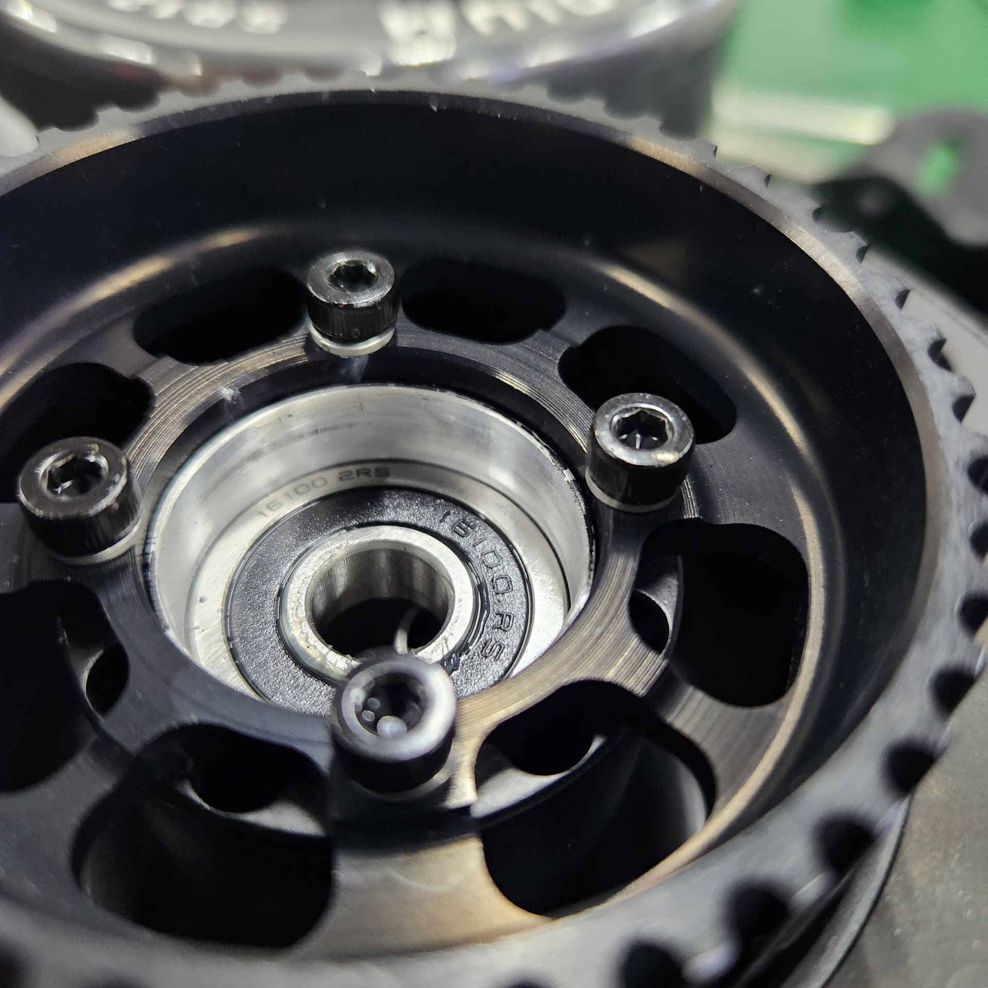

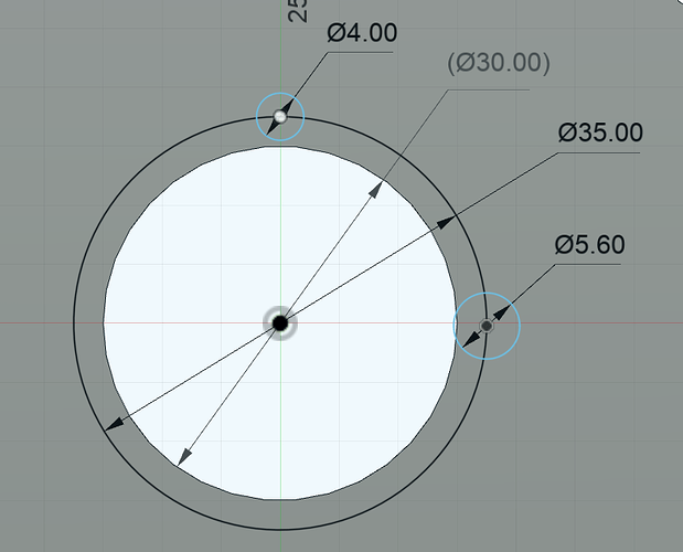

Alright… I may be a bit slow, but could someone help me out?
As I understood the drawing, the gear attaching/ locating holes are on a 35mm diameter circle and are 5.6mm in diameter themselves.
And it appears the circle for the locating ring is 30mm.
That’s all well and good, except for me a 5.6mm “bolt” opening would overlap the 30mm locating lip.
What am I doing wrong?
From what several people have shown in this thread, that does seem to be the case.
5.6mm is the head diameter, which does overlap the center hole, however the actual 4mm bolt hole does not intersect.
This was to optimise weight as much as possible as small increases in hub diameter lead to large increases in cross sectional area.
A bearing technically does fit through but admittedly its cutting it fine…
#clearanceisclearance
Thank you! I appreciate the info!
