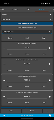

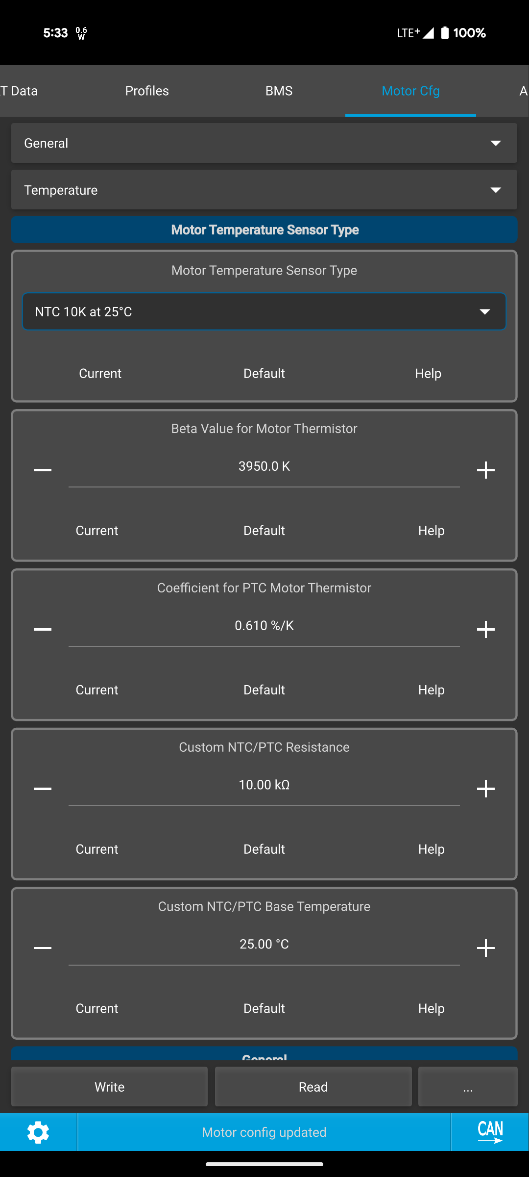

Did you adjust the beta value to 3950k?
Sorry ya lost me there… In vesctool? I usually don’t touch temp sensor stuff.
Yes, thermister will give the wrong temperature value if the beta value isn’t correct. The default thermister value in vesc tool doesnt match the correct beta value for reachers.
Got it heck yeah.

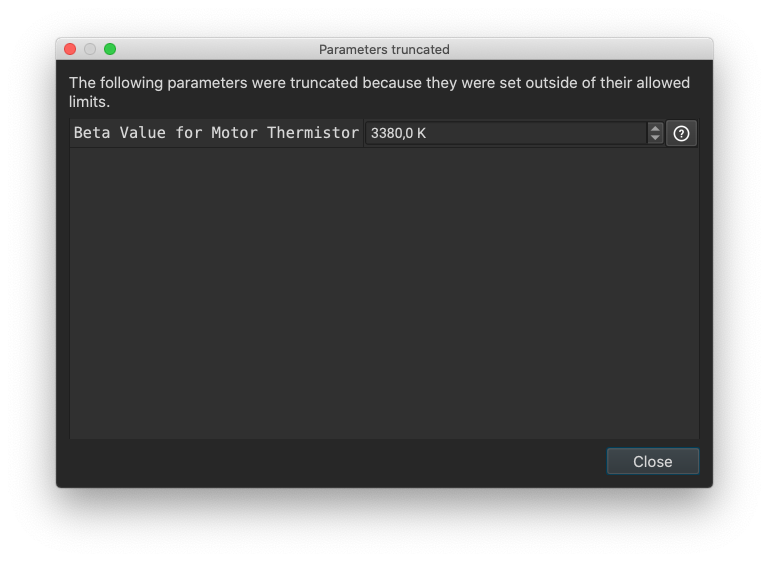

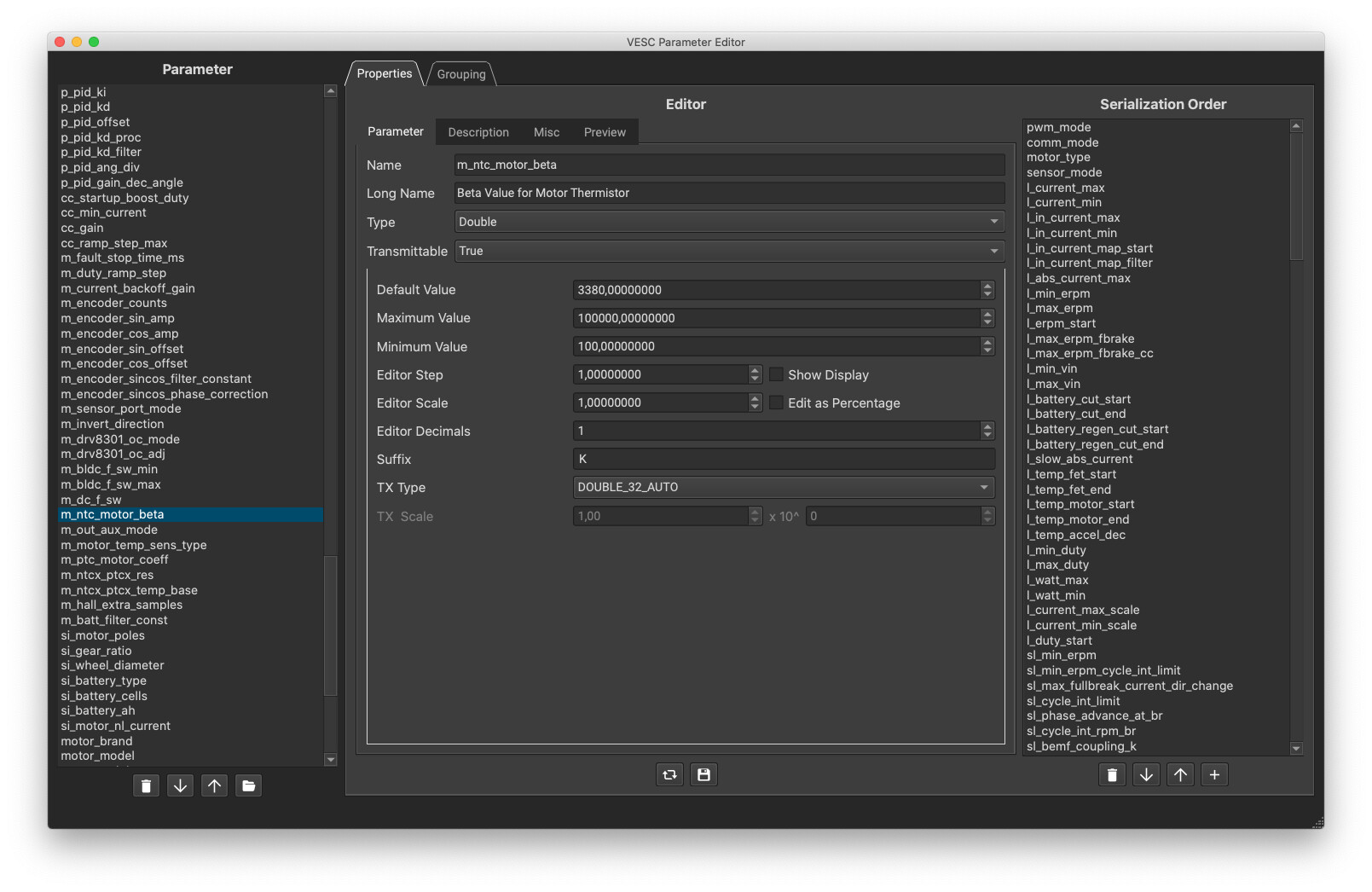

I have Reacher motors (Reacher 6385 V6.0 N45SH Brushless ESK8 Motor 48V 5000W KV245 Hall Sensor 12N14P Electric Skateboard BLDC High Power Belt) and FW 6.05 doesn’t let you use value 3950 K As Beta Value for Motor Themistor :face_with_raised_eyebrow:
Choosing NTC Custom as Motor Temperature Sensor Type can’t fix this issue…
In VESC Parameter Editor, 3950 doesn’t appear out of limits.
