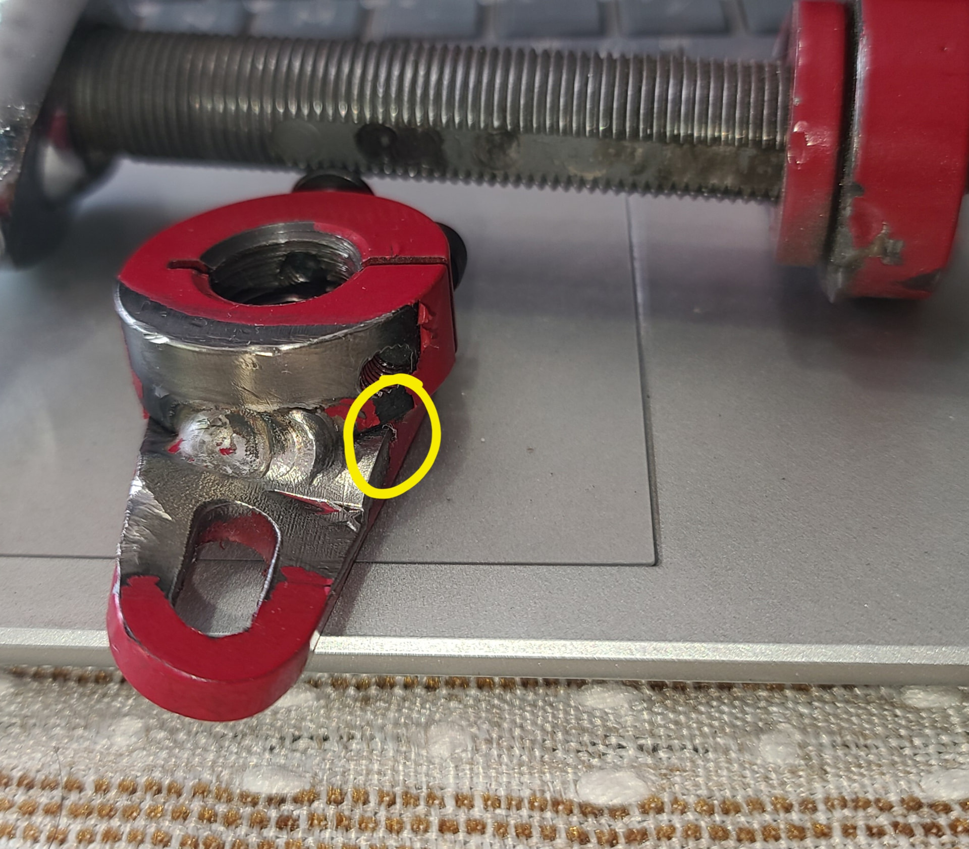

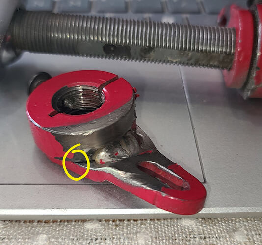

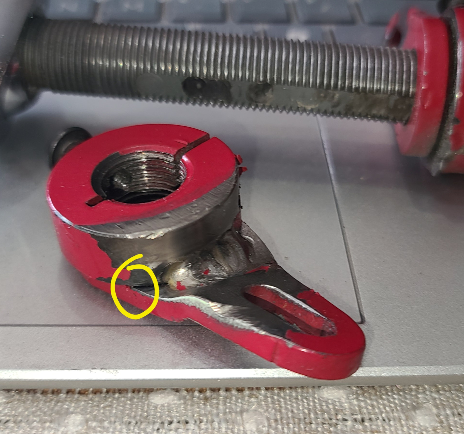

Any time we have damaged parts from a wreck I want to see bent parts, not broken parts. The hanger in this case here took a heavy impact. We checked it in the lathe and it is also bent between the rod mount and carrier heim. [20260421_132327] The opposite side was stripped of powdercoat and checked for cracks. [20260421_132951] Updated parts were made and sent out to people using this setup. For Andys, we replaced and updated his bent and broken parts at no charge and replaced all attat…
But why was it just tack welded? @MoeStooge
Maybe just conduct yourself with more grace? Its only been 10 years of disrespectful comments on this forum, especially towards other vendors, we’re all incredibly tired of having to read it.
Yeah it’s pretty exhausting at this point. I get so much confirmation of my issues with him in private from people who outwardly display themselves as his biggest fans
When you tig weld end to end of a piece, it creats a thin spot where the weld ends. By leaving material untouched on each end of the weld the tab end strength is stronger and eliminates chance of tab end cracking .
@JesseM to answer your question.
A tack weld would be a spot weld to hold two pieces together so they dont move while you perform a weld.
The weld in question measured 3/4" (19mm) in length.
Its job was controlling tortional load between the clamp collar and tab end. The tab end is constructed as a ring that is threaded and supprted arround the hanger.
On the new part the weld measures nearly 2" in length with no weld end point on the rod mounting tab side.
