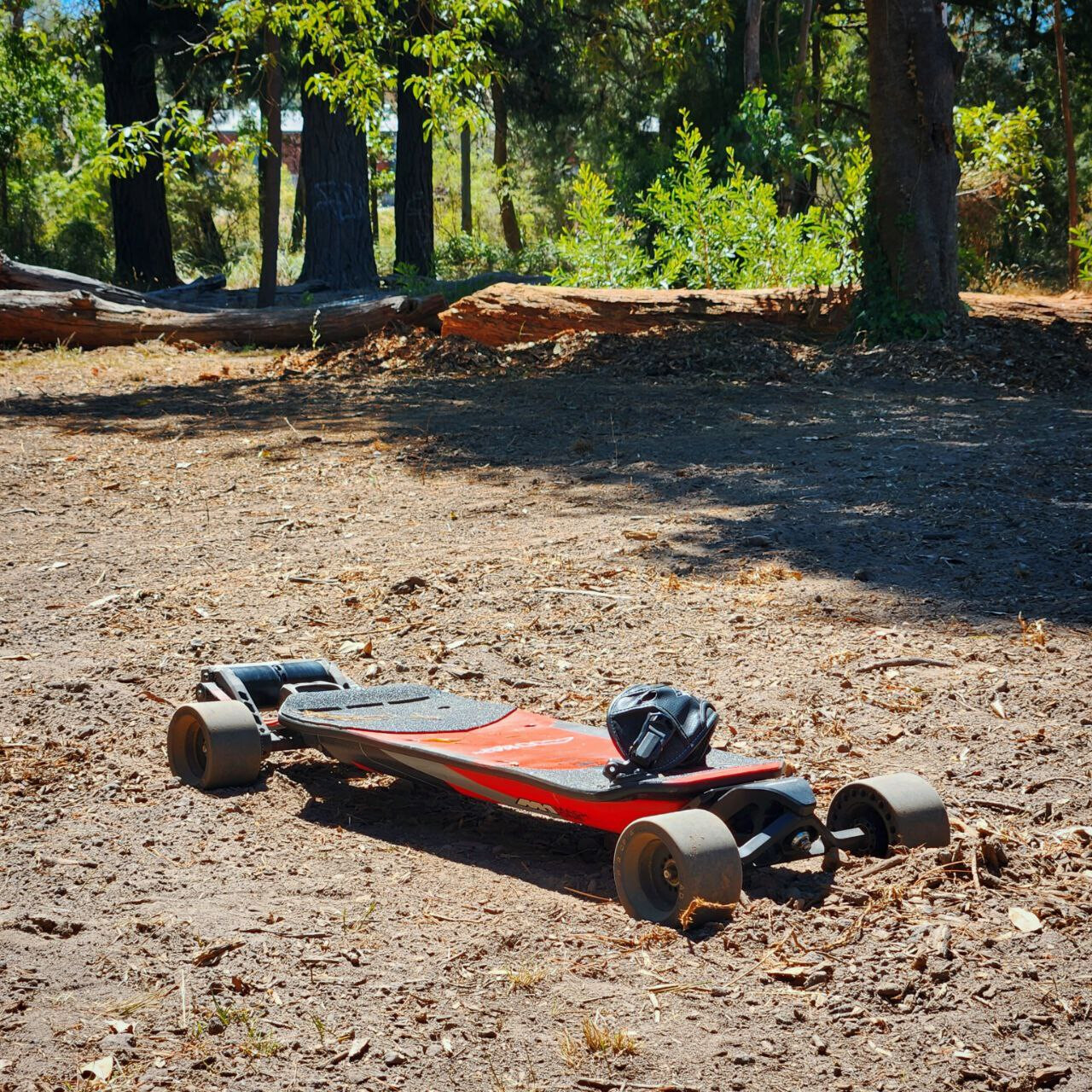

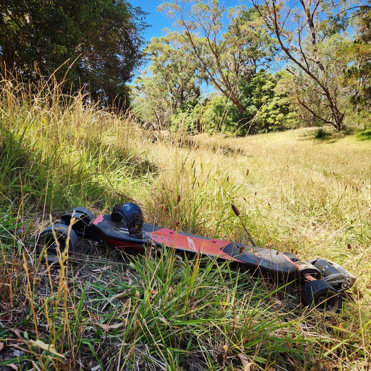

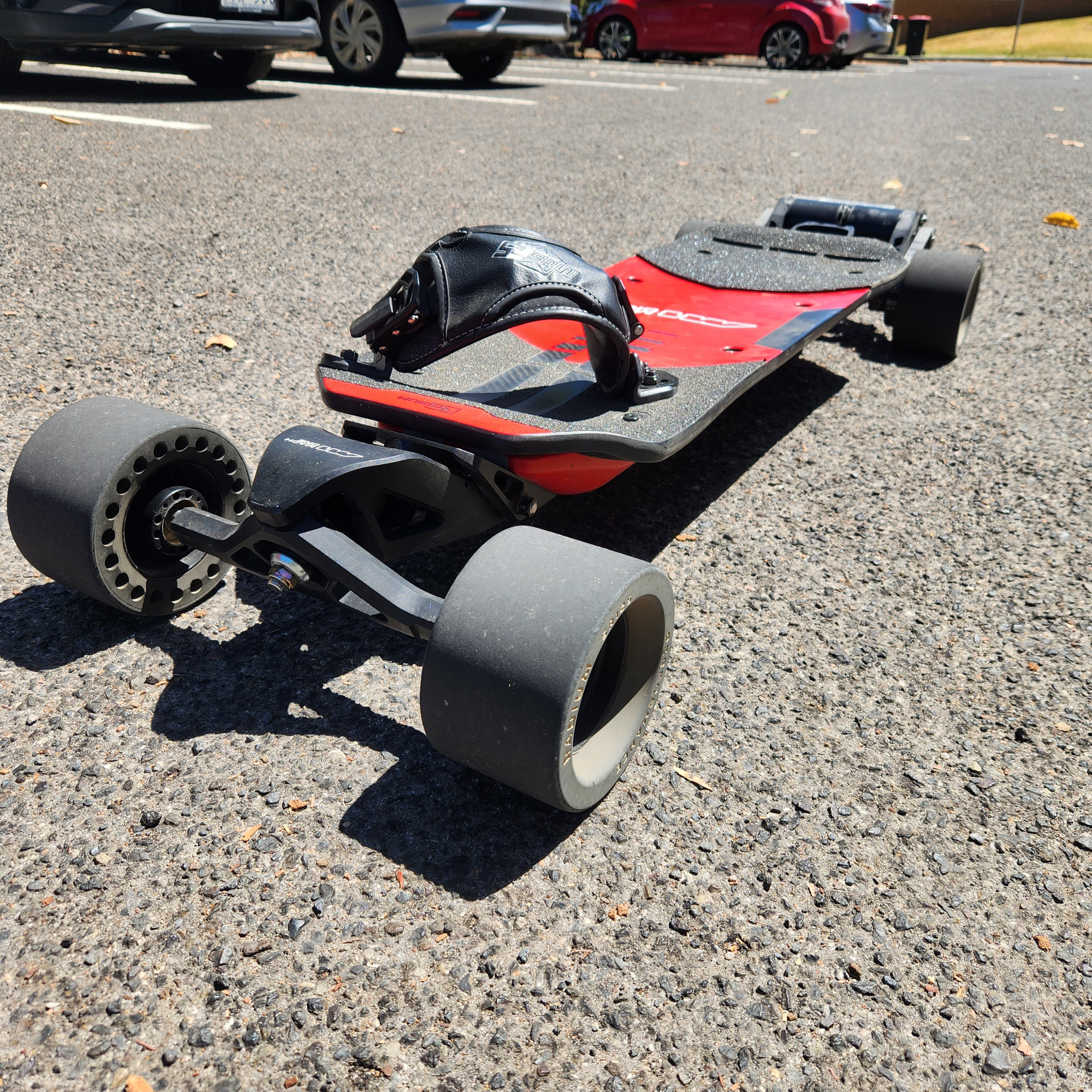

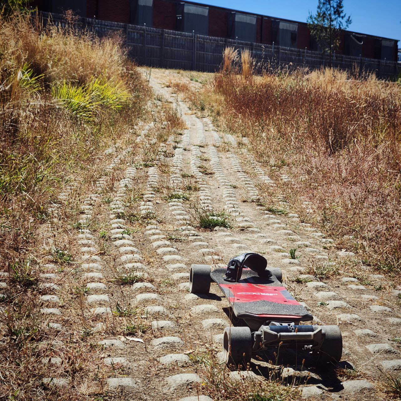

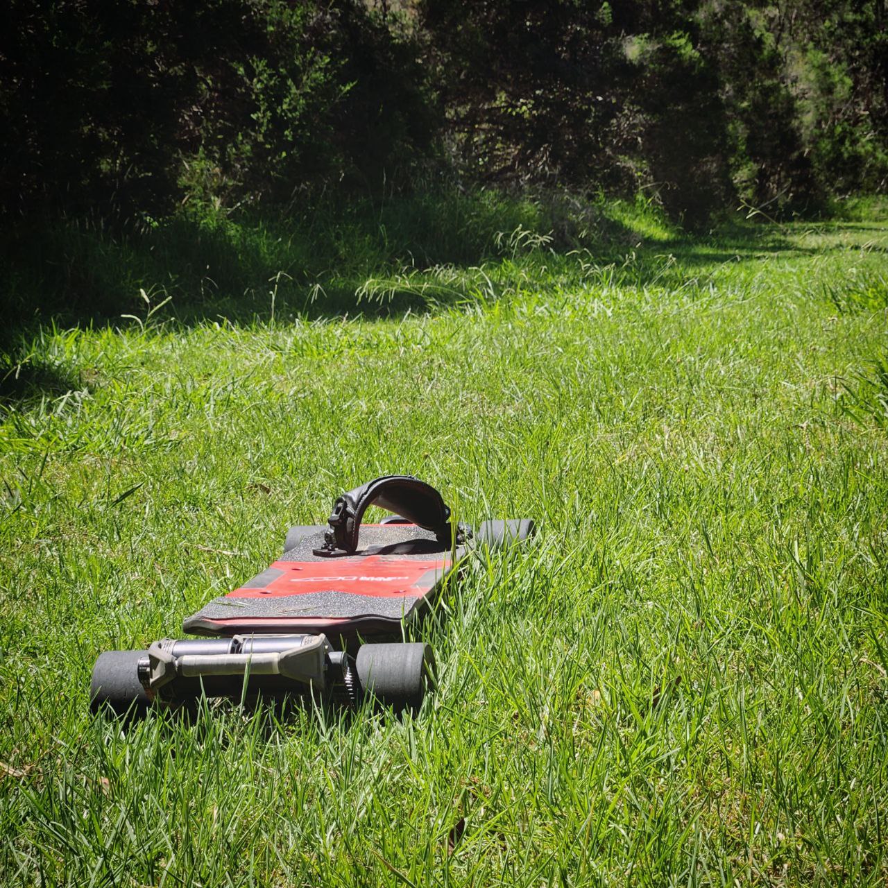

Had to take a break from staring at the screen. Happy (soaking in sweat) snaps from a quick ride around the neighborhood. You can go virtually anywhere on this setup if the surface is dry, and not too loose (bogged in the last pic).
I thought you were kidding about the rough roads out there but cobblestone, yikes!

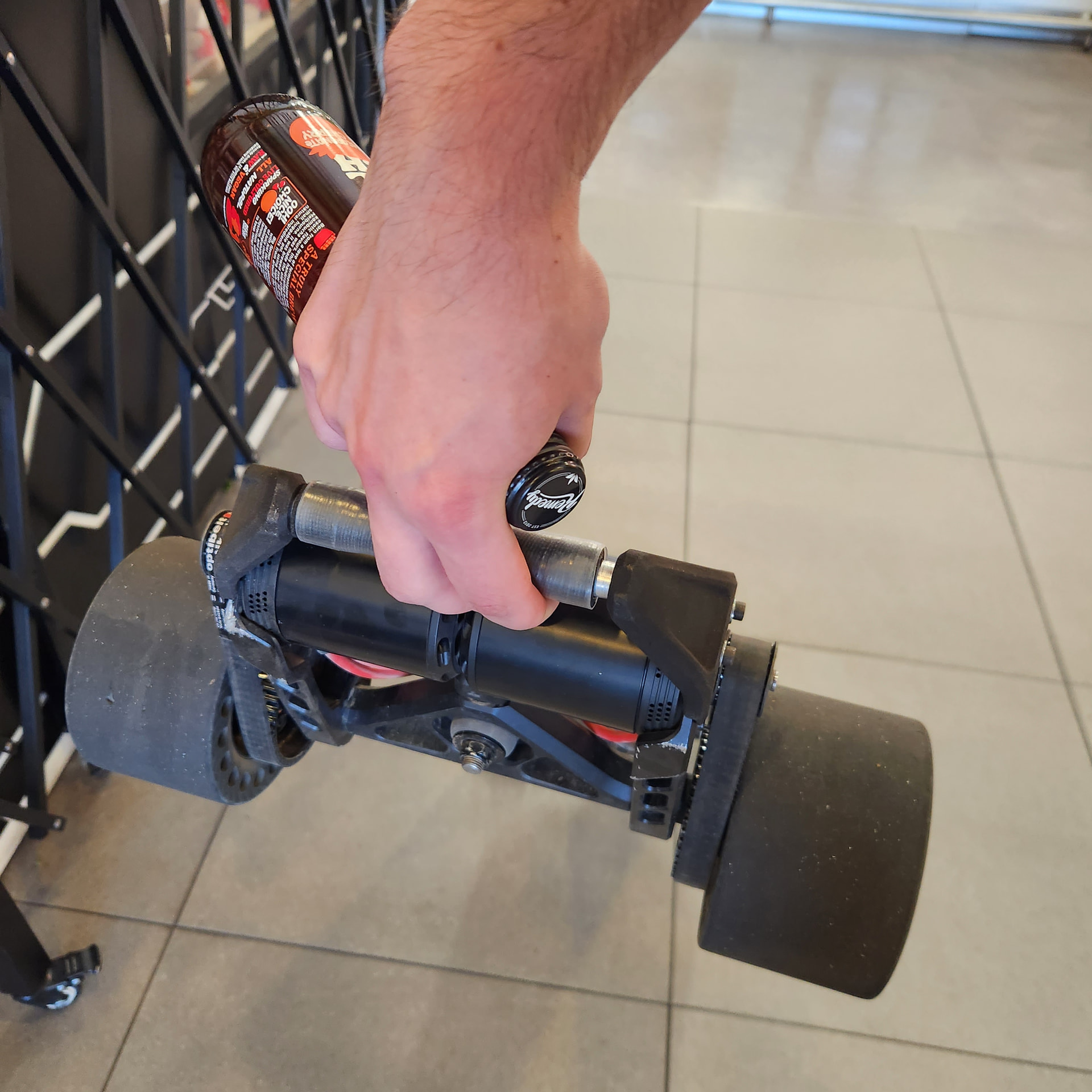

Any details about that bumper/handle, will it go on the store someday?

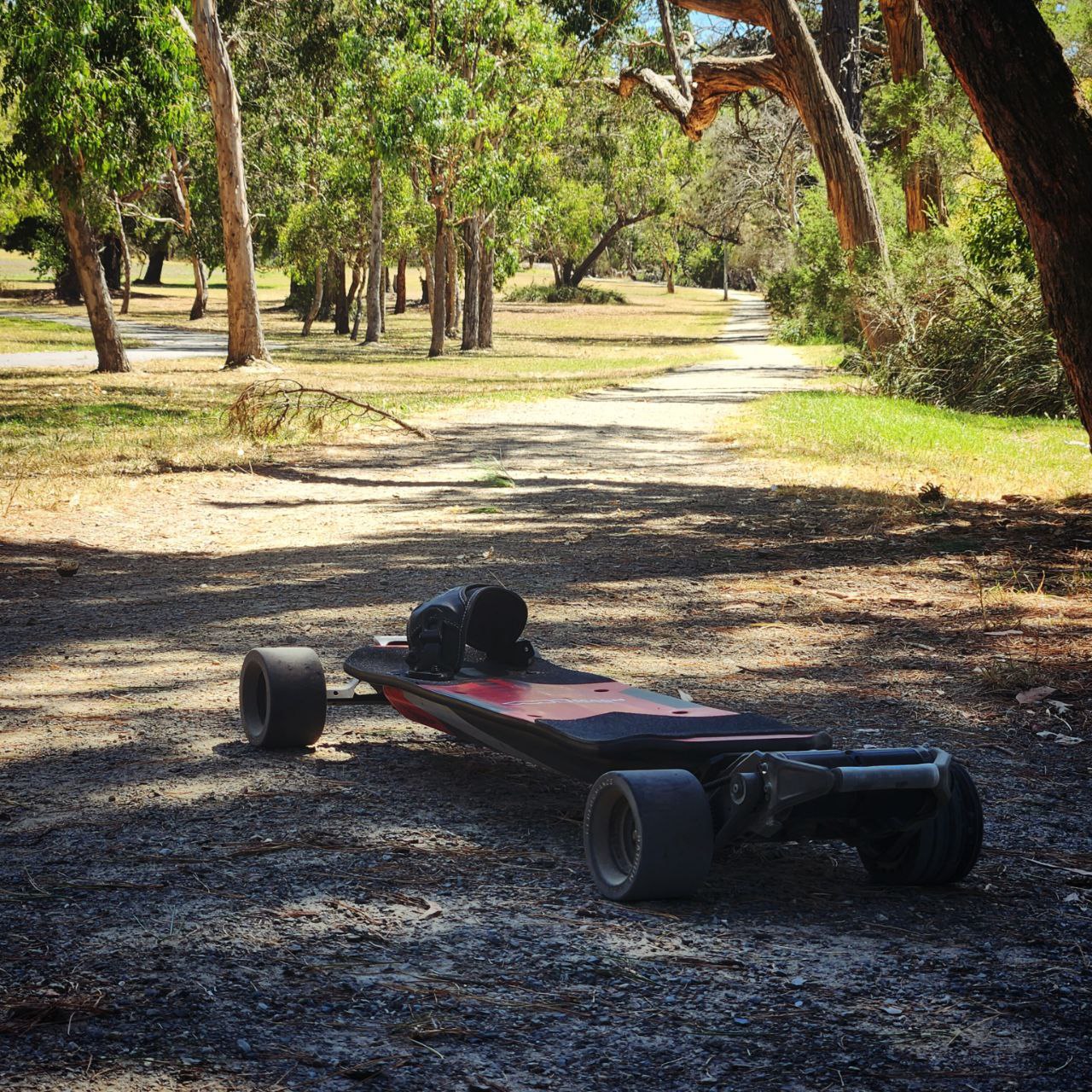

The roads are pretty good in my area, but this is an example of an unsealed surface that is not pleasant on the hard SR125s. It feels icey at maybe 30kph.

In production now and will be available in March. It’s awesome for shop runs, I can tow the board with two fingers.
