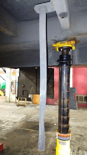

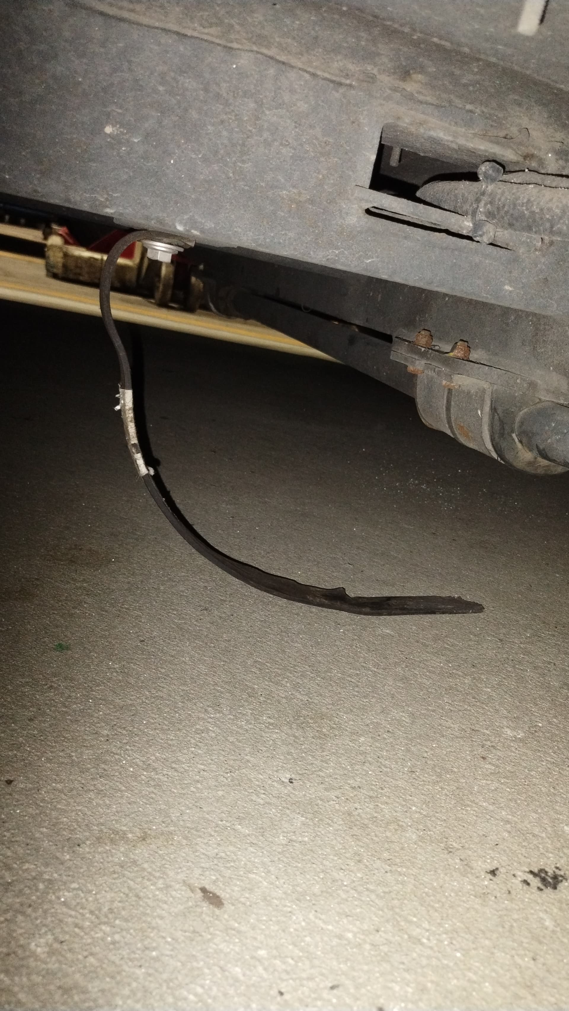

I work on mass transit buses and for years I wondered what exactly is the purpose of these Static Straps. All the hundreds of buses I’ve seen have them, older buses had two in the back, newer ones have one in front and one in back. They wear out, constantly replaced and are seen laying around the shop. Basically just a strip of a rubber material, bolted to a ground point under the bus, hang down and drag on the ground anytime the bus is in motion
At the shop we call them Static Straps but a quick search they are actually called Anti-Static Straps. Possibly an easy solution to discharge a built up charge?

Unfortunately this wouldn’t actually work in our case. We technically already have 4 anti-static straps - the rubber wheels.
Adding straps wouldn’t do anything, because the charge is being built up on surfaces that are not electrically conductive, and so those straps would be conducting to nothing.

Buses have huge tire contact patch but still have those straps. Just threw it out there. Luckily I’ve never had a had vesc fault that caused me to crash but I’d certainly drag a 10mm wide belt like strip if I was having vesc failures and it was a fix.Pretty wild this was even discovered as a possible cause for some vesc failures.
The big vehicle ones are more for static discharge when stopped for refueling since the vapors are more prominent. Most stations have discharge spots to touch before refueling. Those flaps get blown by the wind and dont make contact while driving. Most around here have gone to chains by now. Common on school busses.
The ones sold for smaller cars were like those magnetic balance bands and did nothing but hype
Thanks for the clarification. Sounds like they are required on certain vehicles. Totally makes sense. I never knew of discharge spots at stations
