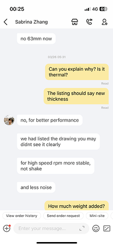

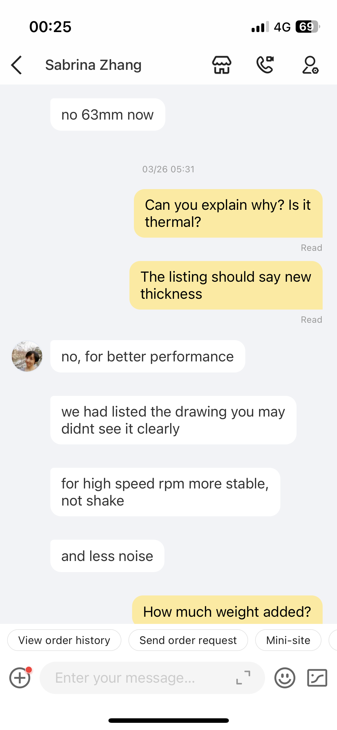

I was surprised that Reacher had not updated their listed sizes. My heat extractors fit 63mm motors so to find they have 64mm but say they are 63mm made me think they were hiding something they thought was valuable.

What do you mean “the change”? We developed the whole motor over several years, hundreds of hours of R&D and making changes. Reacher doesn’t use 64mm diameter even though we do on our site because they prefer marketing over facts.

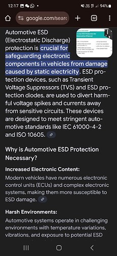

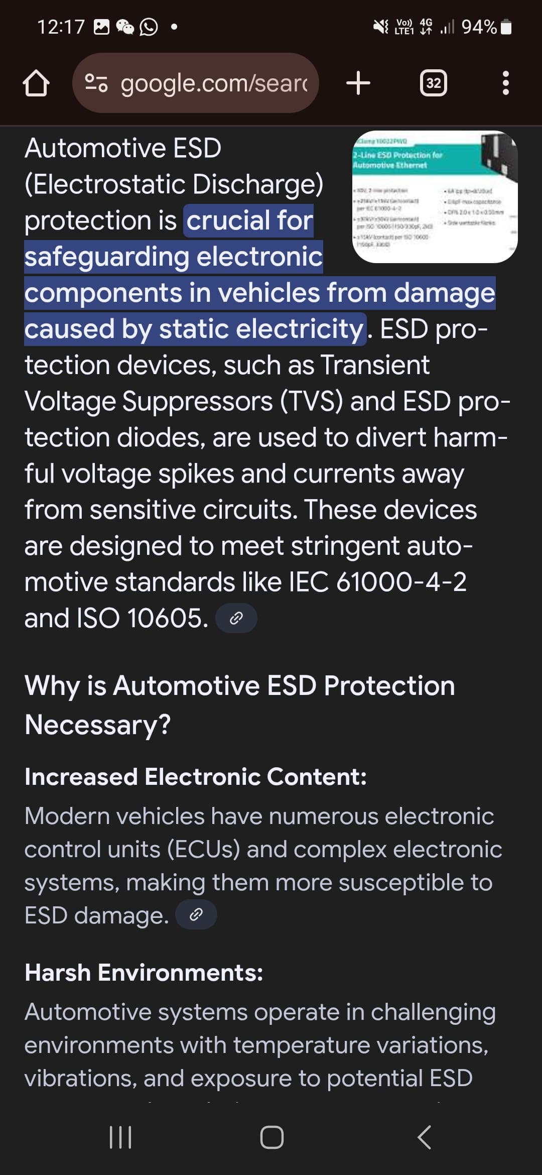

Yes everything fails, although cars are produced in the millions whereas electric skateboards have a remarkably high failure rate considering the far smaller sample size, and I attribute this to hobby engineering and that most eskate brands treat them as toys.
Cars have ESD protection standards to prevent such failures.
My mission has always been to bring eskate out of the hobby realm and produce something closer to automotive standard to significantly lower the risk of injury and we’re getting there! Ironed out nearly all of the gremlins over the last 5 years. RTS unfortunately introduced a new elusive one, but in a way I’m glad it allowed us to discover the static charge phenomenon and add protection for that. Just wish we figured that one out a little earlier😅
