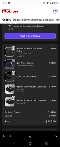

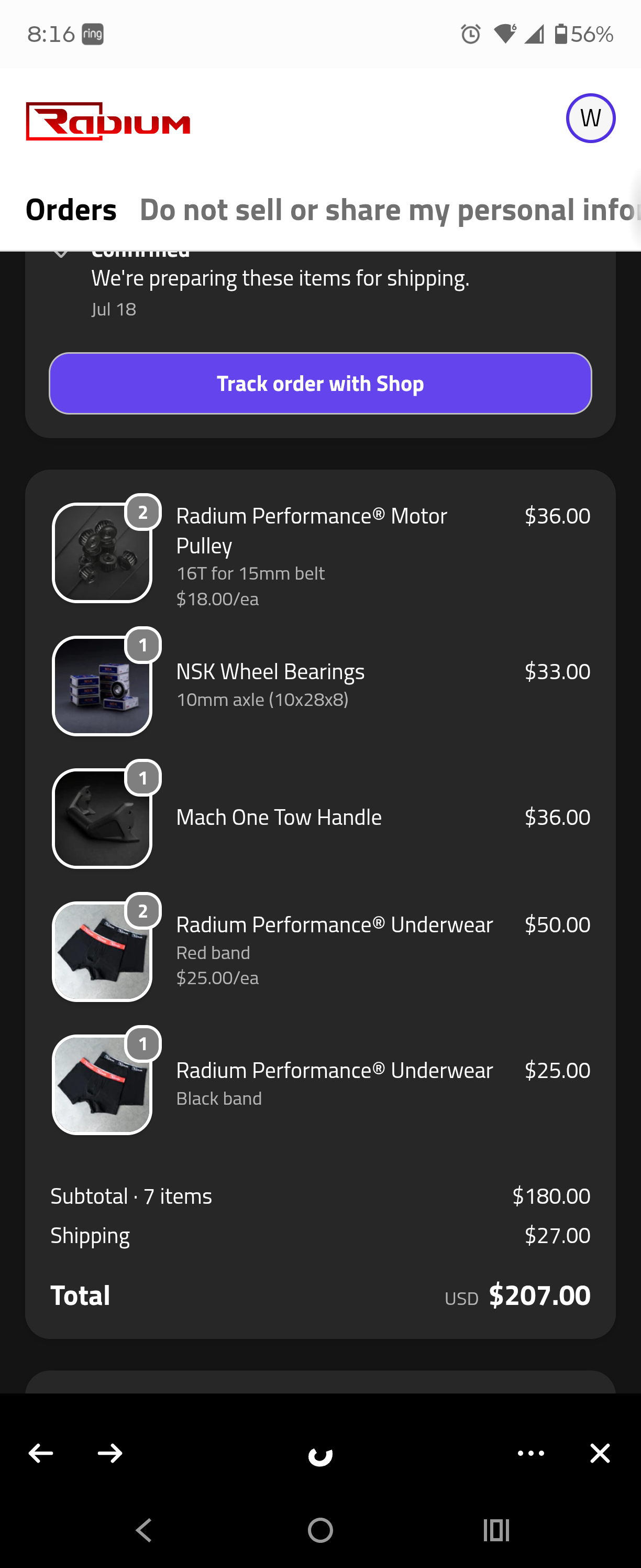

Radium performance underwear is up on parts list for ordering
:face_with_hand_over_mouth:. Just had to get some more as well as some other Mach 1 goodies to prepare to ride when it gets cooler real soon here. Meanwhile, indoor quad skating to maintain balance skills and getting over a bronchitis bout :grin:

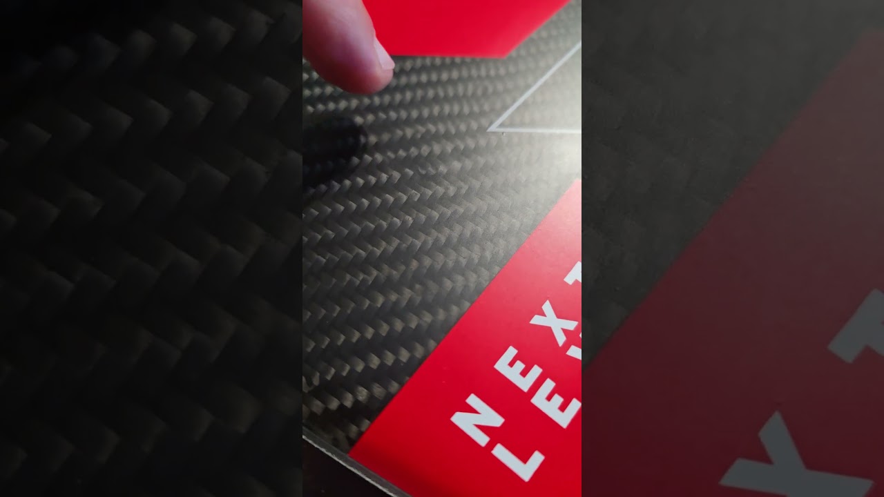

I realize that I have soft zones in the carbon enclosure of the Radium Mach One.
Does anybody else have that?
There must be a shortage of resin here, right?
Woah that’s a first!
Please email us contact@radium-performance.com so we can assess it and decide the next steps.

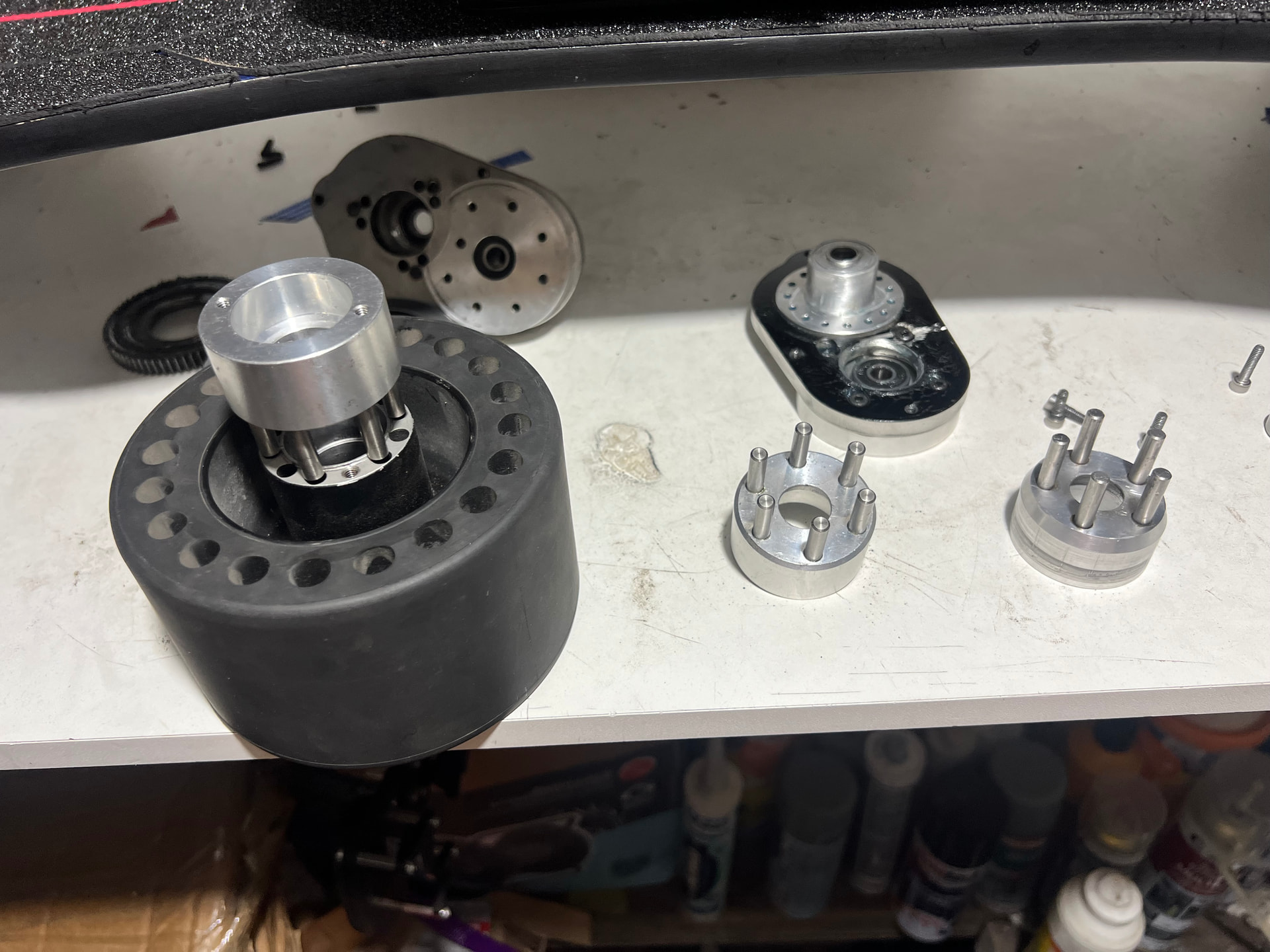

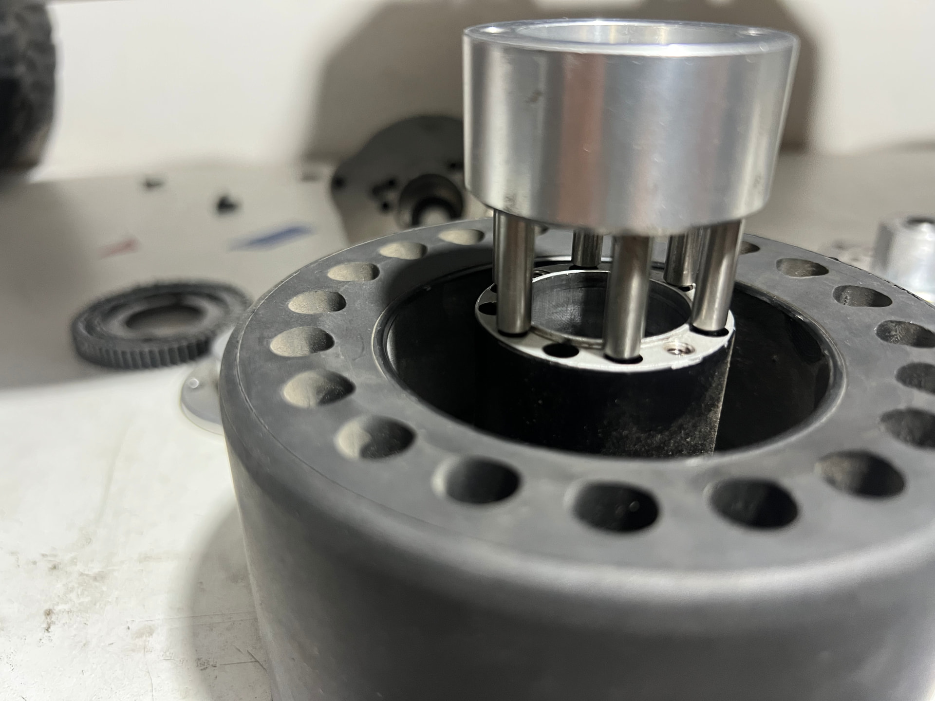

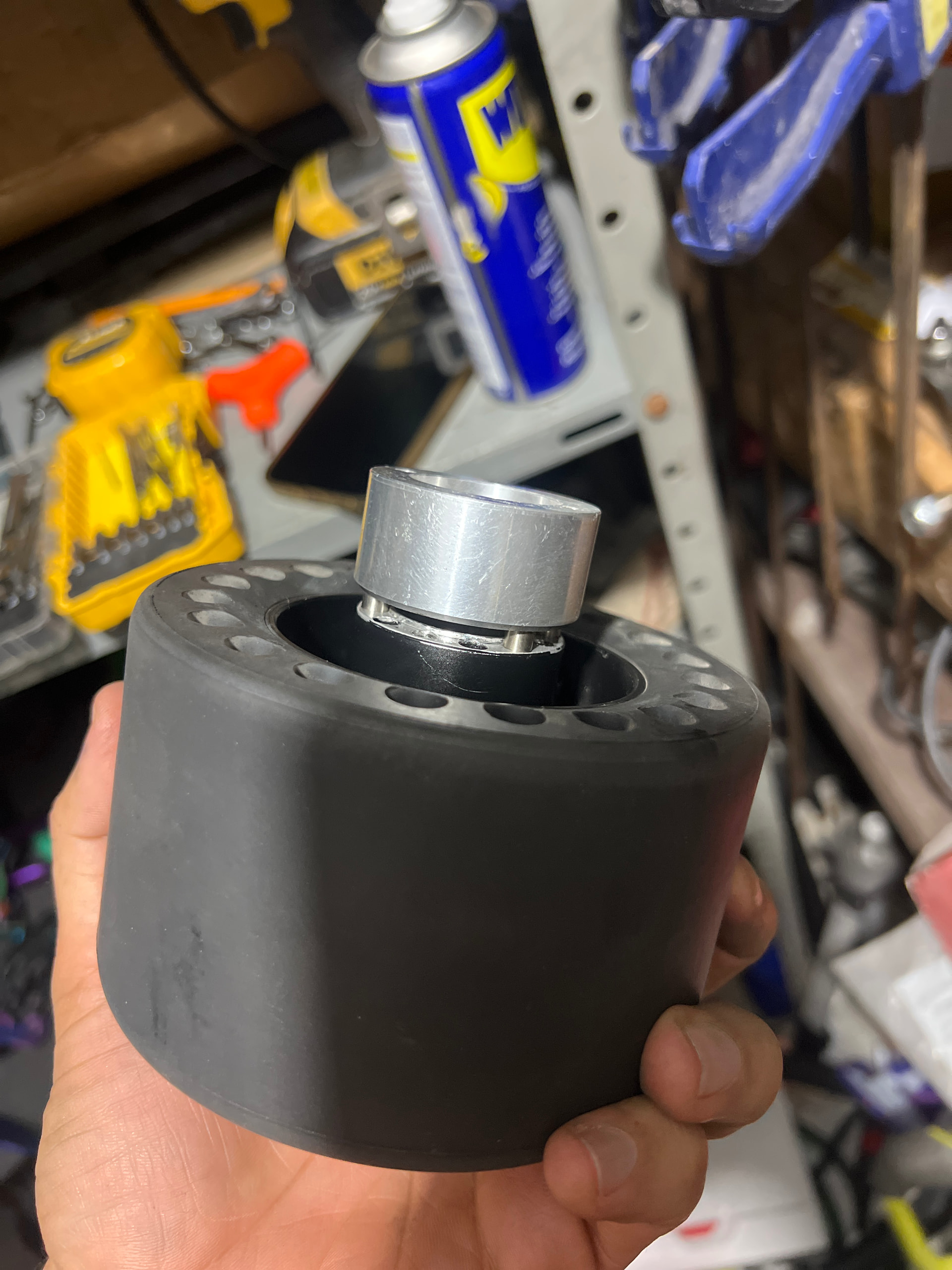

While going through some of my stuff, I found a BoardManiac adapter that, from what I can tell, fits the older RS wheel model.
I think I got lucky — it looks like I’ll be able to make a BoardManiac gear drive work with the older RS wheels, which normally only work with Kegel adapters or pulleys.
The only issue is that the mounting holes are slightly smaller than the pins, so I’ll need to open them up a little with a drill.

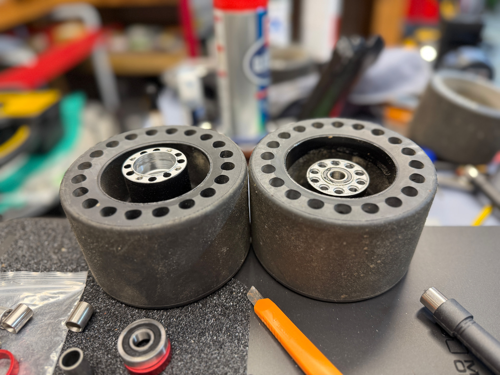

The only problem is your pulley is going to be a mile away from your wheel… will make fitment on the trucks difficult. The newer wheels have the kegel holes inset into the hub more to allow for the pulley adapter… (Older style on left, newer on right)
Now I understand, the pins fit together better, I’ll be able to screw the axle bolts in all the way, I’m not sure if it will work yet to be honest!
