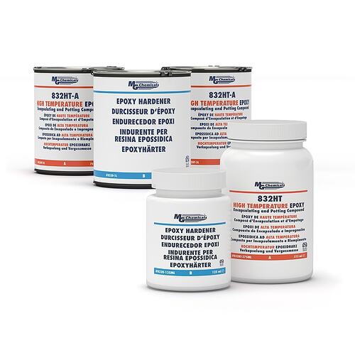

On this batch we upgraded to a much higher quality enamel coating on the wires thats also rated for 40C higher temperature.
However this then caused the varnish that coats the coils to behave differently resulting in a coating that was so thin you could pull some of the coils off with your fingers. So I have had to disassemble this batch and coat each stator in a special epoxy by hand.
Before and after adding additional coating to prevent winding failures:
Proper QC :ok_hand:
What epoxy is that?
