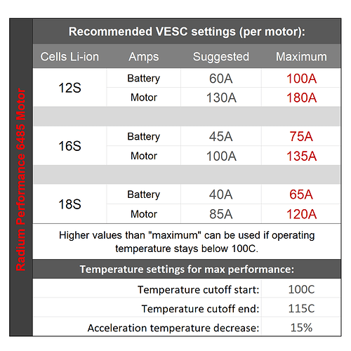

New setting recommendations for these motors based on real world testing.
Highly recommend updating your temperature settings to this if you want max performance in warm weather.

Those settings are recommended and same for all kV options?
What basis is the battery amps rating? Seems a weird thing to include with motor specs. They’re not even similar in wattage…
What do you mean?
The recommended battery currents are based around heat from experience testing and from our customers. The range is quite large because of the variation in setups, climate and riders. Thats why we always recommended to set a high motor amp limit and then adjust the battery current up or down based on whether thermal throttling is occurring or not.
Most people don’t realise you can run very high motor amps with these motors so thats why we mention it
Pretty much. You will find lower rpm setups on the lower end and higher rpm setups on the upper end of the scale
Firstly, I was wrong about the wattages, they are similar. The 18S max batt current is only 108W less than the other two which are consistent and the “recommended” column stays consistent at 2592W.
However, I meant you shouldn’t offer battery amp recommendations. You’re selling motors here not esc’s, no other motor seller give a battery amp recommendation with them. Offering an access of advice isn’t helping you imo since you don’t know what esc/battery customers are using and what amps those can handle. Asking for a customer to come back saying “your powerful motors burned out my ESC”
But to be honest, on second thought that vesc setting chart doesn’t really make sense to me at all. The amp recommendations should probably be given based on motor KV since that’s going to have the greatest effect on it heat. The voltage and battery amps are somewhat nonsensical to include imo since you have the voltage → KV recommendation chart already.
Well, the faster a motor spins the more it heats up as well, so maybe taking both battery and motor current into account to draw a graph that slopes downwards as you increase the duty cycle makes sense.
It’s an easy way to inform customers that you can use X kind of current for startup, but during riding it’s best to stay under Y amps.

Battery amps is the one every motor manufacturer uses because its what actually dictates power. You can’t really use phase amps to calculate wattage.
What power the particular ESC someone using is capable of is not really a concern when I’m talking about the capability of the motor here. Its up to you to know the limits of your motor controller and not exceed them. You surely wouldn’t go and buy a set of 10kw 80100 motors and just put in 200A into vesc tool, and then blame the motor manufacturer when the vesc blows up (well there are probably people that would but)

I highly recommend going by max operating temperature to dial in your settings for battery current as every setup will be different. This is just meant as a guide for people that don’t know where to start, or how much is safe to push.

Technically, if you offer a wattage on a motor, you’re also implying a current.
Regarding the kv thing, aslong as the copper mass is equivalent, both low and high kv motors output the same wattage. They’re just efficient and torquey at different RPMs.
Given that its harder to push alot of current at higher RPMs unless you’re battling massive hill climbs, it make sense that lower kv motors are more efficient at lower RPMs then high kv motors.
I havn’t checked what data is avaible on the radium motors but any performance graph with amps, efficiency % and rpm will tell you alot more then just a static amp value. But they dont look that unrealistic to me tbh :man_shrugging:

I think I got @A13XR3 's point twisted. I don’t really know why battery amps would be relevant info for motors, and take back what I said.
I’ve always assumed battery determines battery amps, and motors/ESC determine motor amps.
With modern cells and the size of peoples batteries these days its often not the case where the battery is the limitation for battery amps now. Usually its the controller thats the bottleneck, or the motors getting too hot (mostly determined by battery amps) wheras motor amps gives you that low end punch and wont contribute to heating as much or affect mid-high speed acceleration as much as increasing battery amps does
