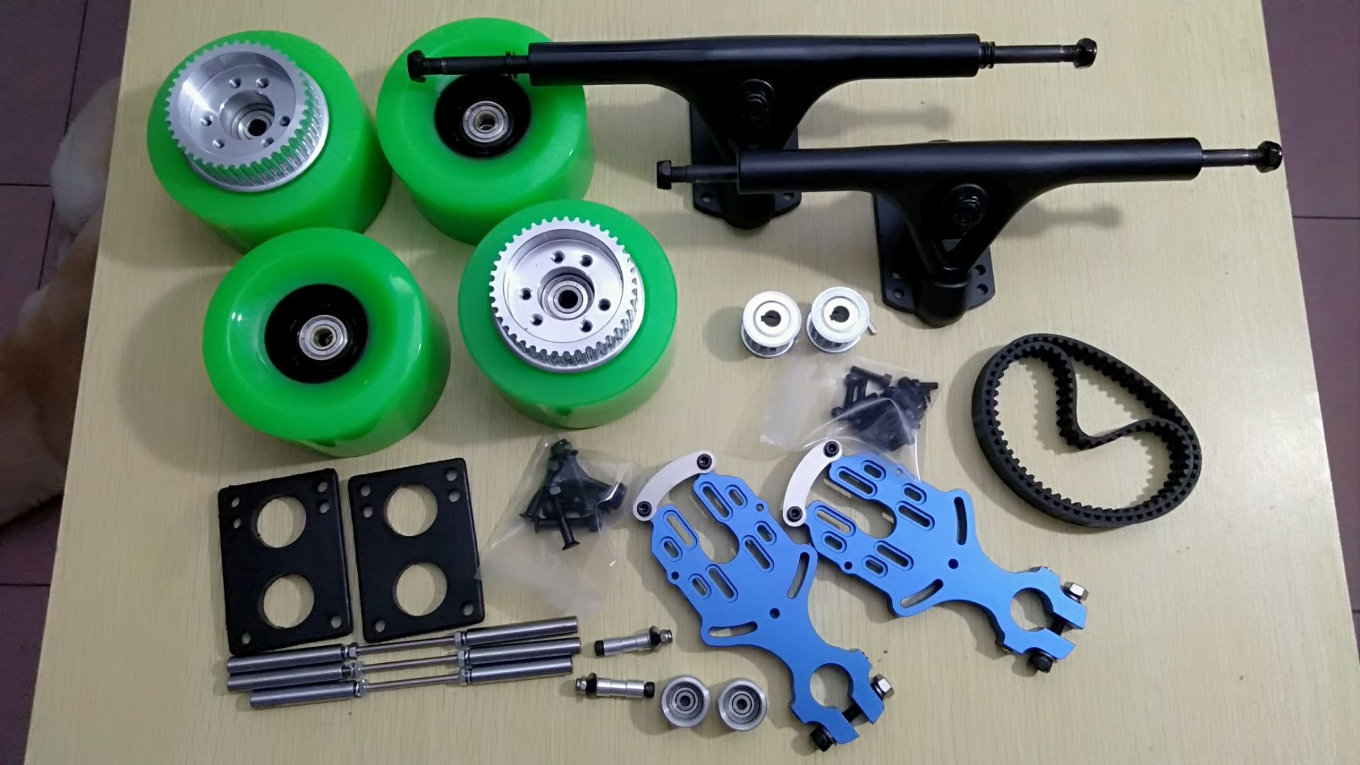

Trying to build a nimble board. Using all @dickyho parts. Picture attached is from @dickyho, he just shipped everything today. Still looking for a deck. Open to suggestions, but what I am looking for in a deck is around 40", drop deck, and with a kicktail. Below are the closest boards I could find so far with the specs I want.
Would like to mount the motors in the forward position to take advantage of the kicktail. Wheels will be 97mm or bigger. Motors will be 6355’s dual. Have not sourced a battery yet, probably going to take the battery out of my other build for now, which is a 12s5p.
Open to any other suggestions you guys may have. Will post more pictures once the build starts.

Parts I am getting from @dickyho
I have the first board you posted( except its the bamboo version) but I had that exact one before it got stolen. I like it just fine. I also have a 12s5p but with a battery that large I wasnt able to mount my motors under the board. Unless you have a double stack pack you wont be able to fit it either.
Found the board I want to use but do not think they sell it anymore. Anyone seen a similar board?
