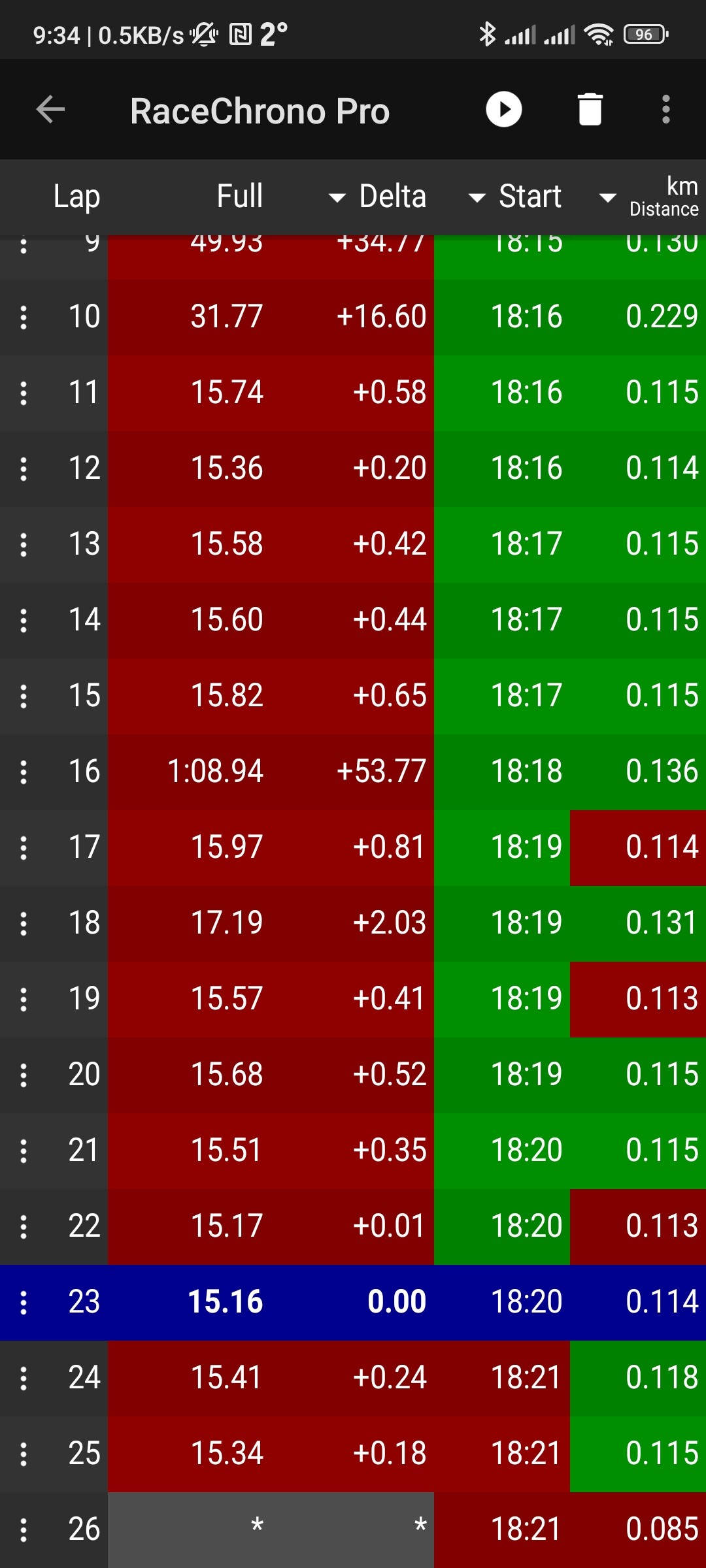

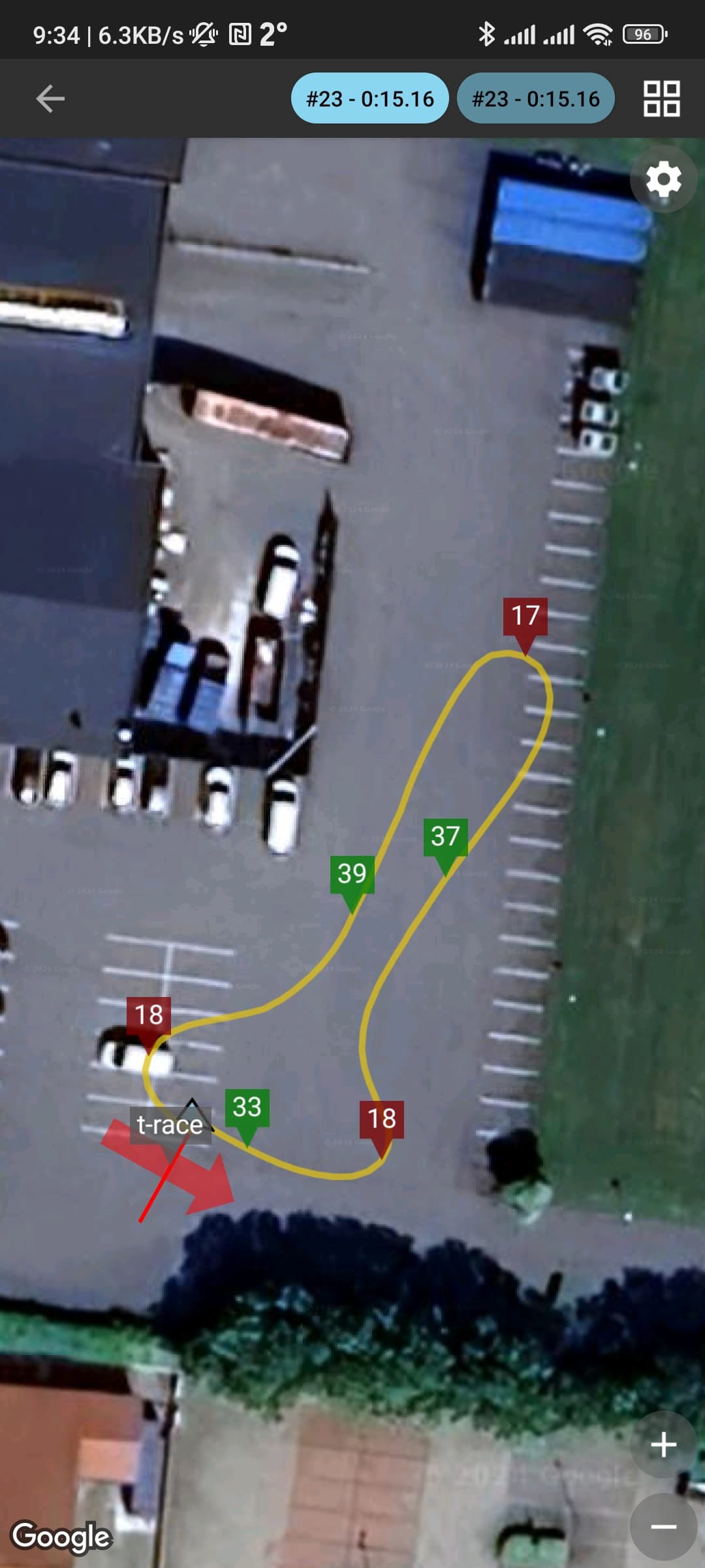

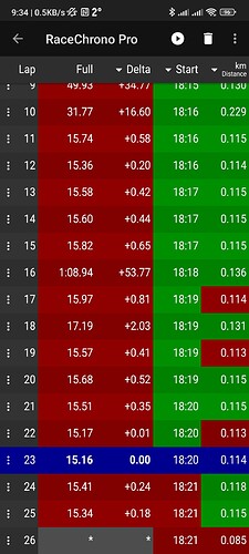

I didn’t balance the wheels just yet, but I’ve been t-racing yesterday.The toeside lap didn’t record, but I think it was really fast - I kept sliding around in corners. Even with the 9x3.5s. Turns out I need to have a separate “track” configured for it each direction in the racechrono app. I also crashed out a bit and broke the remote AA battery holder clips - so I had a very inconvenient dead man’s switch on the way home. lol It’s electrical taped together now.
Before that though, I could get times for my heelside.
15.16 single lap
15.16 15.17 15.41 3 lap challenge.
I felt more confident in the other direction, hopefully I can get out there today as well and time it finally. My first goal is to be under 30 sec combined - that should get me to the first page in the rankings.
Also, the board could go faster and the straight is long enough to accelerate and brake harder. I struggle a bit with the traction while braking, but once I get used to the board a bit more and sort out the balance of the tyres, I should be able to go faster on the straights that’s for sure.

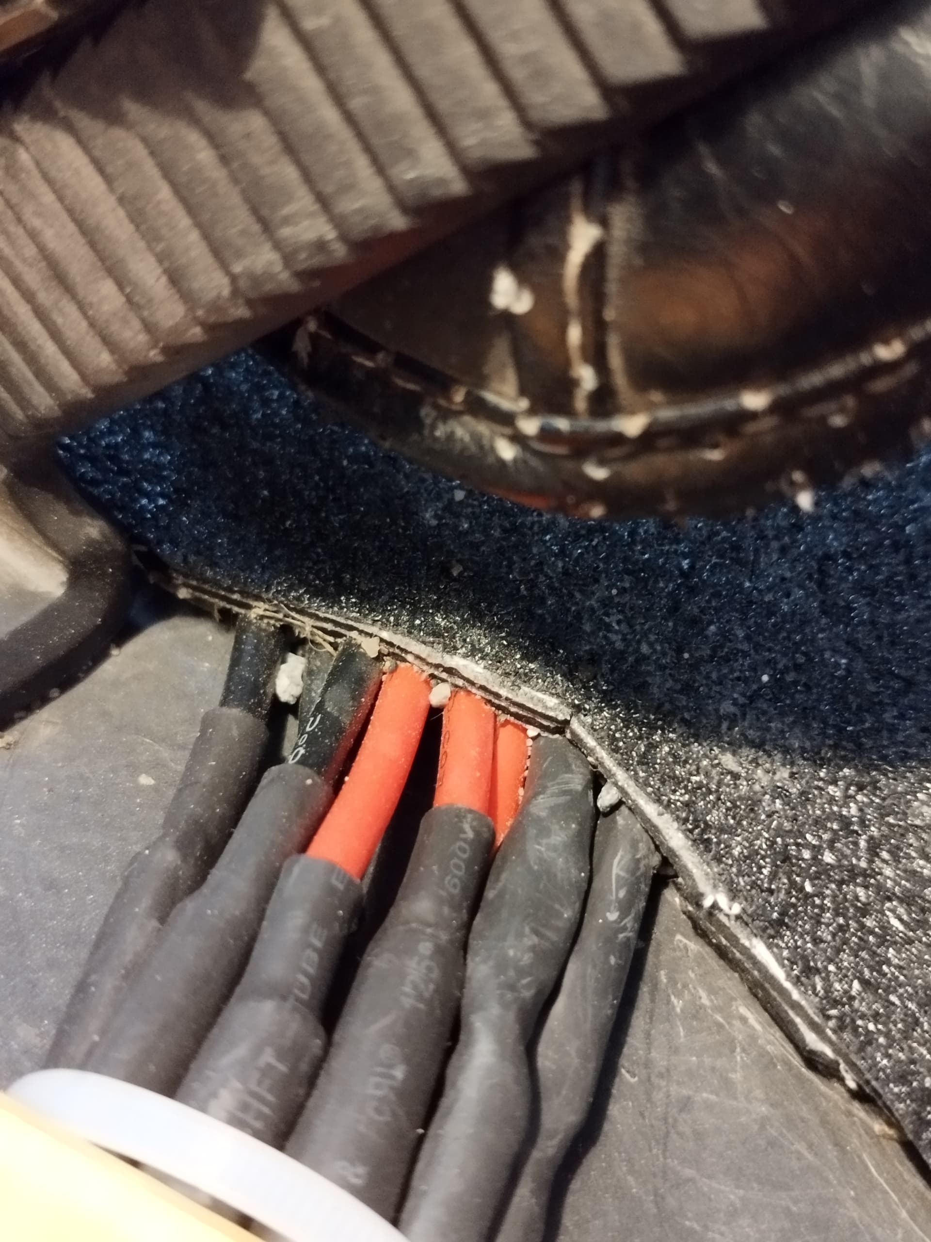

Also I have a slight worry
Small rocks keep flying into where the cables come out of the footpad. Hopefully they are not going to cause issues…
a dab of black hot glue between the gaps?
It doesn’t stick the to silicone but it should stick to the heatshrink and the footpad… I will give it a try. These slicks keep throwing rocks everywhere lol
Thats perfect. It just creates a really easy to remove gap filler

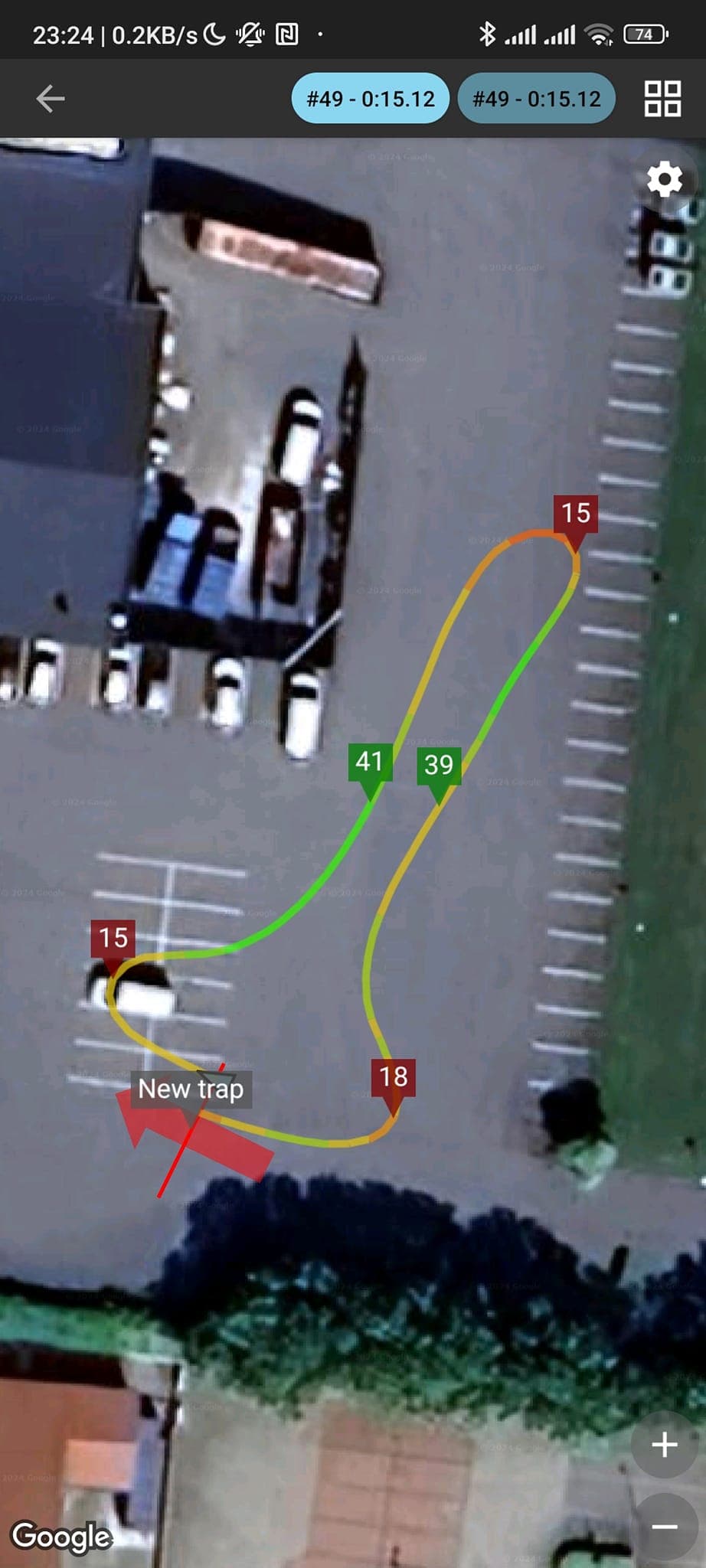

Also finally got a toeside time today on the T-race - single lap 15.12, triple lap 15.17 15.31 15.16. Interesting how tight my lines were. I keep doing super tight lines on toeside. Not sure if that’s ideal.
I didn’t feel in the zone though and the weather was really bad. Windy and really cold, nearly freezing even. Hope I didn’t catch a cold :grimacing: The wobble is not present at 40-42 kph now. I haven’t got faster than that today though. Hopefully it’s not gonna come back at the race in Prague.
Today I could only push the tire to it’s limits once (while cornering). In this weather it’s impossible to heat up the tire to a decent temperature, but I still had enough grip, so that’s nice. However I need to practise braking - I keep losing traction while braking hard, so I have to brake too soft and early and this definitely sacrifices my speed in the straights. I can’t really predict where the limit is. Probably the tires being super cold doesn’t help with this.
The weather is not gonna be nice this week so I don’t know if I will have another session before the race in Prague. I really want to get under 30 seconds combined though. Hopefully it will happen at the next session. I definitely feel that there’s quite a bit of room for improvement.

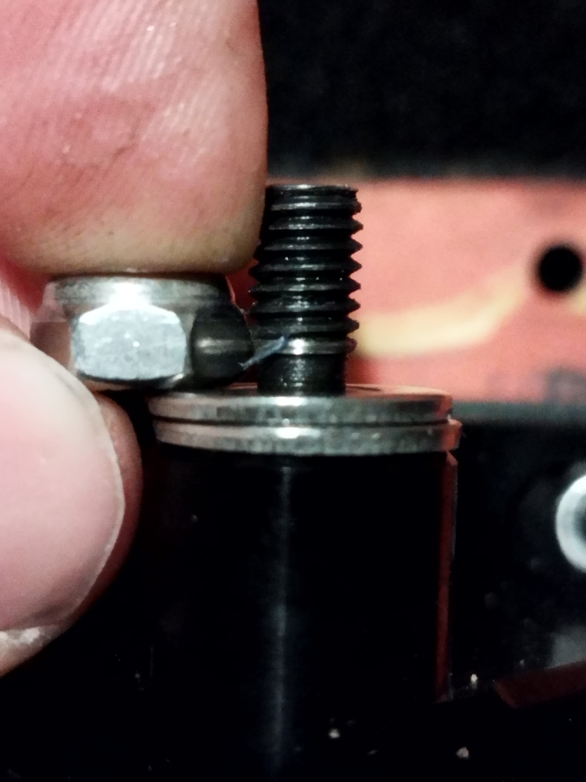

Holy shit I just it figured out. Now I could push 33 mph in a straight line and there was no sign of a wobble. It was the tightness of the kingpin. And not that I didn’t tighten it properly - I did.
The issue was bad thread engagement at the kingpin. Only one metal tread was engaged and ~3 nylon threads. It wasn’t enough…
I added 4x washers on each side and tightened the kingpin again. Suddenly the board is stable… 33mph was no problem in a straight line, couldn’t try on the track yet though.

I also agree that the @Boardnamics kingpin needs to either be a few mm shorter so you get full thread engagement, or more spacers/washers are needed like you ran. I think I put a couple extra washers on mine too.

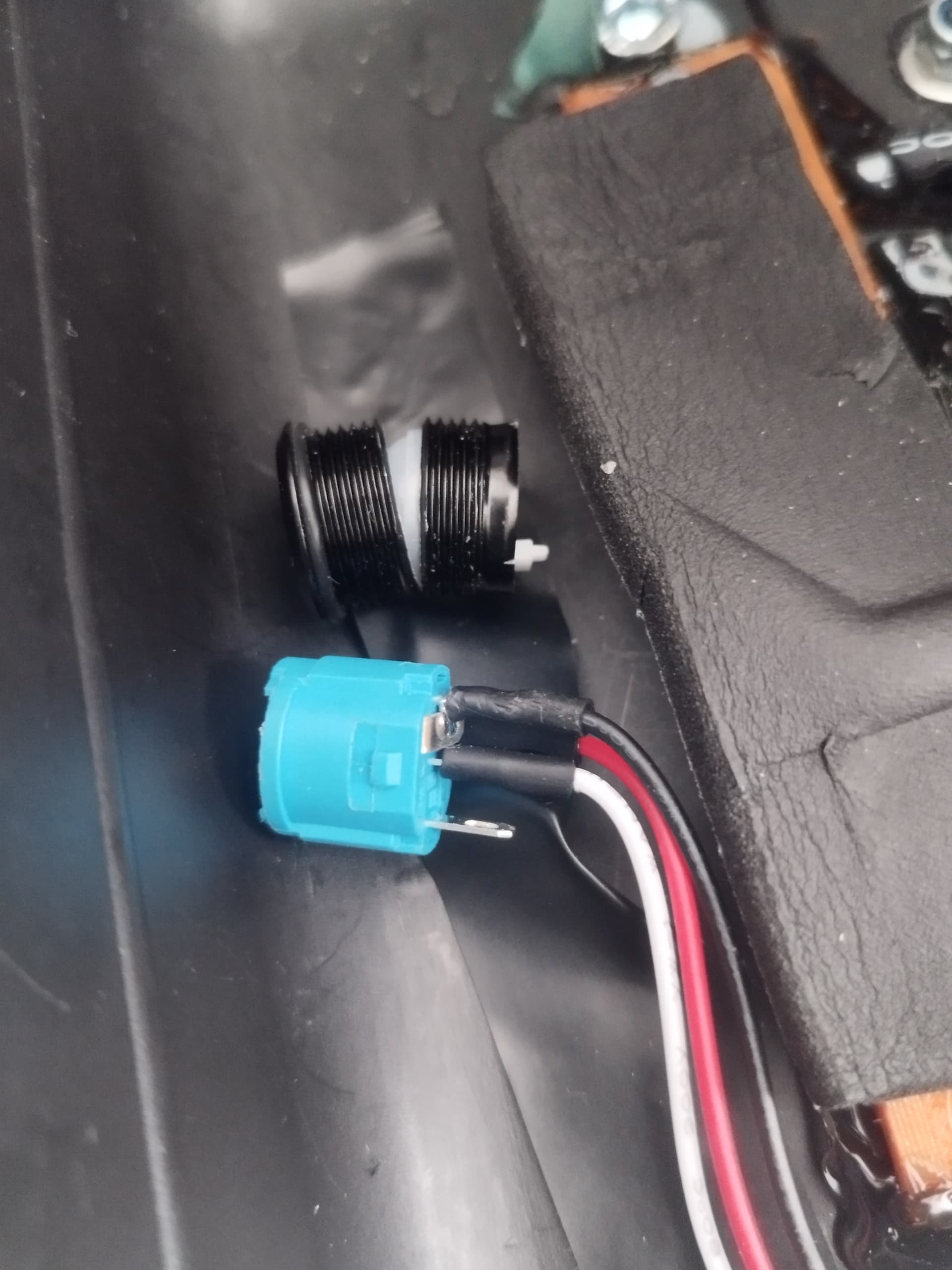

Also as we were travelling to Prague, we had to emergency brake on the highway and the battery moved a bit, breaking the on off switch into pieces
I’ve sent makerx a pm asking if it’s possible to order an extra one, I need a dv4s for my summerboard anyways. In the meantime I need to hold the switch together by hand and it’s still working, but kinda annoying having to take the battery out everytime I want to turn the board on

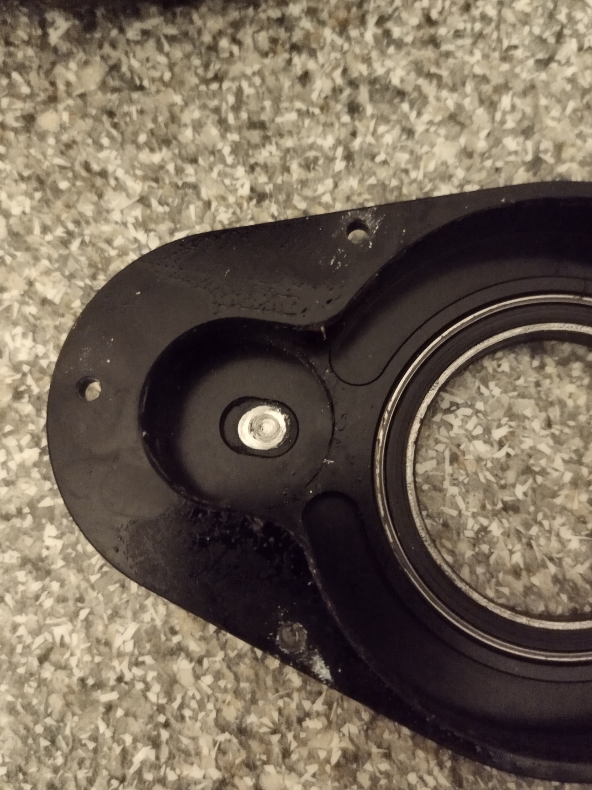

And as we were nearly home, I jumped a speed bump, and the motor moved in the gear drive.
Also somehow the shaft of the motor managed to scratched the gear drive casing
I have no idea how that could’ve happened as the shaft is still in its place (doesn’t look like it moved in the motor) and if I have the casing on its not scratching it at the moment - and also it wasn’t scratching it when I assembled it.
