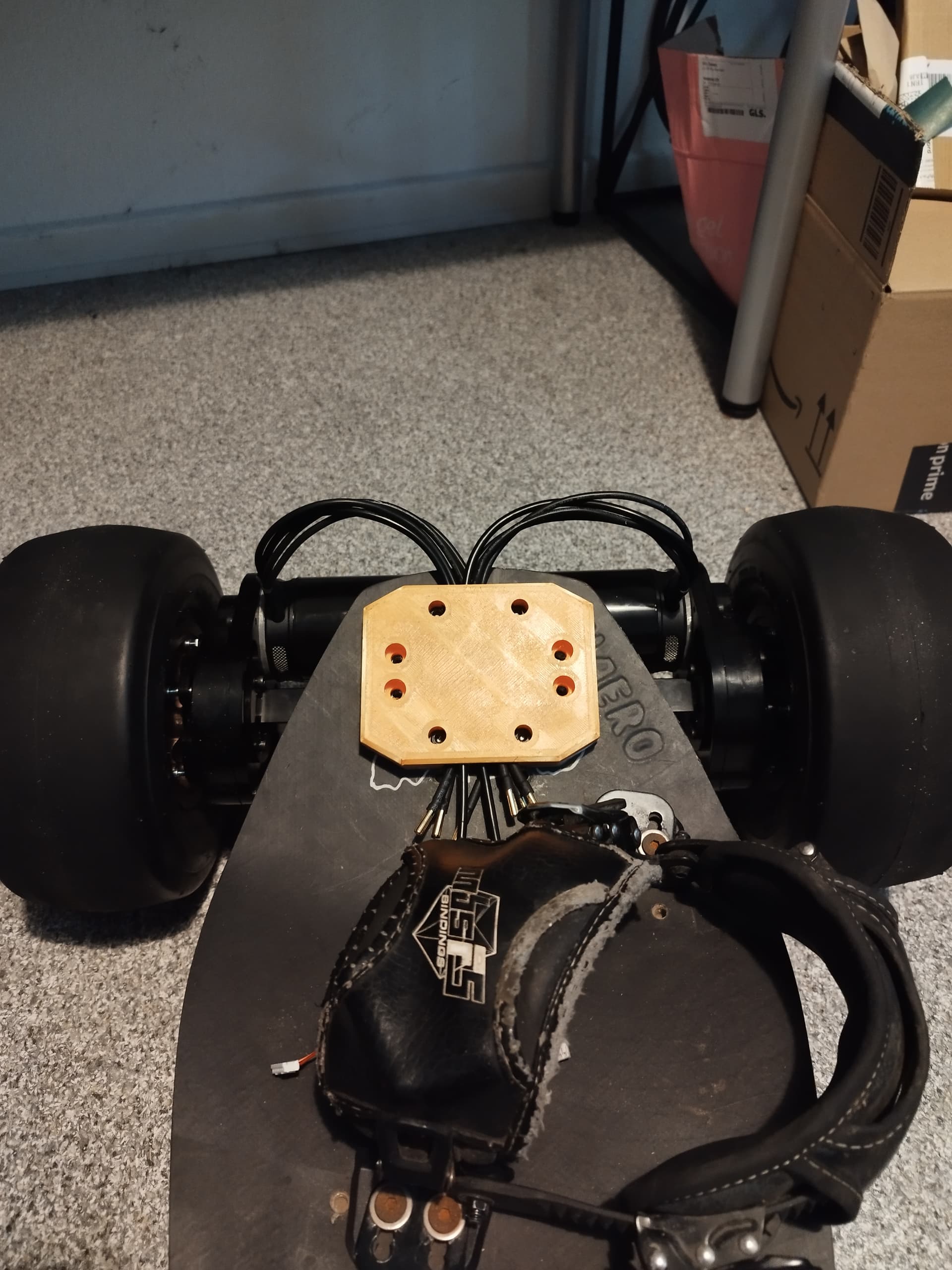

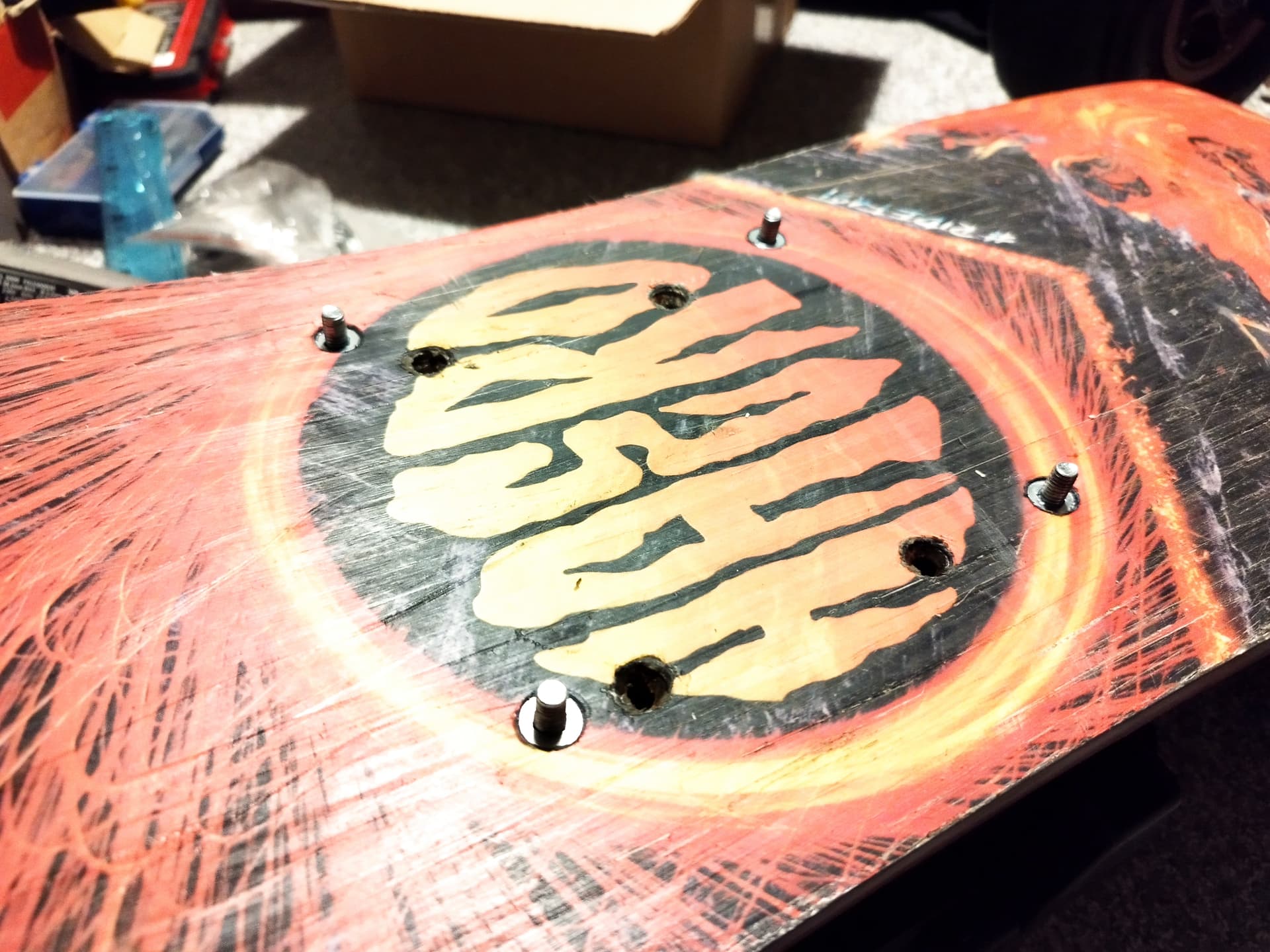

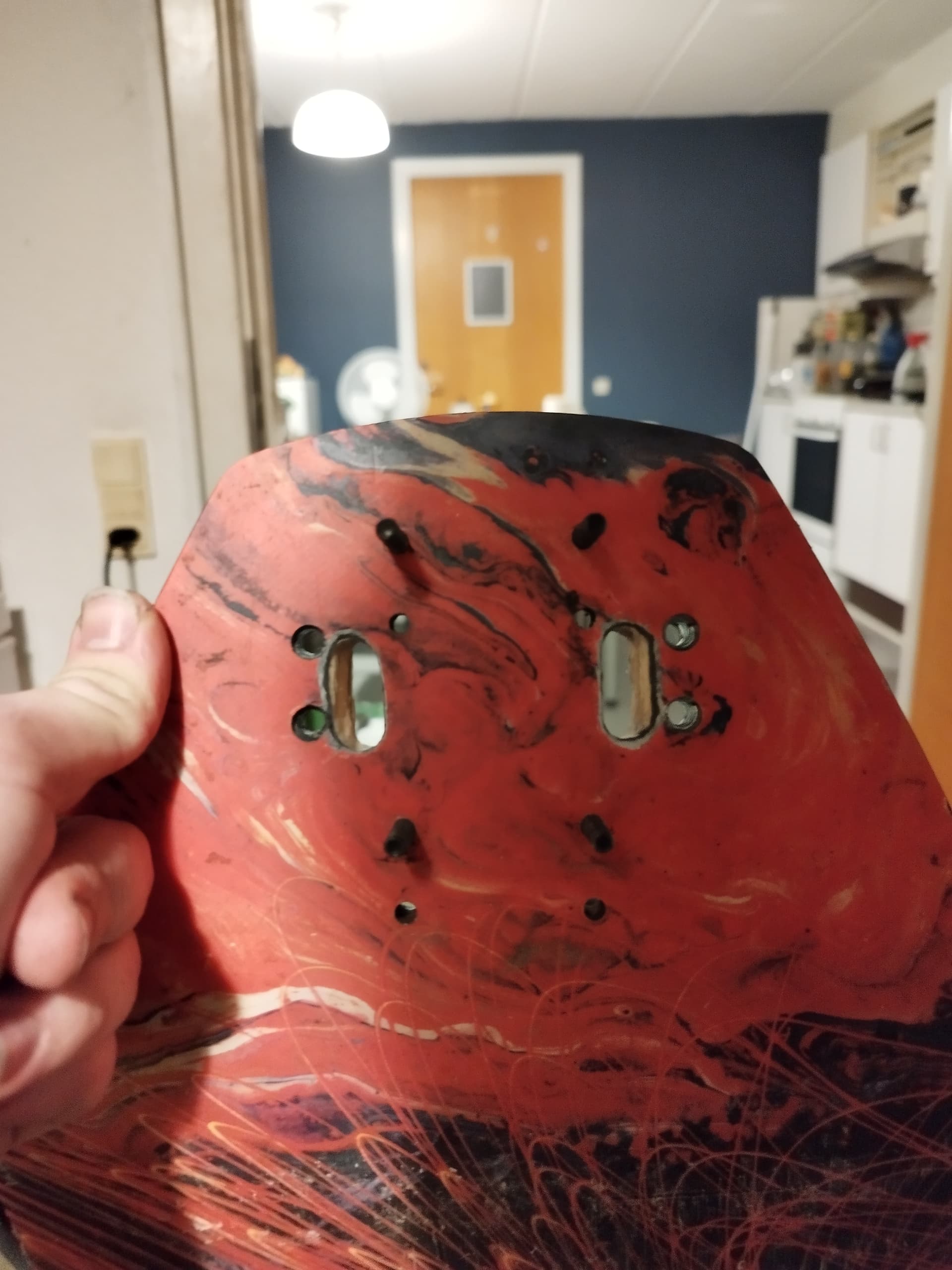

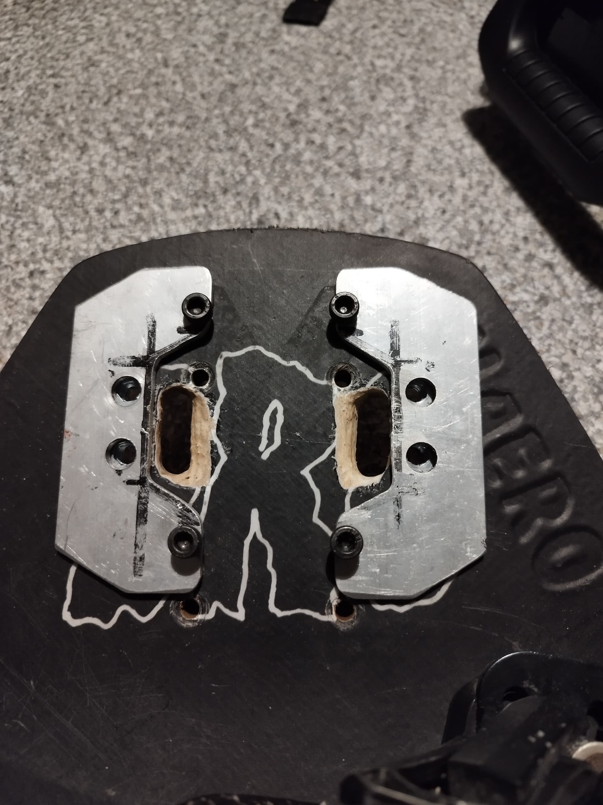

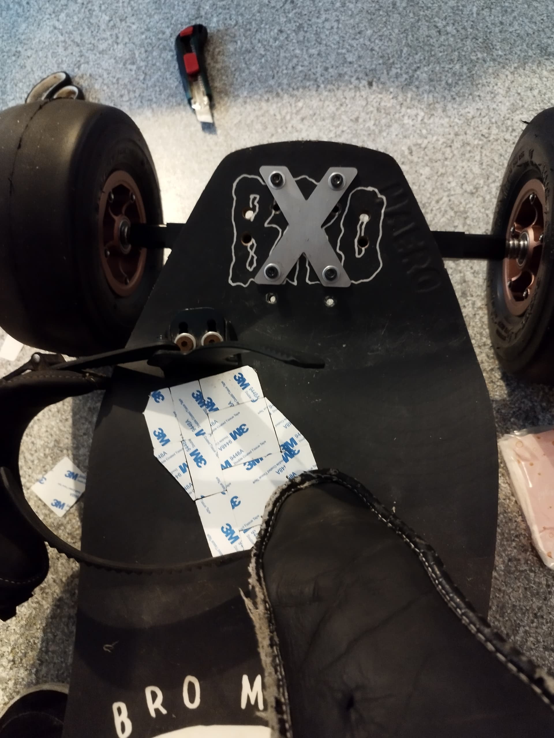

I drilled out the deck with a dremel carving bit like how @Shadowfax 4wd lacroix is.

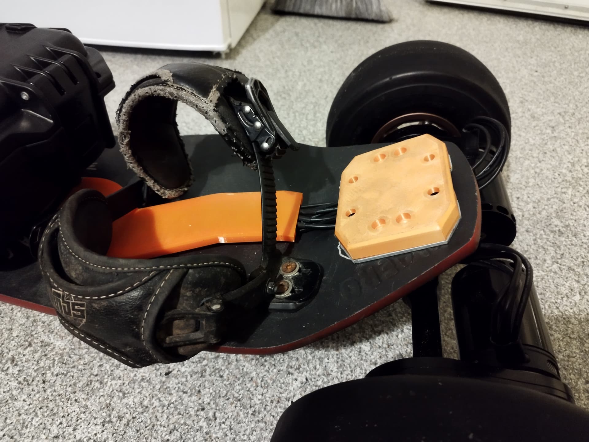

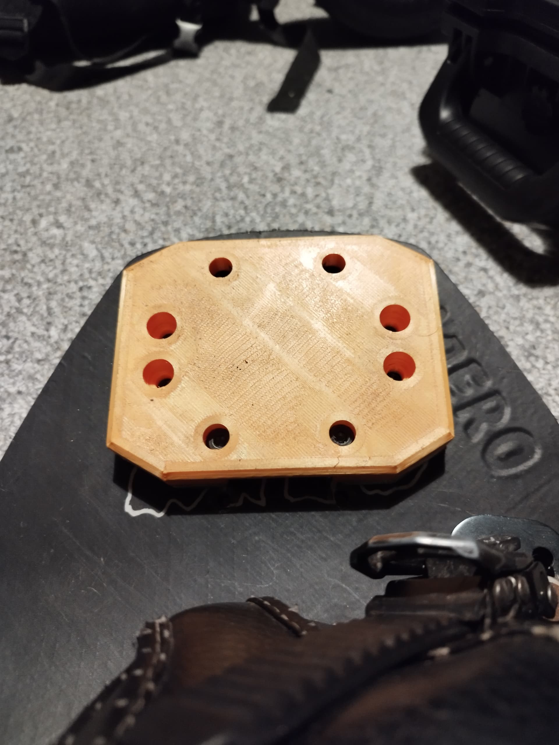

Also finished fabricating these anti sink plate thingies with the angled grinder to go under the 3d printed cover, and I installed threaded inserts into the deck into the binding adjustment holes for spring trucks, to have the 3d printed cover mounted.
Now, I am going to reprint this in black later down the line (I think the colour looks shit) but this is the only filament that I had enough of and isn’t TPU (that I just didn’t want for this part) or nylon (that I can’t successfully print).

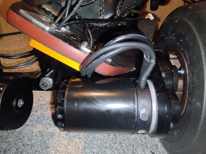

Then I pulled the motor cables through just to take a photo of the whole cable management system
I will have to print a riser as my current half inch riser doesn’t work too well sadly. It does the job but the cable could rub on it as it’s a tiny bit wider than the hole. I couldn’t angle the hole sideways as much as @Shadowfax because of the threaded inserts that I installed there, so I am going to print something that fits better.
And I also setup the bindings into their final positions, and added a small W to the front:
This is a 3mm thick foam that doesn’t really compress much with adhesive on both sides. I still have to apply the griptape.
I am also going to fill up the rear a bit with this foam, so that the cable management guide there makes a very very subtle W, then apply the griptape there too. I have some 24 grit griptape, so hopefully that will work decently even if the board gets muddy :upside_down_face:

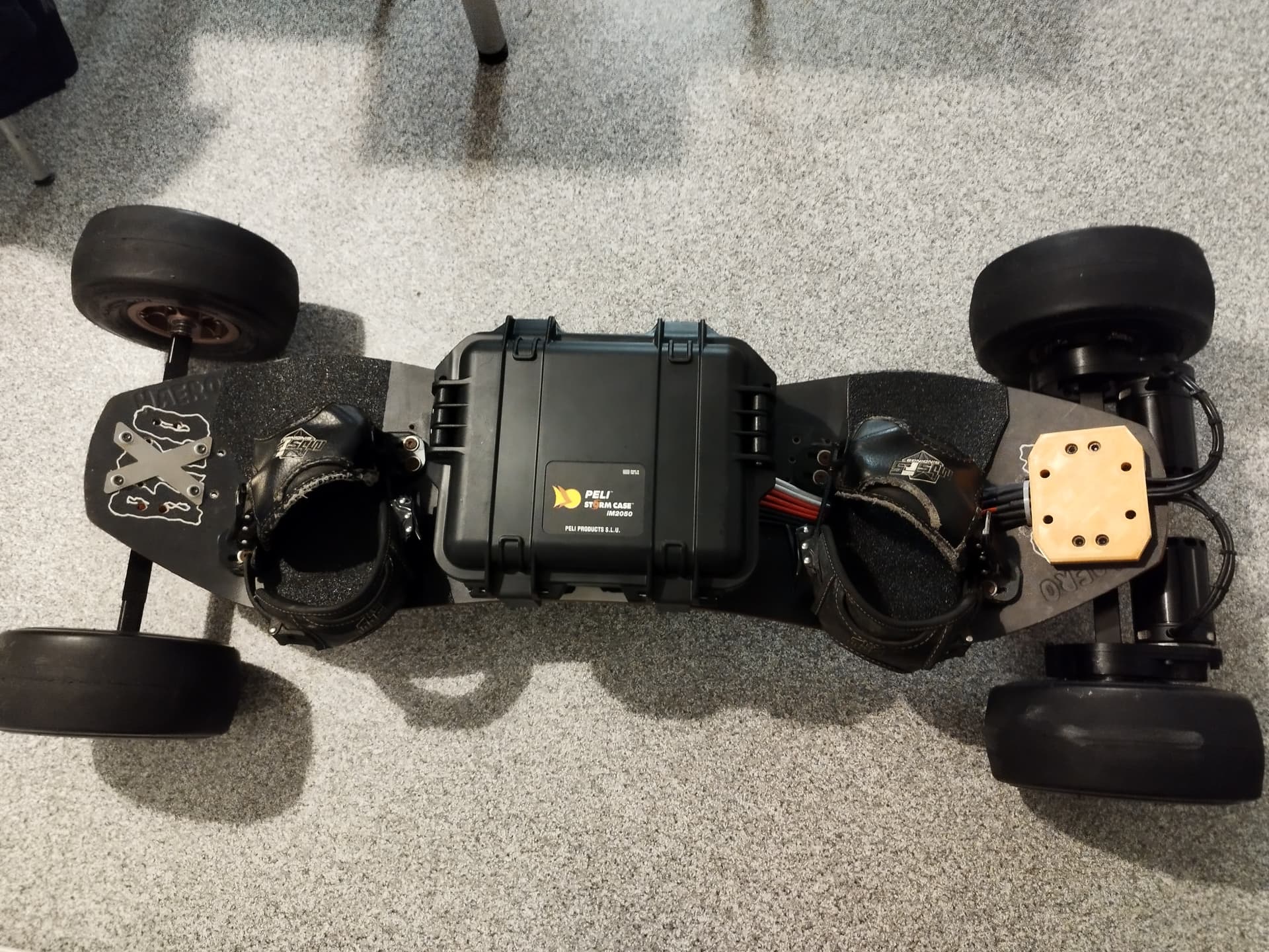

Anyways, here’s the close to final look:
And I hope I can finish it tomorrow. I still need to extend all the motor wires and have the enclosure mounted. I was thinking about ways to mount the enclosure. I either do it the same way I did it on my previous board - 4 bushings as standoffs, screw goes through deck and enclosure, or install some threaded inserts from the bottom (and still have the standoffs of course). I kinda wanna do the threaded inserts, but I am not sure if I trust myself enough to be able to drill 100% perpendicular to the deck 4 times in a row :rofl:

I got some work done today, didn’t progress as well as I wanted though. First, I was waiting until the evening for 3d prints to finish.

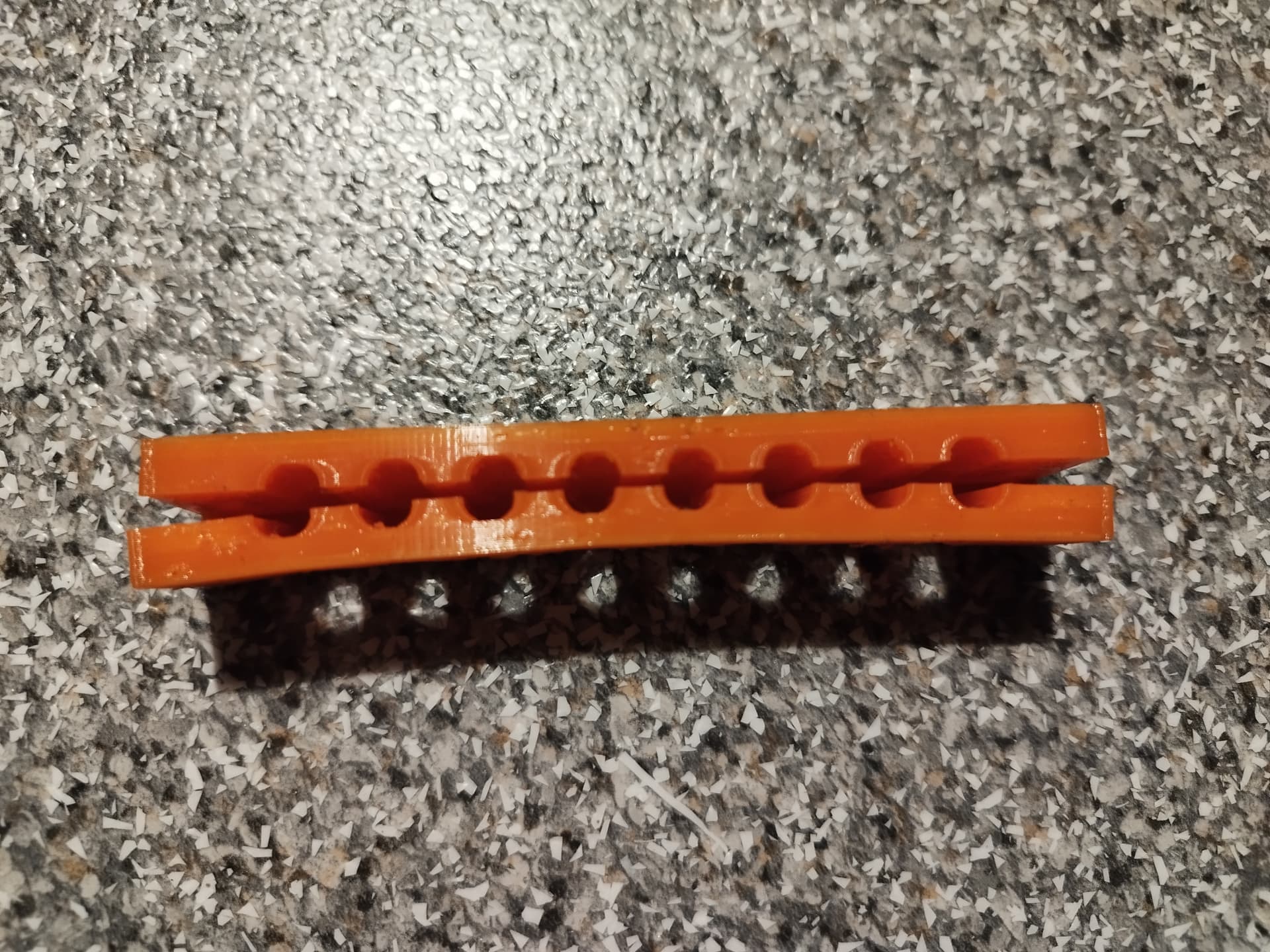

I designed and printed a riser, spacers between the deck and the box, and these cable guide thingies from tpu to get the cables out from the enclosure.
I didn’t have the time to install these cable guides yet though.
Next, I installed 4 threaded inserts into the deck with jbweld (I am gonna put shorter screws in there, I just used these until the jbweld cures)

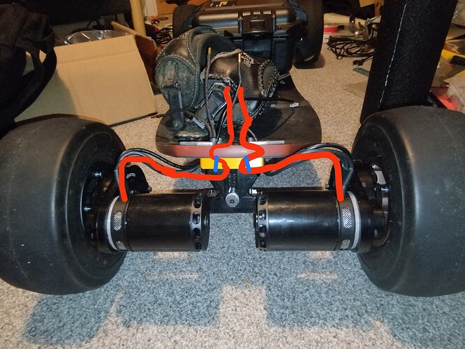

This is how I originally intended to run the motor cables up to the top. That ain’t gonna work.

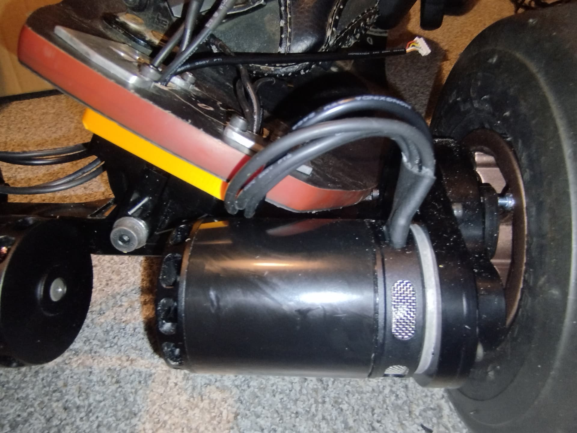

Then I thought what about running them at the hanger
But that’s also not going to work because I am utilizing the full lean of the truck, and the hanger does bite into the deck on hard lean.
Then I had the idea to run the cables through a tunnel riser first, then up through the deck. But then the cable take quite a few turns… It comes in straight into the tunnel riser, goes to the side of the riser, goes up, and then goes back to the middle under the cable cover thingy. I am not sure how much the cable would like that many turns though.
I’ll think about it more tomorrow, I am going to sleep now.
Maybe you need to run them directly to the top of the deck and into a tunnel anti-sink plate?
That’s probably what I would do. In my top mount esc enclosures I use cable glands out the back, works pretty well
When I designed the orange cable cover piece I (unintentionally) did it right - I can use that as a cable channel as is.
So I am going to assemble it like this now. And maybe change it one day to the tunnel riser.
This means, that I only need to get the cables to exit the enclosure and extend all the wires. Plus get the wiring done inside the enclosure and program the vesc. I should be able to get it rolling today.
I couldn’t finish yesterday, but today I finally finished it.

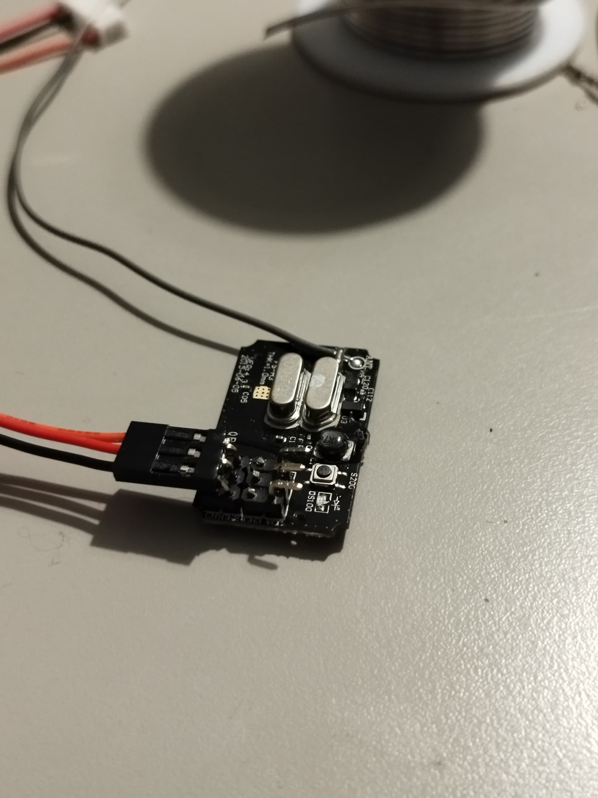

I needed to mod the receiver because it took too much space vertically - took it out of its case and bent the pins sideways (and hot glued the connector so it stays in)
I ended up not using the printed cable channel, as the fit was not perfect with the cables inside
I stacked these small 3m foam pieces with adhesive on both sides to create a channel and a W concave.
I also had some weirdness setting up the vesc. First, I did manual detection, both motors detected about 12-13 mOhm. Then I did automatic detection once, and from that point in it kept detecting first both motors at 36-43 mOhm. Then I realised I messed up the hall sensor wiring, fixed it, downloaded the latest vesc tool and rerun the whole setup from the beginning. Then one motor detected 13mOhm, the other detected 36 mOhm. I ended up just setting the 13mOhm motors resistance, ki, kp, and gain onto the other motor as well and it’s working well so far :man_shrugging:

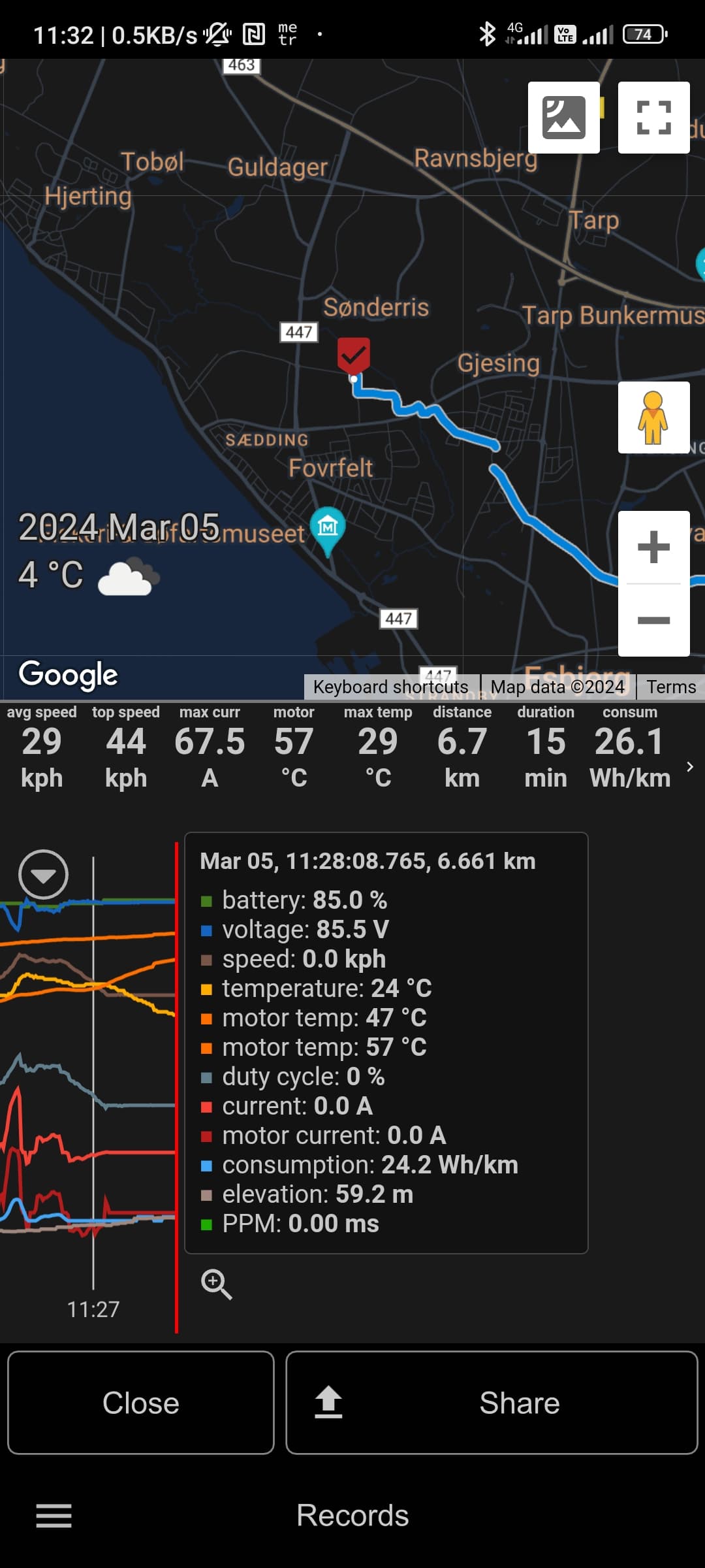

Slight issue. The motor temperatures read unconsistent- not sure if they are actually different but it’s possible - I am going to check it physically after the ride home.

here’s the full metr log

Follow up on the temperature sensor issue and this.
At work, I felt like the motors heated up differently. After having redone the configuration for this side (now with detection automatically setting the right values for the resistance and everything calculated from it, instead of me setting it manually) the motors heat up to the same temperature, so the issue is partially solved.
However. One of the temperature sensors is still kinda weird. Its like if it has very poor thermal conductivity to the stator. It’s visible in all the logs, that the temperature differs usually about 10 degrees while riding (sometimes maybe even more), but once stopping at the end of the ride, the “bad” sensor keeps increasing in temperature, settling to the same value as the other in about a minute or two.
https://metr.at/r/4BJZD
I don’t think I can do anything about this, can I? I will send reacher an email about this, but to he honest I am not expecting them to resolve the issue. That’s the price for buying direct I suppose.
