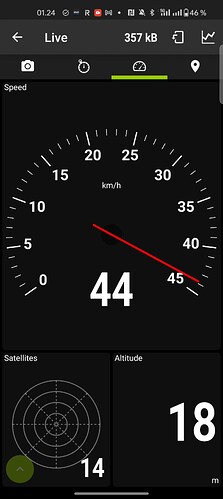

Hit 44 km/h / 27 mph on without the slightest feel of instability. Up to about 20 mph I even tried to induce wobbles, but nothing. Didn’t dare to push it faster but if you are gentle with your inputs you don’t need rear bushings on dualities… :exploding_head:

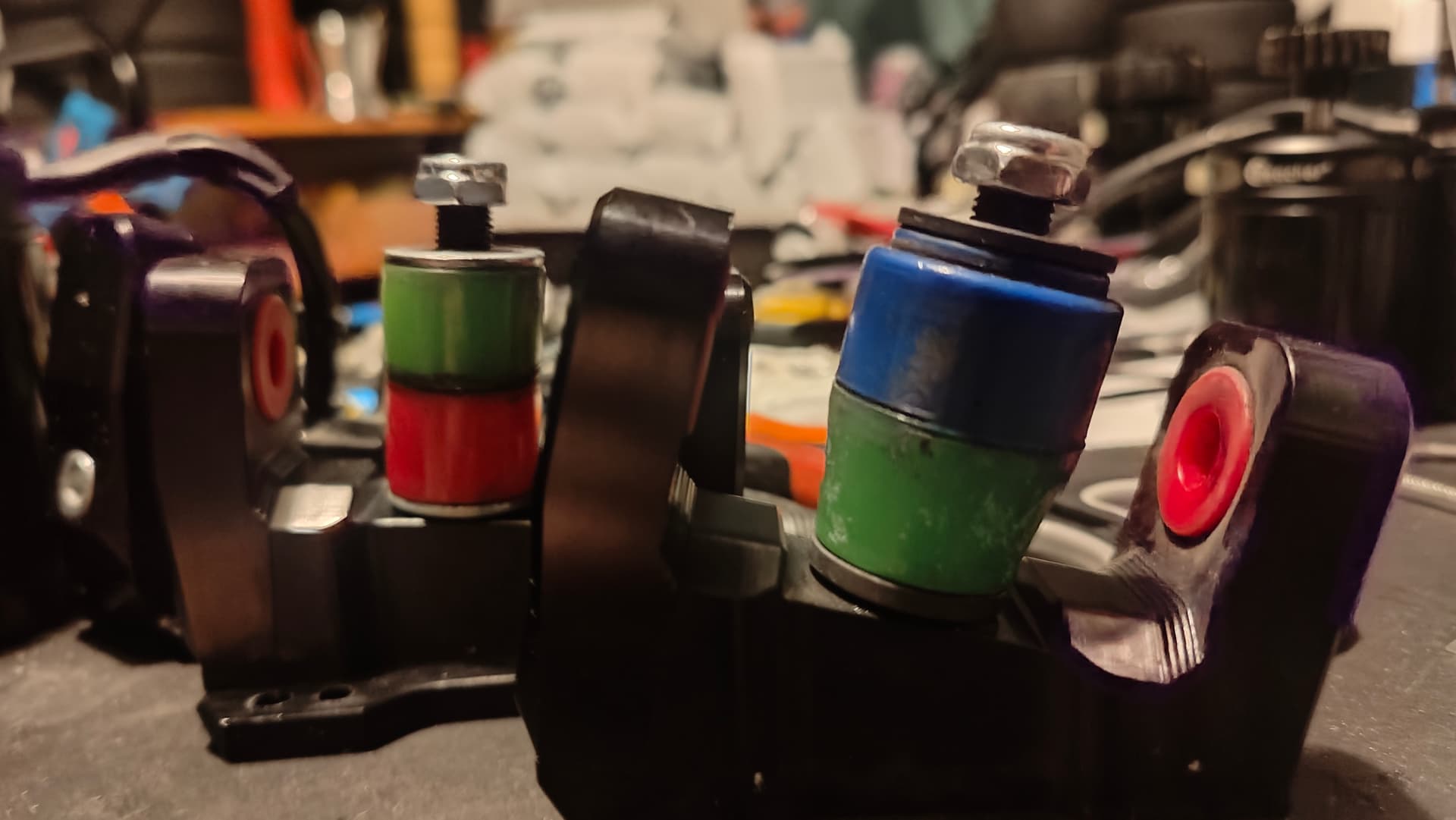

Now finally both me and Tilo had a rideable board. Next day, qualifications. Started off by tweaking my bushing setup, ended up settling on this all WFB combo, feels nice, a little divey, easy to turn, while offering enough stability for the straight.
Front 93/95 barrel, rear 100 chubby / 95 fatcone, all tall WFB.

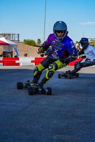

Saturday, heats. All went cleanly, and I just about made it to the finals. Had my fastest lap time during reverse grid:
Sunday, finals. Ended up messing up the launch and dropping to P12, then fought my way to P11 through Joshua, then put on some pressure on Tucker but didn’t manage to overtake. Then Brady crashed out so my final position is 10th.

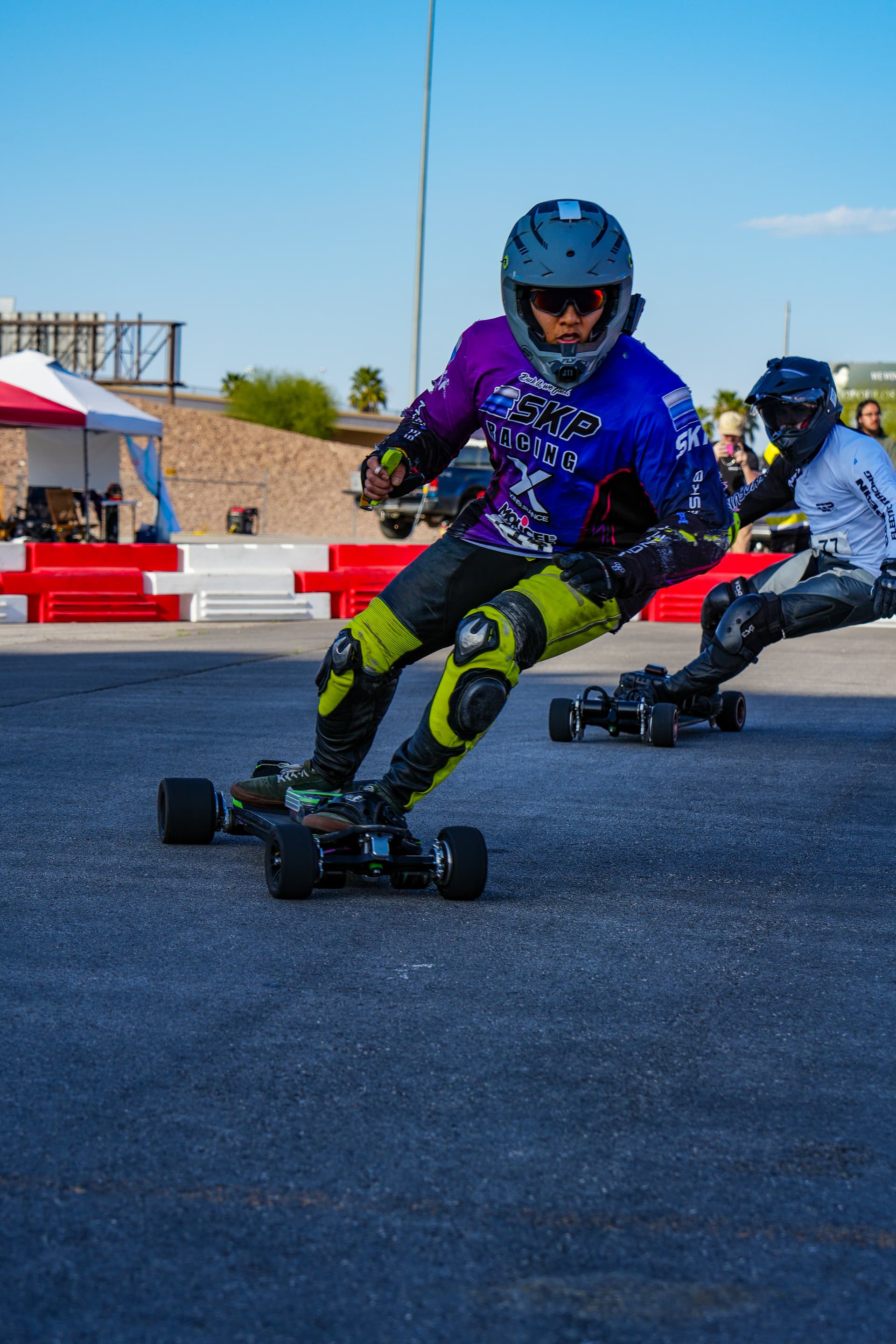

Zooming past the straight.

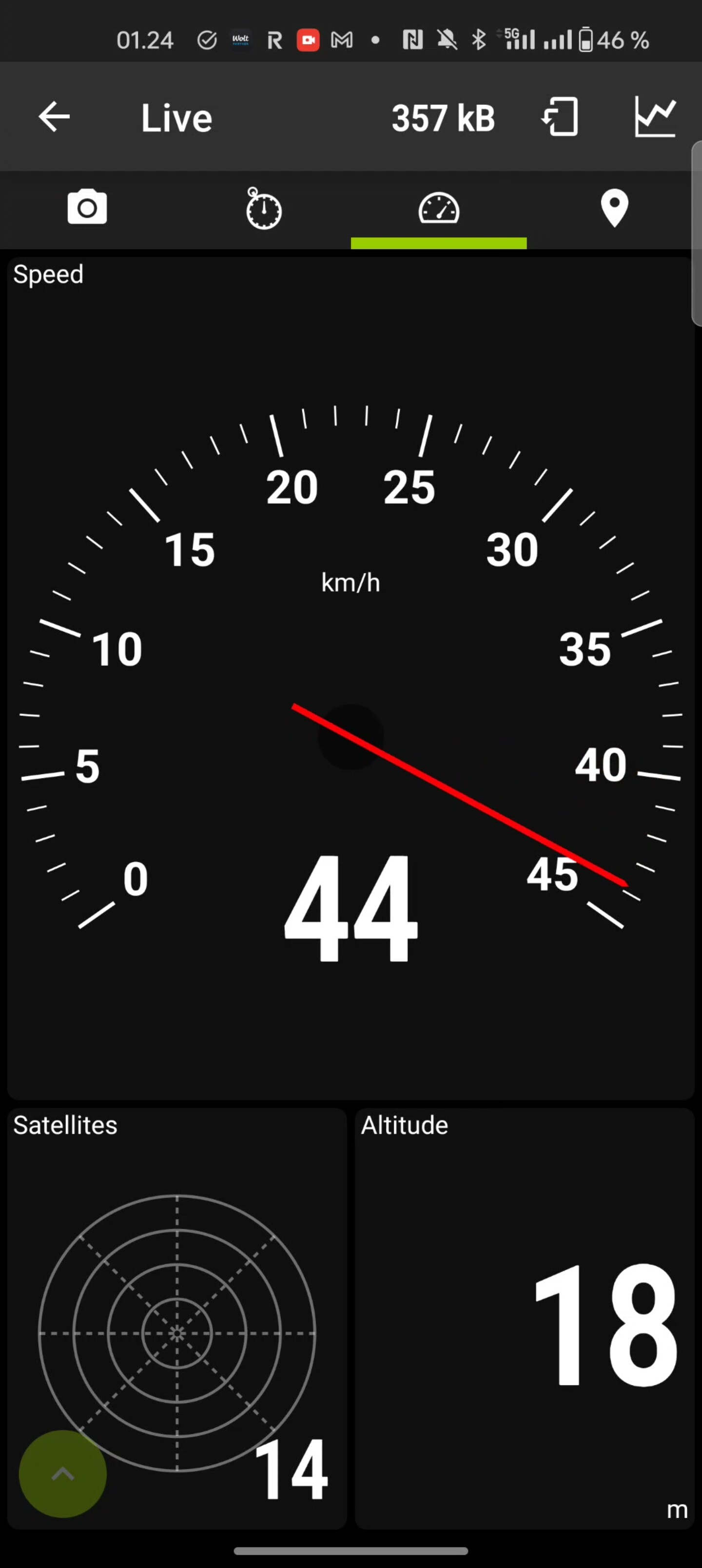

My top speed during the finals ended up being 71.9 km/h or 44.7 mph according to racebox which is also a new record for me actually.

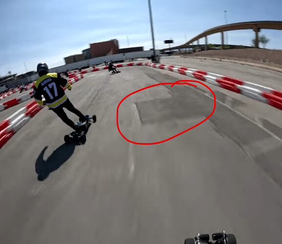

Here’s a POV of the pro finals:
was your board not jumping going over that square? i pretty much had to avoid it like the plague unless i wanted some air time
I was hitting it on purpose. i liked the line.
but yeah it wasn’t nothin’ :slight_smile:
I actually didn’t even notice it at all hahaha. I guess maybe in Europe we might be used to racing on cracks more?
i never attempted it after i got thrown in the air the first time although i should’ve tried different ways of hitting it during practice. oh well

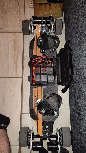

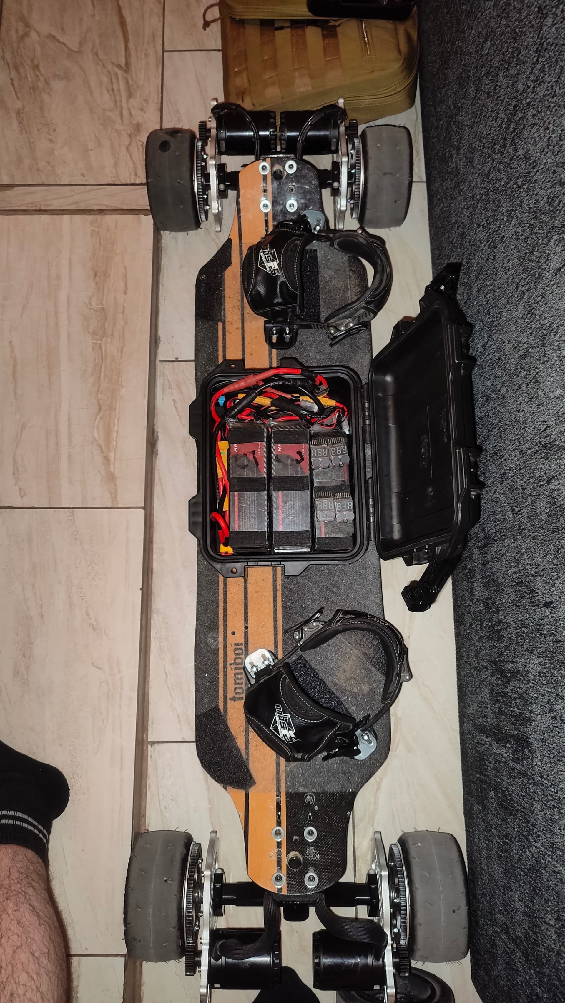

She’s back together! I’ve decided to run the motor cables towards the hanger for a cleaner look, and it also makes me worry much less about stacking boards vertically in the car - no motor wires get squished where they exit the motor.

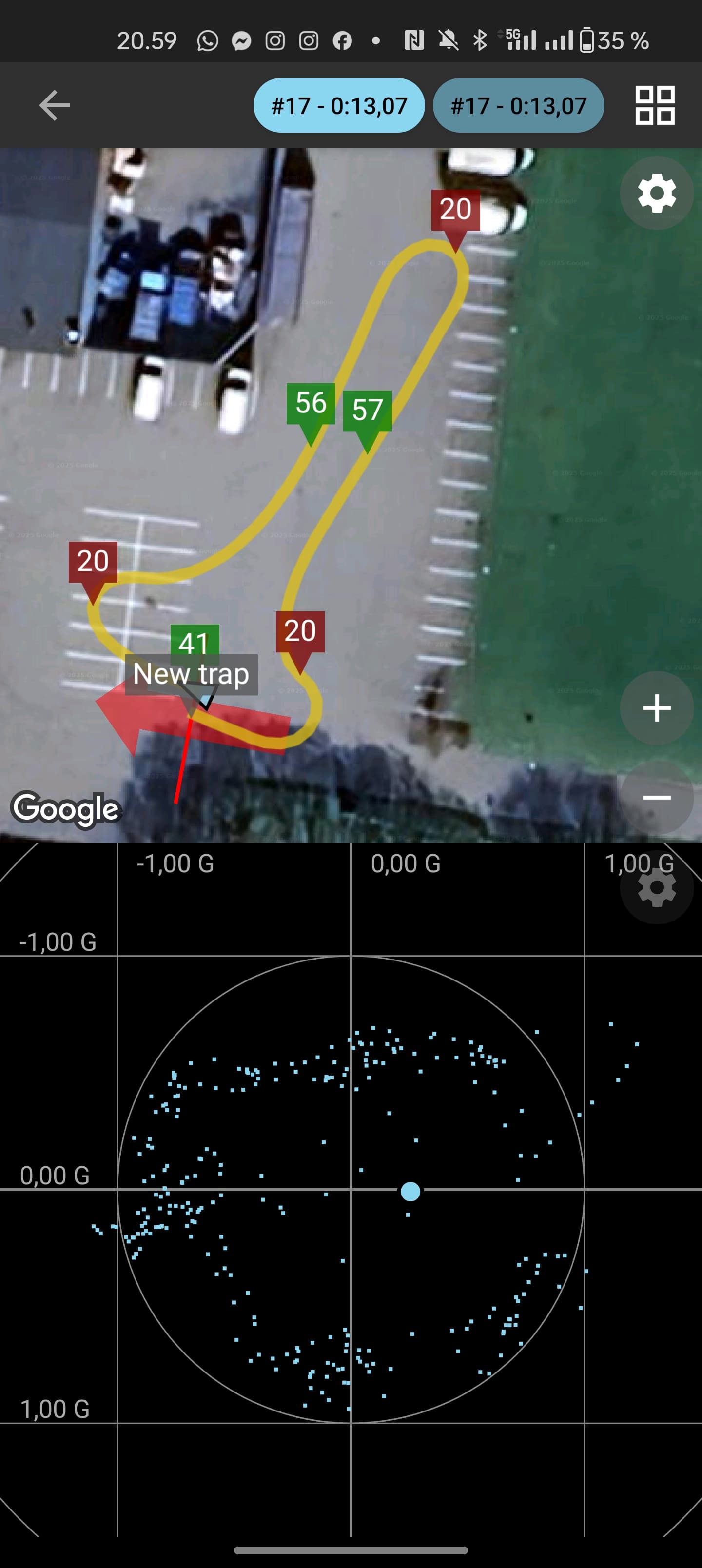

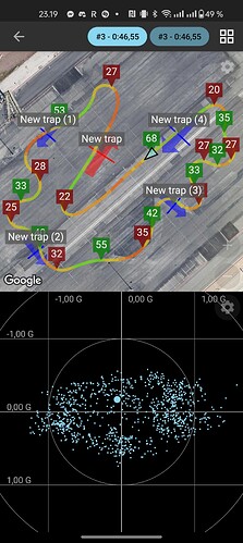

Also did a T-race session today with 13.07 toeside.
This is on my esk8con bushing combo btw. I could get away with looser trucks for T-race, but having a set and forget setup that works for anything from the tightest track to medium - large tracks, is just too good to pass up.
From the data it looks like no cruising, always accelerating some direction, just what I like to see. With a bit of luck I’ll be back in the 12s next session. Just gotta reinflate my tires with soapy water for better fitment so I feel the edge of grip a little better.
