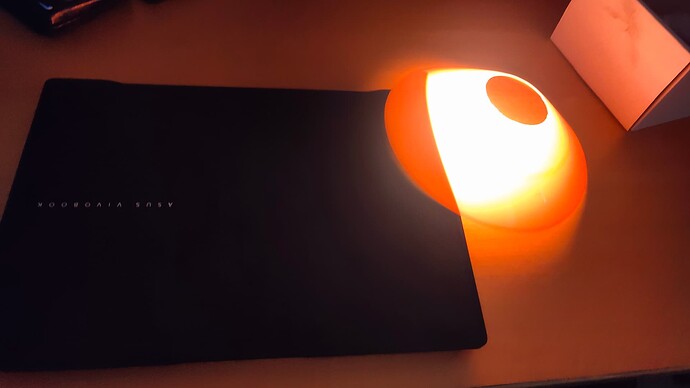

Just received everything for the LED cone sideproject.
I think I might have overshot the brightness a bit with 0.2 W LEDs.
The plan is to wire a single liion cell to each lighting module, use the TP4056 charge and discharge modules for charging, I need to replace that tinyyyy discharge protection chip on each one. The chip that comes with it shuts off at 2.5V, the FS312F ones cut off a little above 3V if i remember correctly. Then the voltage goes through the switch into the boost converter which steps it up to 5V. Then that 5V goes into these super small LED modules.

Cone lights are a fun problem that we don’t often have in Esk8- scale. Easy to build one, much harder to make a bunch. Have to come up with a design that’s cheap and quick to build, while also being durable isn’t easy. It’s a fun challenge ![]()
I think the time investment to make a single, custom PCB design would pay dividends
For the immediate future i just want something to do T-race with though thats relatively low effort on my brain cells, and I don’t mind sniffing fumes for a weekend. Funnily enough ordering parts for 5 vs 40 was like a 10$ difference though, so I might as well just build out all 40. Coincidentally I need 35 to setup the Aussie’s standard track, and my friend wants to do something that’s not T-race… So definitely going to try and set that up eventually but we can only do that at night.
If I ever need more or need to remake them, then I’d probably take a few days to throw together a PCB for this, it actually wouldn’t be too complicated.

designed up a small case to hold the leds and all the electronics, about 40g each, printing the first one right now. I’ll probably lasercut the top at work instead of printing it but we’ll see
about time I make these so that I can maybe still practice a bit before esk8con…
First module is done *
(I didn’t swap the ic so overdischarge protection is 2.5v)
It’s gonna work really nice though! Gotta print 4 more of these cases tomorrow!
