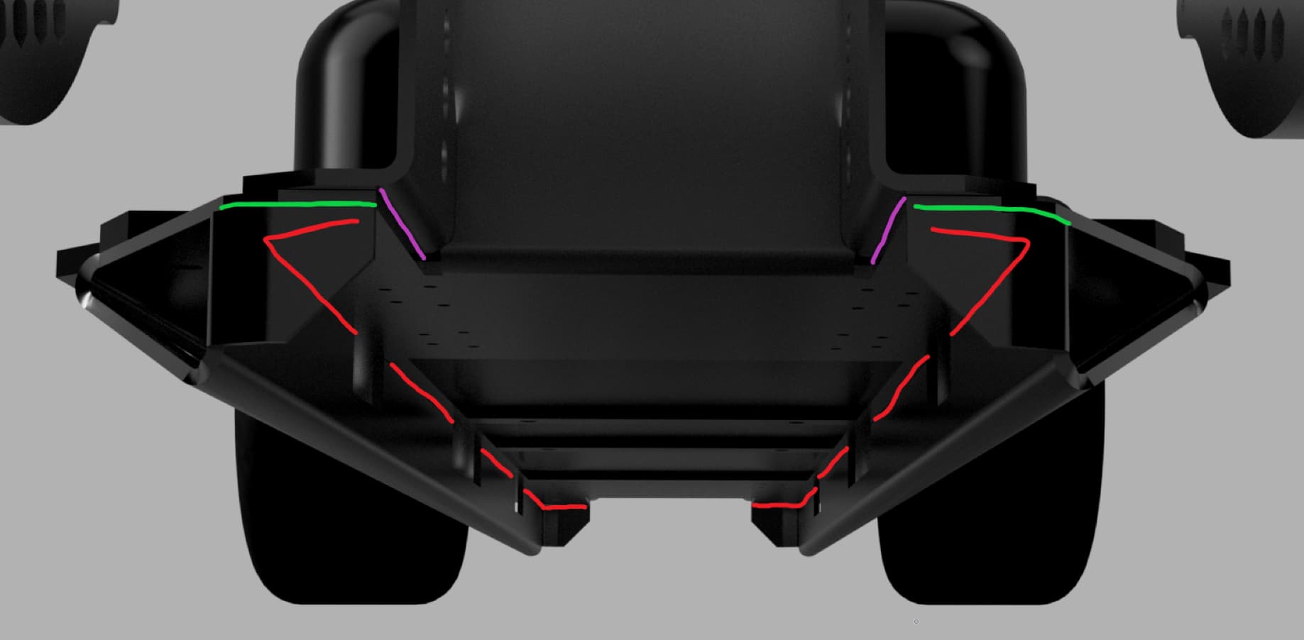

The vertical joint under the standing platform, where the sheet metal touches, is that going to be attached at all? If it’s not attached, the deck is going to be substantial weaker(the triangle sections won’t add as much strength as you expect). Also I predict it’ll make an annoying rattling sound

The plan is to bolt down the towers by 6x M8 bolts
Furthermore these edges circled by red will be welded shut. And also considering welding the tower down next to the bolt pattern after it’s bolted together tight.
Also I just added these flanges here to what my intuition says would have been the weakest point.
Also going to be welding along the red, green, and indigo lines. Will be tack welding everything then work on the red lines first so hoping that by the time those are done and I get to the visible parts my welds won’t be looking attrocious :joy:
Also having the bellypan and the deck bolted to the triangles is going to add a lot of strength as well. My intuition says I am probably good now but I’ll be trying to run some FEA nevertheless.
And also planning to use 80mm long aluminium standoffs in some of the unused holes, to give the tower itself some extra rigidity.

With it welded together I’ll be surprised if you need a structural deck haha
Might have better luck with rivets. More durable, lower profile, and lighter

I want to countersink all the M6 screws including the binding’s mounting hardware so I’m going 6mm alu on the deck so the head has enough meat around it and 3mm stainless everywhere else.
I think if the structure is designed well it wouldn’t have trouble with a car driving over it, the question though, is it designed well? Only FEA and real world experience will tell for sure hahaha. I just installed Ansys but I’ll definitely need to research more on how to use it well. I had one basic mechanics course at university and that’s it, so I’m not exactly a mechanical engineer :sweat_smile:
