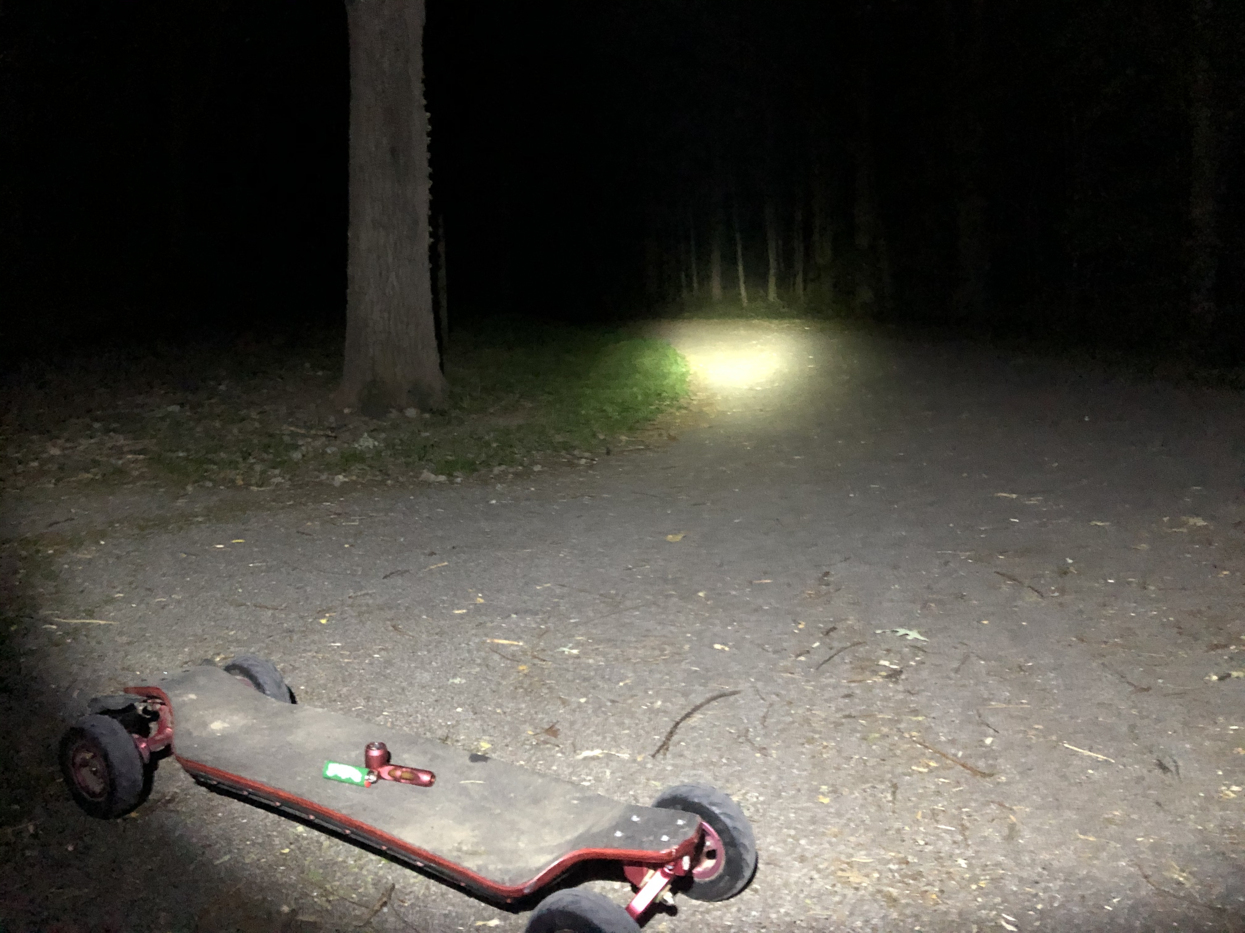

First time really riding at night, it’s not a problem on the 8” tires since you can roll over most things, wouldn’t dare ride in unknown places with the Caguamas at night

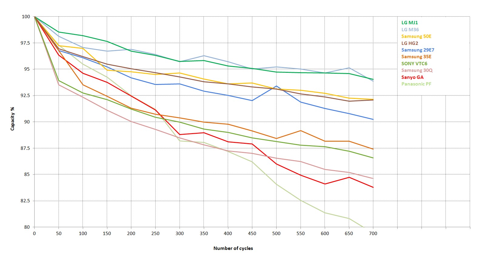

“They” say LiFePO4 has deeper discharge with lower voltage drop and lasts waaaaay more cycles, like 4,000 or something before capacity gets down to 80%. Although you’d need more cells (and weight) for the same Wh.
This is 12S5P ANR26650M1B at 4.7kg weight for the cells. You’ll literally ride for years before noticing a drop in capacity.
For sure, but the low energy density is a no no for me

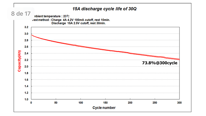

The thing is that even for the abusive data sheet conditions it has 73%@300 cycles
If you account that I started at 4.1 V, I will still have close to 75% capacity loss, these cells were always taken care, never charged at more than 1 A, rarely fully charged
I doubt I have more than 150 cycles , maybe not even 100
Again, I’ve always heard that the 30Q doesn’t care how you treat them, they will degrade no matter how much you baby them
This is the only good test I know
I wonder if there’s an argument to be made for usable capacity? e.g. when using LiFePO4 you need to compare a 400Wh pack with a 500Wh Li-Ion because the LiFePO4 has more usable capacity due to deeper discharge at more or less constant voltage? That would make the weight difference less of a problem.

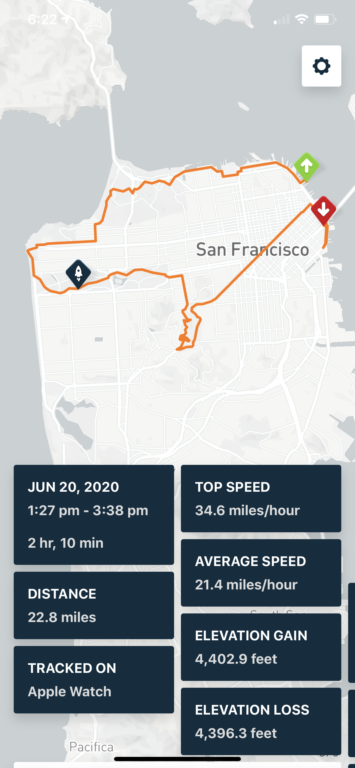

First real group ride in a lonnnng time. Did 0 charge stops. So had to keep it easy on the throttle. Glad I could squeeze 24 miles out of the proto :grin:
