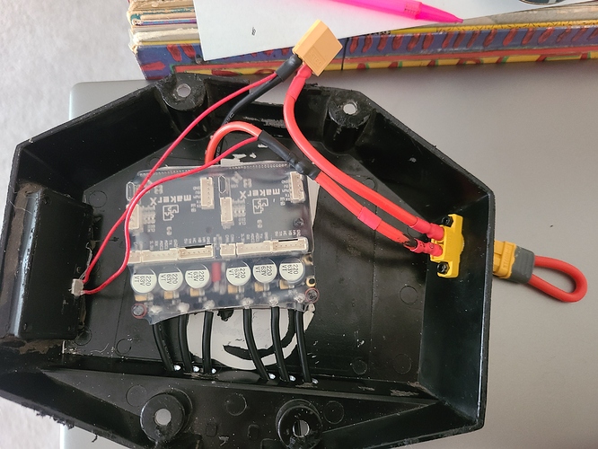

Here is my current wiring situation. I think I’m correct here. Hopefully?

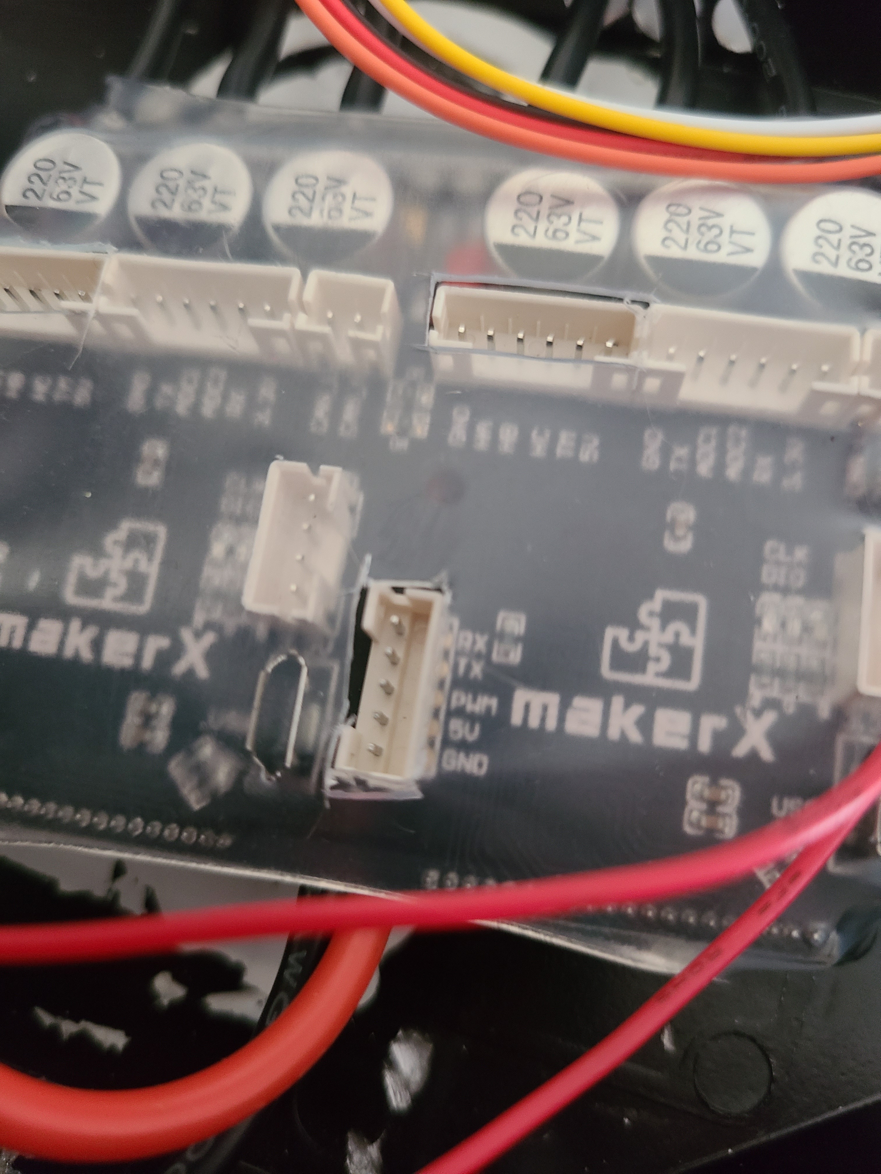

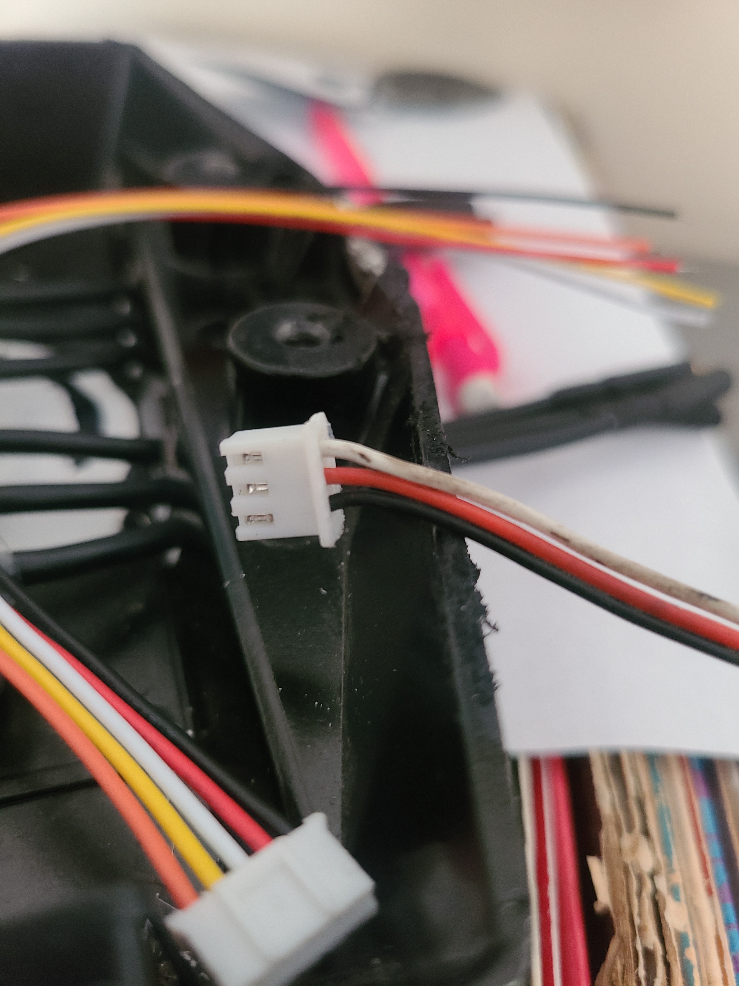

Next ussue is my TB nano remote needs to be re-pinned to the supplied connector, I have red (pos), black (neg), and white (?) Wires on the remotes receiver and I am unsure where to pin it on the connector. I can’t find a diagram anywhere on the nano remotes wiring. Anyone know what pins these need to go into?

Do I plug in my motors and remote receiver before pluging in my loop key? I’m probably over thinking this.
Is that loopkey XT60? It will spark up, use XT90S instead.
Yes it is. I’ll order an xt90. Will it hurt if I run this temporarily to set up the esc?
The “S” is crucial.
