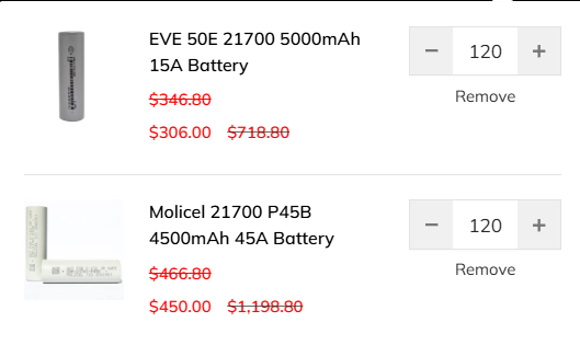

Title, I’m building a pack and there are some pretty good prices over at 18650batterystore.com. The best they have are EVE 50E & Moli P45Bs:
I’m doing a 12S10P pack and I don’t expect to draw more than 50A, so max ~5A/cell. I’m leaning toward the 50E because it’s cheaper and higher capacity, and its 15A max current isn’t a bottleneck. 50E datasheet quotes 70% capacity after 1000 cycles (3.0V discharge cutoff), and P45B datasheet quotes 85% capacity after 500 cycles (2.5V discharge cutoff), which extrapolates to 70% after 1000 cycles, so both have good cycle life.

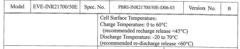

EVE 50E has a 60C max temp limit.

Yes, just to be clear, this is the EVE 50E, NOT the Samsung 50E. Title, price screenshot, and datasheet links also all show I’m talking about the EVE cell.
45B also has 60C max discharge temp in its datasheet, is that not the same as the EVE?
I see 80C temp cut under 45 amps continuous.
Nothing over 60C on the Eve 50E datasheet.

If I may play devil’s advocate, the EVE 50E cell datasheet shows that the cell is operational at a 60C ambient temperature, with a higher cell discharge cutoff of 70C.

Which other cells would you recommend? From the link in my first post, 18650batterystore already has what looks like a decent price on P45Bs
