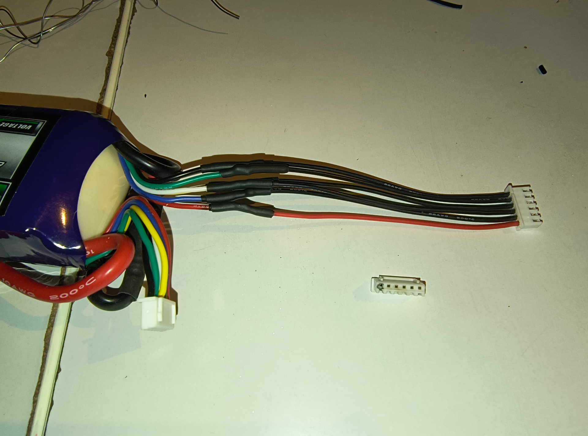

Here is a picture of the connector. It does not look that bad but the plastic has melted enough that I cannot plug the male side anymore.
I think, I’m going to cut the wires (one by one) and solder them to a spare male connector I have (with a lot of heatshrink tubing).
The wires can be removed from the connector body by lifting the little locking plastic tab with the edge of a razor blade, and pulling the wire, on many JST connectors, and it looks like yours allow this.
You can likely get away with soldering only the one wire as the contact is likely fried.
edit: I looked at photo on my desktop zoomed in, and it appears you will have to push the wire forward in the connector and carefully depress the locking tab on the contact itself, before being able to remove the contact from the connector body.
This little metal locking tab on the contact itself might need to be relifted in order to lock inside the new connector body.

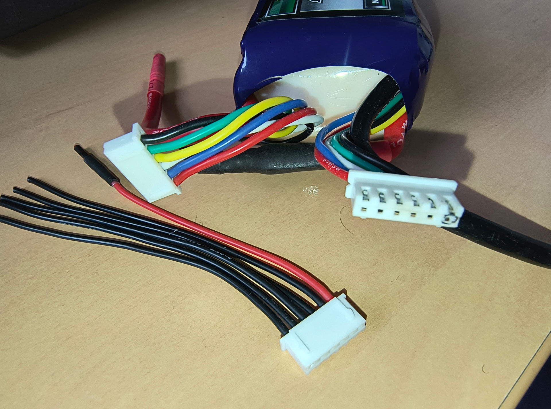

Soo … I choose cut the cable and solder them to a new XT connector. I was so scared having to cut live wire that I had to change my shorts twice in the operation !! :rofl:
But the result looks satisfactory.
