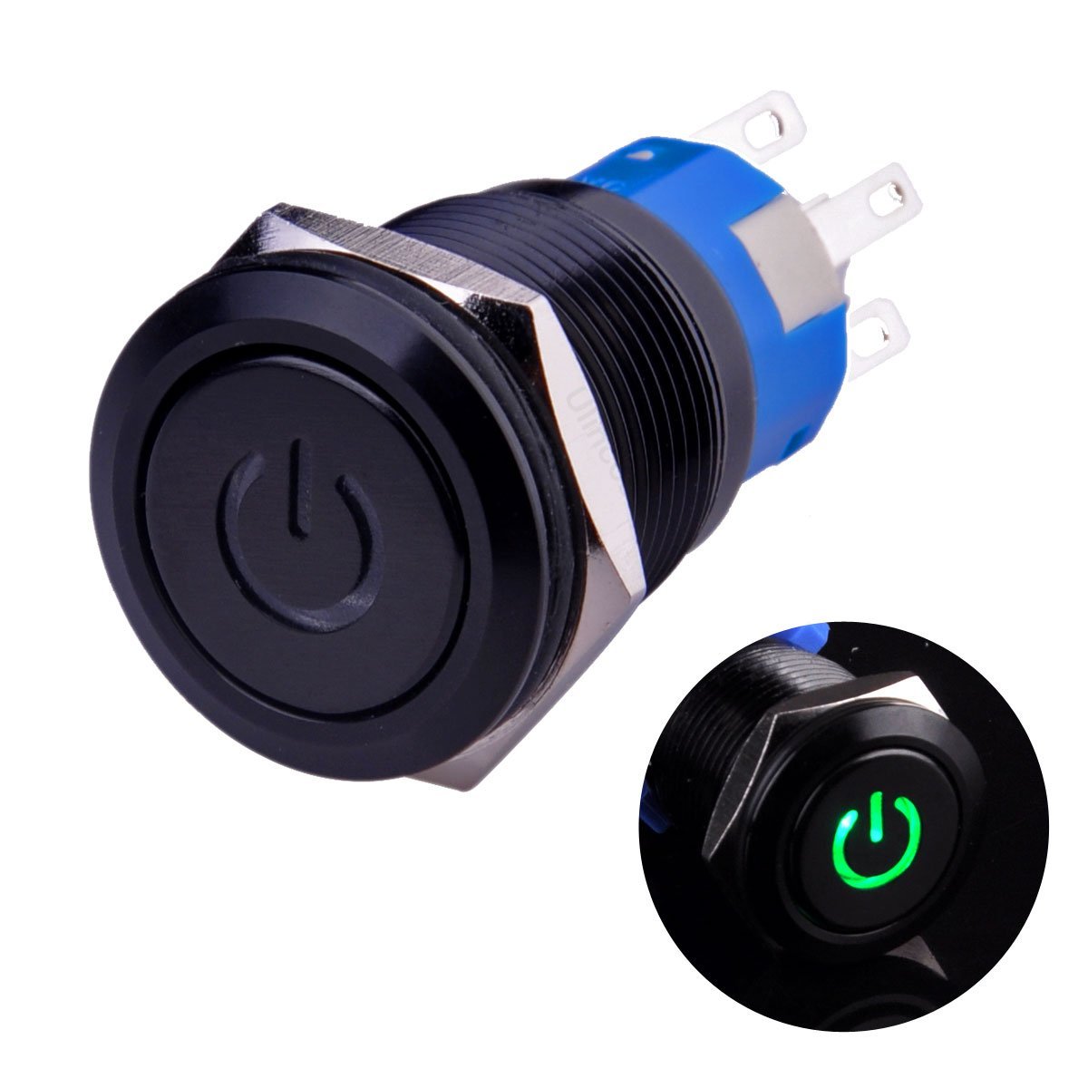

using this switch

The picture is not of this switch he is making… Also, this will draw current as it has always on LDO
EDIT: sorry regarding picture didn’t read correctly but still it is not what it will look like.
