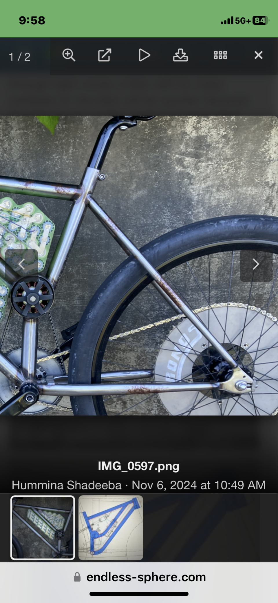

electricity takes a lot of human effort to make but I’m freezing riding around on this bike as the pedals don’t do anything and it was either add non-Newtonian fluid to the bottom bracket bearings or do this. Adding the generator n rectifier seems easy enough. I just hope I can get enough resistance from a motor the size of a bottom bracket with like 2kv.
