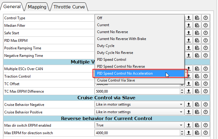

Ackmaniac’s PID no acceleration mode is pretty close to what I would want out of an endless ride mode.
Basically you kick up to the speed you want, engage the throttle and it goes. Let go of the throttle and it coasts, and brake engages the brake like normal.
The only things it’s lacking are the speed ramping down slowly, and if power is engaged you can’t kick it up to a higher speed without letting go of the throttle first. You can tune the PID to have a huge range of give, so it’s possible, but you still would need to toggle throttle off and back on again every time you kick.
A fun oddity is that depending on how you set your PID values, it’s possible to pump up to higher speeds, almost like you are jumping off the force from the throttle. By disengaging the throttle and giving the board a quick forward motion so it’s going a bit faster than before for a split second and reengaging the throttle while sliding the board forward, you kindof jump into higher and higher speeds. Get into a rythm, and you can pump up to any speed you want… it’s so novel and unexpectedly fun that it almost beats out pushing to a certain speed and just cruising there. Going scary fast after 10 pumps with no throttle just feels wild as a totally unorthodox form of endless ride.

You’ve tried this stuff? Awesome. Maybe the mode can be modified to allow increasing speed, so just hold throttle down, and kick/pump up to whatever speed you please. Depending on setup I can get a pump going faster than I can push…
