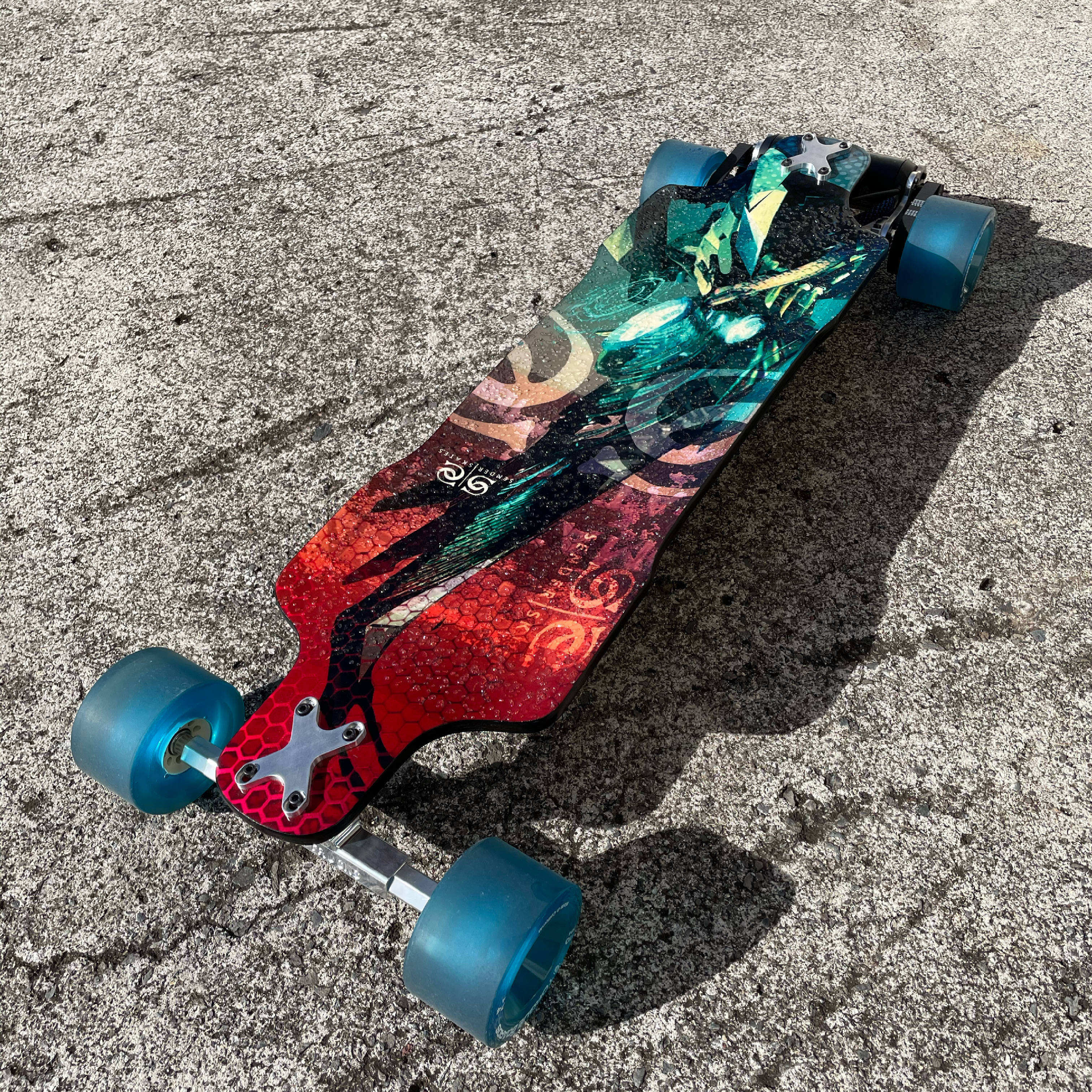

Is this a board you own? Don’t see a build thread :disappointed_relieved:
I bought this board from Kade Anderson several months back. Thanks to Skyart, it has a mew 12s4p p42a pack and smart BMS.
