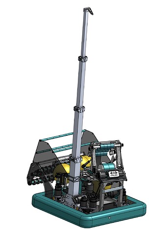

Thanks! Definitely, something we are proud of. Lots of other teams made “4414 clone” shooters.
It was so much fun. I am just glad that all of the new students got serious frc experience before the real season!
I designed the drive base, elevator, and intake. I also do a lot of the CNC work, as well as lead scouting. I made two pretty cool scouting apps that track robot performance with graphs and such.

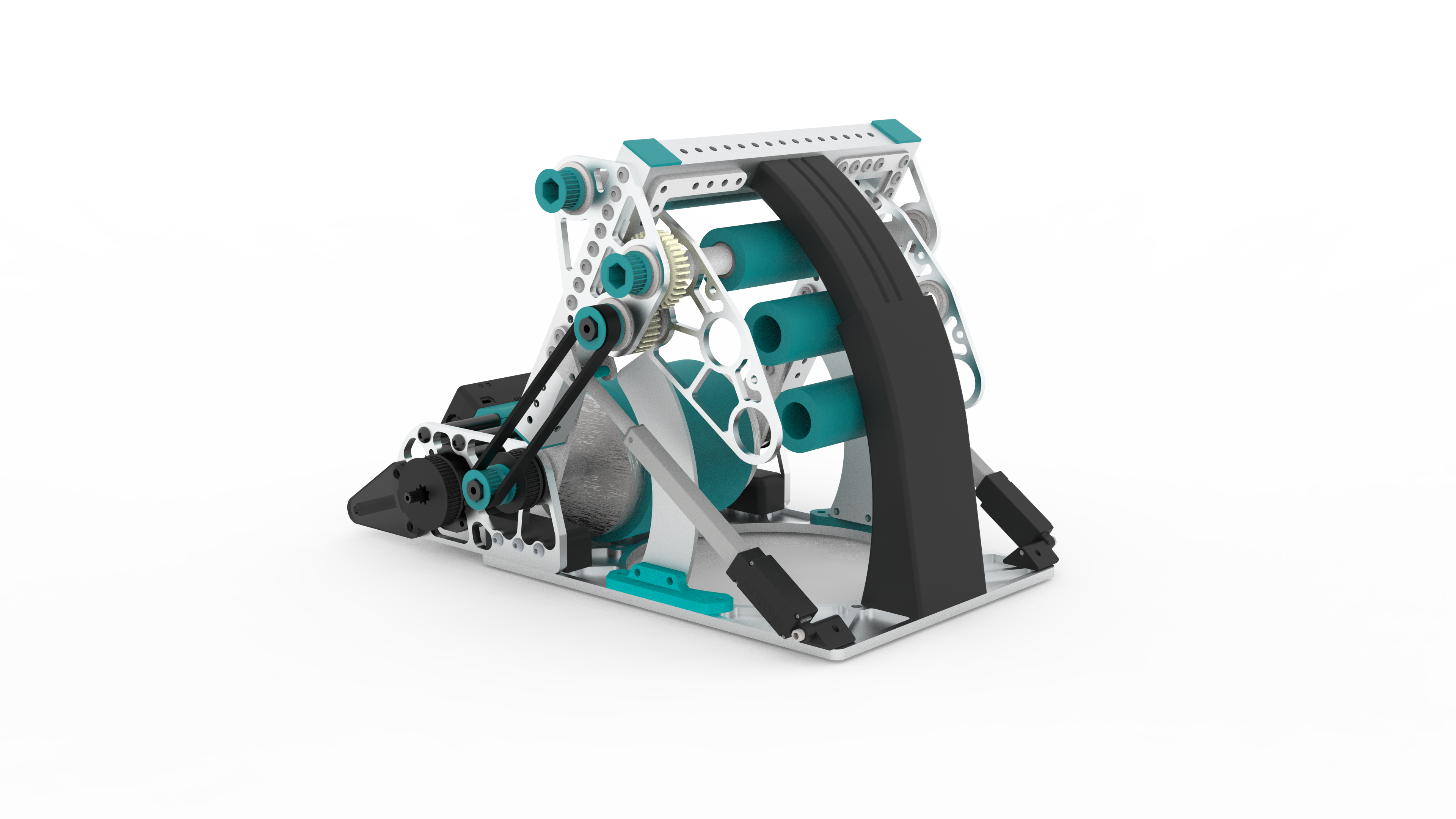

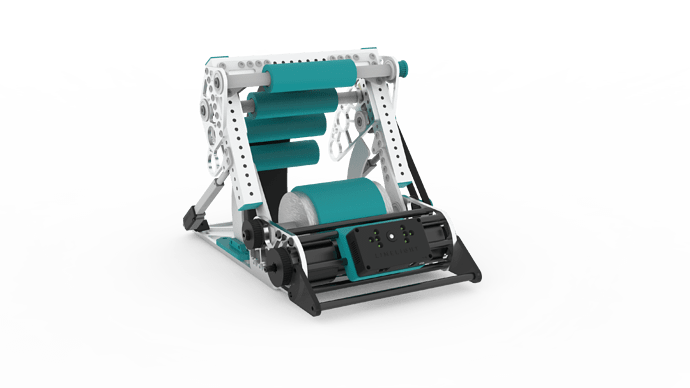

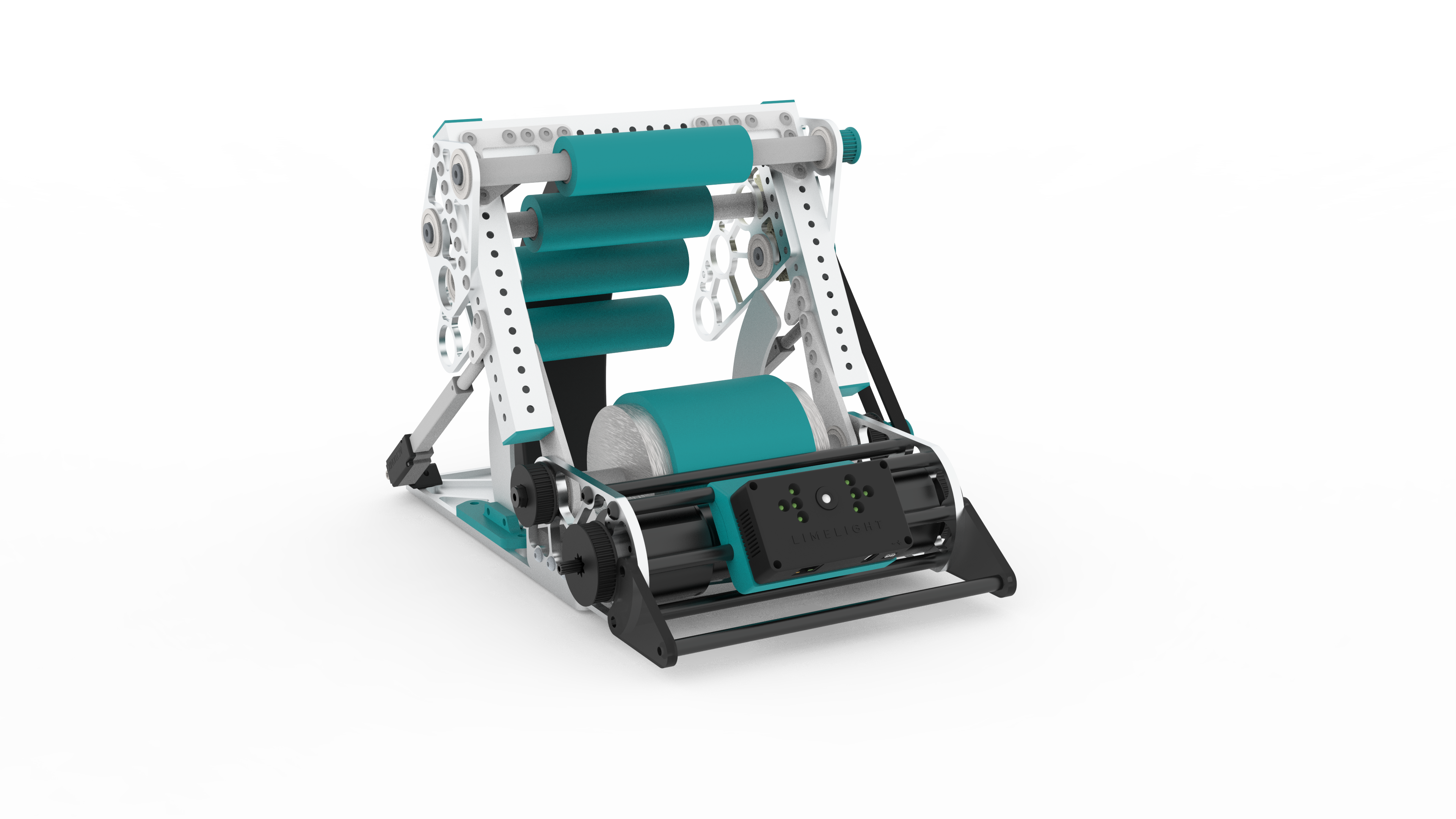

what are the central elements of the design that allow it to preform so well?
There are a few things. The first is hood control. We use linear servos to change the angle of the hood based on where we are on the field. We like them because they have built-in encoders and we don’t have to have a separate hood gearbox.
Second, and probably the most defining, is the roller array. The main flywheel is a 4" urethane wheel with stainless plates on each side for MOI. What makes the array special, are the hood accelerator wheels. We originally only had one, then moved to two for our 2020 competition. We realized that the accelerators had a huge hand in the accuracy as well as consistency of each shot (not slowing down after the first shot, causing the second to miss, etc.)
Also, the carbon fiber filled nylon hood is sweet lol. The telescoping nature helps guide the hood and provides some structure to the back.
And then to make shooting positions even better, the shooter sits on a 180 deg rotating that also changes angle based on robot position. All of this combined with a swerve drive (simultaneous rotation and translation), allows for insanely fast cycles. This setup allows the driver to focus fully on picking up balls and scoring them rather than on robot orientation.
Talked a lot about the v1 of this robot here: Behind the Bumpers FRC 4414 HighTide Infinite Recharge 2021 - First Updates Now - YouTube
I assume you didn’t design your own swerve modules, are those the sdsmk3s? Having multiple accelerater wheels is a really interesting idea, makes sense that it would lead to better consistency. What rpm are the main wheel and hood wheels spinning at? I’m curious about why you guys chose to opt for an independently amiable shooter even though you have swerve. Is the thinking there that keeping the aiming of the shooter (horizontally) separated from the drivetrain allows the driver to be driving while the shooter auto aims with minimal interference? Or is it so that defense bots can’t pin you and stop you from shooting?

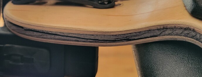

DIY - fill with epoxy and clamp. Add layer(s) of fiberglass or carbon fiber to reinforce the deck at the necks and mounting positions.
Not-DIY - buy a stiffer / stronger deck
The sportster is pretty flexible off the shelf. The ideal esk8 deck has little to no flex.
