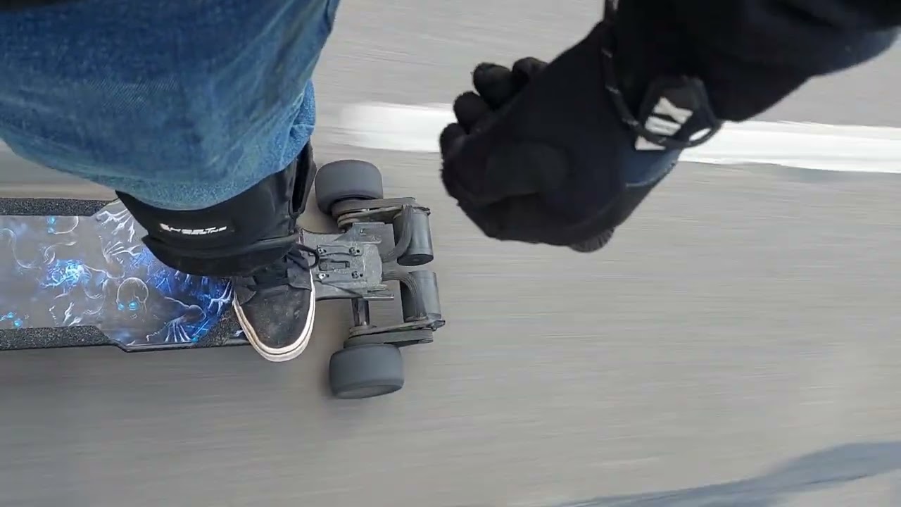

My shitkicker deck has picked up a wobble i cant solve, happens about 20km/h. It’s never done it before.
Ive changed all the wheels, tightened the bushings/loosened the bushings, checked motor config, changed belts… short of pulling it all out and rebuilding it i dunno where to look. Ideas?
Is something bent maybe?
Hasnt had any hits recently, im at a loss to explain.
while wobbles are nothing new for dkp its usually under much harder riding or hitting an unfriendly rock or somesuch, not through light acceleration.
u have TC on? could be one side is way tighter than another, so the roll isn’t even on both side? idk, hard to tell
u checked if the middle arm kingpin isn’t bent?
Maybe the bushings are just gone. Have you tried swapping them? Maybe for something harder, in case you picked up some weight. Other than something bent, maybe one of the motors is underperforming? Check if one gets hotter than the other, and do a fresh detect/setup.
Turn off one motor, and aside from the torquesteer, see if the wobble still exists. If it does or doesn’t can give you information.
No TC. Will strip down today and inspect.
I thought this last night, will swap out today
:laughing: nope, still under 90kg
Hadmt considered that. Nice one.
apparently house insurance doesnt cover fire from electric skateboards, and you cant buy insurance for DIY builds, kinda stuck in a loophole
This i think. I couldnt see anything bent so I swapped out the riptide for some older stock barrels and it’s gone.
New riptides ordered.
