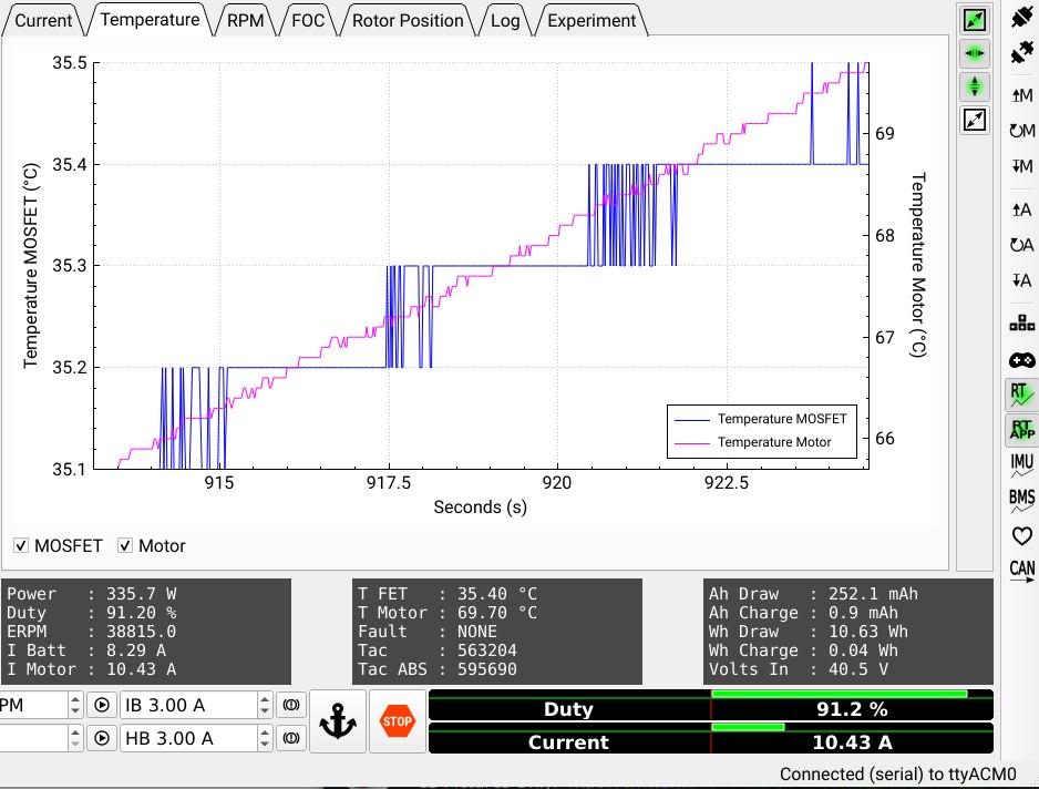

Is it normal for the motors to heat up just spinning on the bench with no load? They get to 70 degrees in just a few minutes. Wondering if maybe my bearings are over-tightened then :thinking:
10 amp no load current, 335 watts is very high, and it’s not normal for them to heat up under no load… They should stay pretty cool. Mine will heat up to 70C fairly fast only if I am pushing them hard while riding.

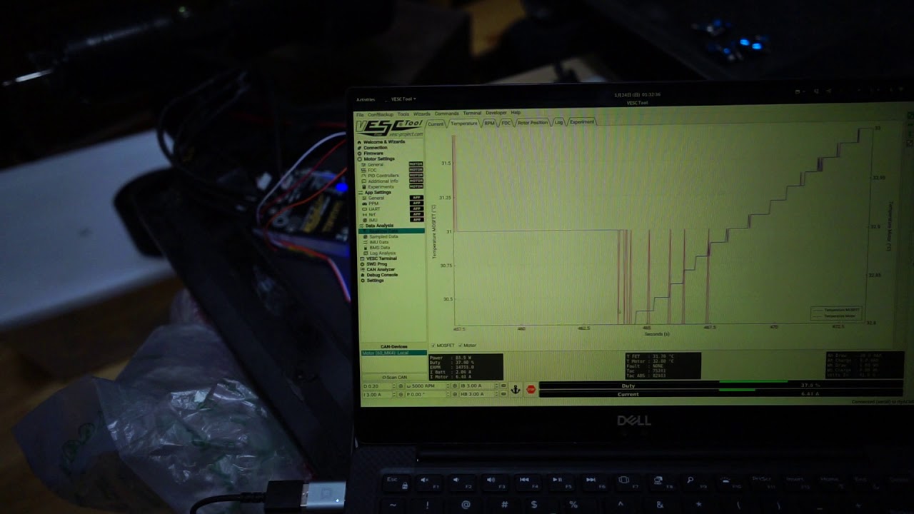

Here’s mine after about 3 minutes at 95% duty cycle.
Cool to the touch.

Thanks for the useful info! The motor I shared the graph of spins freely (I can get it to do 1-2 rotations on its own by hand), so I want to believe that motor is fine, it’s just the core losses heating it up. The other motor is definitely getting stuck, probably bearings filled with gunk. Will try to disassemble it and see…
Edit: incorrect; graph is of bad motor. Good motor uses only 2.5A at max duty.

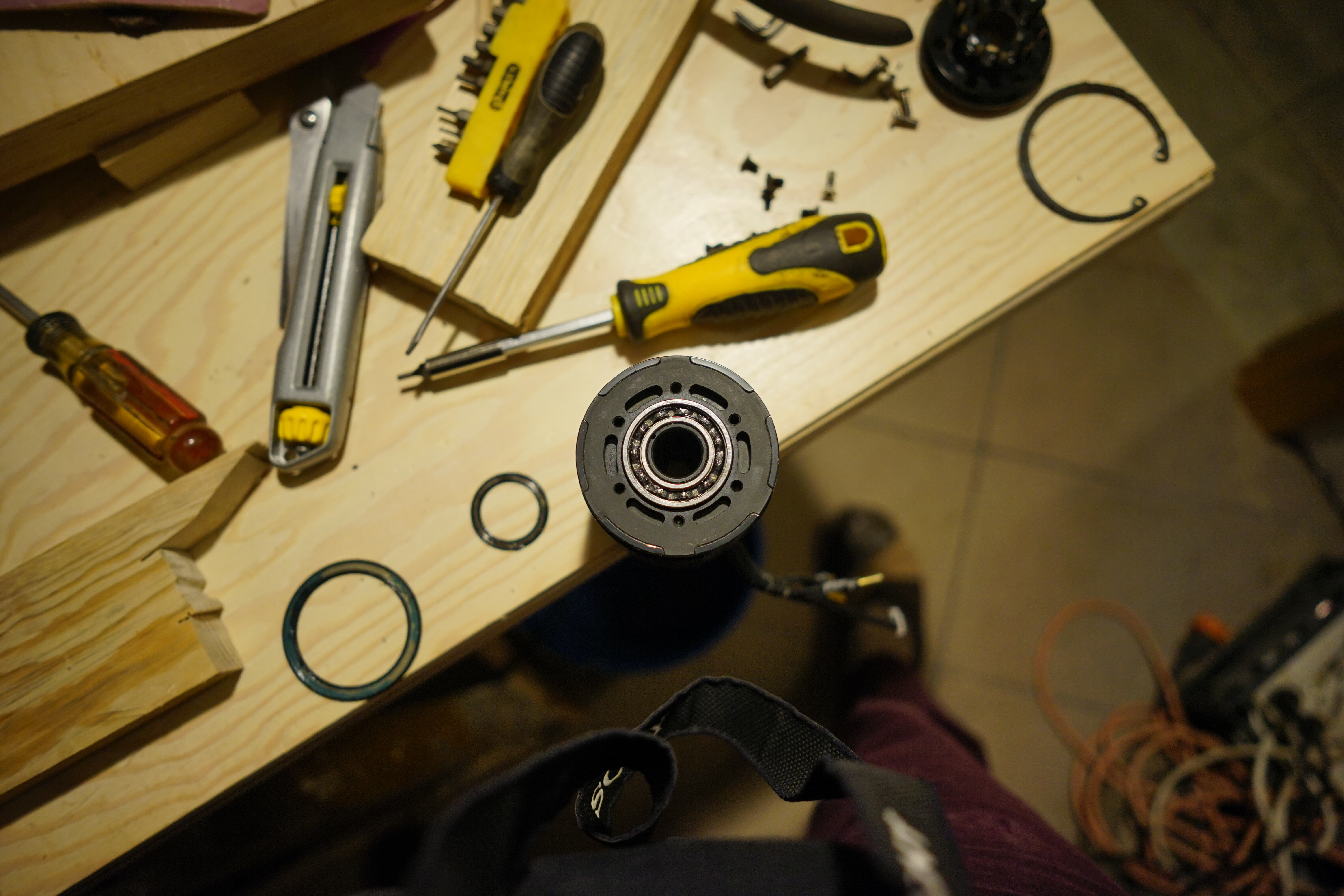

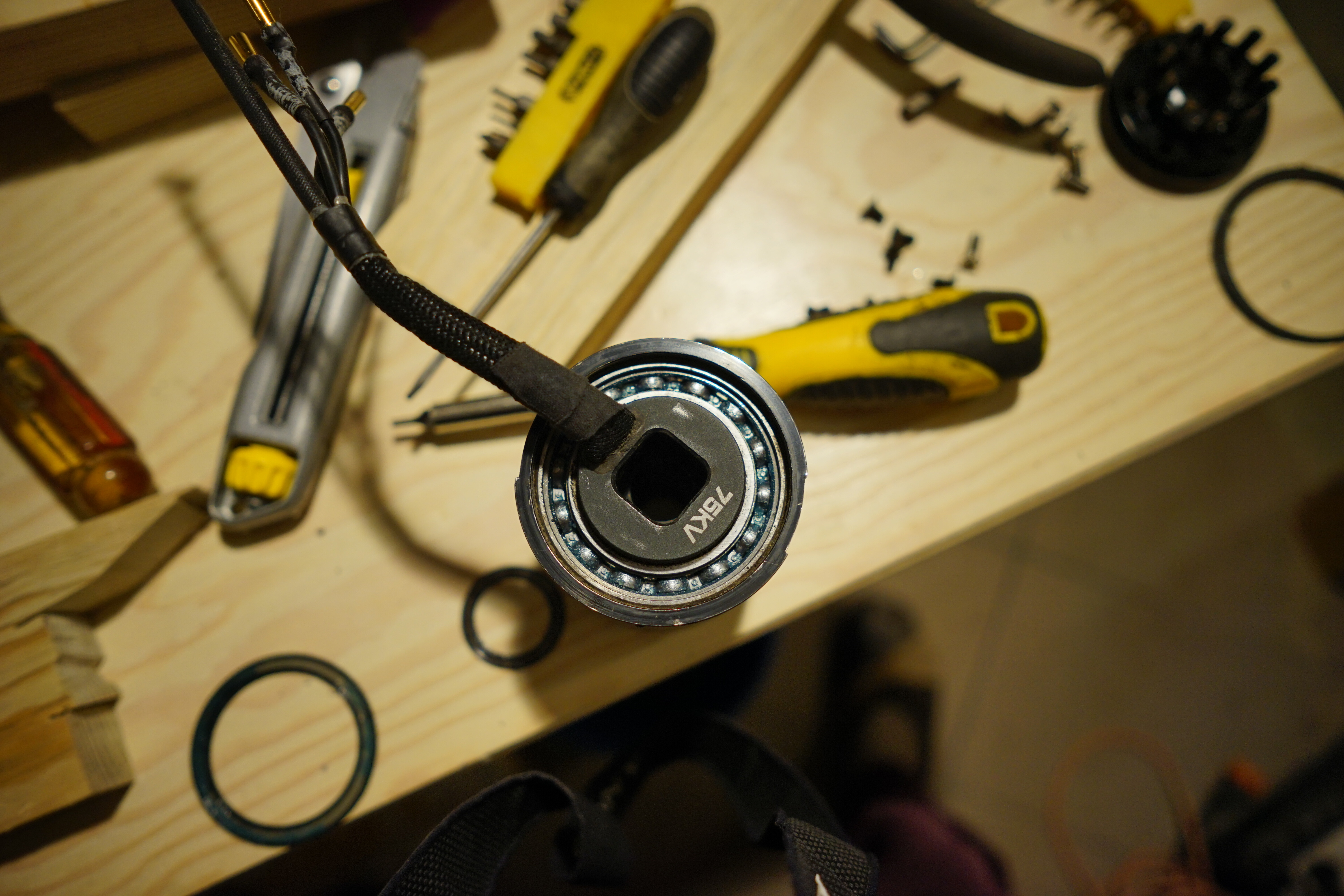

Well, I opened up my dirty one as much as I could, but don’t see any sign of the bearing shaving, and despite all the grime on the outside the outer bearings look clean as well. I don’t think it’s possible to open them up any more without a press jig, right? Stumped for now I guess.

Hmm, maybe it was the vesc; tried again and it’s only 2.5A at max duty. Still heats up at a rate of 6 degrees per minute though :frowning:
Edit: apologies; it looks like that graph was from the bad motor after all; it’s using 10A. After my teardown and reassembly even more now, and sounds like it’s dying. :frowning:

Simplest and way i can think of is buying a fitting nut for a tightening wrench-tool-thing (sorry, english not first language) that exactly fits the rim inside the smaller bearing on your second photo, place the outer rim surrounding the big bearing in your first photo on a vice or similar supporting structure and gently tap out the whole portion of the motor with a rubber mallet. I’d clean out the bearings with wd40 or similar, see if they run VERY smooth (in my case a clicking noise disappeared after exchanging a RATHER SMOOTH running bearing against a new one) and regrease with bearing grease. Be sure you didn’t damage the rubber seal when removing. Last thing you want to do is wonder why you won’t get more detailed and precise help from the manufacturer. We’ve got other threads containing more detailed instructions though.
