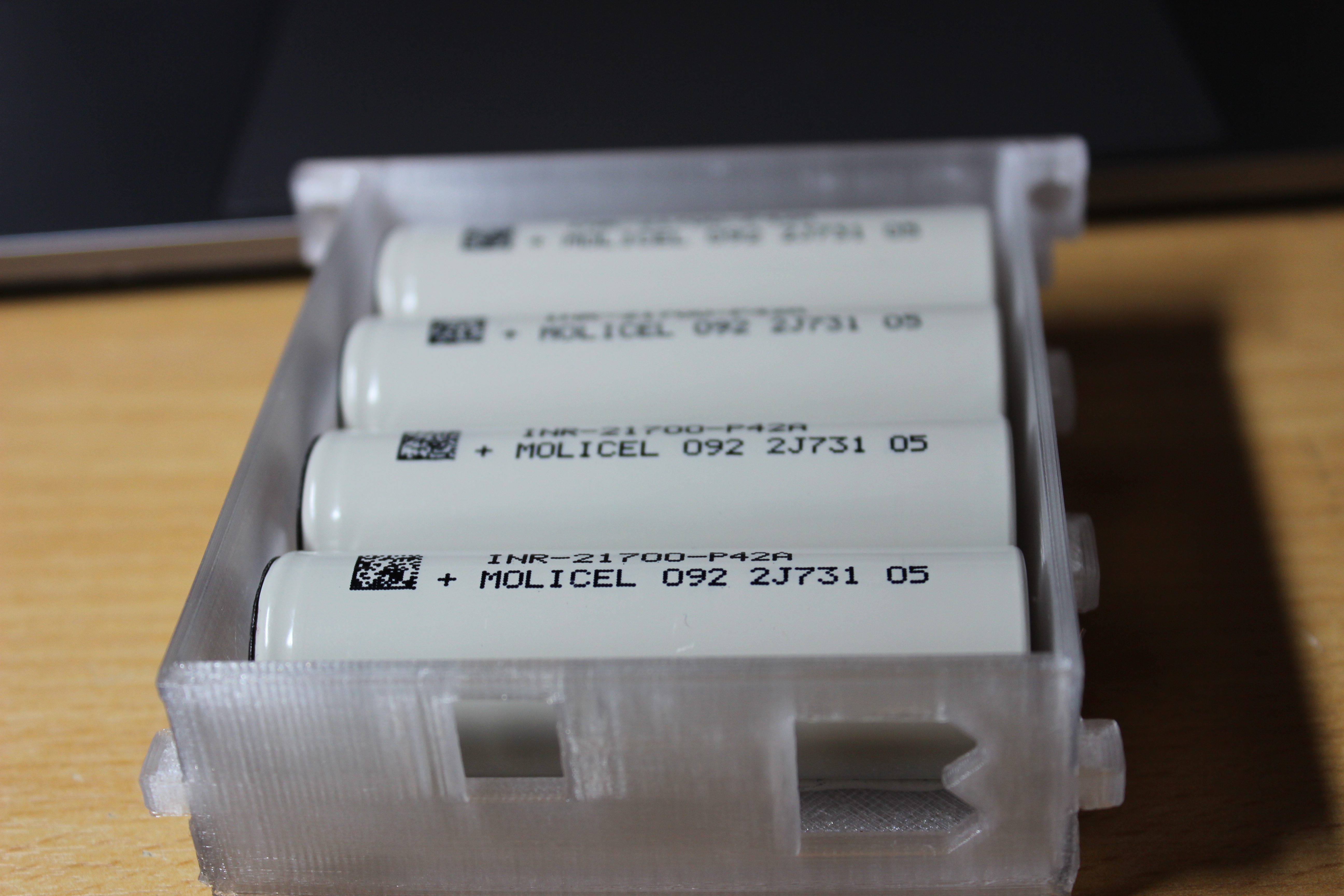

Update! We’re Prototyping
So, this is printed in PETG, and I think i might keep the magazines in PETG, since even if printed in TPU, the cells are rigid and would not allow much flex of the ā€œmagazineā€ anyway. Printing the mags in PETG is a) easier and b) provides more impact resistance to the cells.
I need to order the Magnets, in order to test their adhesion to TPU and PETG, to ensure that wont be a mechanism of failure.
Furthermore, Have to ensure that there is enough structural rigidity with those tabs to ensure that they will be adequate to support the mag without snapping.
So far, really pleased. Really excited to finally see it come to life

I did! Was looking at integrating a TP4056 Module, which would also mean the packs could individually be charged on the go with a run of the mill usb-c cable, however, those boards are only capable of 1A charging, which for 1.6 Ah packs means a really long charge time.
This in tandem to the fact that there is no easy way to monitor State Of Charge per pack, meant that if one were to try to charge a pack over usb, they would have to charge each one to full in order to ensure that when all the packs were reconnected, that they would be the same voltage.
Additionally, due the potting, i began to realise that if i integrated a charge module in each pack, that there was a good chance that heat could become an issue.
On that note, i wish there was an easy implementation for thermistors in regards to off the shelf BMS’s that would allow for 12 seperate inputs, and could take action based on temp.
Thinking that this may be doable via raspberry Pi or something, which then communicates to BMS via CANbus, but would be awesome to just have one integrated package

Copper braid is what im looking at right now. Gonna have to do some testing to see about how im going to connect it to the cells, As I know it can be particularly tricky to solder with and given my space constraints, I need it to be low profile.
