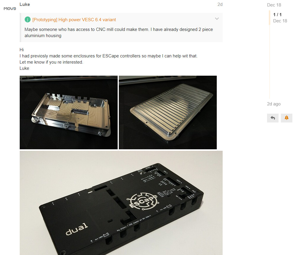

I had 2 PMs about aluminium housings. Maybe someone who has access to CNC mill could make them. I have already designed 2 piece aluminium housing

@Luke wrote me a message about CNC milled aluminium housing. I have to admit, his dual ESC housing looks awesome. Are you interested? I don“t know the price yet
