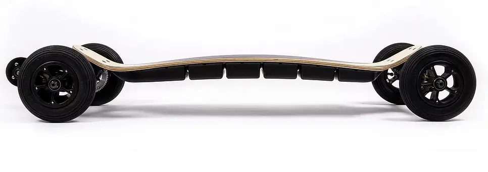

I can still remember the first time I saw the promotional photos. It was a routine work day in 2019. There I was… on the clock… just staring at this image.
How could a skateboard design could be so artistic? The enclosure so elegantly traced the belly of the deck while the bottom geometry remained parallel to the ground. The carbon fiber weave was so dreamy.

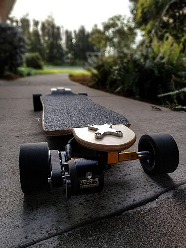

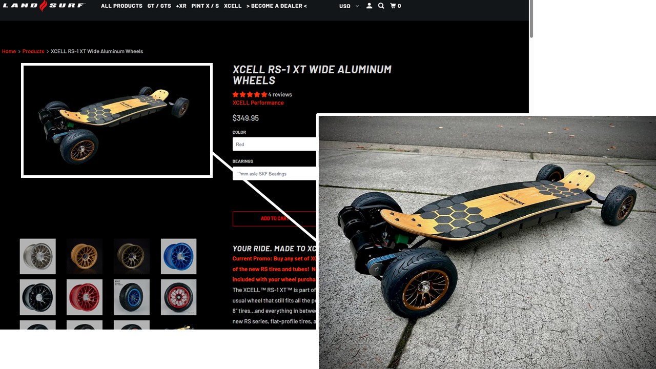

I asked the seller to send me as much info and photos of the board. Turns out this exact board has some coverage on the Landsurf website. It was used to showcase the Xcell RS-1 XT hubs. That’s pretty cool!

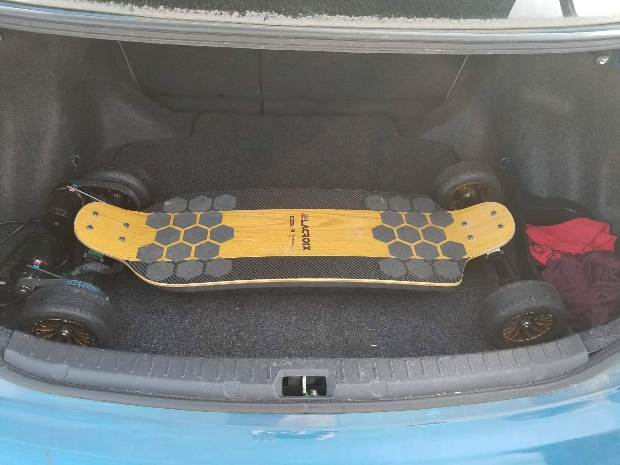

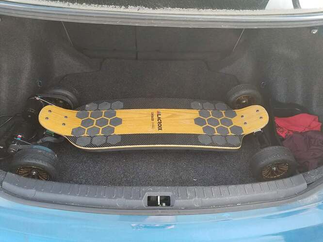

That very next Saturday we met up at an In-N-Out burger about 30 minutes away and I PayPal’d the money on the spot. I couldn’t believe that this board was actually sitting in my trunk.

I have almost the exact same build. Xcell Hubs and racing tires, etc. You are gonna love it.
Yo!!! These are YOUR trucks and wheels. I sold them to you a few months ago. I’m just a bit behind on putting this thread together LOL.
Love the name!
LOL!! I thought those trucks and wheels looked familiar! I have them on my Prototipo right now. I can really rip on those XCell hubs! Thanks again!!!

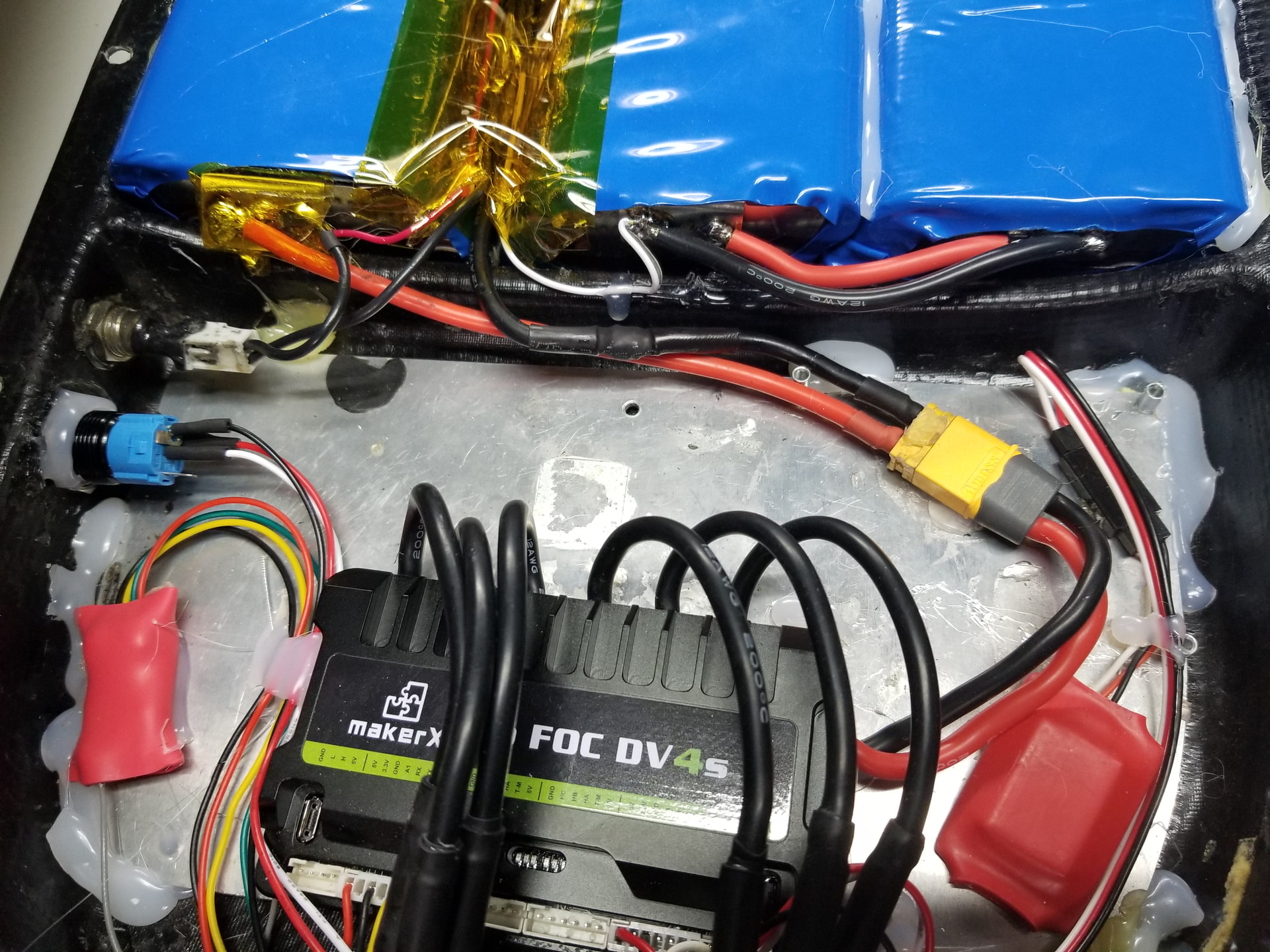

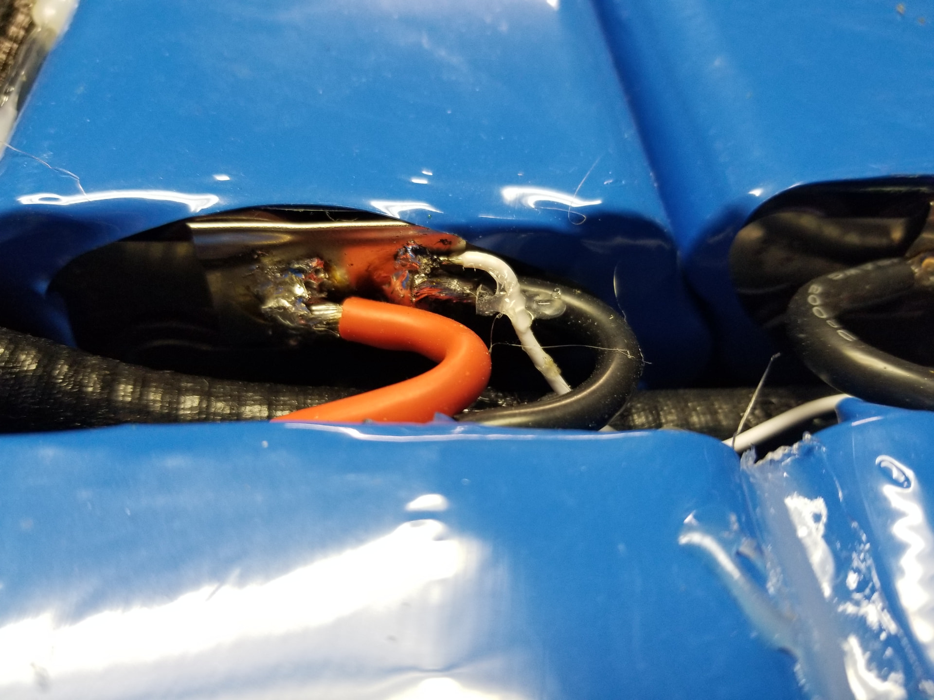

Disclaimer: I am going to intentionally leave out any usernames from this post, as I have zero interest in calling anyone out. The gentleman that I purchased this board from did not build the battery. He reached out due to having battery issues. After pulling the battery apart, it was pretty clear that the problem most likely originated from the battery assembly methods. Hopefully this can be an example of what not to do.

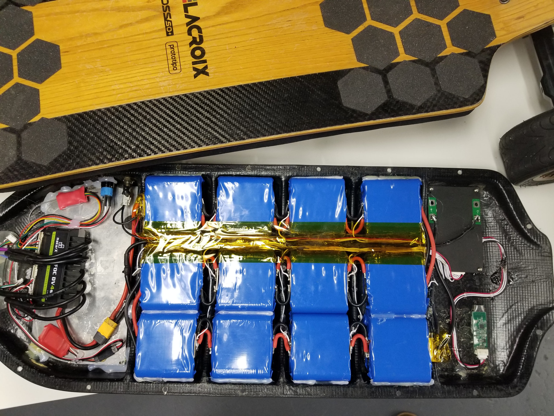

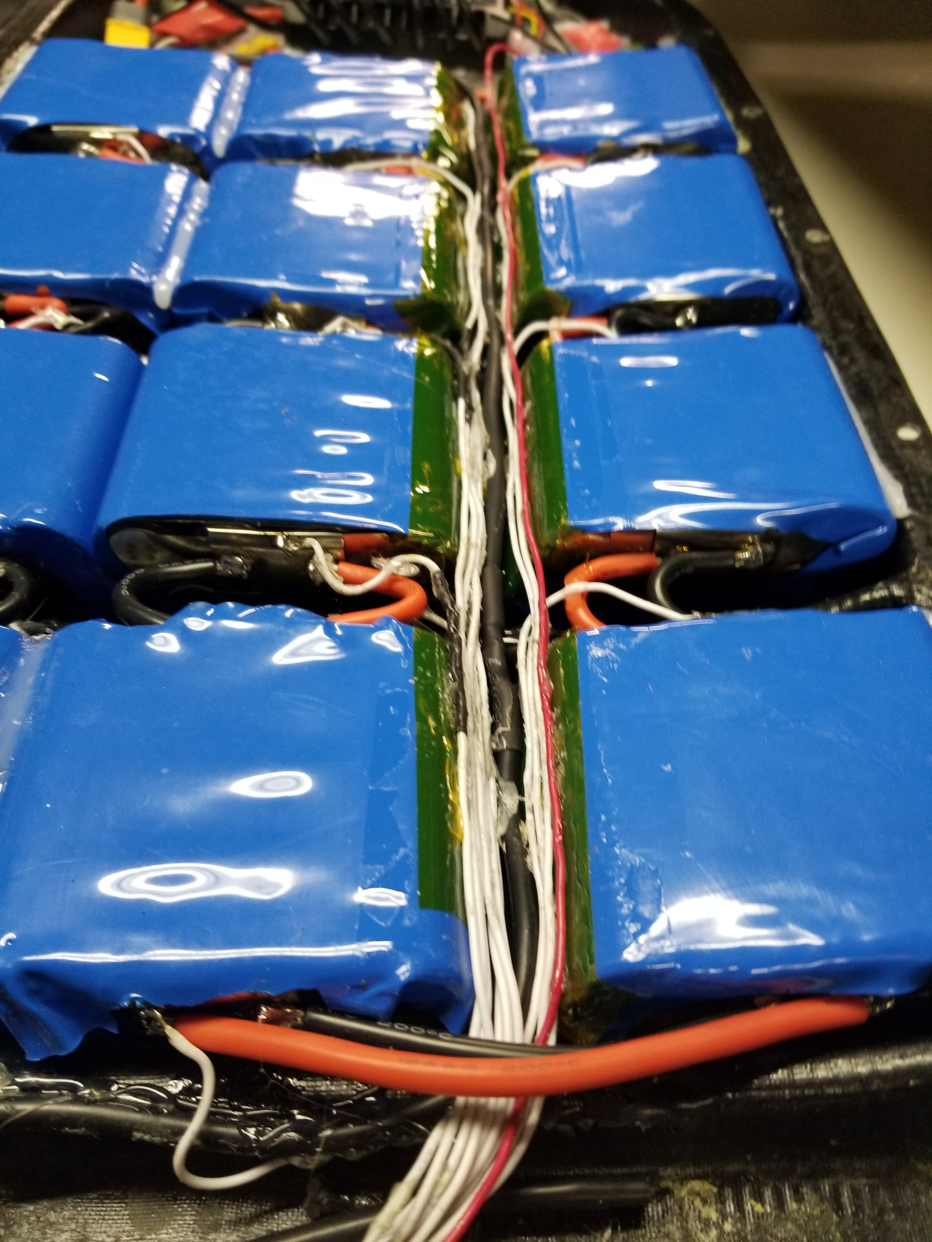

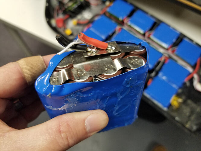

The board included a 12s8p pack. I was pretty optimistic that I could remove the dead cells and convert the battery into a 10s8p pack for my daughter’s VESC based Razor Pocket Mod (aka death scooter). She’s still using lipos and manually balancing the pack was… starting to get old. Once I got home, I removed the enclosure to see what was going on.
There was hot glue everywhere! It was all over the bottom of the enclosure (underneath the P groups) and poured into the sides of the enclosure.
More on the hot glue in a later chapter… back to the battery. I wasn’t super stoked with how the balance wires were routed, but whatever… I was going to drop in a new 10s BMS anyway.

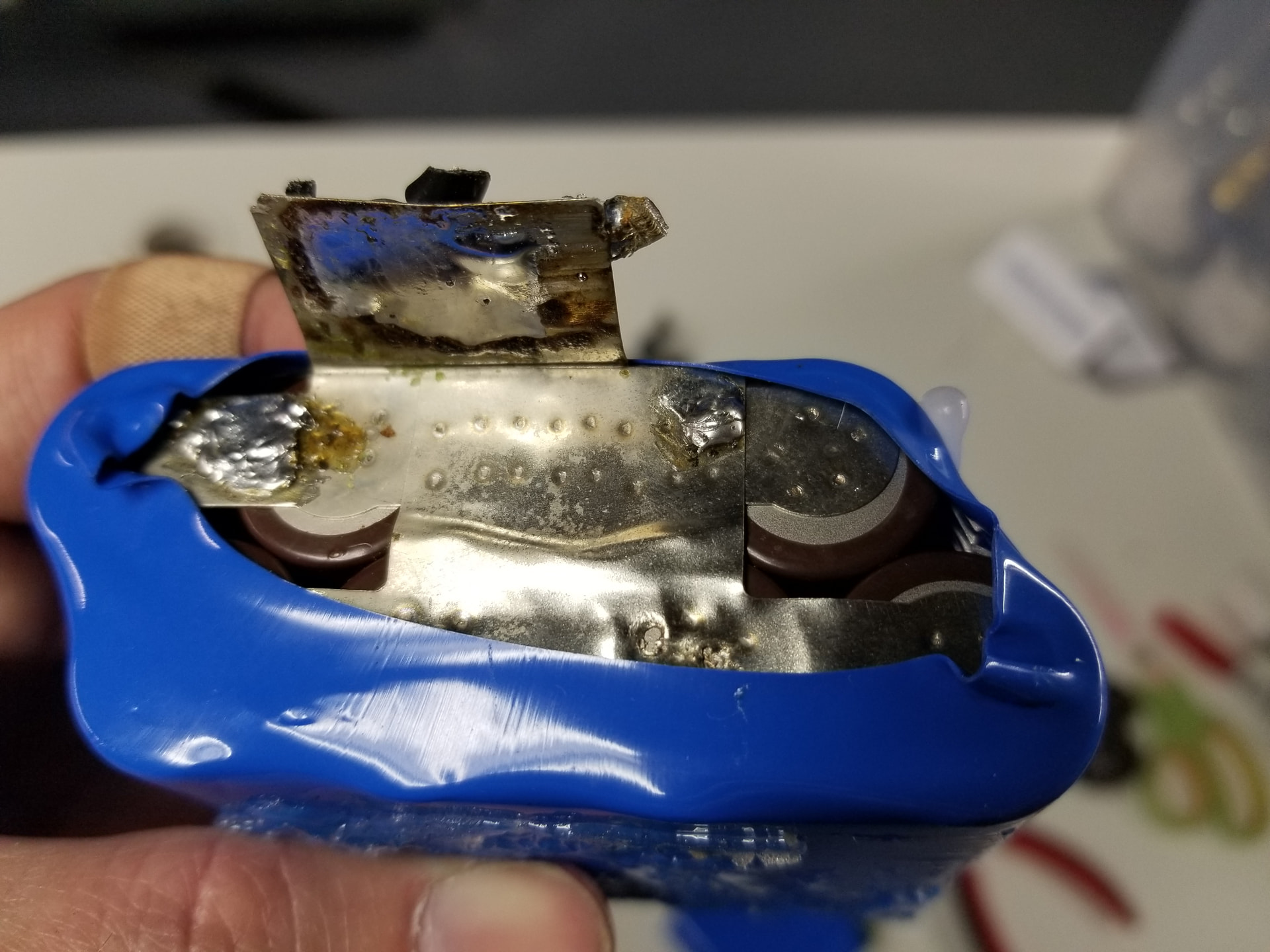

The solder joints for the series connections looked questionable, but like I said…this would need to be re-done anyway.

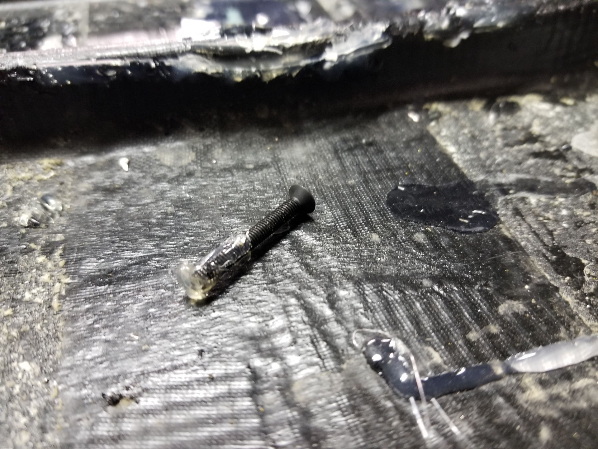

Then I started cutting series connections so that I could inspect the individual P groups. There was no fishpaper insulation, spot welds that blew holes through the nickel (not sure about the cells), insufficient spot welding connections and incorrectly sized nickel that was folded/bent to shape.
Oh yeah. I found a loose screw floating around in the battery pack.
By this time, I had seen enough to know that it would be unsafe to keep any part of this battery. I wrapped up the P groups individually and immediately drove to Staples. They graciously were willing to dispose of this battery (at no cost) despite my verbal disclaimer that this pack wasn’t safe. I was so glad to get this battery out of my house!
Thats disgraceful. I often think we get a little high and mighty around here regarding pack construction, but this just goes to show why our outrage is necessary

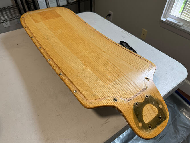

The goal is to make this deck look as new as possible. I totally enjoy all of the modern skin jobs that others are doing with these Proto decks, but I’m more into the restomod builds that maintain the original design ethos. So buckle up, I’m going to take you on a little OCD journey of how this deck got a second chance at life.

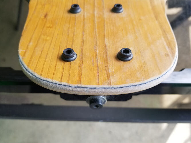

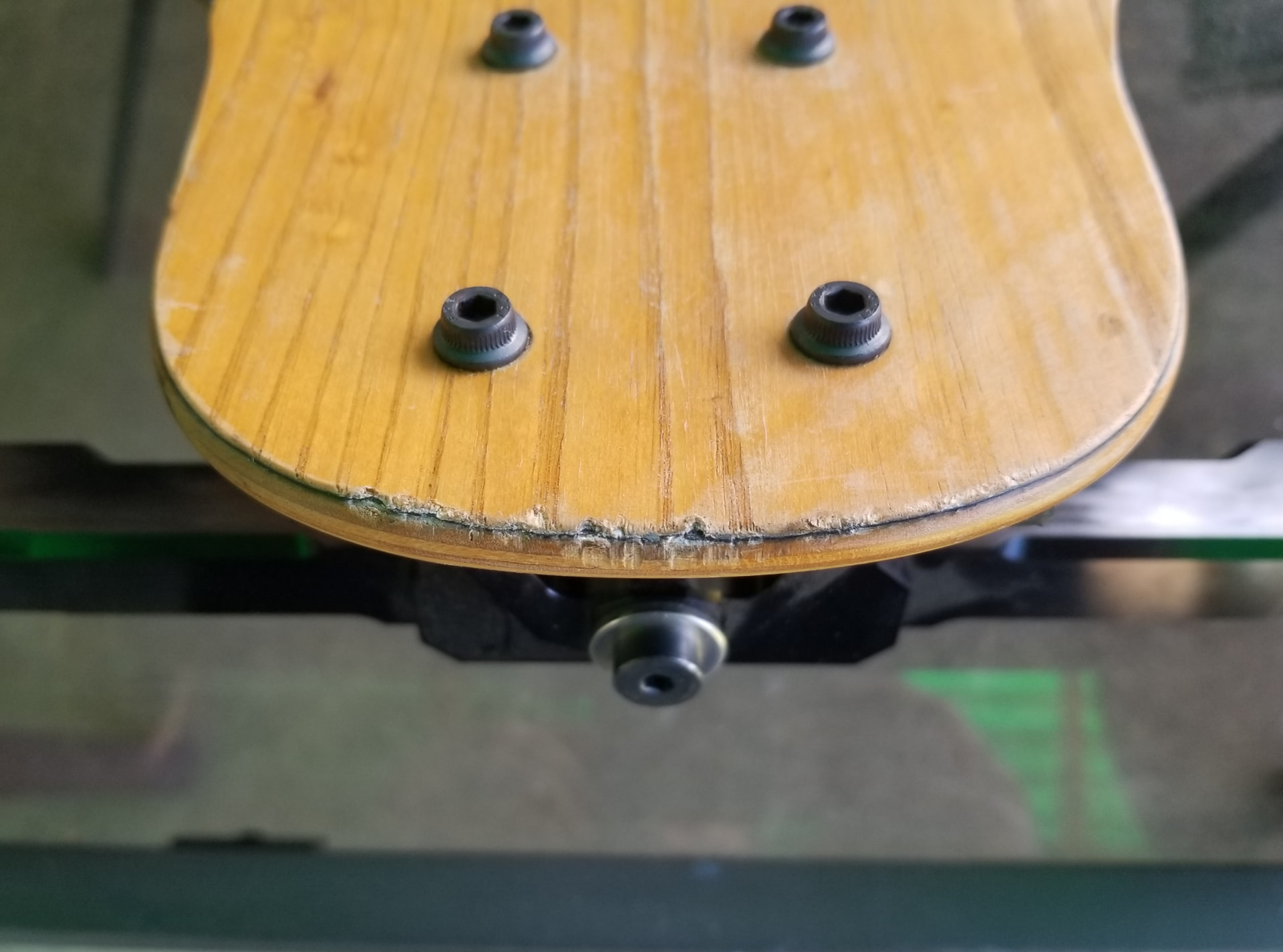

First up… the tips of the deck were all kinds of chewed up, almost like it had been flipped over and stored wheels up on the concrete. Nothing that a bit of sanding couldn’t fix. Here is a before photo:
And after much sanding, rounding and some more sanding:

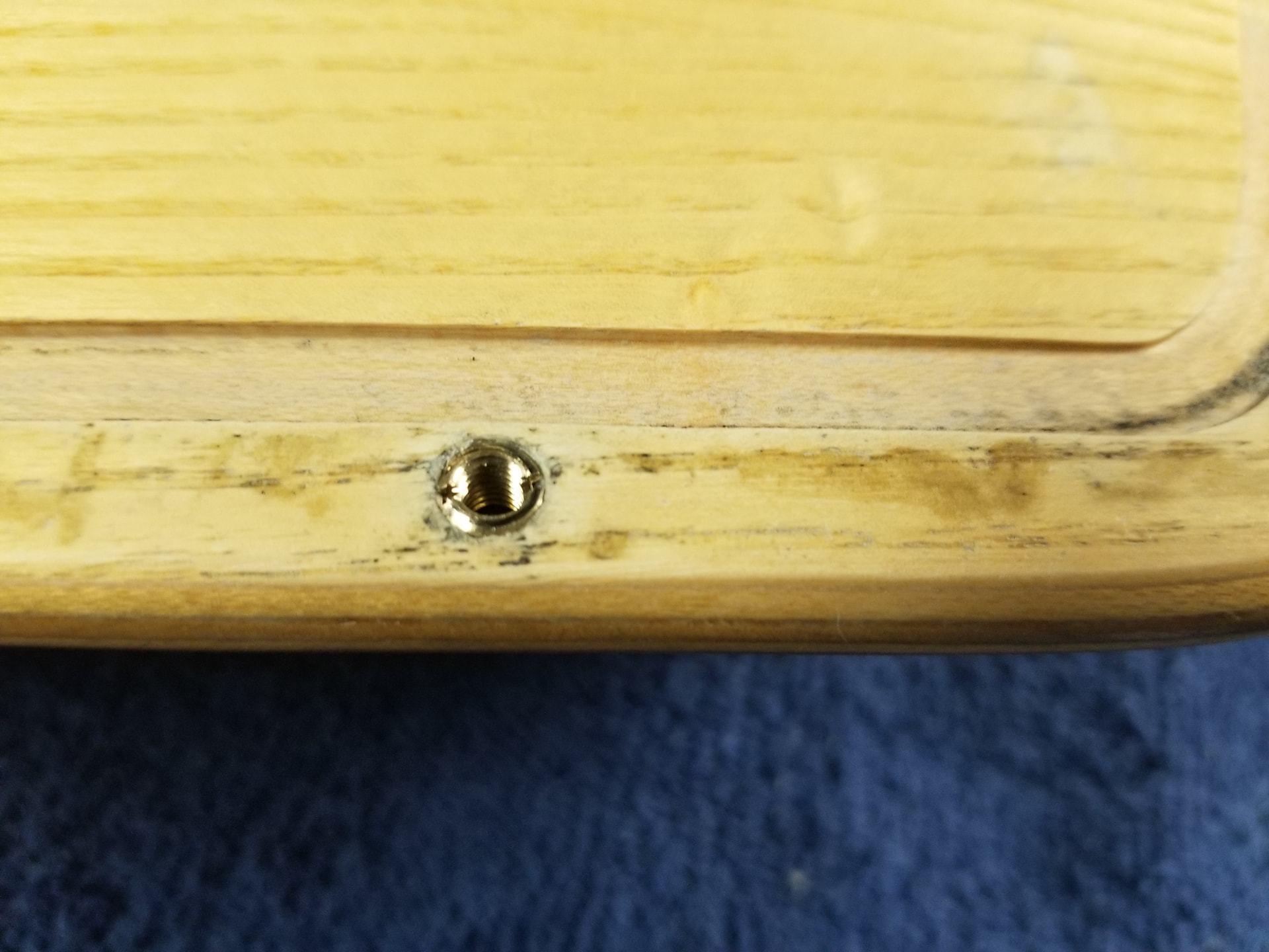

Then I swapped out the M3 enclosure mounting hardware. I was surprised by how easily the stock M3 inserts came out. There was no glue adhesion of any kind. It might not be the best idea, but I’m going to try putting the M4 inserts back in the same way. Just raw dawg them back in place and hope they unthread back out.

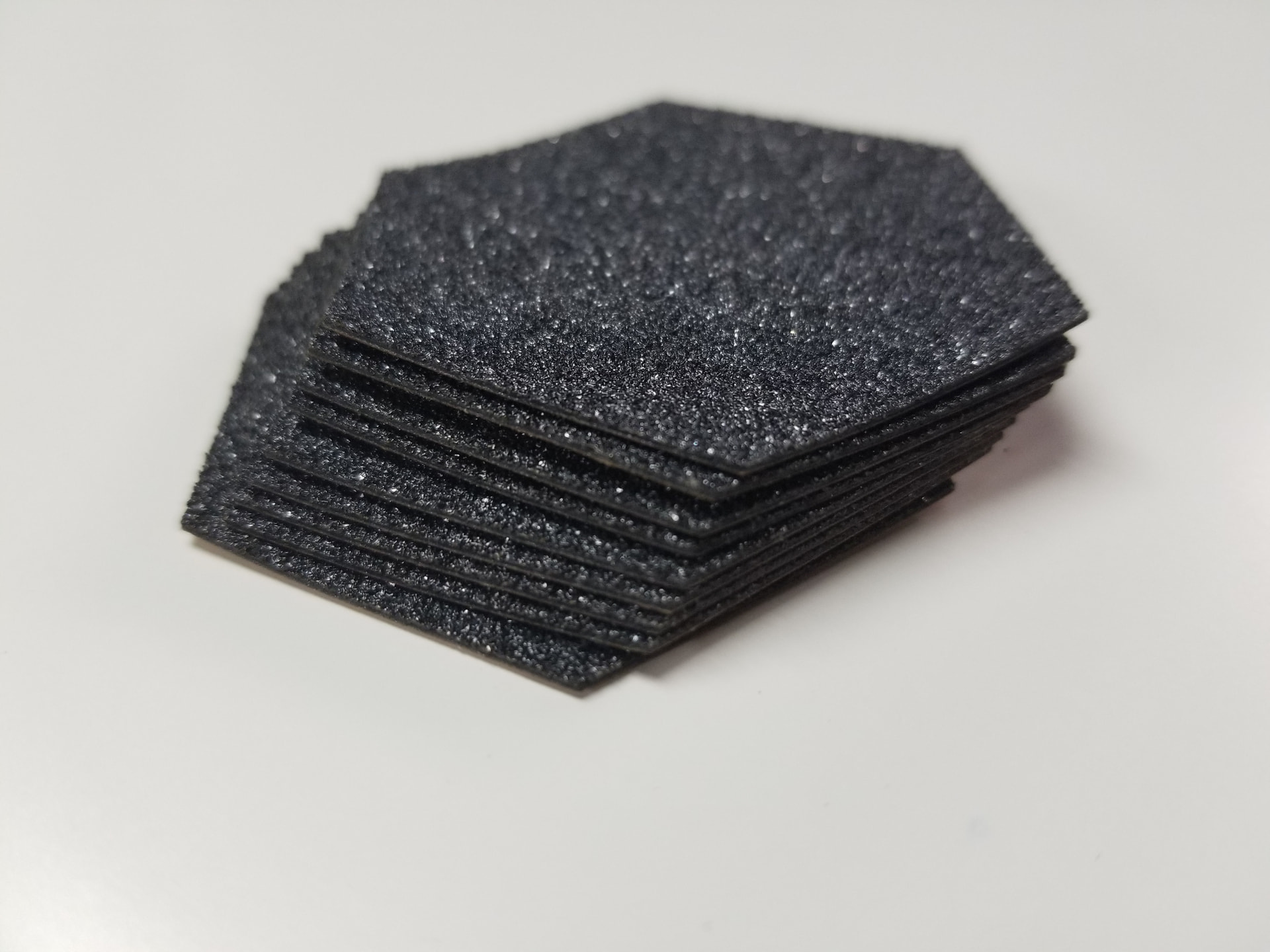

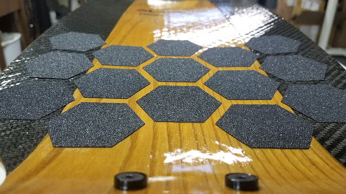

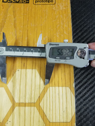

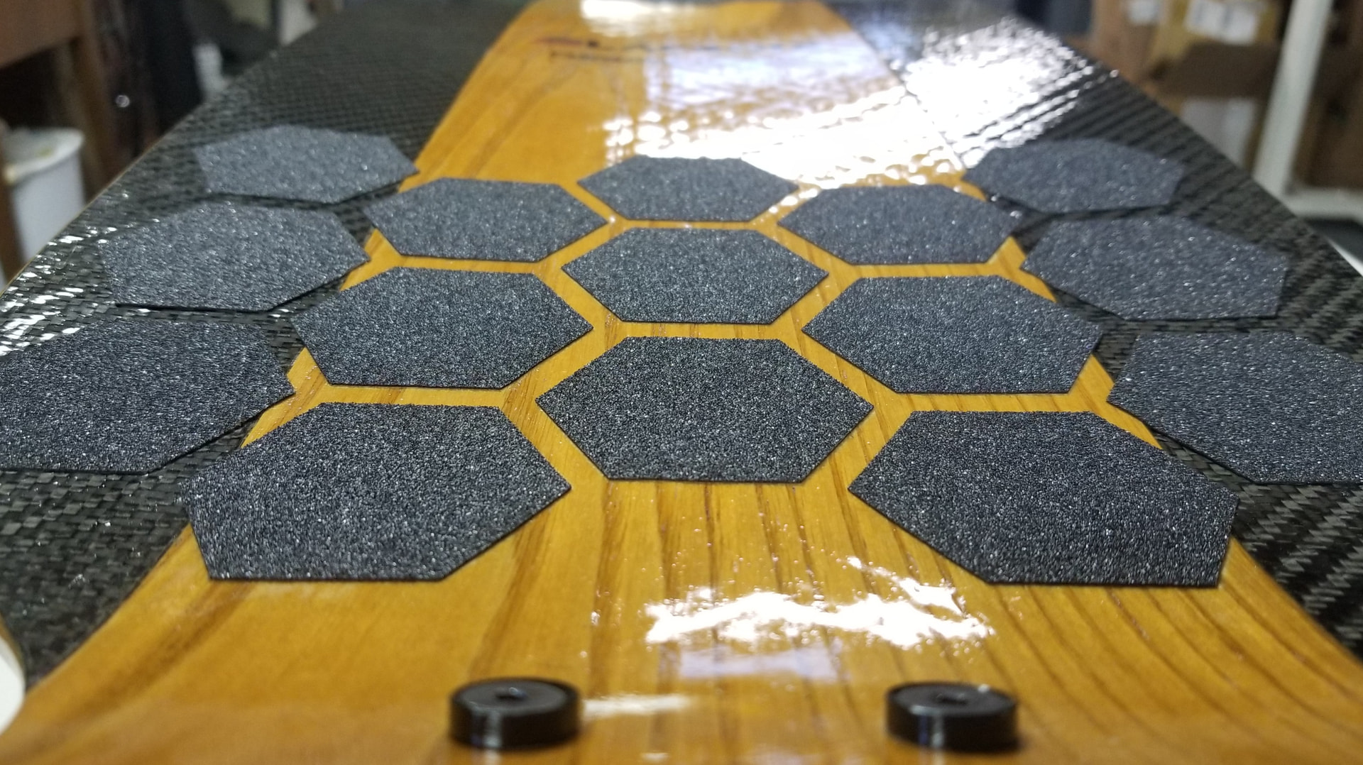

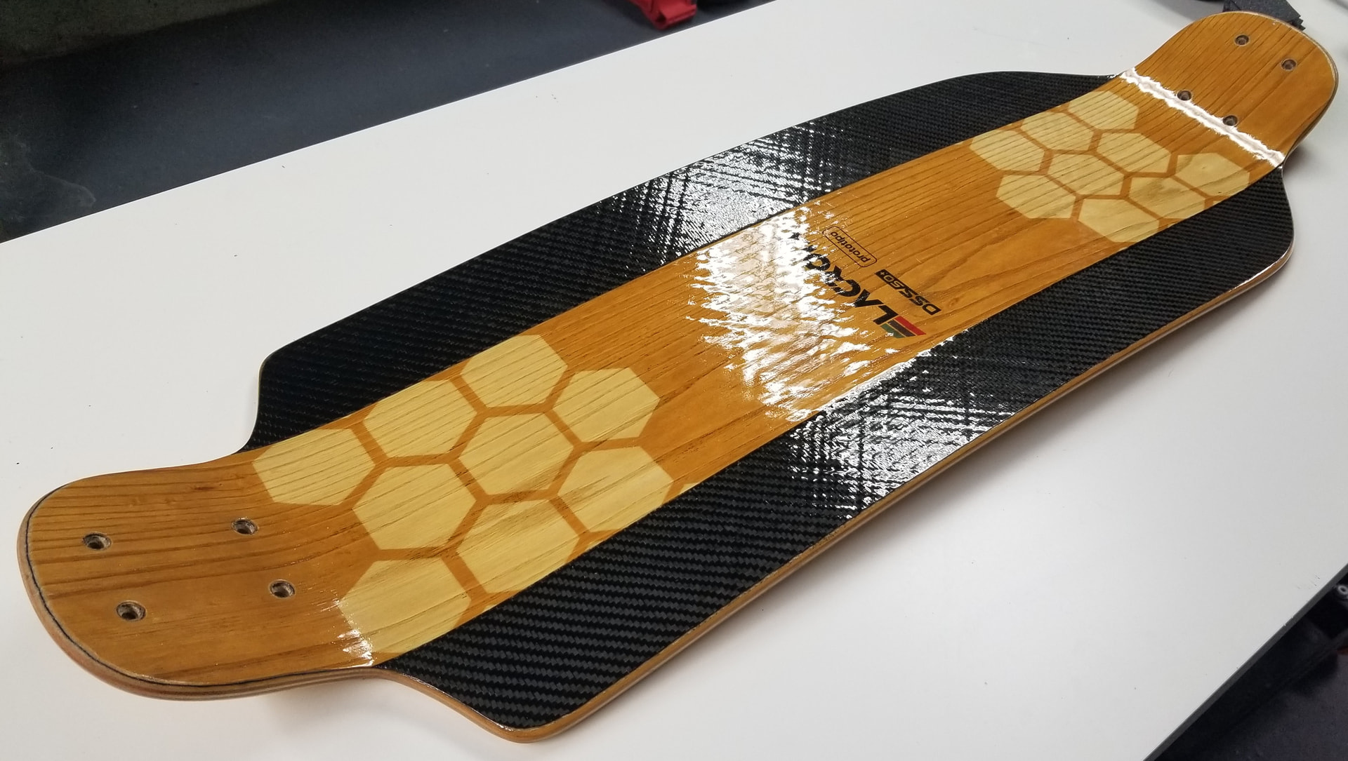

The original grip tape was removed to start preparing for the refinishing process. The hexagon dimensions were a bit larger than anything that I could fine online, so I took some measurements and hit up my homeboy @andoug to laser cut some custom grip tape.

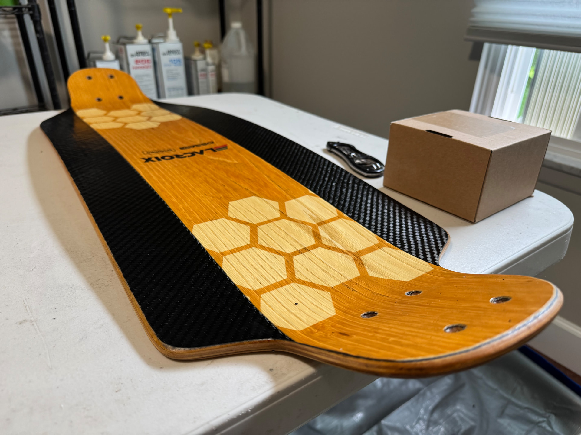

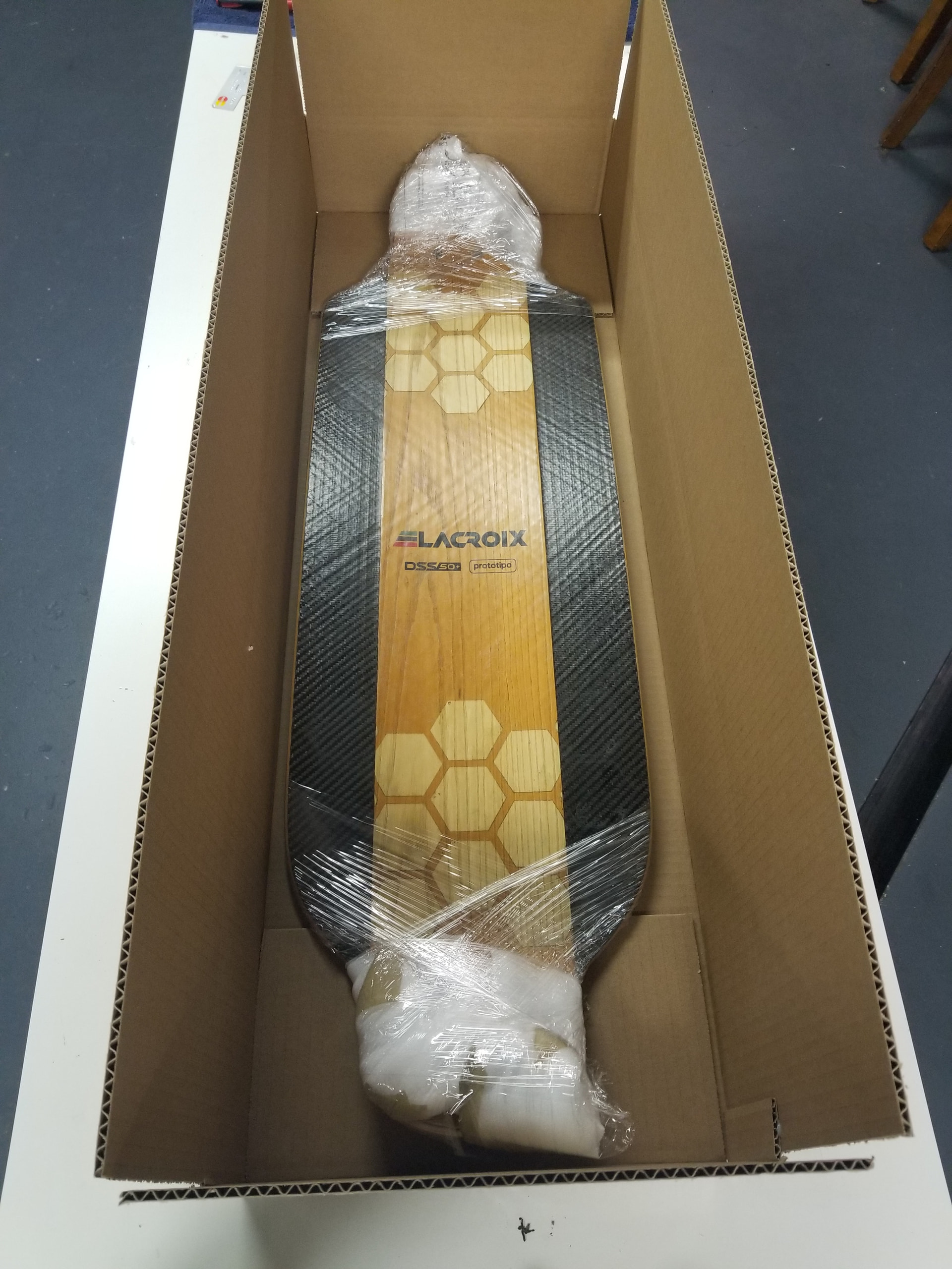

Then she was boxed up and shipped out to the legendary @tomiboi to work his magic

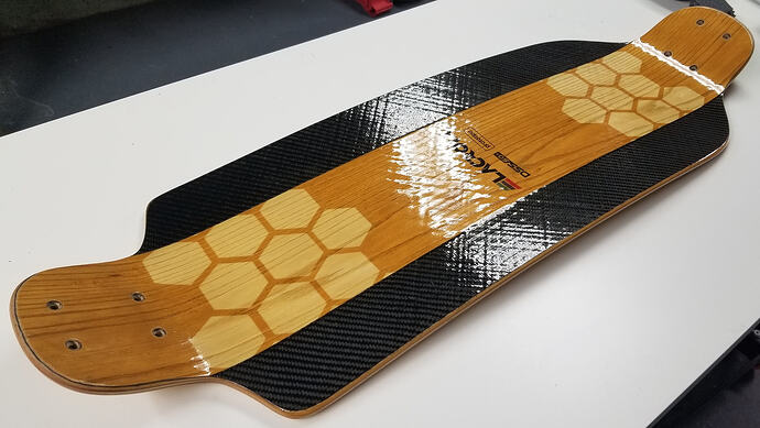

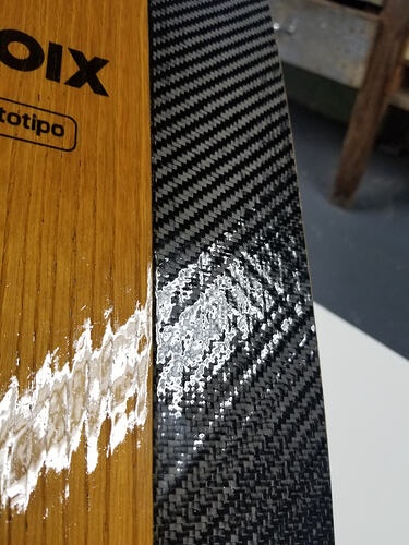

Thom cleaned, degooped and scraped the deck. That took out quite a few of the imperfections.

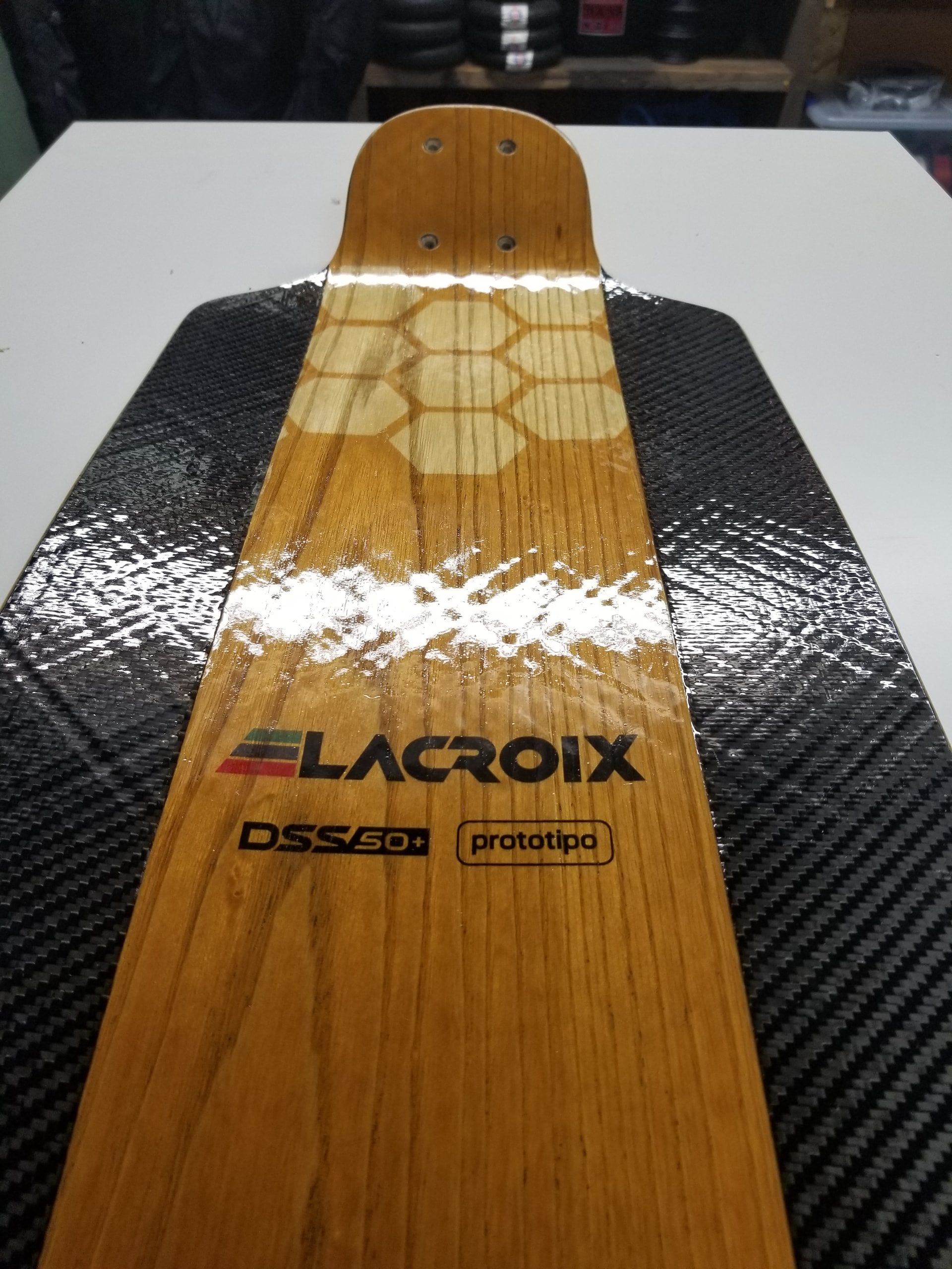

He and I went back and forth on what to do next. I sooooo appreciated his need to be cautious and really consider all the options to make this finish look right. @tomiboi decided to do one more cleaning then give the deck a fesh epoxy based clear coat. I didn’t get any sneak peak pics, so that meant that I had to wait for it to arrive back in Oregon to see the final product.
I literally got home minutes after the arrival notification hit my inbox and ripped that box open. I was so impressed with how this deck shines. Thank you Thom!!!
@andoug came in clutch with the laser cut hexagons. This ended up being quite a key detail considering how much the Maple veneer had patina’d from UV exposure.
The grip tape went on perfectly and looks soooo good! I’d show you some more pictures, but everything I have on my phone shows the wheels and trucks. So I guess I’ll need to talk about that next.
