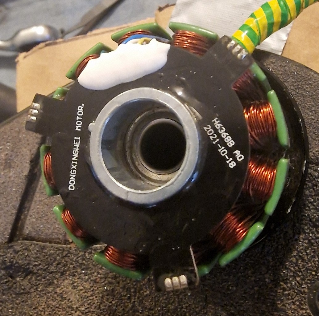

After about 1.5k km, a bearing in my motor (on the Hall sensor side) failed. I don’t see any way to replace this bearing without destroying the Hall sensor. Is it a good idea to completely remove the sensors in both motors, replace the bearings, and set the remote to “sensorless”?
I’m referring to these motors: https://www.ridepropel.com/electric-skateboard/endeavor-6374-motor/
Does anyone even know the size of this bearing?

Okay, guys, sorry for yesterday’s panic.
I found a solution :slight_smile:

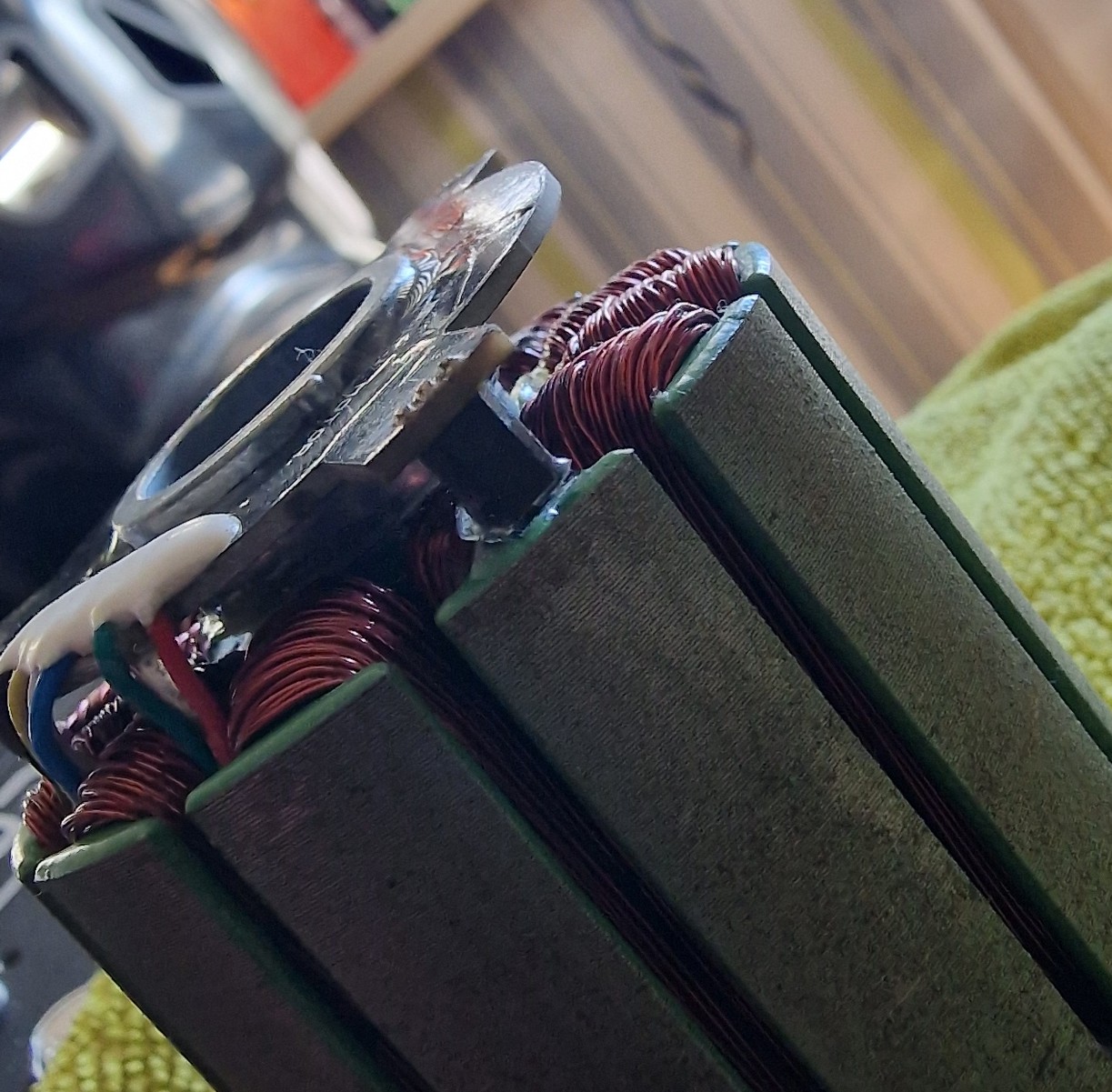

The Hall sensors are not glued to the stator
and the entire board is mounted +/- on the bearing. After knocking out the bearing on the other side, everything fell apart nicely.
bearing sizes:
6000RS x1 (10x26x8) & 6800ZZ x1 (10x19x5)
Sorry for the off-topic, but I also checked that:
After disconnecting the sensors and switching F.O.C. 3.0 to the “sensorless” option, the board behaves quite well (after 10 km, there were no problems with temperature or brakes).
