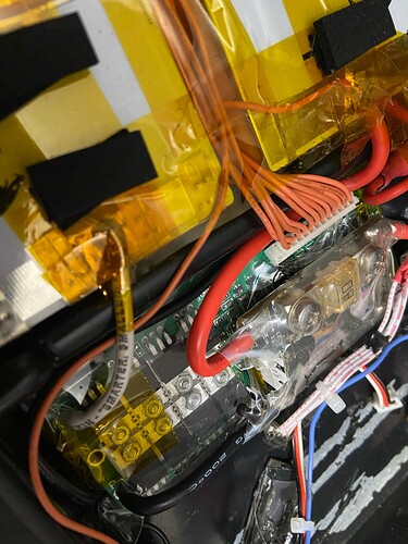

The internals weren’t pretty, but not exactly unsafe. The battery build was lazy, and seemed to have some approaches that essentially fell under “eh, it’ll work.”
Balance wiring wasn’t compressed, but just haphazardly laid about. There appeared to be an attempt at cell-level fusing on the positive end of the P groups…but really with was just a bunch of differently cut, thin nickel pieces with 2 welds onto the cell.
There wasn’t any padding, and two P groups had dented cans when I lifted the battery out of the tray. This assembly didn’t stay long in my home, I brought the whole thing to recycling quickly, because I suffer from both anxiety and a mild case of battery paranoia.
I didn’t personally care for the single piece of 1/4" copper braid as a series connection, especially on such a flexible deck (and completely cracked enclosure).
I realize that this is an older board with an older battery, and I’d like to think that it was shortly after that things improved in these boards, but I do not think that anymore. Since starting on this particular project, I’ve have 4 total Kaly’s come into my shop, an XL40, an XL 2.0, an XL50+ and another V1. Their batteries were in essence, the same. Two of those boards had battery issues, one was from water damage, the other was strictly balance wiring problems. The were abraded away and disconnected from the P group, causing charging problems, and the other was kind of rusty inside, along with having what seemed to mainly just be a cold solder of the negative discharge at the pack terminal, so it was having sag issues.
Those are all the main reason I no longer work on other people’s batteries. Those, the 2 EUC batteries I’ve worked on, and lastly, the nail in the coffin that was a Trampa Orssum. Not the fauly of Trampa, this battery was just disgusting and I needed it out of my life. Never again.
Anyway, back to this build. I did say this section would be short…my bad.
The motor wiring was just plopped out the rear through open holes that kind of look like how I would draw zeroes on paper if I had no lines to write on.
The BMS was…ew. The balance connector was bent and the housing was pulled a bit from the pins. I’m fairly sure I’ve seen this BMS in use before, and the connector didn’t sit at this far an angle so I’m mildly certain it’s not supposed to be this way. Or maybe it is?

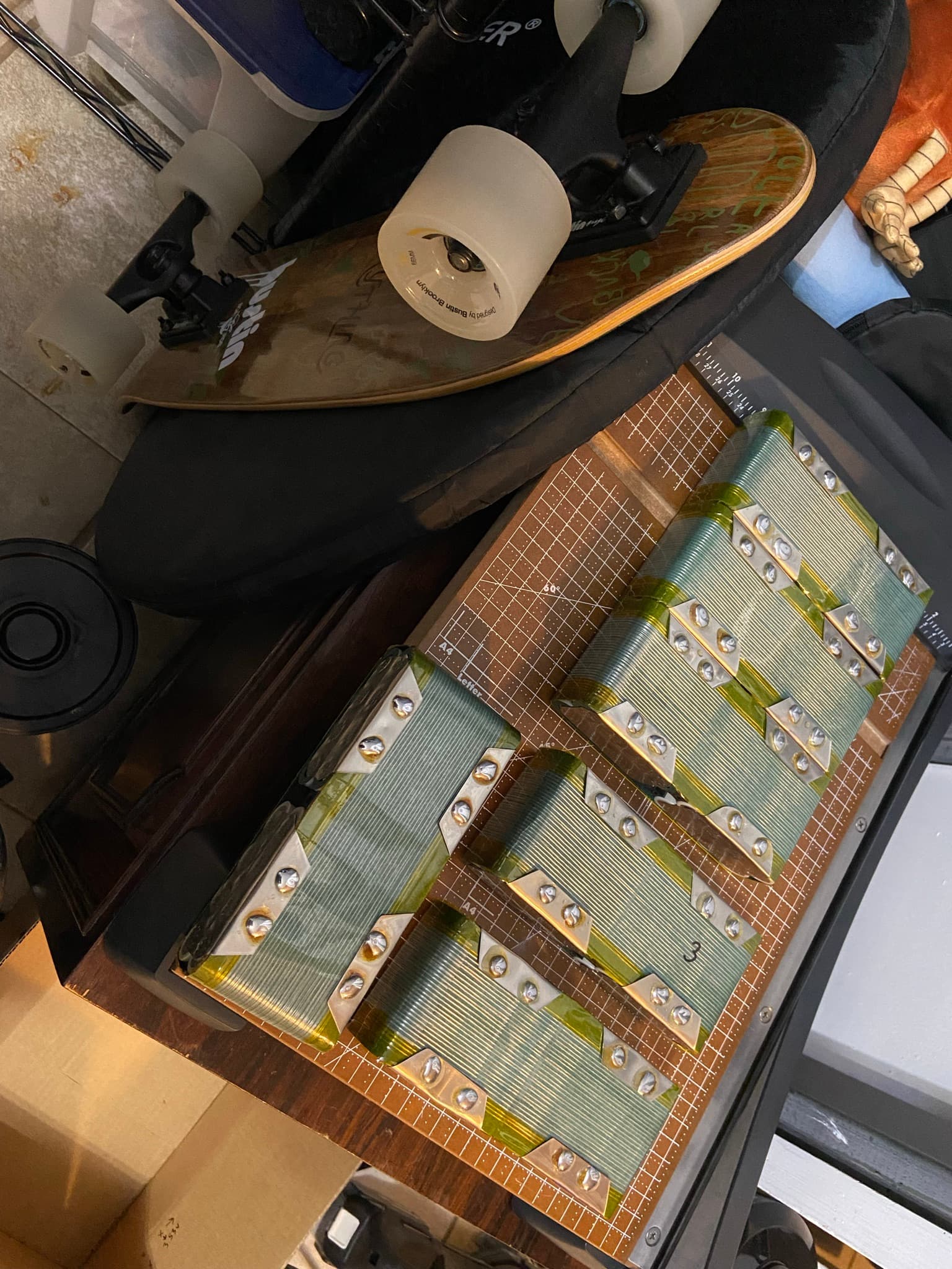

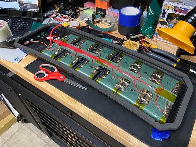

The choice of cell here was the Sanyo GA 18650. The rider weighs 120lbs, and rides fairly conservatively. Tuned to his weight and preferred ride feel, this cell works perfectly. In practice, the board doesn’t pull more than 5-6 amps per cell, and in this case, the extra capacity will indeed be reachable.
Stealing the idea from @glyphiks , I put a printed spacer betwixt the P groups to make the segments one cohesive unit and give a bit of extra space between alternating cells.
The spacers were also glued into place, and so far seem to be holding well. I have indeed checked, and I’m mildly convinced they’ll last fine given how it all went together.

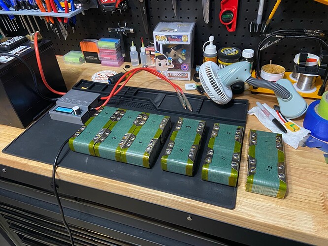

I haven’t gotten THAT many battery build pictures, but there’s not much here that’s out of the ordinary at this point.
I kind of regret how not-that-round-and-pretty the solder pools ended up. The joints held very well, but they could have ended up much nicer looking. My main regret of this board.
Oh look! Unwelded cells. They’re so adorable.
Finishing it up.
Don’t mind that last picture…I totally didn’t build two of these batteries with different cells at the exact same time and use a picture of the other one.

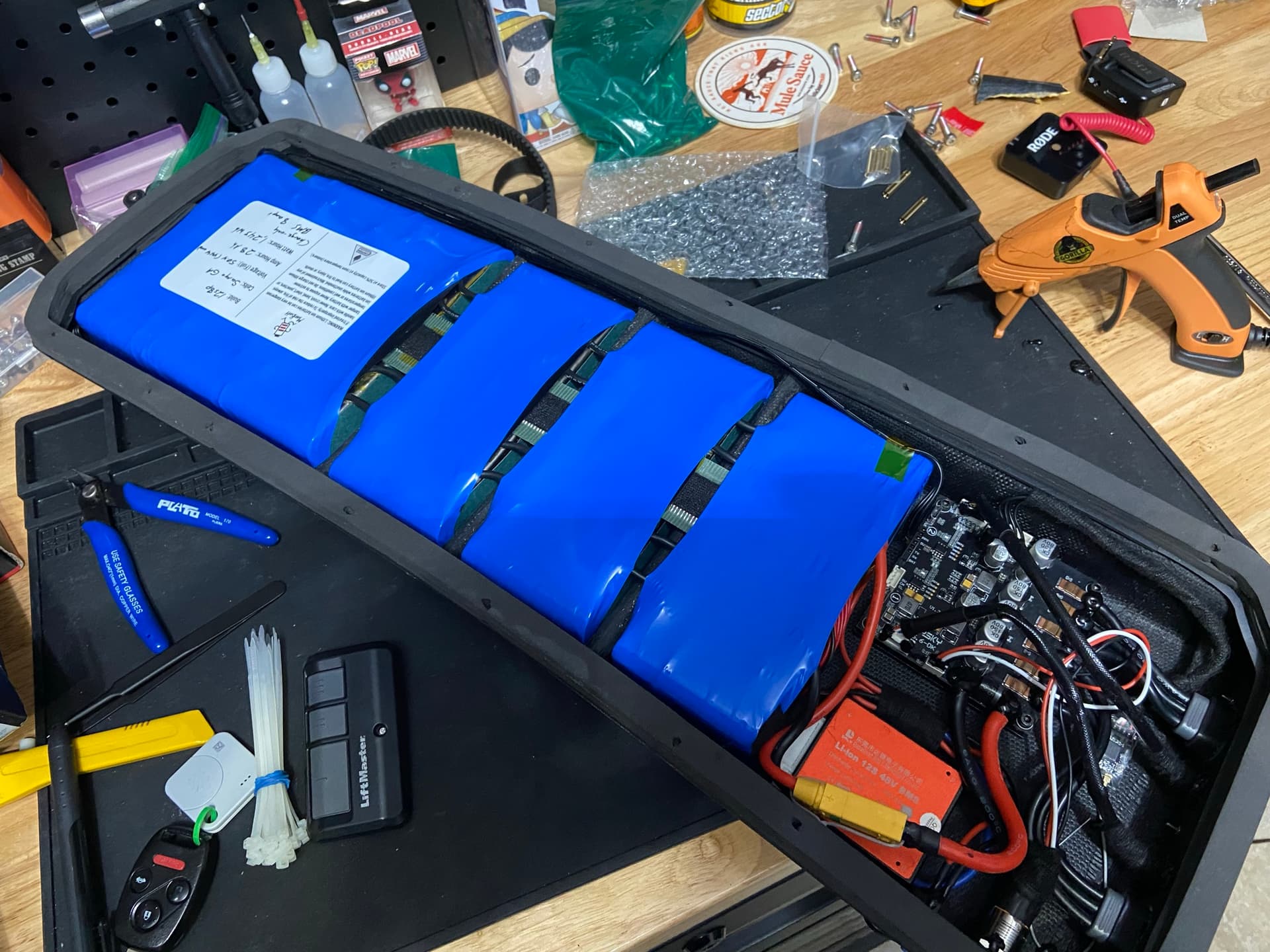

With the connectors all set, it was time to set up the internals…kind of.
At this point, one of the very few things left on this board was the Unity. This is actually where the name of the board comes from. Since the owner and I ended up talking very often, one of the things he said along the way was, “I’m getting strong Ship of Theseus vibes from this whole thing…how much of the original board is left?”
For those of you not familiar with the Ship of Theseus, it’s a thought experiment. It was recently highlighted in the Marvel show Wandavision with regard to Vision.
It was because of this, that I tossed together a graphic to lay on the center of the deck, in the place of what used to be a serpent eating its own ass. Which, for some reason, people think is cool looking.
Incidentally, it was shortly after all this, that the Unity died during testing.
Oh, sweet Unity. You had a rough life. You can rest now.
But the build must go on. Best laid plans of mice and men.
BMS adhered in with VHB, given time to mould and set.
I ended up not needing the extra layer of gasket, so it came off. Ignore it here.
I flowed some insulation onto the exposed solder terminals of the ESC and added conformal coating to the rest of it, which is a Flipsky Dual 6.6+. I have had good luck with them, and so occasionally I use them, especially when there are space constraints. Despite the comically large 8awg power in wires, they’re just fine. The one inside my Sportster build is running strong after a year and a half of lugging my fat self up hills every day. And I have a spare in case this one doesn’t last as long as I expect it to.

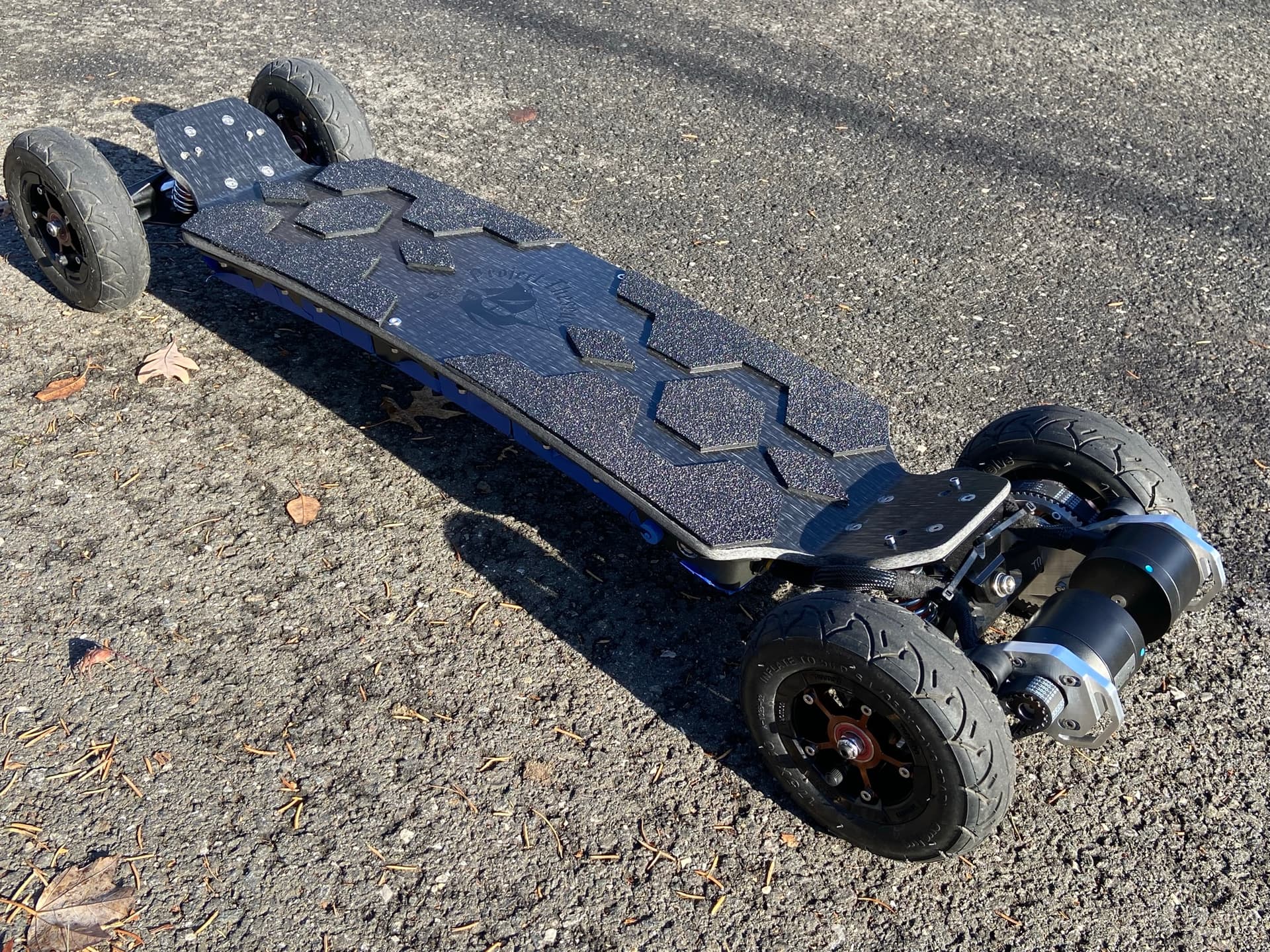

Grip tape is usually last for me. Since it’s a matter of taste in many cases.
After some test riding on a very slick surface (the top of the deck, that is), it seems ready for grip.
This grip tape is padded, and bought from 1wheelparts in Texas. They started with foam grip tape for Onewheels, and then branched off into offering grip that fits Evolve decks, and then a universal board package. It’s really great stuff, very coarse and robust. Not like the flimsy stuff that sometimes ends up on eskates. The grit is just a notch below Vicious grip. Not as coarse and sharp, but very coarse. Most akin to The Float Life grip tape, which is incredible. I love this grip, it contours around the edges of the shoe sole, and really locks in. The pattern was made with just hexagons, and some slight mods to those shapes.

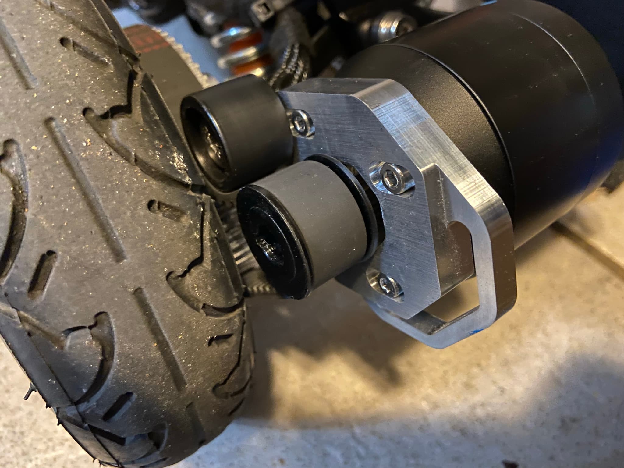

The stock motor pulleys for these motors weren’t really working how I wanted them to, and there was some belt bias. I swapped them to other pulleys, specifically the 15t pulleys bore for a 10mm shaft. Generally these 10mm D shaft motors include a pulley with only a single flange, which can be problematic since there’s no wheel pulley flange to offset the bias. On most boards where these motors are employed, there is.
So, they had to be swapped to a motor pulley with two flanges to true up the belt. Tension was kept loose since there’s an idler pulley, and it keeps things nice and buttery.
