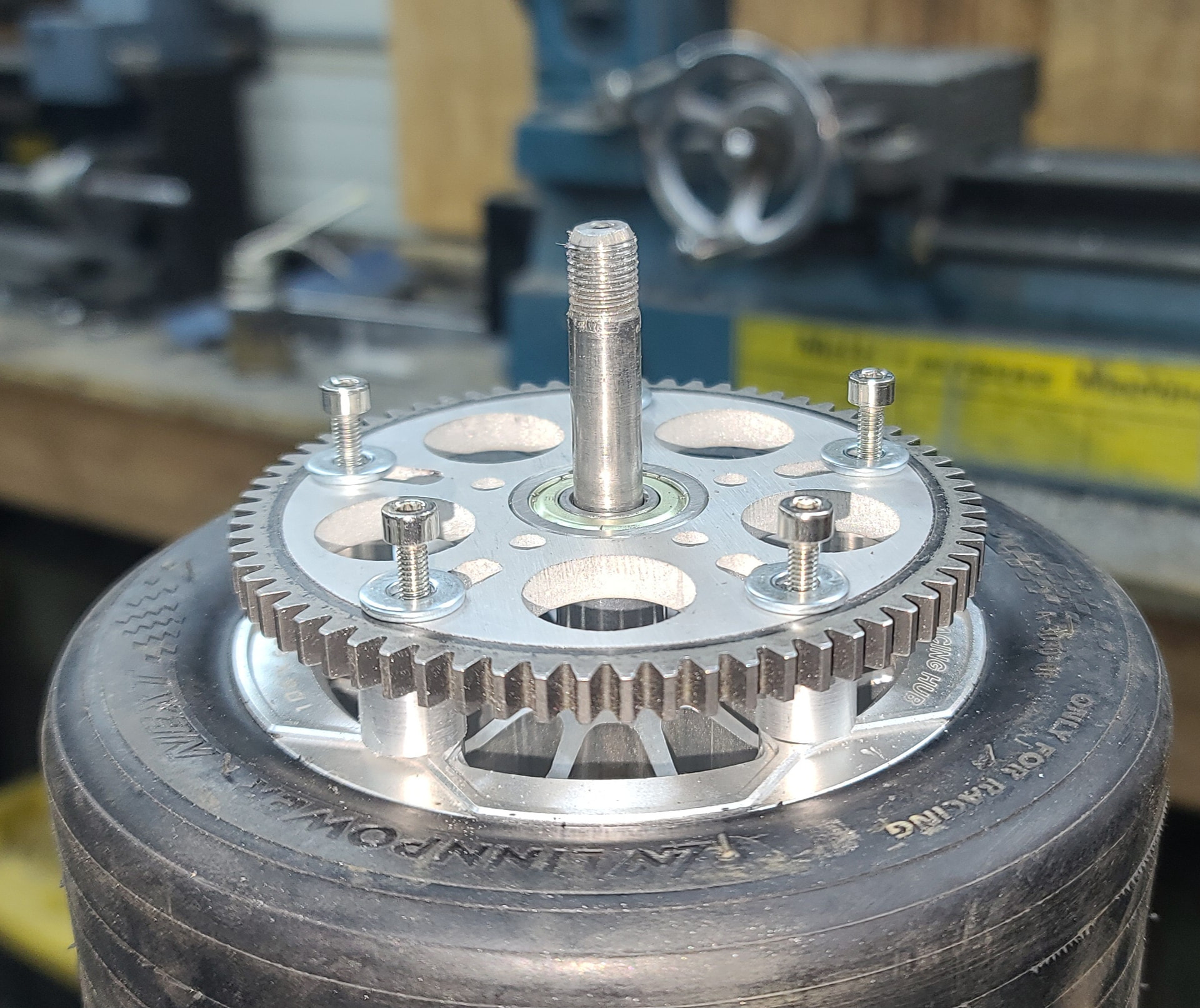

I have mad hubs with linn power adapters and spurs. But I’m using the MBS pattern between the adapter and the spur.
I bet we could make a simple printed jig to bolt up to the new spur to drill out MBs holes.
I believe they went away when he had to find a new supplier. But not entirely sure.

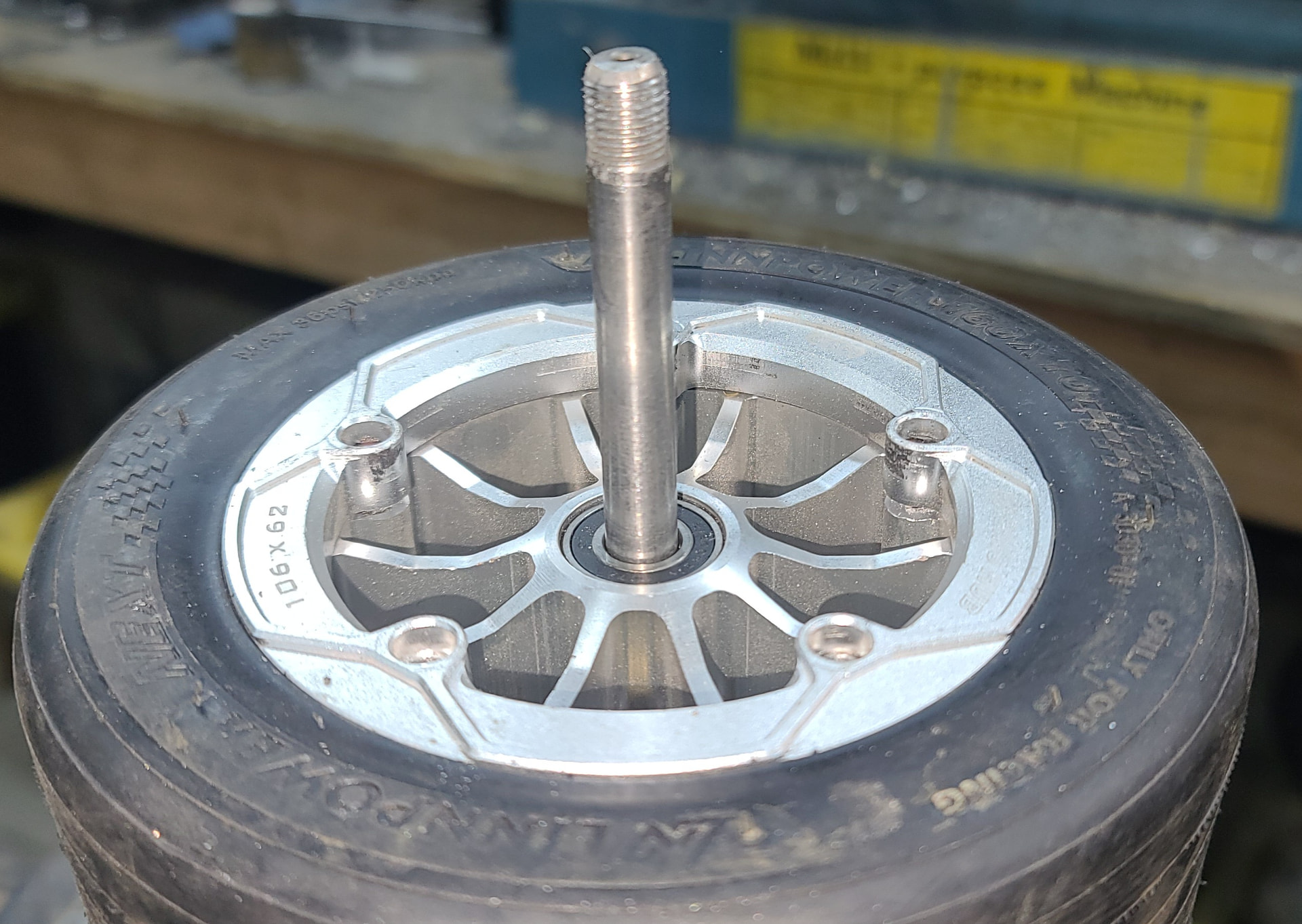

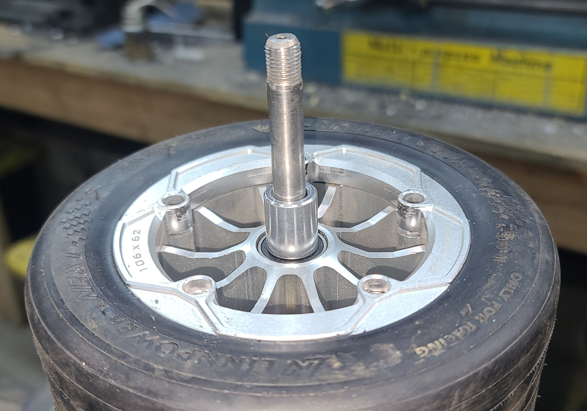

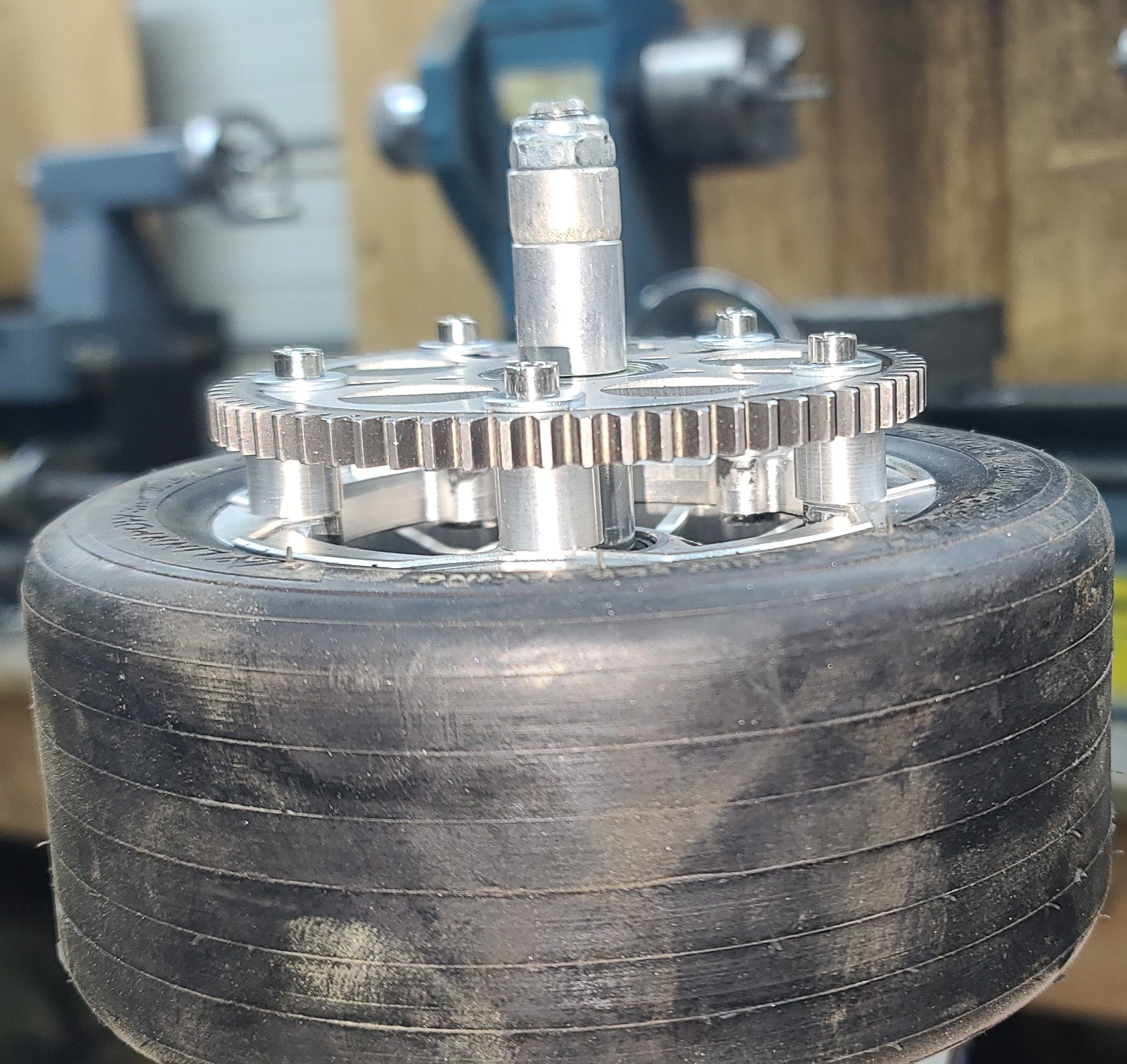

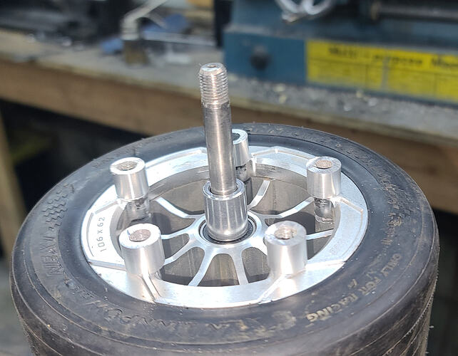

I’ve been using mad hubs as well, but using a spacer system instead of the linn adapter and it worked surprisingly well and never moved. a jig would be a good idea for drilling holes into 78t, I was fortunate I had the 67t spur I just copied the holes into the 78t.

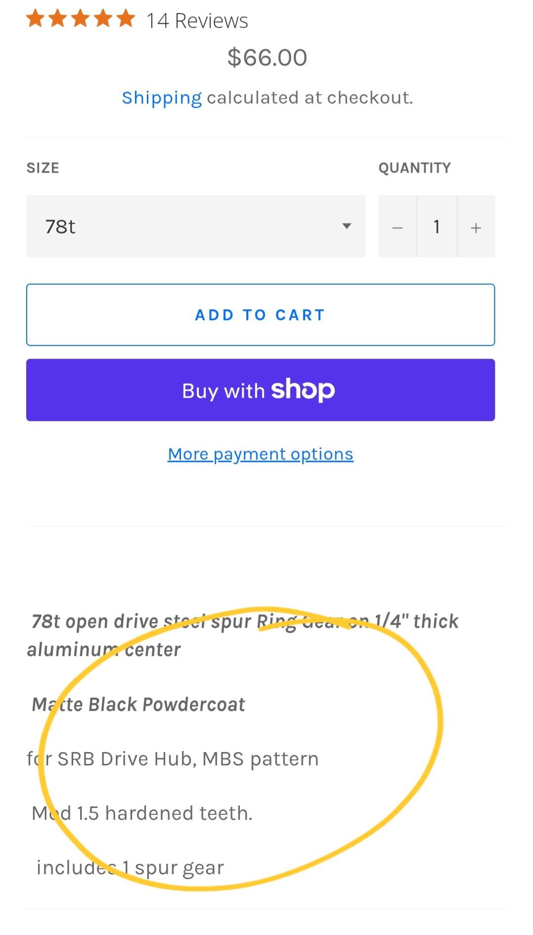

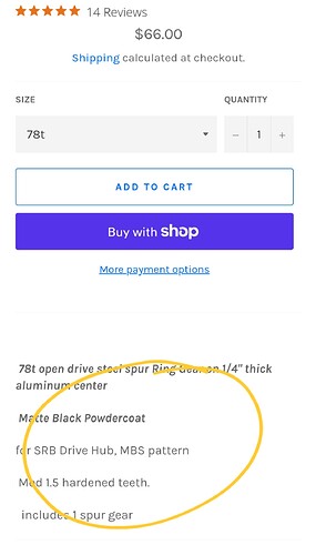

MBS hole pattern has been back in the 78t spur for some time now.

False statement. The 67t spurs had MBS holes stock. Your new 78t spurs the MBS pattern was removed. I just got your 78t spurs 2 months ago and they only had BRP compatibility stock.
Since the holes were removed, you must pay to have them drilled or do it yourself per my above comment. Bring back MBS compatibility!

Happy you’ve made this change, I stand corrected.
There’s your answer, you can get the 78t with MBS from Moe.
