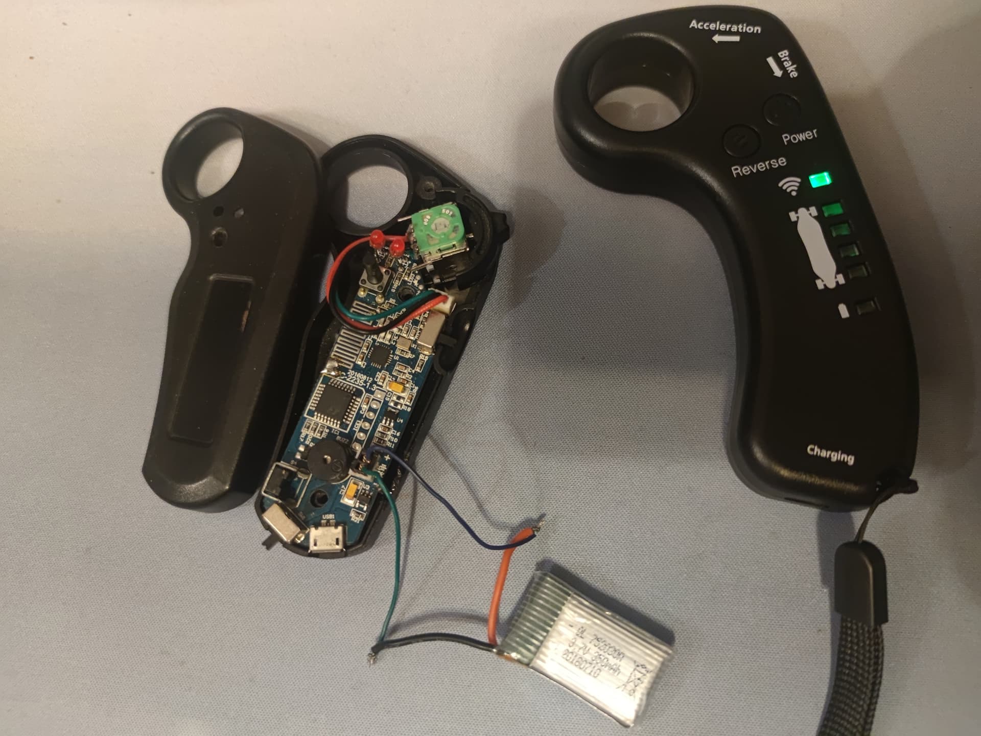

I’m not getting any input from the remote to the board. I’m hoping someone who is familiar with the ESC / remote models in the pictures can help me out.
What I tried:
  1. When I start the remote the left LED blinks once, stops and the buzzer beeps once, pauses, beeps 4 times, pause, 4 times again and so on. This happens regardless if the board is on or not.
If I press the pair button on the remote the beeping stops for a second, it beeps 3 times and then starts beeping 4 times again. If I start it with the pair button pressed it beeps continuously until I stop it. The remote also had a wire soldered between the ends of what I assume is the antenna. It seemed DIYed so I removed it to see if anything changed, it didn’t and I can put it back if it’s necessary. The old battery was also soldered poorly to the back of the board, it didn’t look good, which is why I thought it might be broken. The remote is still open so that I can hold a finger on the buzzer while I try the remote because it’s absurdly loud.
2.I found an identical looking remote on ali, it was out of stock but the same post had another remote for about 14$ so I though I might as well try it. When I press the pairing button on this one the power LED just keeps staying green. I’m not sure if that’s supposed to change only if it connects and the board is just not in pairing mode or if it’s just somehow incompatible or if something is wrong with it.

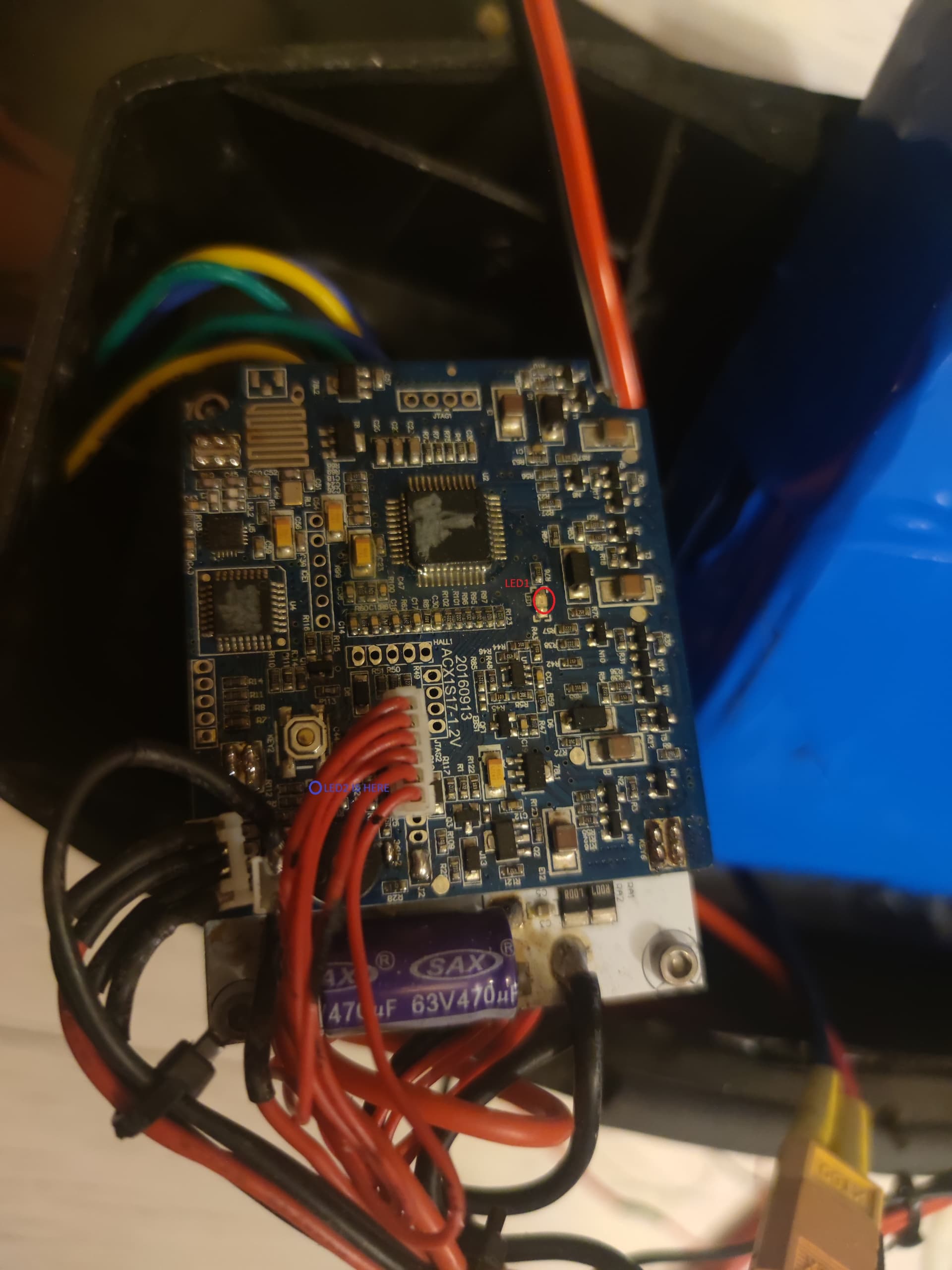

  1. When I power on the board I get some a very light click from both motors, LED1 on the ESC stays on for about a second and then it starts blinking about once a second. There’s also an LED2 next to a button, this one never lights up.
    The LED1 on the second ESC also seem to be blinking every second though one of them is ever so slightly faster than the other if that is relevant.
Long pressing the power button for 4-5s, after turning it on, seems to make LED1 light up 2 times extremely quickly after which it keeps blinking every second like before though it looks more like a reset and I’m not able to pair after this. If the power button had any integrated LEDs, they’re not working.
I also tried pushing the button on the ESC, it didn’t seem to change anything. I did not manage to connect with either remote.
There’s also a weird voltmeter on the battery cover which seems to work fine when the board is on but when it’s off, the voltmeter buzzes, the screen stays on and the V value jumps around though I can measure battery V just fine on its connection even when the board is off. I’m not sure what that’s about so I disconnected it for now.

I think those old small remotes have a way to pair them up but i can’t remember the exact process. Doesn’t help that the internals on the one i have doesn’t match up with what you pictured - green pcb and a paperclip hole to a pairing button. I have since retired mine because of twitchy pots and better options.
Seems like the original remote may not be the original? I’ve never had to re-pair them except when changing the board even when replacing the batt, but again it has been a while and im sure im just remembering incorrectly or incompletely.

I have a bit of experience with remotes. I’ve designed my own shells and used the guts from off-the-shelf remotes.
@pecos is right too, most ESCs use the power button for pairing.
Usually click and hold the power button till some LEDs starts blinking.
Remember to turn the board on first, and have both remotes off.
Power the board, then hold the board power button till the LEDs do something (rapid flashing usually), then turn on the remote you want to pair and put it in Paring mode. From what I can find, the new remote you got should be LingYi, so it should be able to pair.

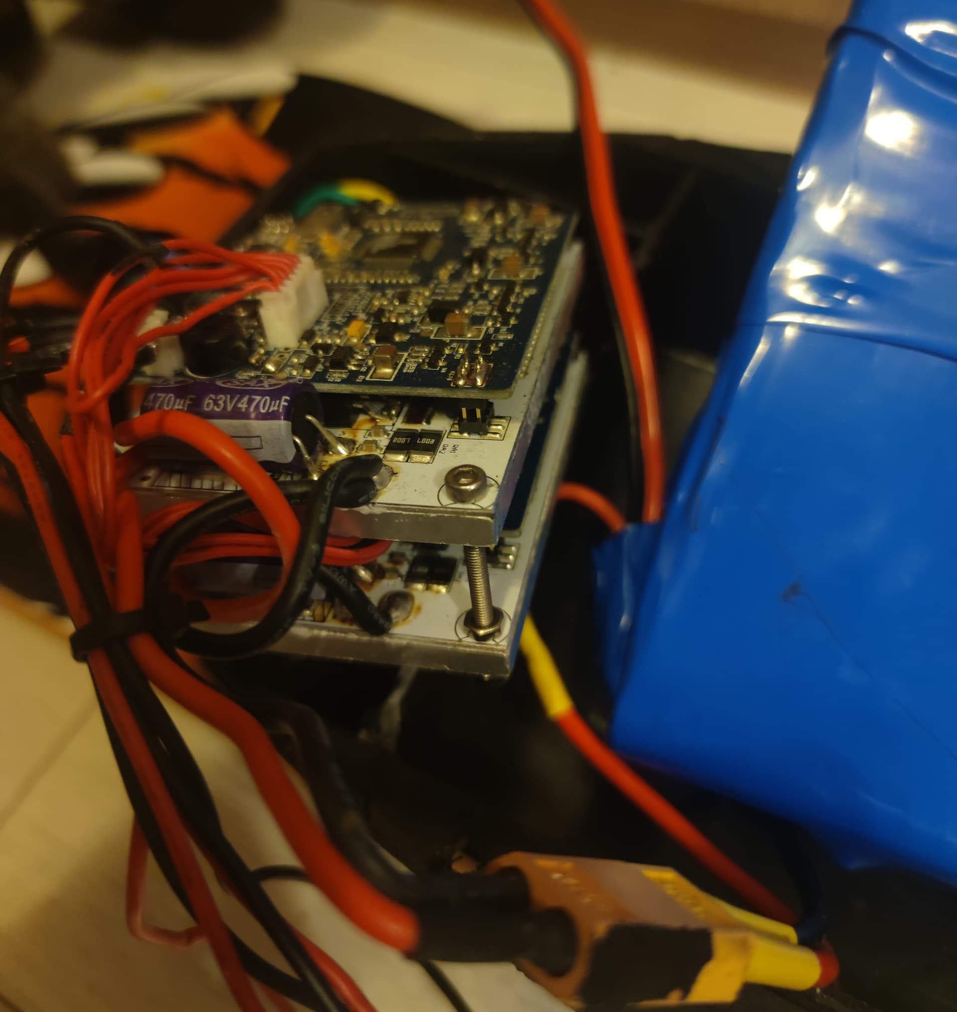

From your pics it looks like 2 single ESCs stacked (master and slave maybe).
Instead of a Dual ESC. So it’s possible that the bottom one is the Master and that is the one you need to pair with.

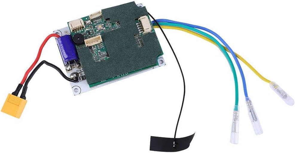

Also, is there an external antenna? I cant tell from the pics. I see a PCB antenna on top there, but I would imagine there is an external one too, maybe coming off the bottom ESC.
It’s 2 of these ESCs stacked:
Anyway, there is really only 1 important thing in choosing a replacement remote, and that’s the RC Protocol it uses. In E-skate there are a few, but the 2 most used by manufacturers are; LingYi Remotes, and HobbyWing Remotes.
It’s hard to find that info when buying a remote tho, so you kinda have a 50/50 chance of getting one that works.
It looks like your ESC might be an older LingYi. The white PCB is indicative of those ESCs. You can buy these pretty cheap all day long.
I’ve found that this LingYi remote works with my Propel Endeavor right out of the box. It uses the LingYi protocol (this same remote goes by other name and brands too)

I don’t know if it’s original or not. The pairing button on the old remote is just above and to the left of the on/off switch which is the one at the bottom and it’s slightly recessed when the remote is one piece. The new one has a smaller pairing hole on the back.
Multiple presses on the board power button don’t seem to do anything but I’m also starting to question if the cabling for the power button is ok as it looks like someone might have worked on it. It also seems to be two stage, there seems to be a click in the middle and one at the bottom. No that it seems does anything to do anythign diffrently depending on how much you press it and the board starts as soon as it’s lightly pressed.
From the video provided for the new remote, the ESC goes into pairing mode by pressing the power button for 4s after it’s already ON. I’ve also found this video www.youtube.com/watch?v=pWkZInF4JHg with seemingly the same remote being paired with a different board by pressing a button on the ESC which I’ve tried doing on my ESC but I did not get a pair.
The multiple presses didn’t seem to do anythig. How could I tell it’s doing motor detection, would it rotate them or just beep?
I’ve tried a few times with the voltage meter connected, I will try with some of the ideas new ideas with it connected as well.
The ESC that is at the bottom seems to have a lot of components missing so I think that’s the slave.
I can’t find anything that looks like an antenna on the ESC. I would try connecting one but I don’t see any obvious place for it where one would have been previously connected and disconnected for whatever reason. Does it usually just get soldered to the end of the snake like antenna on the board?
I’ve seen similar ESCs, to the ones on my board, for cheap but they’re rated for 430W and I think these motors are quite a bit more powerful than that, though I can’t say that I know they are.
This is a cheaper one I’ve found, that is rated for 1650W. Though it could just be that the motors available there are 1650W as the ESC looks exactly like this one in the 2nd link which is rated for 430W.
