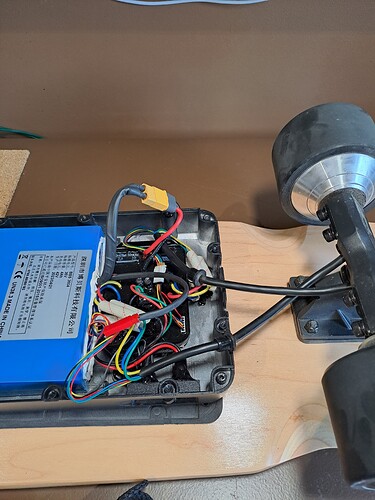

I bought a Verreal Mini Hub Duo and I am looking to convert it to a belt drive for wheel options and also reduce its weight at all if I can. I don’t really know anything about DIY Esk8 so I thought this would be a relatively straightforward project where I can learn a little bit about building in general.
I’ve read that I have to replace the ESC because the kV is different for Hub and belt motors so right now I’m trying to figure out the specs for the existing battery, which I plan to keep, but I’m having trouble understanding the label on it. Can anyone help me identify this info? Thanks.

this looks to be a 10s2p whatever cell battery pack, without the cell and bms info, there is no telling how many amps u can pull from it…

Battery Amps: So knowing how many amps it can pull is the main stat you need to know when pairing it with an ESC? I’ve messaged Verreal to see if I can get a proper stat sheet on all the parts.
depends, if u going vesc, then yes u will need that info to not hurt urself. if u plan on getting the belt drive version of that same type of esc, then verreal would gladly sell to u

And since I know that the battery is 36 volts does that mean I just need to find an ESC compatible with 10s?
