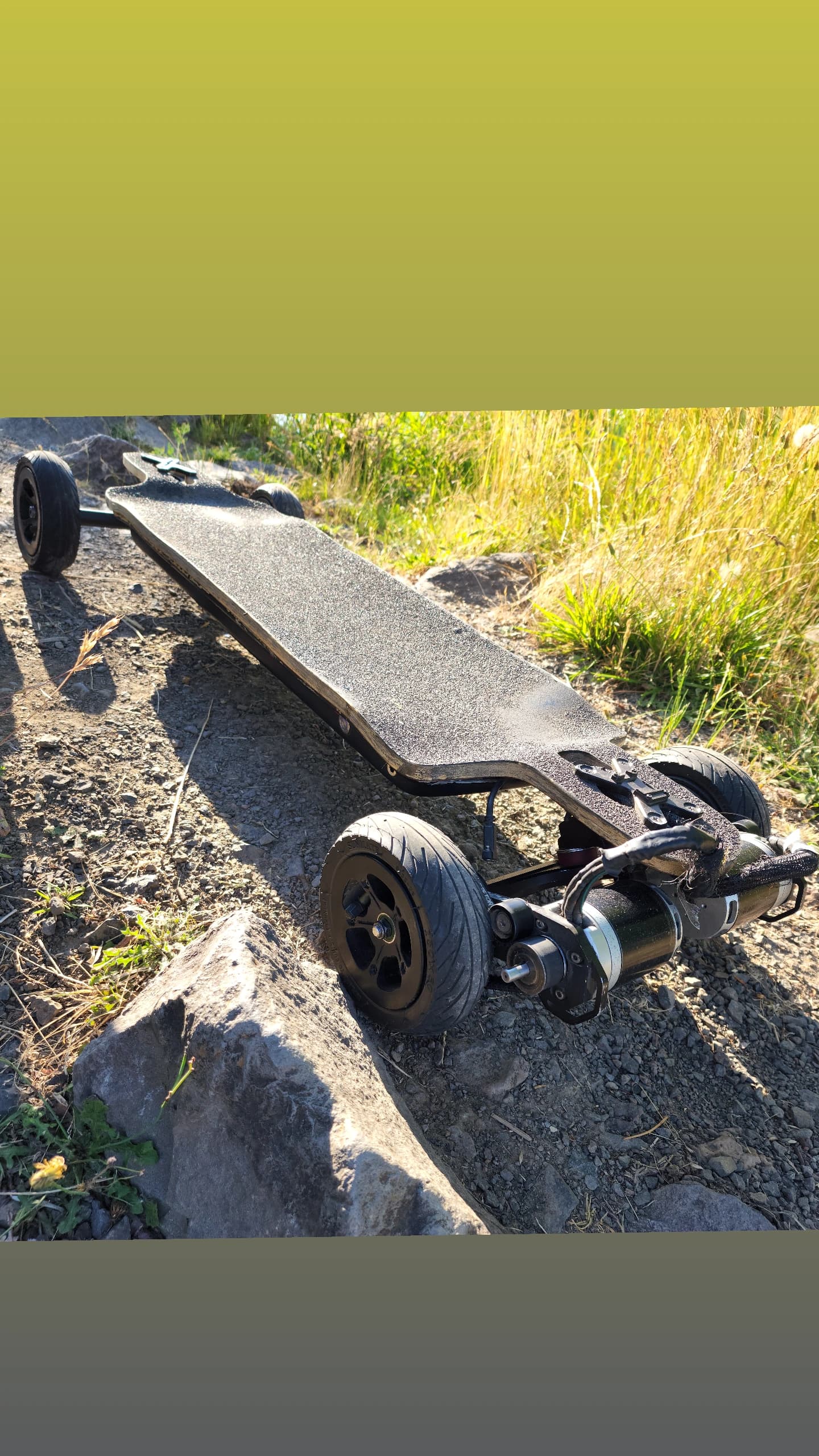

This is what I ended up building at my attempt at a powerful RKP street deck. Asides from using pneumatics and super wide trucks, I wanted it to be as close to a normal longboard as possible looks wise
Love this thing, but the 6 kg bother me, could you make a baby version of it (never hurts the portfolio, no?)
Not in terms of power, ofc, I’ll gladly take that
