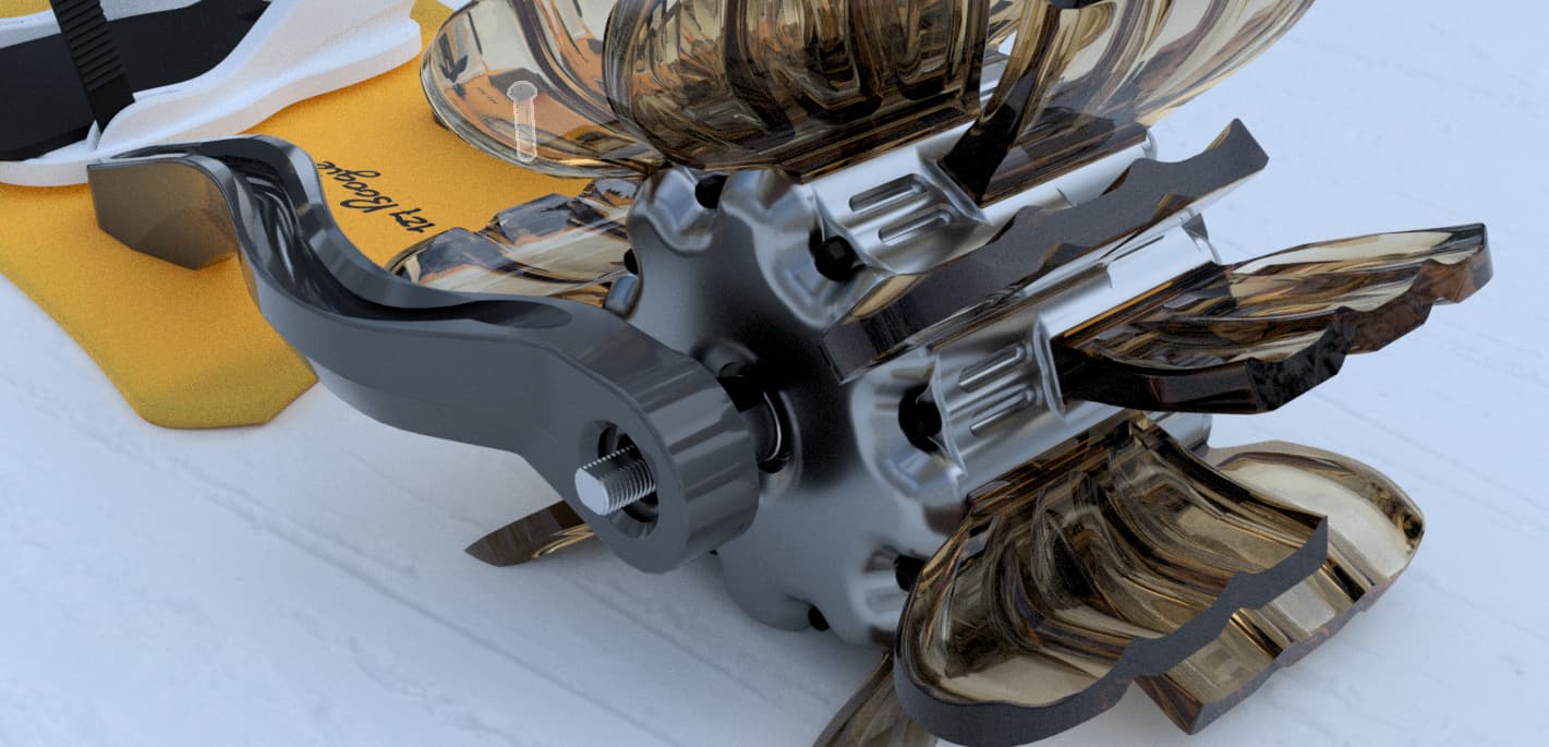

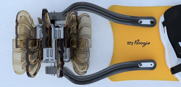

Next, we mount and wire the hall sensors, then plug the motor into the vesc. :pray:
Looks incredible cant wait to see it in action!
hmmm, did you have a third party designing your motor? Or did you already performance test metrics behind the scenes?
Idle current, efficiency, max torque etc?
Please dont tell me you’re just slapping it on and expecting it to work as intended
We modeled it with a few engineers. The picture above was the first time the parts were all mounted on the board. (The stator wasn’t installed yet.) The motor is now mounted on the bench spinning…
If we paid everyone to do everything this project would be dead.
If you model the parts in simulation enough you can start to predict the effect on torque and RPM.
We used AI to test every parameter range, then picked from the graphs.
This is how we got to a stator that can handle 2500-8000W 1000-2000 RPM 50Nm+
Looking forward to the practial bench test results, will be intresting to see how close they are to sims :slight_smile:
