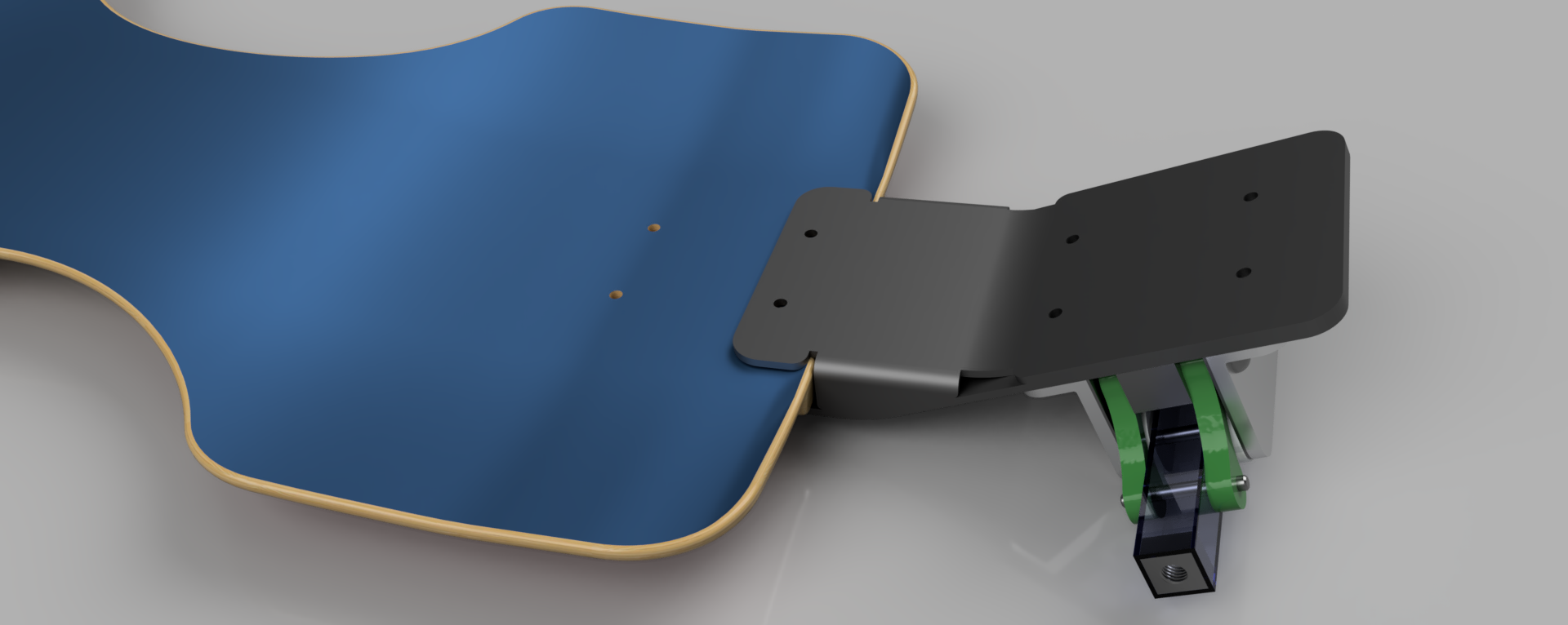

I think there’s something missing. I mean, I can see where the trucks mount, but that can’t work can it?
Ah, well.
Its actually a platform deck, designed for Brackets.
Cut-in grooves to retain a simplified bracket is a cool idea, but… That’s going to reduce how strongly the foot platforms attach to the stringer too much I think.
Second simplified bracket concept. Top and bottom of bent sheet metal.
Will this bracket construction be strong enough? Maybe. I’d like to get away with keeping these parts Aluminum. I’d also like to avoid having to weld them together. Would be more ideal just having them tied together from the mounting hardware. But, welding might be inevitable.
Should be simple enough to execute with a plasma cutter and a vice.
