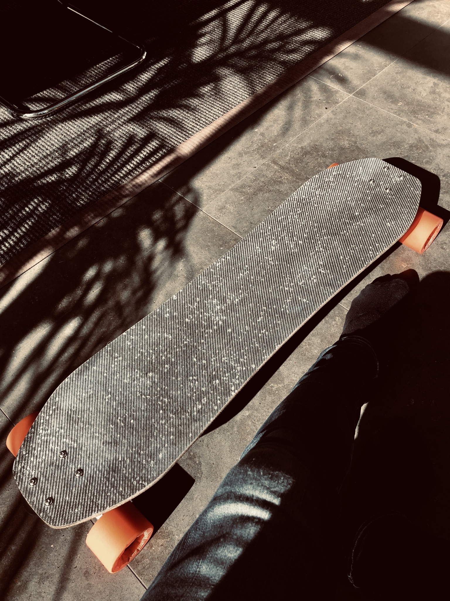

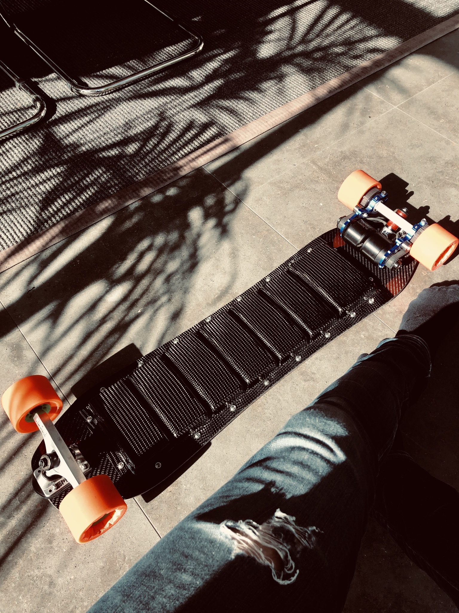

I love those mounts are they your creation?
yeah had a friend of mine machine them. I previously used dickyhoo’s older caliber style mounts but. they had too many holes and places where rocks and pebbles could get in to the drive train. and it was abit to long and ugly for my liking. (dont tell dickyhoo)
