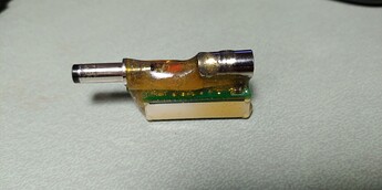

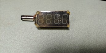

It never occurred to me to look for a 2 wire/4 digit/42+ volt capable display.
My alternative was to use a 3 wire version with a resistor to drop supply voltage for the input.
It’s not a 2 wire. It’s a 3 wire, 4 digit 100V one
With a ZXTR2005K-13 to power it buried in the epoxy

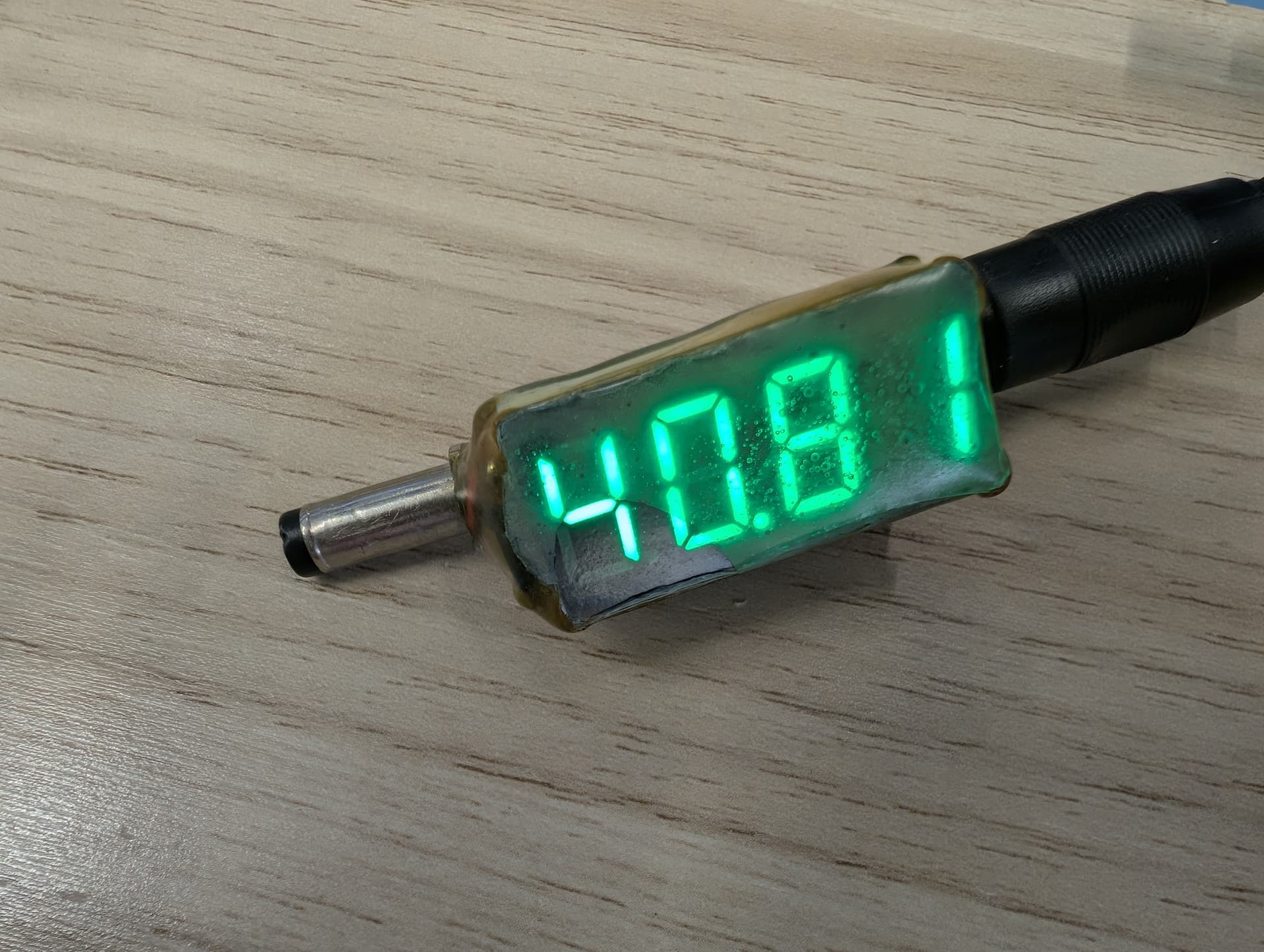

Is that a voltage-only bypass hack?
My newest favorite parts are this gauge:
using this for power
https://www.digikey.com/en/products/detail/diodes-incorporated/ZXTR2005K-13/4279448
or the ZXTR2005K from AliExpress (which costs more in the US, and is ten pieces)

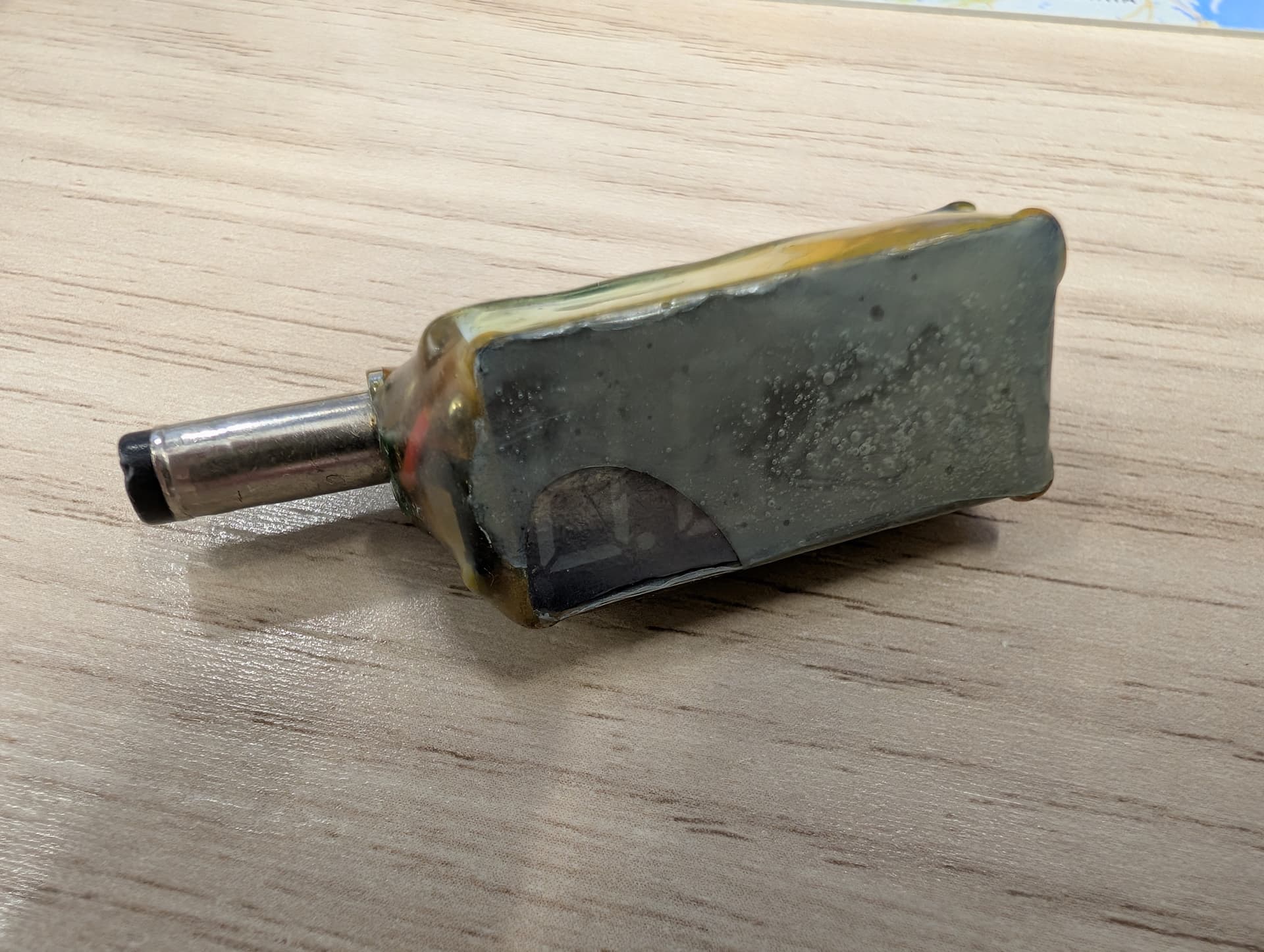

add some West System 650 epoxy and these:
male
https://www.mouser.com/ProductDetail/490-PP3-002AH/
female (REQUIRES an epoxy mount solution)
https://www.mouser.com/ProductDetail/490-PR-2155/
and a tiny bit of fishpaper and you can make some shiz looking like this

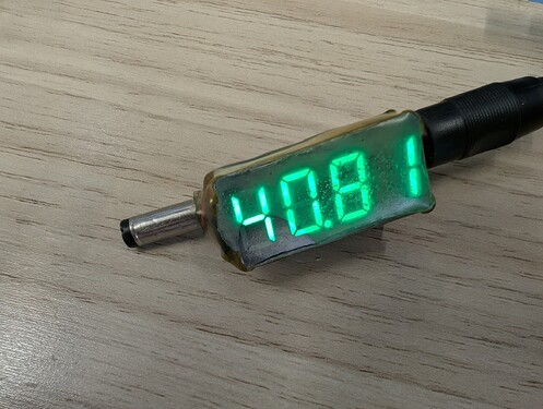

So tiny! Why the need for the voltage regulator?
You can test 4V - 30V and run the gauge from the test wire, but if you exceed 30V you need a separate power source. So I use that part to make 5V from the test voltage. In that configuration, with the ZXTR2005K powering the gauge, it will test 10V - 100V.

I was wondering what the two circled wires were for as they appear to bypass the circuit board, connecting the input directly to the output.
they are just input and output going in different directions.
this is how it looked with the original connector
e: yep as it seems to are connected to each other.
output←→ input | input ←→ output
That makes much more sense
Ahhh…okay, thanks!
